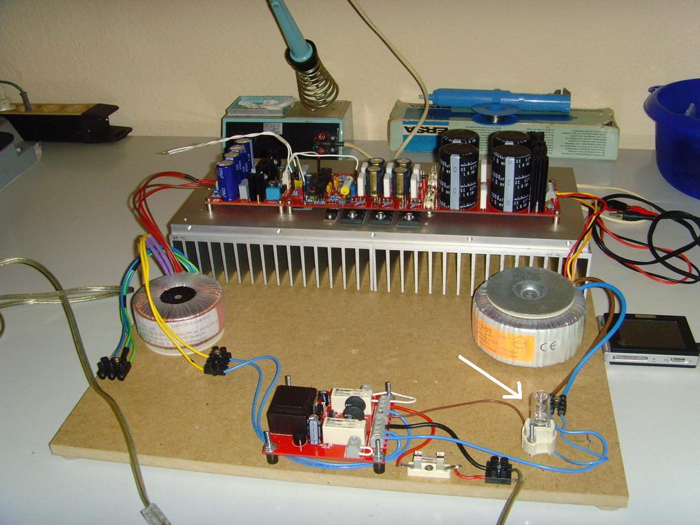

Jean: if you succeed with step 2 (my post #580): switch power off again, remove the bulb-tester, preset the potentiometer to 0 Ohm
and remove one of the "Bypass - TT-diode" jumpers.
(I see 2 diodes being bypassed on your picture).
You need a string of 5 active diodes for efficient thermal compensation.
Ideally the TT-diode with the highest Vf (did you measure before?) shall be bypassed.
Then: adjust again - and have a big Scotch!
Best regards - Rudi

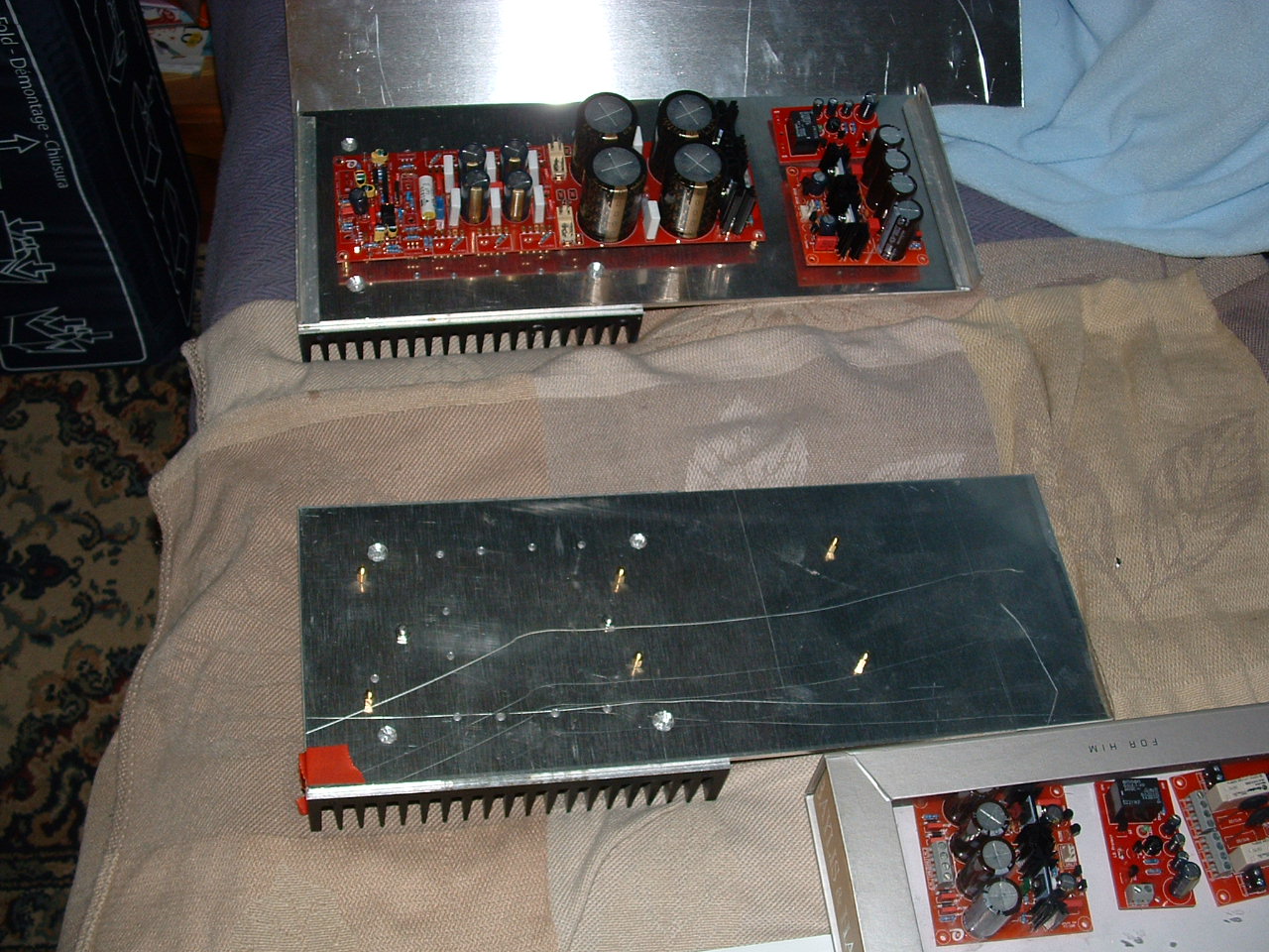

Hi My case is starting to look very similar to Rudi s,,,;) I am missing a few parts that should come this week and for one of my shunts that will not work regards john

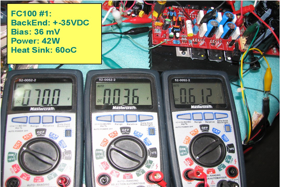

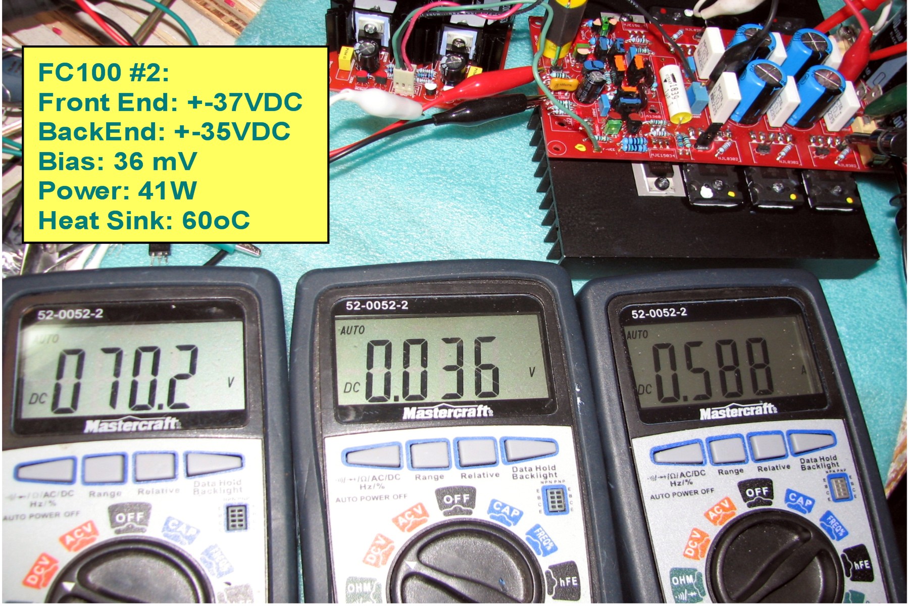

Hi, Rudi. Had a productive weekend. Adjusted both boards without problems finally! (See photos). Now, onto bigger heat sinks and appropriate enclosure. Oh yes, the sound is great and lots of oomphhhhh into 8 ohms. Thanks for all the help on this project. Another great build. Looking forward to the next...
Jean

Jean: very nice to see that you replaced the "round" LEDs by square ones to maintain the thermal compound.
Does the ThermalTrak - diode chain consist of 5 active diodes?
It will be very, very hard (at least in my ears) to beat the sound of your FC-100!
So go on and give it adequate heatsinks and a nice case!
Thank you very much for the pictures that you published - I like them!
Best regards - enjoy the sound - Rudi
Thanks Rudi. There is just 1 of the MJE0302 shorted on each board so the bias shown is with 5 active diodes - right where it should be just like you said! No need for a BAT42.

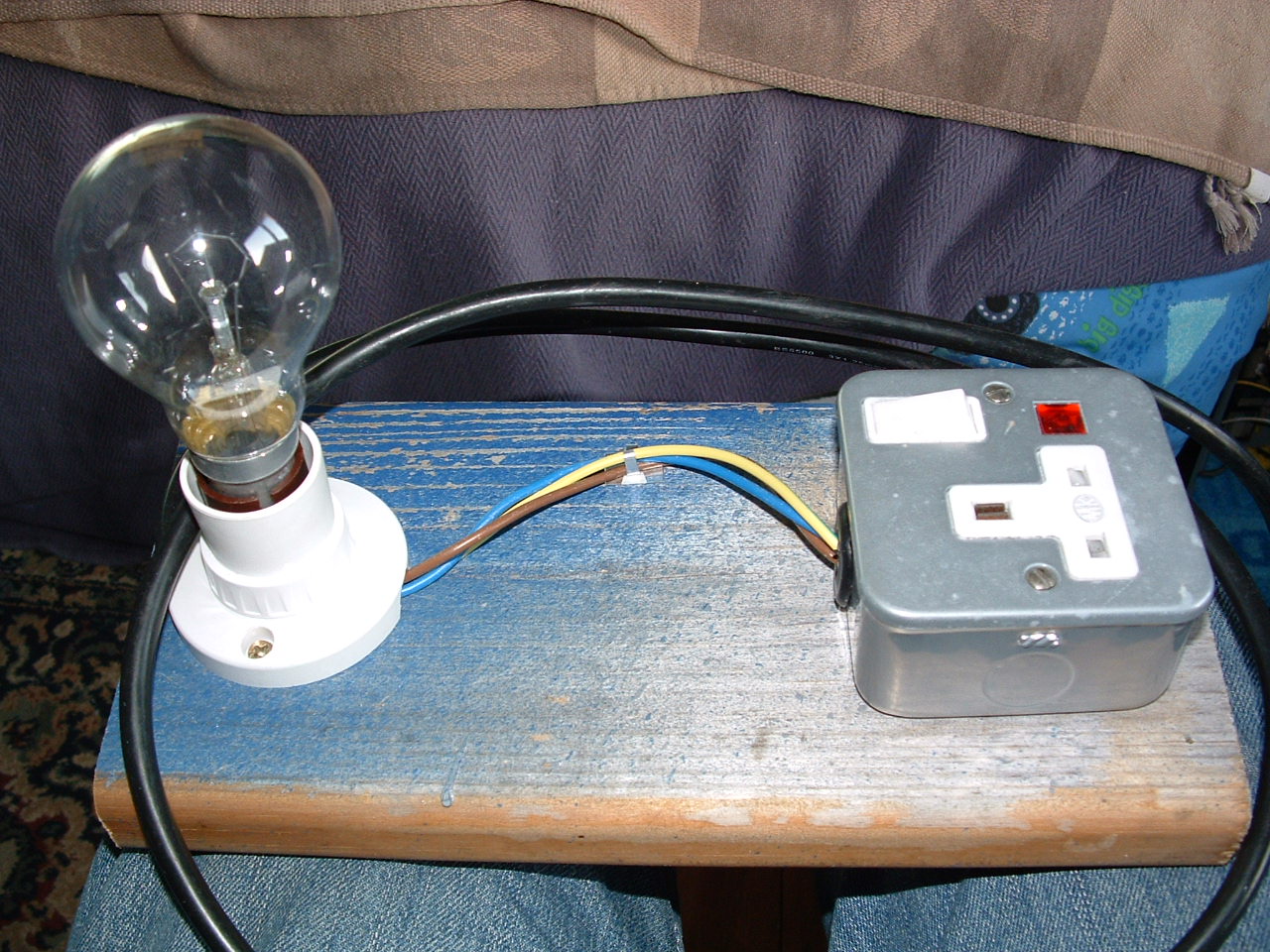

lucylu, It appears something is amiss as these supplies should only take a few VA from the mains. Concentrate on fundamentals initially.
Any signs of life such as LED's glowing?
Make sure you have the rectifier diodes in the right way round.
Same with the electro capacitors.
Reverse polarised capacitors can be a health hazard! They may start hissing, followed shortly after by exploding. Eye protection is recommended.
See if you can measure any DC Volts between each supply and 0 Volts. The 2.2 ohm resistors may be a convenient place to measure.
When you conclude there are no reverse polarity issues we can relax a bit. The 2.2 ohm resistors can behave as fuses, as I have discovered.
Please report your findings.

the shunt regulator draws a constant current from the PSU. About 50mA.
This is a significant load, bigger than some ClassAB power amplifiers when biased.
Check voltage and particularly polarities of voltages when the bulb is glowing.
Expect the voltage at the PSU to be <half the normal voltage.
When you are sure there are no catastrophic errors, use a higher wattage bulb to allow a higher transformer primary current to flow. This may just allow the PSU & regulator to reach >90% of normal voltage. If all is OK so far, then direct online powering comes next.
Remember that a shunt regulator dissipates all it's heat in the components. It gets hot.
45V @ 50mA for two polarities is 4.5W, that is a lot of heating.
Once you connect the front end the 21mA going into the amplifier you save 1.7W of heating. The heatsink should be noticeably cooler.

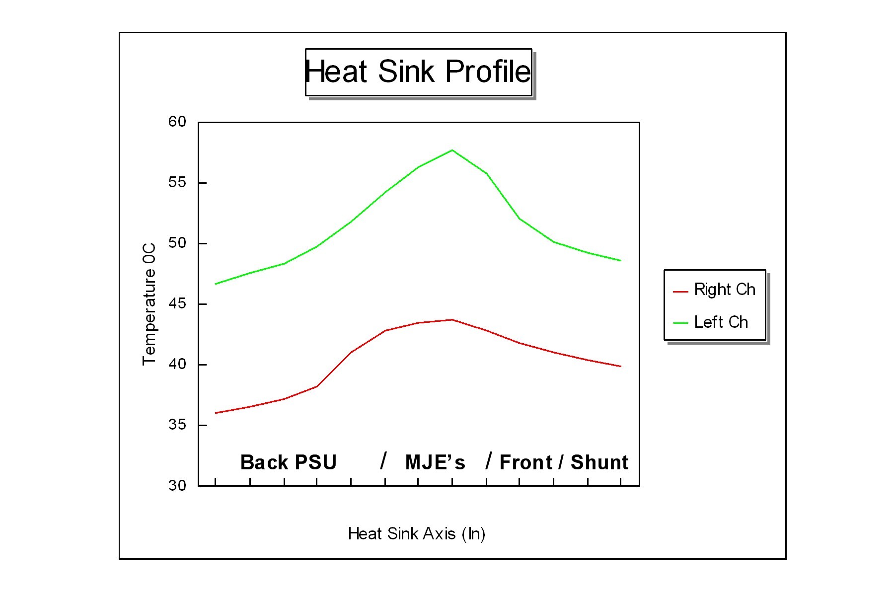

Further to my post #587, I moved to bigger heatsinks (25x150x350mm) and get different temperature profiles for each channel (see pic). One channel is running much hotter (or much cooler!) even though back end VDC is +-35, front end shunt is +-37 VDC, both biased @ 36mA and DC offset only +-0 to 3mV. The heat is from the MJE's. Is this difference normal for Thermatraks or is there a problem somewhere on one board ??? Amp sounds fine. Appreciate any input.
Jean

Hi, Roender. Here are the values for R5:
Left Ch: 15.9 Ohms @ 1.09 V (Back PSU=34.3V, Shunt=37.4V)
Right Ch: 15.9 Ohms & 1.17 V (Back PSU=34.5V, Shunt=37.6V)
In the thermal profile, the heat comes of course from the NJL's not the MJE's as I mistakenly said...
As I mentioned in earlier posts, I did have some trouble in finally adjusting the right ch., I had one bad 2SA1360 which I replaced. Perhaps, some fault in others although they tested okay???
