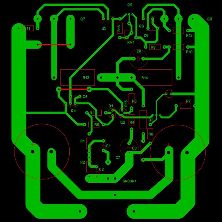

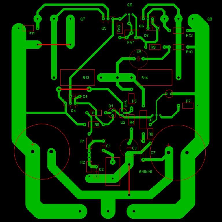

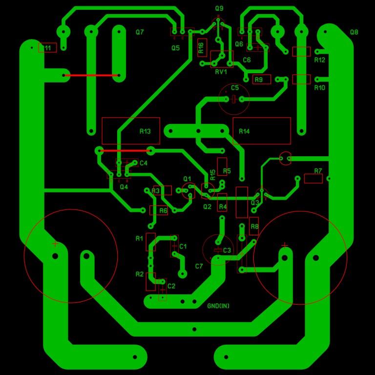

Bringing the big capacitors in the middle will be very fussy!! Don't you think so??!
The signal section will sit right in the middle of two big half-winding loops (follow the main current paths!), but many designs follow this basic layout and still works.

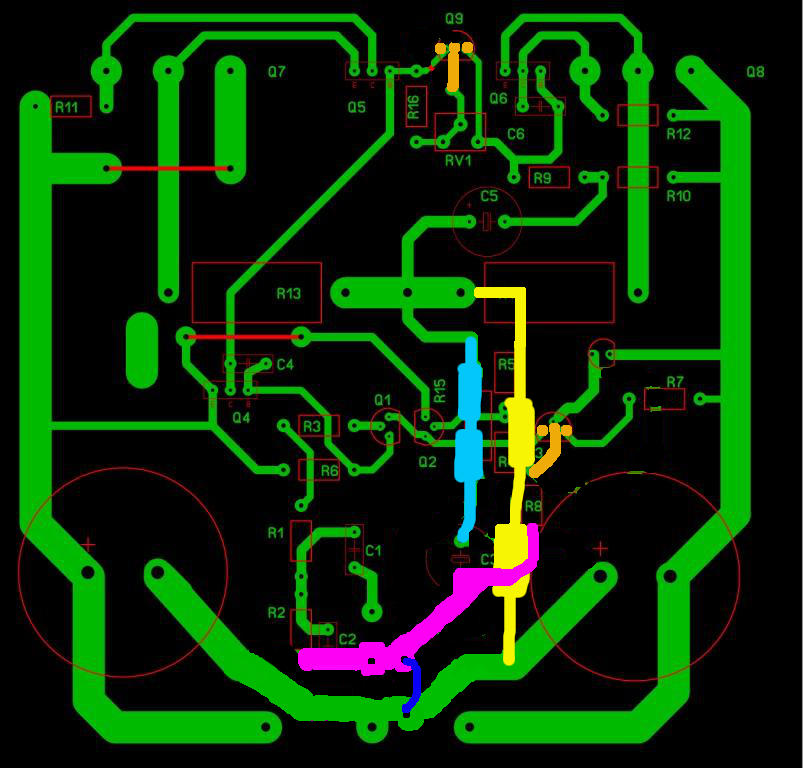

For the rest see the image attached (please forgive the kindergarten art...)
The zobel C7/R15 should go in the yellow line.
R4/R5 in the light-blue line, keep traces connected to the bases of Q1/Q2 short.
The purple traces will be the clean "signal ground".
Blue is a jumper that would connect to the power ground.
This could also be a 10 ohm resistor to alleviate possible ground loops.
Or better yet, a wire that connects to the main star ground together with the grounds of the other channels and the grounds of the power supply and speakers.
For the small TO92 transistors, you should have the option in your CAD package to have the pins inline as shown in orange.
These are often easier to route and also allows you to bend the transistor once soldered (e.g. for thermal contact).
You have a lot of space on that board, you could make all the thick traces double of what they are now.
I do have the TO92 with inline pins, but i cannot allign the traces with the pads on the TO92s. I had a doubt, why can't we connect the signal ground to the power ground with the trace? Why a jumper??
I have attached the new layout. Thanks and Regards
You can put a trace instead of a jumper.
But using a jumper gives you the flexibility later to replace it with a resistor or to put a separate signal ground wire to the central star ground.
Both measures will improve the amp somewhat.
Note that you miss a main ground connection now...
Try adjusting the editing grid or try the shift/alt/ctrl keys to place a track off the grid to use the inline TO92 package.

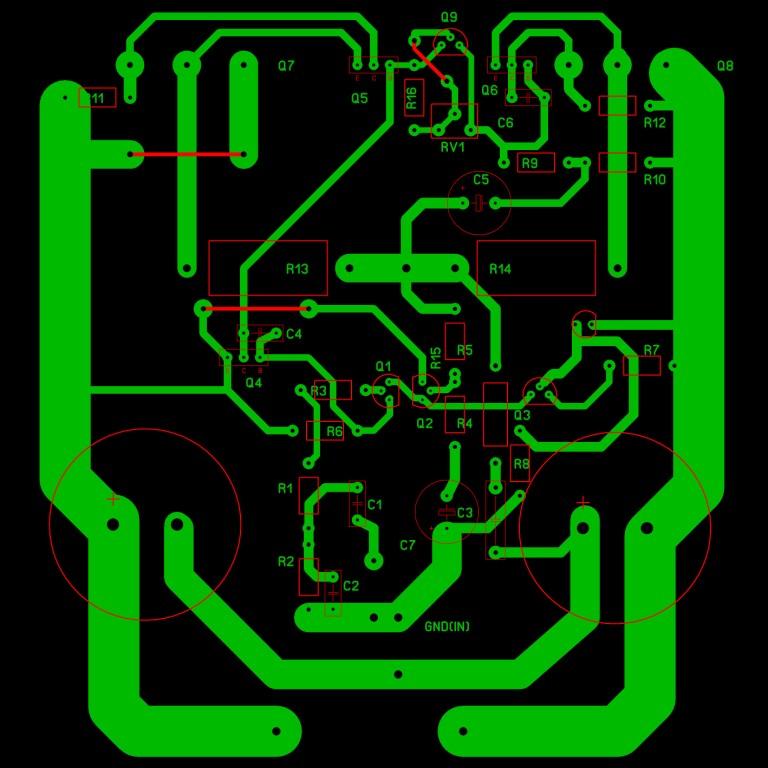

CTRL did the work....thanks!
Is it worth to be the final layout?
You need a pad on the main ground for the main ground wire, see my sketch of yesterday.
Count them:
Three thick wires coming in from the power supply and star ground: V+, V-, GND.
Two thin wires coming in from signal input connector: Signal, GND.
Possibly a (thin) wire from the star ground to signal GND (or just a jumper as previously discussed).
Count them:

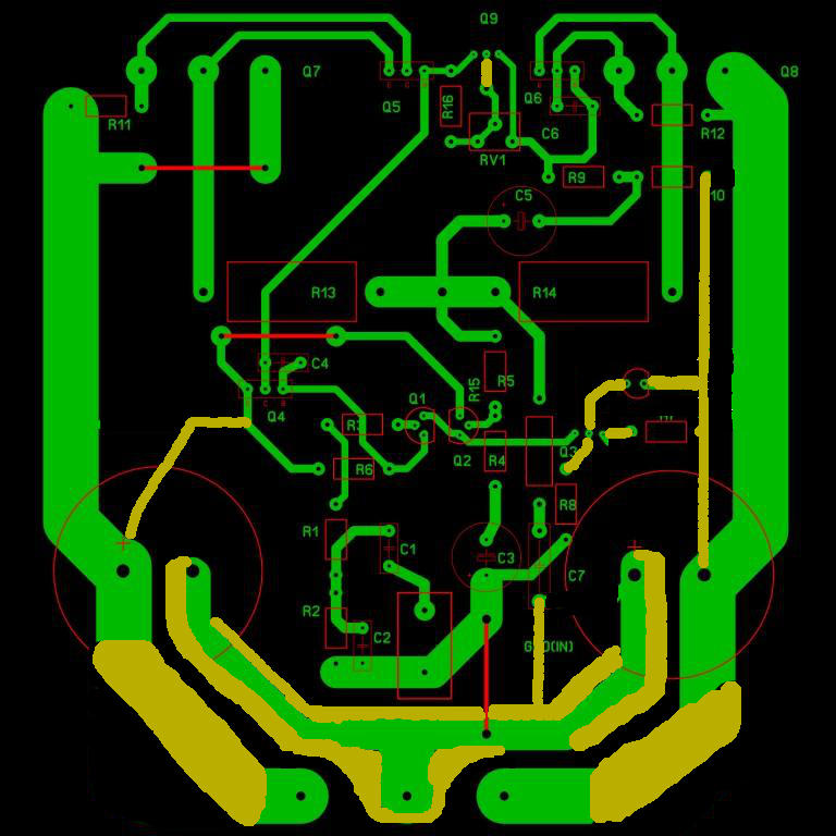

Many little irritations, but the basics are there and assuming the layout respects the circuit schematic and your mechanical arrangement, it will work.
The attachment shows a few more suggestions in yellow.
Try to keep tracks 0.04" (1mm) or thicker if you will make the PCB at home.
Make pads as big as possible to allow for holes not drilled center and for eventual component replacement without PCB damage.
.....The attachment shows more suggestions.....

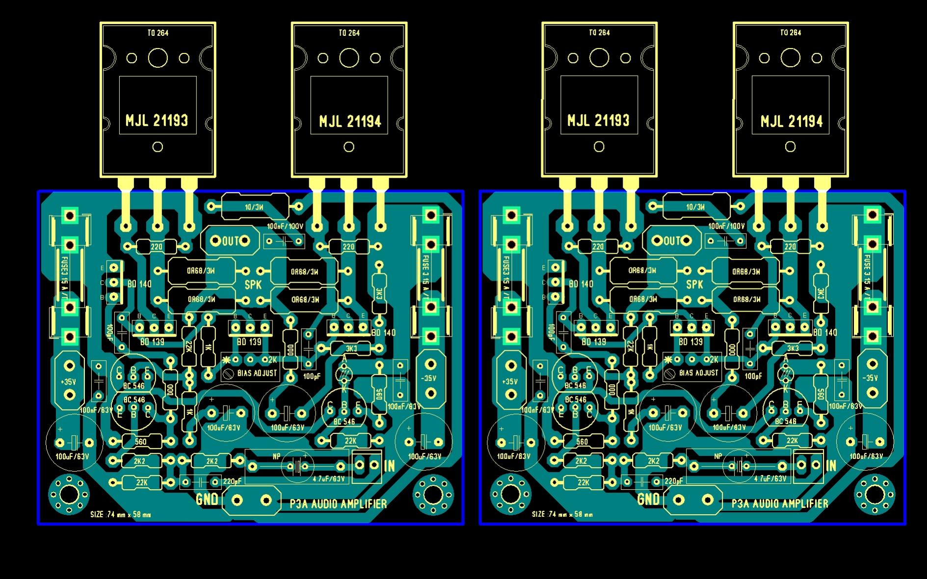

Neat and complete, as usual, Mr. Alex. Long awaited...
Thank you!
alex mm, your pcb designs are works of art

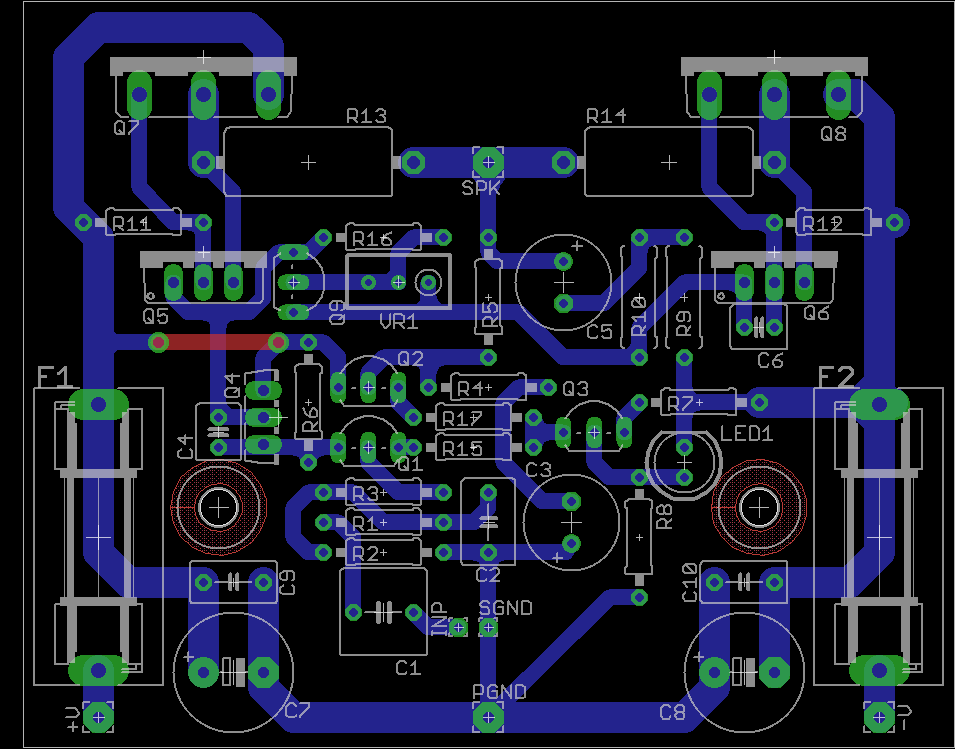

Here's my take on it, from a while ago. Note that I cheated and left the output Zobel off of the board - mine was across the speaker terminals which worked OK. I also added R15 and R17 emitter resistors in the LTP to try this out - but they can be treated as jumpers to stick with the original design. I used a BD140 as the VAS Q4

MR ALEX....!
Your work is really VERY IMPRESSIVE!
Really professional work....!!
Thank your for sharing your layout!
Can you tell me what software have you used for making the layout??

Nice board layout. Regarding: "I also added R15 and R17 emitter resistors in the LTP . . .", what were the performance results of this change? Adding emitter degeneration in the IPS should improve THD at high frequencies, but might also degrade performance at low frequencies. What was your experience?
npdot, at the time I was still learning about power amps, and while i thought it sounded better with 100 ohm emitter degeneration resistors, i don't own any equipment to measure THD or anything like that. It did on the other hand make the pcb layout a bit easier as you can see
paranoid06, it took me about 6 goes to get that layout, as it was my first PCB design in EAGLE. Expect to have to do it a few times before you get good at it. I don't generally share the design out of respect for Rod - many times I was asked "why don't you just buy Rod's boards?" including once by Rod himself. My answer was I wanted to learn how to do a PCB, which he was happy with. I don't intend to cut into his income though.

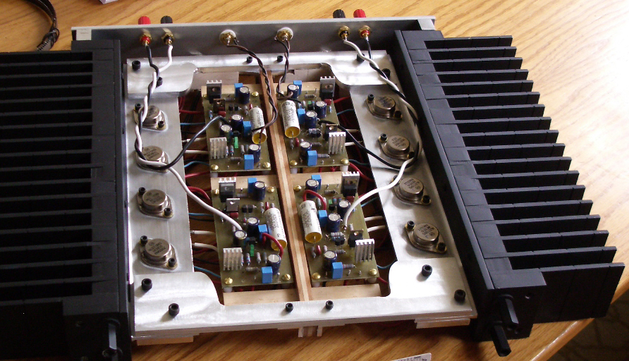

beyond all the above ... for example my choice is to put rail capacitors on board that also cannot be made with rods pcb
