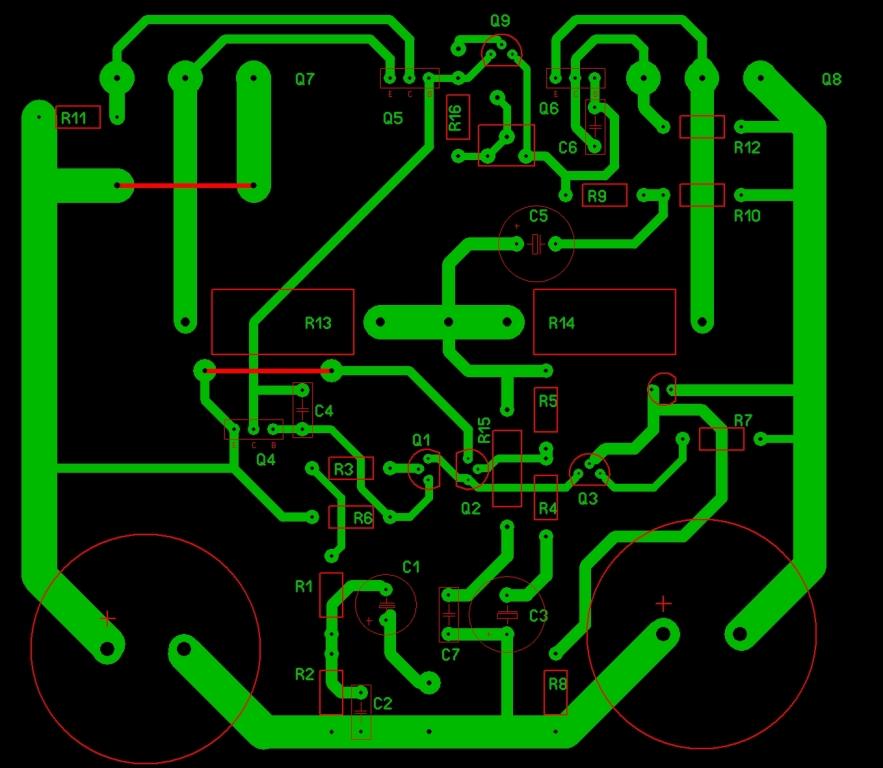

well ...it seems that from the things i told you you have done almost nothing.....
your pcb will work ( produce sound) as is as i said if you are aiming to really high quality sound this pcb cannot go there
jay cee has given you also some useful advice....
--- you use a jumper to supply Q1-2 which is actually ok but proximity between traces is not right .... you can actually do that better
--- Making such a big circle around + rail around the power transistor is not OK ...better with a jumper
--- you forgot to relocate C6
--- you was advised to make Q1-2 go face to face .... it works better for mechanical reasons not one behind the other
--- you was advised to move Q9 close to the driver
--- Finally the all pcb can be rearranged to be more more clean and reorganized see how others did and see what you like to keep

Get hold of Randy Slone's book "High Power Audio Amplifier Construction Manual" and look at the figure 11-1 project. It is based upon the original proven circuit from the Hitachi databook. There is a PCB layout as well.
Thanks, i'll surely go for it.

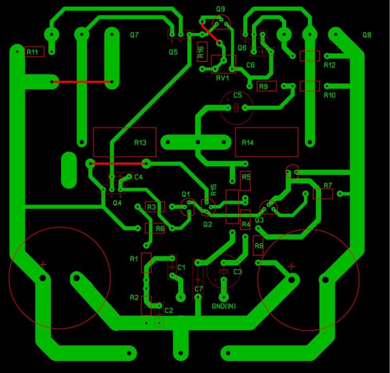

I've uploaded the new layout. Made it taking reference from your layout.

I did not check the circuit for accuracy, but here are a few obvious things:
- C7 and C3 cannot share the same thin track down to ground. C3 is signal and should connect directly on the incoming signal ground point.
- C4 and C6 should be rotated to have very short tracks to Q4/Q6.
- There are no power connection points and fuses?
- There are two unused pads around Q9?
- A film capacitor is much more preferred for C1. A square box MKS/MKT type with 5mm lead spacing will fit in the same space.
- C7 is usually a 250V unit, it will be physically bigger than shown.
- Try to move R15/C7 a little bit away from the sensitive signal devices on the board. At least switch position with R5/R4/C3.
- R8 could be next to R4 with the ground track running straight down, removing the convoluted track between Q3 and R8.
- I would move the big power capacitors closer to Q7 and Q8 and run the main ground through the middle of the board. This would get the signal section outside of the loop formed by the power rails, R13/R14 and the main ground track. This may add 2 or 3 jumpers.
It is progressing nicely though!

Bringing the big capacitors in the middle will be very fussy!! Don't you think so??!
Don't worry, i remember that I have to apply power to the amp!
The fuses will be on another board or maybe in the circular fuse holders, user replaceable ones.
The two empty pads around Q9 was a jumper.Forgot to show it!
I have attached the edited layout.
Thanks and Regards
