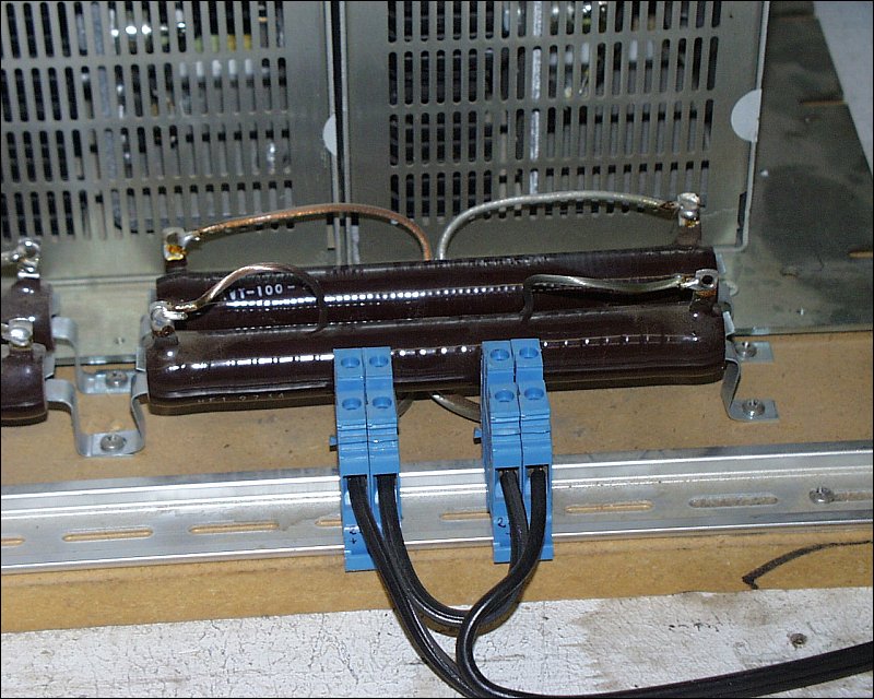

The type of resistor determines what it can withstand. The large brown cylindrical resistors are rated to withstand 10x rated power for 5 seconds. The type in the gold aluminum housings tend to handle far less power, even if on a heatsink. Wirewound are the most tolerant. Fan cool these from the end (forcing air through the core) if you use them for long term testing.

Speakers aren't good for testing power because they're not a fixed resistance/impedance. You could test in the vehicle with dummy loads.
50 amps isn't enough to test for power for more than about 500w class D. It's perfectly fine to test with music when bench-testing the amp to confirm that it's repaired.
Don't do more than you normally do (testing) but if you do, I'd be interested in the results.
One more thing on dummy loads, for long term bench-testing, only go down to 2x the lowest rated power. They are tougher on the amp than speakers. A 2 ohm dummy load on a 1 ohm amp is plenty to tell if the amp is properly repaired.
