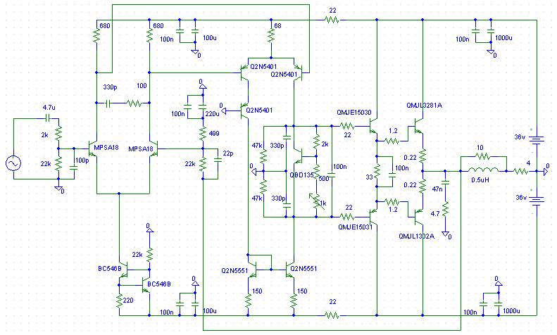

I pointed out the symasym thread, partly because it incorporates some of Mihai's design input, uses more readily available parts, can use a single output pair and partly because there is some group buy activity on boards. Search the forums, if you are interested in that.
But if you really want to build this amp, then go for it. I bought the boards as part of an earlier group buy. Maybe someone has an extra pair. If not, the files for the boards are in the first few pages of the thread. You can have them made by Hugh's source. Were I to use it as a tweeter amp, I'd be tempted to mount the six output transistors, but leave out the base stopper and emitter resistor for Q2/25/4/27. That way you can still use the diodes for bias but only use the output from a single pair. Later, if you need the full power, just add the base and emitter resistors (assuming adequate heat sinking).

did anybody try to modify thje design to use 2SC5200/2SA1943 ?
CAn anybody tell the experience or share the design. How to integrate or design the mentioned Vbe multiplier.
I'm no expert, so I would seek confirmation for what I say. That said, I think you can replace the diode string with a typical VBE multiplier. Here's the version on the Symasym (which I have built): http://www.diyaudio.com/forums/atta...signed-michael-bittner-our-mikeb-symasym4.gif
If you look closely, you can see that you just replace the diode string, with a transistor and voltage divider. The rest of the circuit is very much the same. The only difference is that the FC100 uses a 15pf cap divider to the ground leg, while the Symasym uses 330pf caps paralleled with 47k resistors. If I were to try it, I would just replace the diode string with the Bd135 and it's resistive divider, and leave everything else as is. Of course, the VBE multiplier transistor must be located on the heatsink with the output transistors. Good approach is to fasten it directly on top of one of the outputs.

In case Mihai broke some body parts again, you sure you're not confusing the powersupply schematic with the BOM of the amp ?
Nope, checked it again:
http://www.diyaudio.com/forums/atta...gle-stage-audio-power-amplifier-rmi-fc100.zip
Unless there is a corrected .sch later in the thread.
Not sure where that comes from, and I can't open it. But the schematic and BOM are in the first few pages of the thread. Q4/5 are output transistors. No BD139 parts in the amp. That part is used in the front end powersupply, but it's labeled T2.
