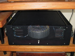

Finished up the second one. More typical layout, which works fine. Able to adjust transformer position to give low noise - no hum at speaker (100dB+).
A few have expressed concern about the complexity of the amp, and the resulting build difficulty. I would say that it not more difficult to build, just more parts to mount. The most difficult thing is matching the devices. Not too much problem with the signal or driver parts, as a battery operated jig is easy to construct, that will run them at voltages and currents something near the order of magnitude that they will see in the circuit. The outputs are a different story, because they require a lot more current. I had a problem with a couple of devices that looked close with my test (at 12V and lower current) that biased at more than double their mates, so I had to find better matches. Removing and replacing them was a pain, to say the least.
Were I to do it again, I would not solder in the output devices, but just slide them in, and use a small wire to wedge the pins snugly into the board. Then I set the bias under actual operating conditions. At this point it would be tedious, but fairly simple to switch parts.
A couple of points: Of the three parallel output parts, take the one that biases the highest and use it in one of the outside positions, as the center position will run a little hotter and bias up higher anyway. Also, check the diode voltage drop for the parts. If one is higher than the other 5, bypass that one. I had a high one, and if I used it in the bias string, I could barely get the bias low enough.
I may dress up the front with some nice wood, but here's the basic unit.
