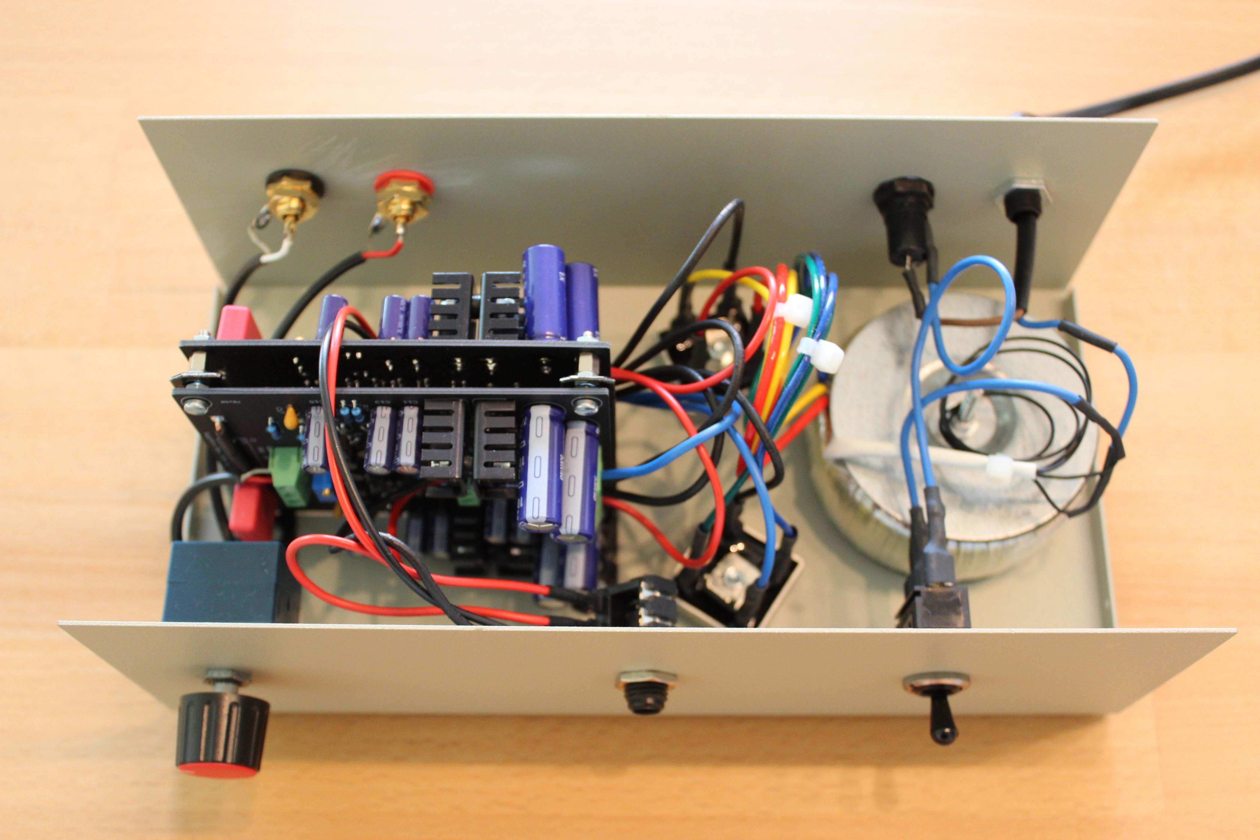

R3/R2 - so you mean you have the buffer open loop then? That's another tweak option, in addition to the coupling cap.
If I ask nicely can you post photos? :D
Attached is a photo of my Sapphire. The case I used is rather small so I mounted the boards vertically. It was previously used for another headphone amp (Sjostromaudio QRV-08) for which it was a perfect fit.
Judging from the way how much I liked the Sapphire until now, I think it will get a "proper" case soon.
Concerning R3: Yes, it's open loop.
