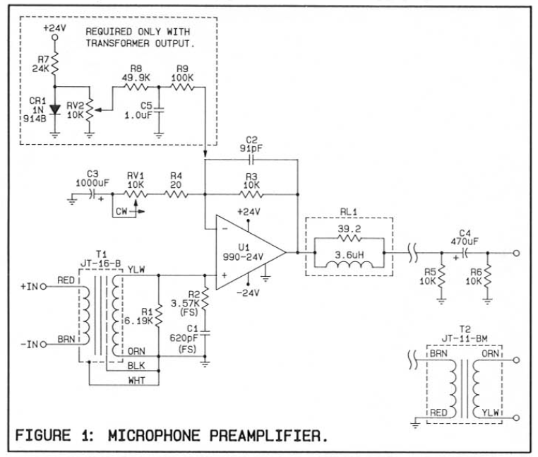

If the following changes are made -
The bias compensation circuits is described as part of the traditional Microphone Preamp, Figure 1.

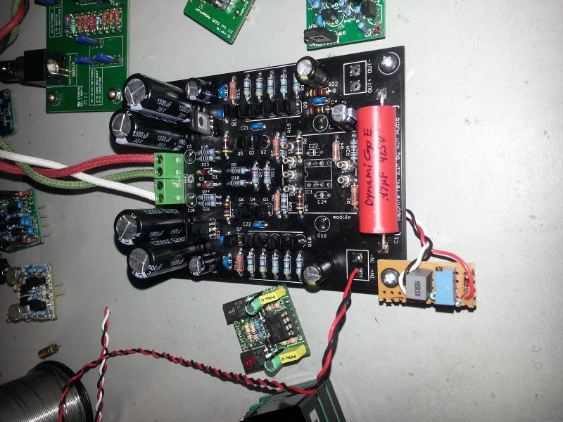

I tried the following opamps and it seems to work fine, they can be tuned to under 10 mv on the output, even under 1 mv, no warm up needed -
It does not work for Sparkos' SS3601. That sits at 200mv (stable) and seems to pop up to 2V on turn-off. Perhaps Sparkos could suggest why?
On turn-on, the meter didn't catch anything. On turn-off, they all acted the same - decayed, drifted up to 100 mv, then dropped down to -300 mv
and sat, even the opa134. Perhaps because there was no load or that I was using bench supplies to power them.
I still need to build the DIY-990 and SG-SOA-2...
Setup - just sitting on the bench, only one channel channel modified. The attached pot is a 10K TKD. Power provided by a couple of Kenwood bench supplies at +/- 15V. No load on the output. Sine and square waves look ok with the JE-918, the JLM-Hybrid rolls of the square wave, perhaps my setup or the 47pf that I added across R4.
Once the second channel is modified, it'll be the dreaded chassis drilling...
- Add a 330uF 25V cap to bottom of R3/R3a - I used the SW1 pads.
- Add the simple bios compensation circuit from John Hardy's 990.pdf.
- JE-918
- DOA-17 (FiveFish)
- JLM-Hybrid (OPA2604, and the servo kicks in)
- OPA2134
- AD797
- SA5534A (though it's limited - 20 mv)
Cool! Thanks so much for doing the hard work on this.
To confirm, the additional bias correction circuit is the part marked "required only with transformer output" in the attached figure?
I get from your results that everything but the SS3601 could be tamed by the input current cancellation circuit. By the way, a few hundred mV on turnoff is relatively common and I wouldn't see anything under 1-2 V as a problem. Likewise a stable operating offset of 50 mV or less is fine - there's no real reason to get terribly worried until its well above 100 mV.
Yes, that's the circuit I used.

Do I understand correctly that you're not populating both R3 and R3a, but using one value in the R3a position with the 330uF cap between it and ground in the SW1 holes? And you'd like the cap to be more like 1000uF instead of 330uF.
Correct. It's mostly academic as a 330 uF has a corner frequency of around 0.3 Hz with the current R3a of 1.5K. However, 330 uF is a bit of an odd value and a 1,000 uF would allow using the same caps as is already in the power supply while dropping the corner frequency down to 0.1 Hz.

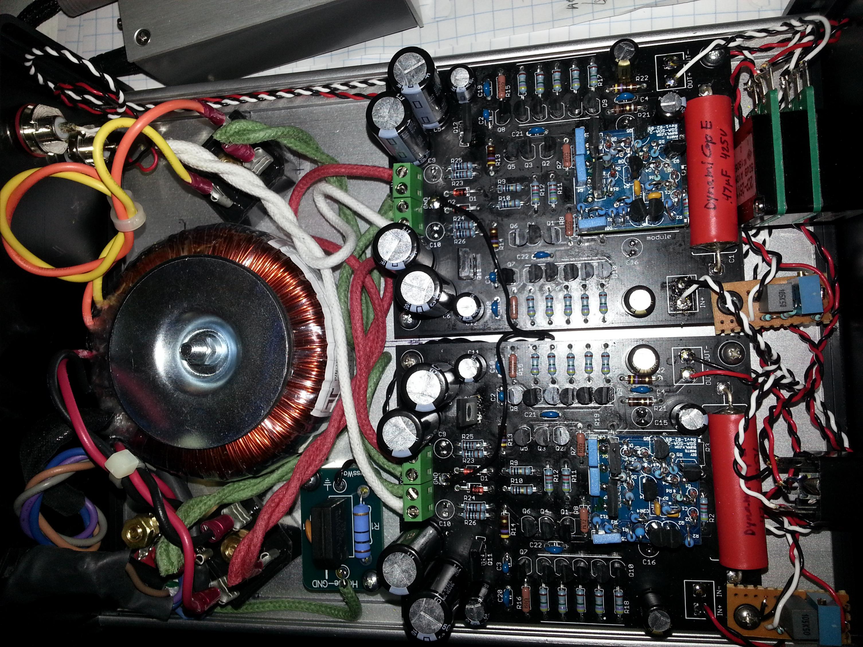

Completed the headphone amp this evening. Set it up using a pair of Sam Groner's SGA-SOA-2 opamps. Off set stabilized around 1 mv after adjustment.
Listening to it, even in the first hour the thing I most noticed was that the bass had more texture to it yet the notes were discrete. While there is harshness in the upper registers - cymbals don't ring due to it not being burned in, and it feels a bit constrained or tight, it's still quite nice overall. Vocals are more forward than I'm used to. The bass though, sometimes, just goes inside where I feel it.
FWIW Headphones are Senn HD-600, Stephan Audiomart Equinox headphone cable, a Schitt Modi 2 Uber DAC feeding it from uncompressed flac files.
