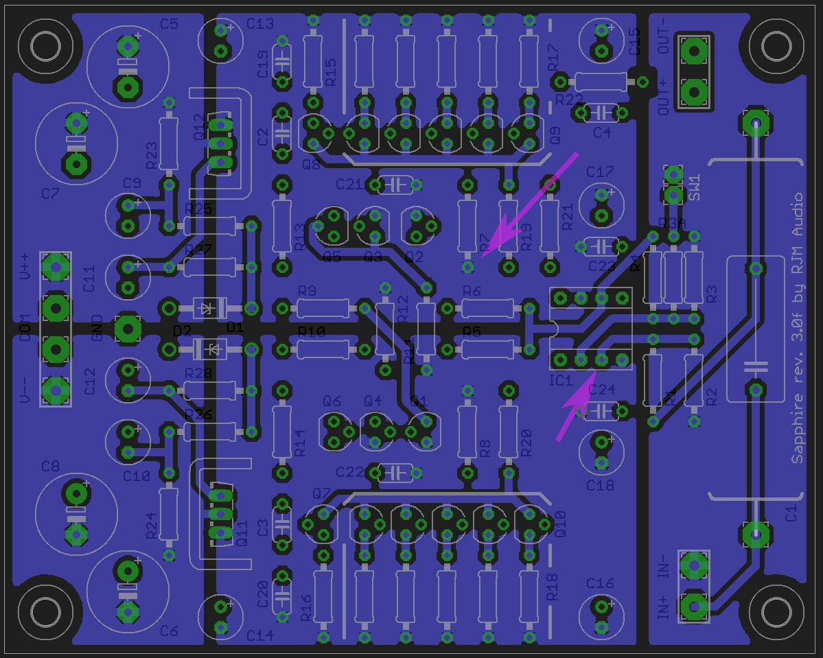

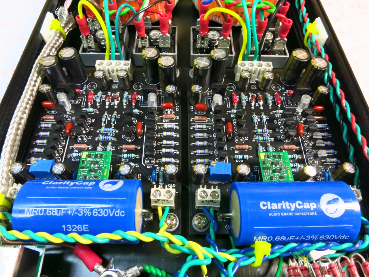

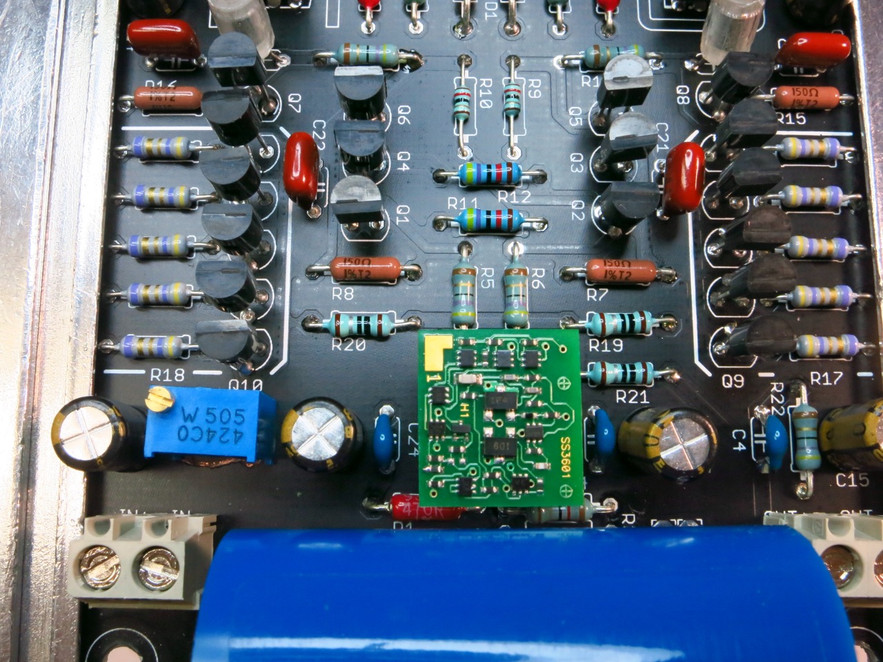

Sparko Labs' SS3601 discrete op amps in place of the OPA134's
I discovered the hard way that these are not quite a drop-in replacement in the Sapphire design, as previous posts will describe. Andrew Sparks was quick to understand the problem and suggested a 2.2M resistor between Op Amp pin 3 and the 12V power rail. After some email discussion, instead, I installed a 5M Bourns 3299 trimmer on some vacant real estate on each Sapphire 3.0f board (between C16 & C18). Not the neatest installation, but it all seems to work. The one thing I’m still wondering about is that it took a long time for the output offset voltage to settle down - an hour. Even so, the values bobble around, sort of +/- 10 or 15 mV, but I set both channels so that each was about 15 mV, +/-. Voltage between op-amp pin 4 and 7 is 10.3 v, rather than 21 V with the OPA134's in place in my build (Richard's kit docs say to expect about 23V pin 4 to pin 7).
Sound is lovely, and with my very first test track I heard something I hadn’t heard before, and hearing it brought me to suddenly realize something about the sound of the OPA134. I’ve read people describe the Burr-Brown sound as dark and I have never perceived it that way - until I heard the SS3601 discrete op amp sing. It is different, I suppose it must be a bit brighter, for lack of a better description. Anyway, with more listening in the last couple of hours since powering it up, I’m extremely pleased with the sound. The OPA134's are not going back in.

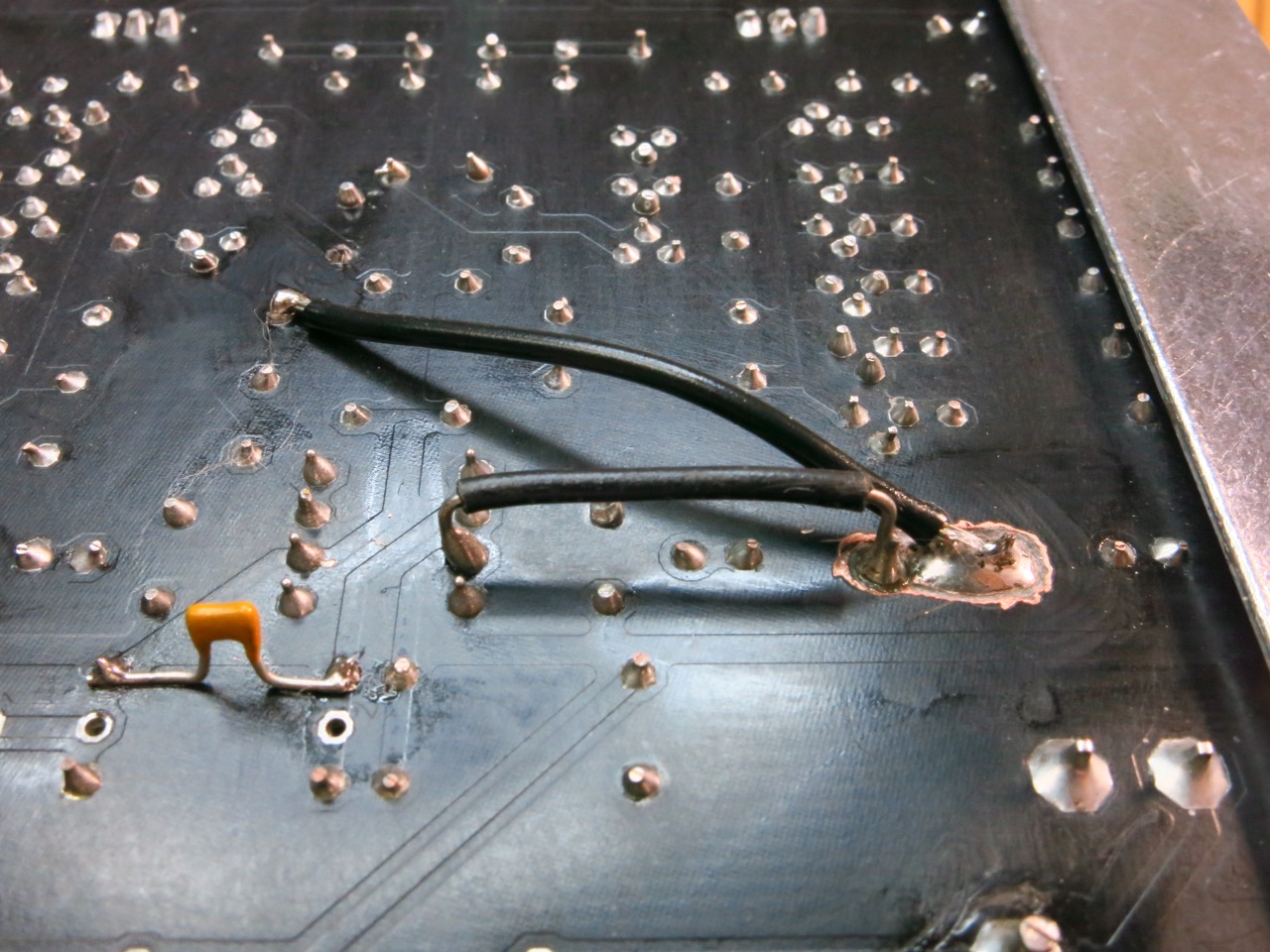

First image shows the underside of a board, with the pot wired between Op Amp pin 3 and the 12V rail at the end of R7 where there is a through-hole contact to the power rail on the top of the board. I used a Dremel diamond bit to cut through the copper foil to isolate the pot contacts from the ground on the board top and bottom.
I re-installed a 22pF cap across the feedback resistor; hedging my bets, really. It’s underneath the board and whether it’s needed or not I figured it wouldn’t hurt and I won’t have to take things apart again to install one if it is needed. I changed R4 to 18K, which matches the gain to my headphones (I had used Richard’s 22k in the kit as ‘close enough', but now the gain is matched to my phones' impedance.

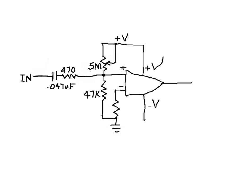

The offset was caused by input bias current. (few uA that flow into the input pins)
The POT simply supplies this current. Before the pot it was pulling it from an R to ground, so it dropped some voltage across that R, making the input not really ground, but slightly negative. The POT is tied to V+ to counter act the slight negative voltage, and bring it all back to zero.
...how the addition of the trimmers actually solved the offset problem?...I'm trying to picture the circuit with the trimmers in my head...
There are others who would answer this more technically than I can, but my understanding of what I've done is that I've added a little over 2 megohms resistance between one of the Op Amp inputs (pin 3) and the power rail to equalize the impedance 'seen' by the two Op Amp inputs. There seemed to be some doubt about the precise value needed, so rather than experiment with different resistors, I installed an adjustable trimmer pot. Once the amp is up to temperature, by adjusting the trim pot you can set the output offset to the desired value, in this case about 15mV. I don't know if it's an audible difference, but my output bias measurements on both channels now match.
On the schematic, the trimmer is between pin 3 of the Op Amp and the power rail connected to the Q12 emitter. R7 is connected to that power rail on the top of the board, and through-hole it is isolated from the foil on the underside of the board. So I extended a wire from one side of the trimmer to that end of R7 on the underside of the board. The location of the trimmer is just one of convenience (ie. where the space exists for it); I had to isolate the trimmer pins from the foil on both sides of the board at the trimmer location I chose, I used a diamond bit on a Dremel tool to cut the foil. On the topside, I removed foil from around the holes drilled; on the underside, I cleaned the black paint off the foil around the holes for soldering the pins. Then I cut a 'moat' around the soldered pins to isolate them. Note that there is also a moat cut through the foil between one terminal pin and the connected wiper and other terminal pin. The trimmer is connected to Sapphire circuitry only by the wires added to the backside of the board.

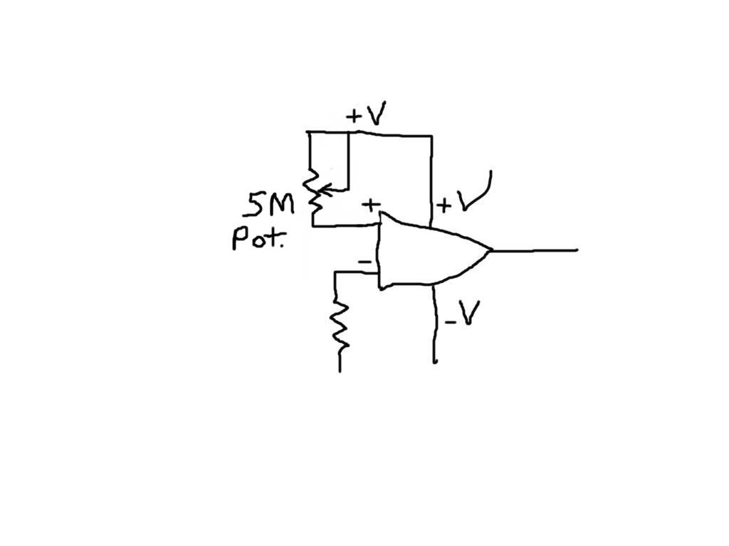

One has to connect the trim pot wiper and one of the trimmer terminals to use it inline like this.
OK, after looking at the schematic it should look more like this.
Interesting that injecting that small voltage on the +input helps so much with the offset.
I assume that method is easier than trying to match the impedance seen by both inputs.
