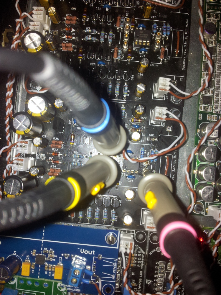

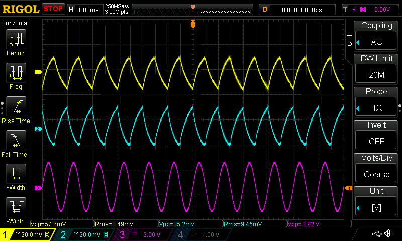

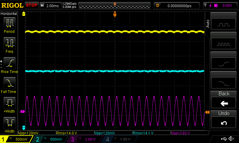

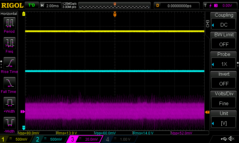

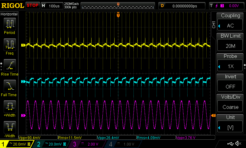

I wanted to see how V-/V+ rails behave when some input signal is applied. First I checked Vpp when no signal is produced. Then 1kHz 0dBFS sine without AC coupling and bandwidth limit enabled on oscilloscope. And afterwards with both enabled to catch details of the ripple. It look like a classical capacitor charging and discharging. What is strange: as I increase input signal frequency asymmetry arises between V+ and V- in terms of Vpp. Is this some kind of measurement error?

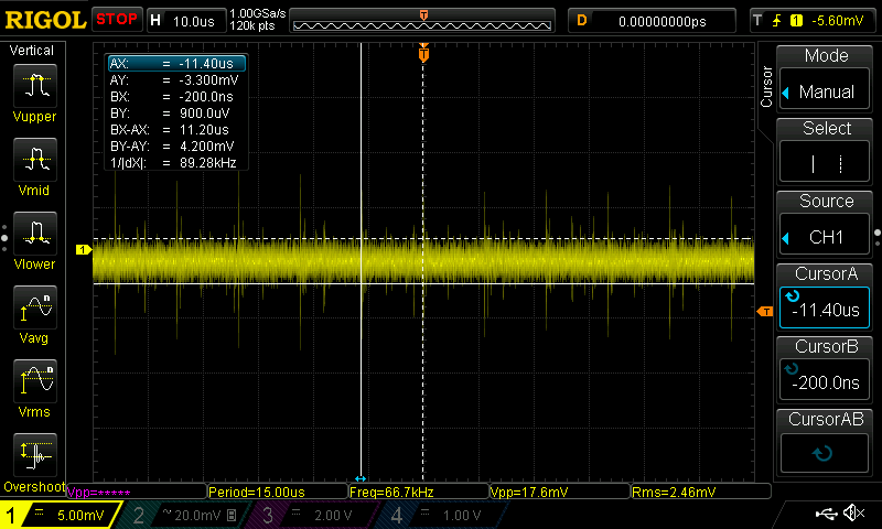

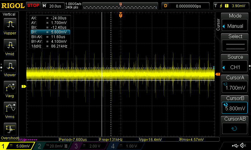

I've also measured the input voltage offset of both opamps. Nominal values are quite good, given that opamps operate without any form of trimming. Only those approx. 90kHz mysterious peaks...
The measurements were done after migrating to higher V+/V- and with 15dB gain.

I can't see any cap charging at the opamp power rails on my unit. The DC is very clean on both channels down to 10x mag of 50 mv setting using a 10x probe. FWIW - I'm using a Tek 2225 50 MHz analog scope.
Base noise on the scope is 5 mv both input and output with random noise spikes. Nothing as steady as you show.
I did build mine with different caps than what was in the kit, but that shouldn't make any difference in the measurements.
Did you apply 1kHz sine wave of a similar level on input during measurements? Also using 10x probe might blur a bit. What's your gain settings?
Btw - I notice in the photo of the amp, the Gnd doesn't seem to be attached. It that soldered on the bottom and run to the chassis ground point?
No, it isn't. Chassis ground is connected to earth ground. I use floating ground for all boards to avoid any complications with noise coming from neutral line and to create Faraday cage.

No, I have no noise when playing music. And I can clearly hear hum on the recordings that have it - it gets panned from right to left. So anything like you show on the scope trace would be audible.
Gain is 20 dB.
As for ground - I use a ground breaker. No hum, works fine. Ground runs from the boards to it and it runs to Earth ground. I was lazy and bought one of John Broskie's kits (don't see them on his web site now). Rod Elliot describes it in this article on grounding.
I'm not convinced whether it is the right way to do measurements as this phenomenon is obviously related to the output signal levels. Assuming that you've listened to music at 95dB SPL (which I think is quite loud) Sapphire should deliver 0.43Vrms to your HD600s; that translates to ~1.2Vpp at headphone amp output. During my tests there was ~4Vpp at input (see purple readings of Vpp), which translates to 20.3Vpp at the output. That's 25dB difference. And then there is an issue of loudness of your tracks. May I suggest using USB DAC and generate signal on PC. e.g.:
$ export AUDIODEV=hw:1,0; play -c 2 -b 24 -r 44100 -n synth sin 1000
Or if you use windows - arta software or similar. Make sure input signal is not attenuated too much.
I'm not really sure whether such drops would be audible either. We're talking about power rails, not output lines after all. But I don't feel competent enough to talk about it though.
PS. Tomorrow I will repeat my measurements.
Too much effort to do all the digital stuff. I hooked up my Panasonic RC oscillator - VP-7201A, set the output for 0 dB @ 1 KHz. Input on the volume pot.
As long as I stayed out of hard clipping, there was no sawtooth on the power supplies. When I went full hard clip, the sawtooth was less than 0.1 V peak-to-peak.
FWIW - hard clip is above +/- 10 Vac given the DC power at the opamp pins is just above +/- 10 Vdc.

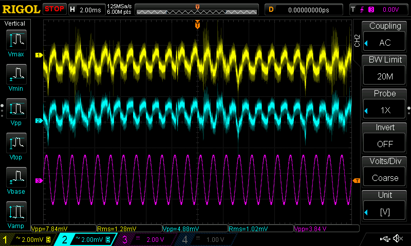

I think I have nailed down the issue. When I repeated measurements in the manner as shown previously, I got the same results. Then I decided to stick input signal probe to the second board and it turned out the order of magnitude of ripple was lowered by 1. Using only one channel of the oscilloscope (to rule out crosstalk at that device) didn't bring any significant improvement.
Power rails in my case enjoy higher voltages (~14V). I've replaced zener diodes.

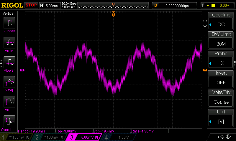

Speaking about grounding and ground breakers... This is what can be seen between earth and neutral lines at randomly selected power plug in my home. Data gathered at midnight or so.
PS. Just to be clear: not that I'm questioning using proper grounding at power amps.

As for noise on the power line, sure that's pretty common unless one is running off-grid using a crystal generated sine wave supply from an inverter. But a refrigerator on the same circuit will destroy that clean power pretty quick
Consider though that if the Gnd on the Sapphire isn't used, where are the diode pulses going to leak into? They aren't going to stay in the small area between the diode bridge and main power caps. Without a path to ground, they'll find a path to ground. Even if it's using signal ground to get there.

The Zreg output V+ and V- will have minimal ripple. I doubt you'd see it in the scope trace unless you used a bandpass filter. I can't remember off the top of my head what it should be, but 5 mV p-p seems about right. (Zreg cuts about 40 dB from V++, and V++ has 2000 uF per rail per channel.) It will vary a little with the current draw of the circuit of course, so a large input signal or unusually large output bias current will cause the ripple to increase slightly.
