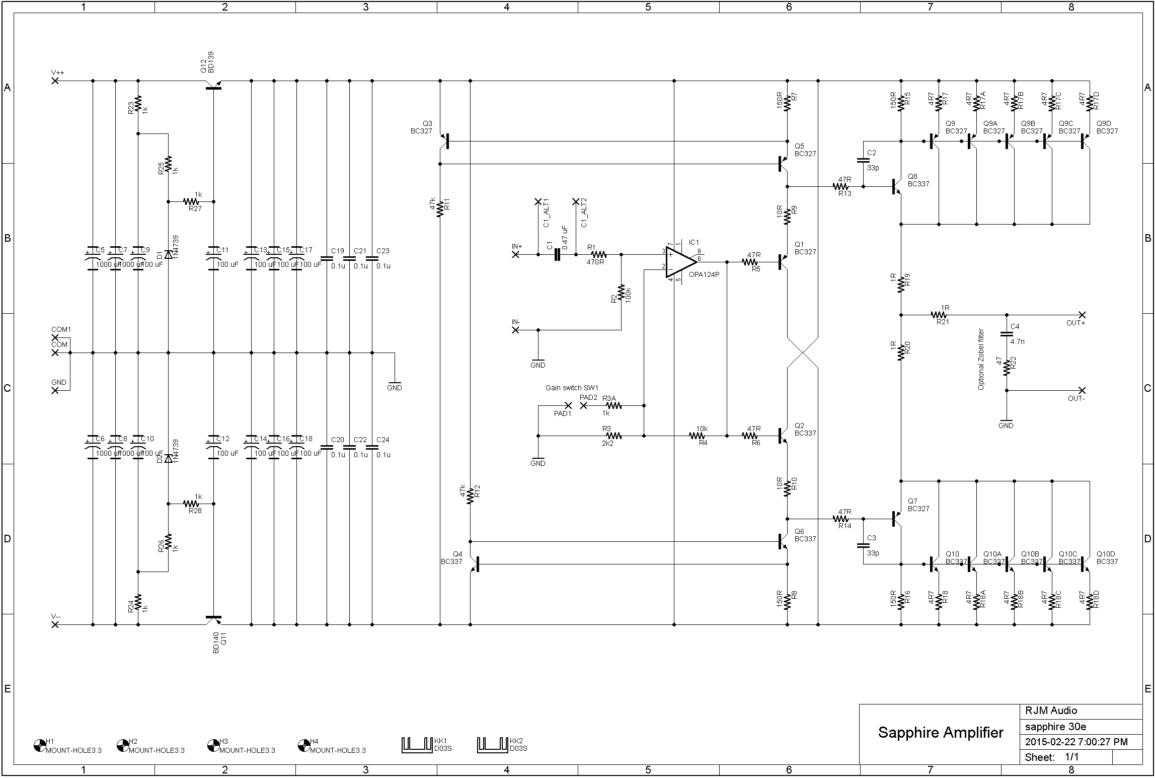

Update to rev 3.0e.
- Changed TO-92 transistors to BC327/BC337.
- Upgraded the Z-reg voltage regulator with additional RC filter, as detailed in this blog post.

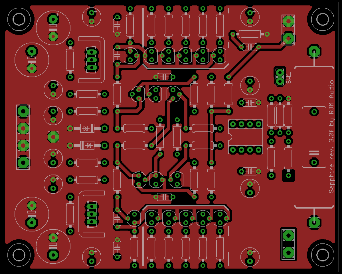

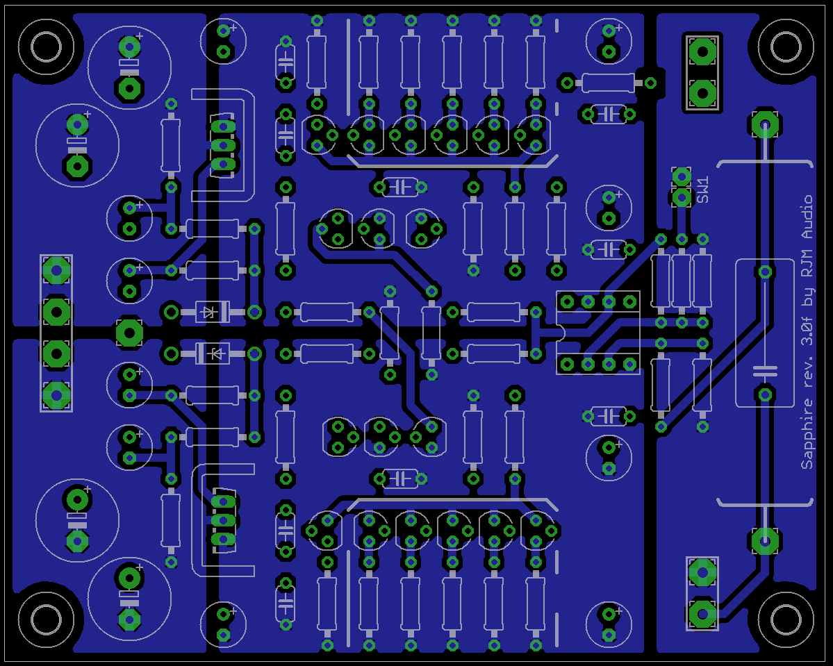

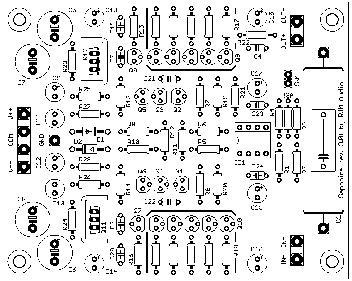

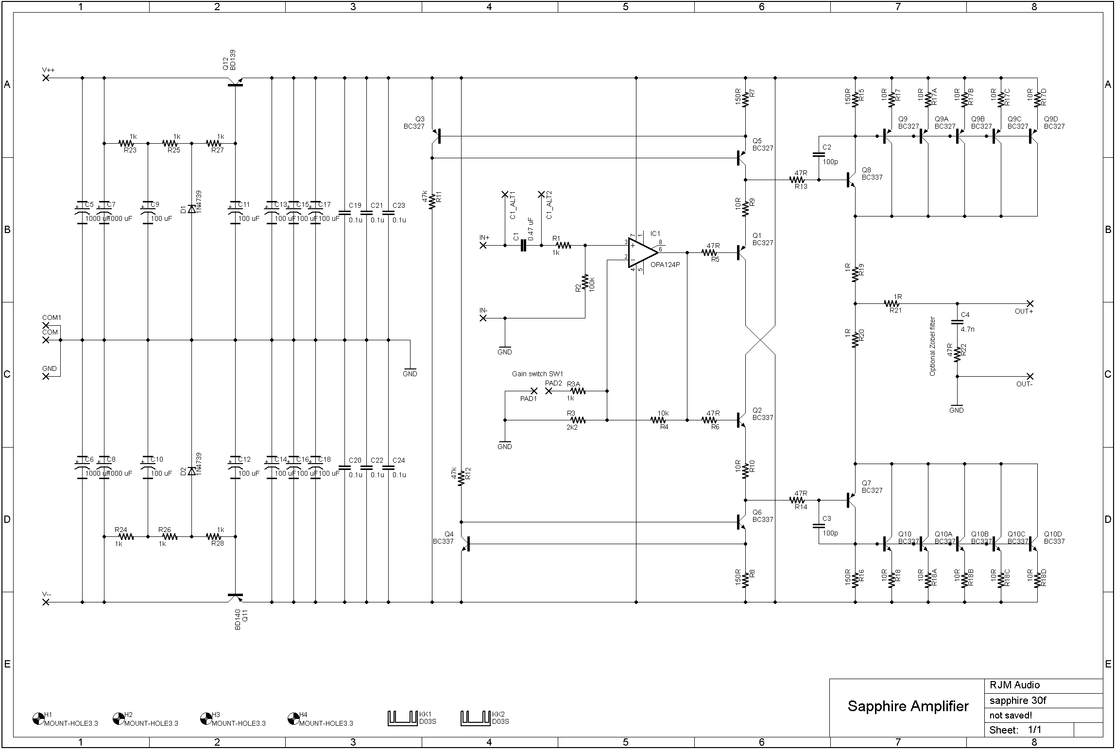

rev 3.0f [production prototype for fabrication]
As per usual, I'm going to get a small batch of these made and inviting "guinea pigs" to join in the fun. $20 for a set of two boards, including shipping. Parts (partial or full kits) available on request. Contact me if interested.

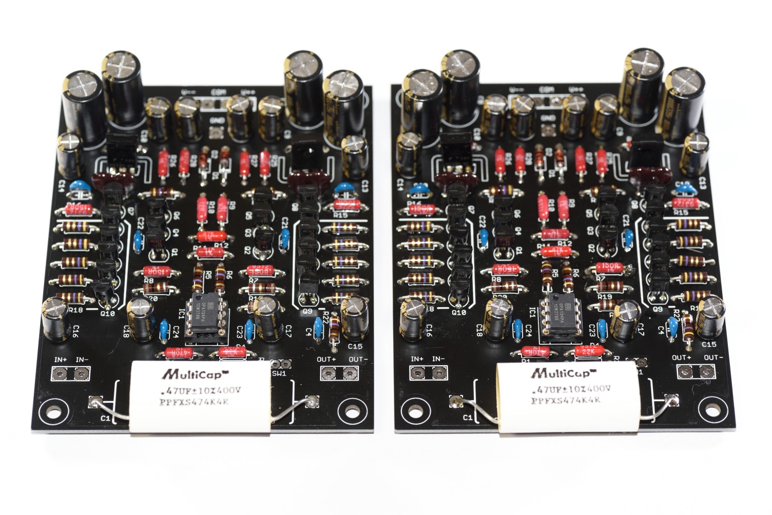

Sapphire 3.0f boards are back from the fab, assembled, and tested OK.
Assembly/test notes:
- Took me two hours of hard work to assemble. The 36 TO-92 transistors were particularly tedious.
- With both the transistors and electrolytics, my technique is to solder one lead, adjust the position (reflow if needed), then solder the remaining leads.
- Voltage drop in mV across R19,20 (1 ohm) gives the total output bias current in mA. I expect about 40 mA and got 40/40 in on board but 62/55 in the other. Took a while to track down the problem as all the voltages seemed correct. Eventually I traced the problem to R7 ... the PRP resistor was labelled 150R but measured 99.2! [Ok, that's the last time I buy PRP resistors! Geez.] I replaced the resistor (all the other ones in the bag were OK) and got 40/40 as expected. Output offset voltage is under 20 mV.
- Will put the boards in my Sapphire amp chassis tomorrow for listening trials.

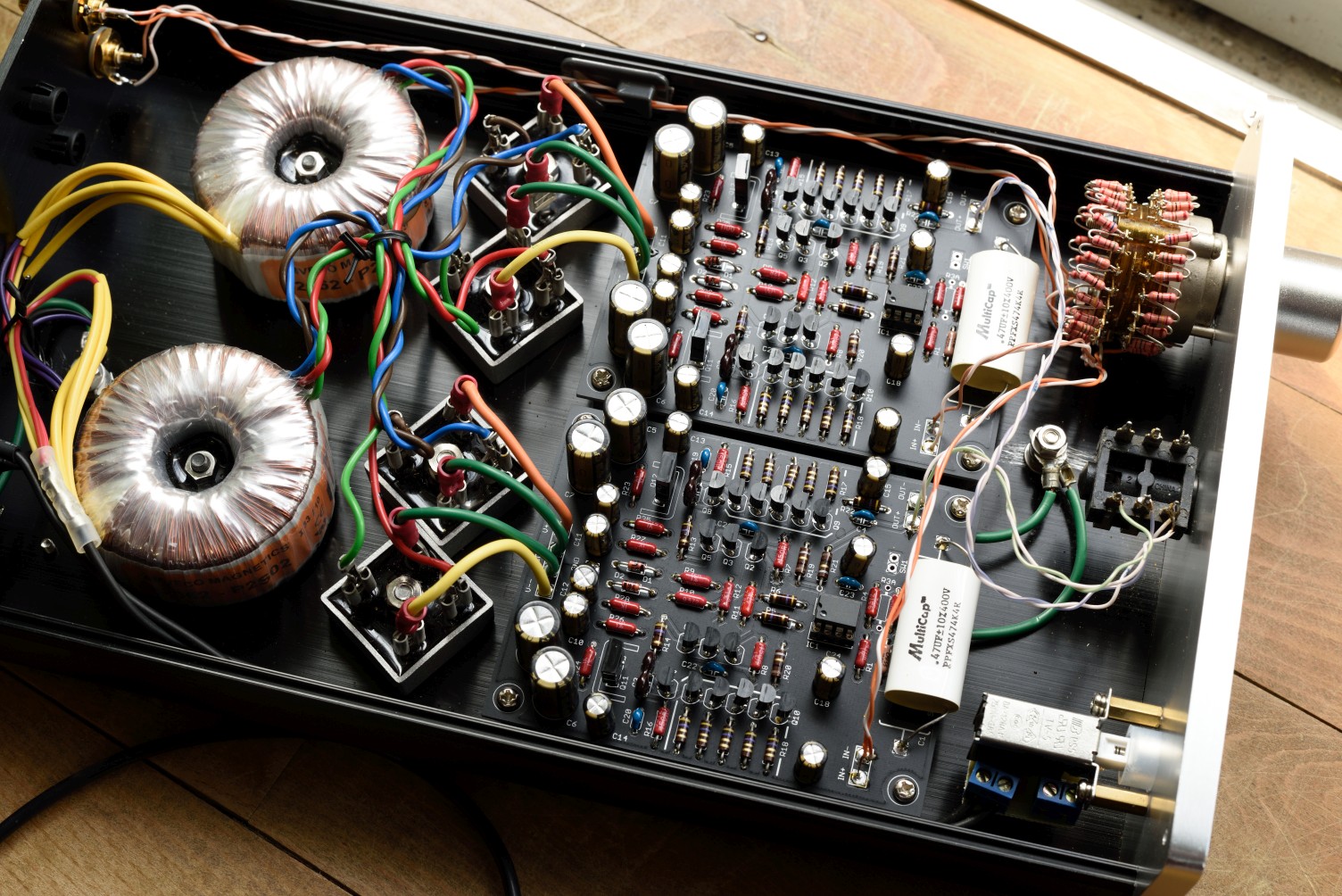

Wired up in the original chassis. (R channel input leads are shown connected backwards, an error I fixed shortly after the photo was taken.)
I did not use R3A or the gain select switch in my build, preferring to have fixed 27 dB gain with R3=1k and R4=22k.
It's breaking in at the moment.

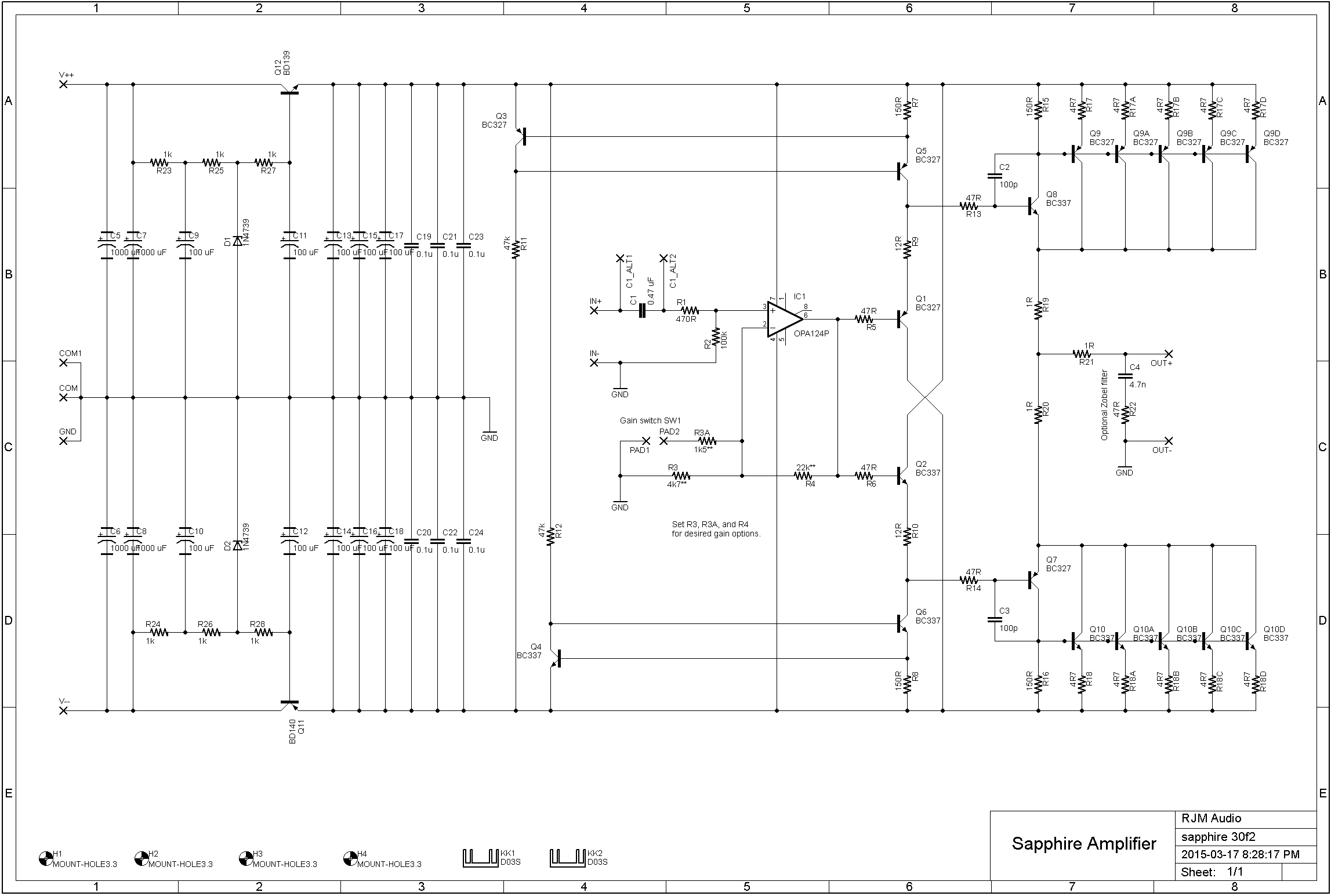

Sapphire 3.0f2 BOM
Sapphire 3.0f provisional BOM and Eagle files, and the "final" schematic (3.0f2). The final number (f, f1, f2) indicates an adjustment in parts values only, with no layout or circuit changes.

2. The change in caps brought in a welcome warmth and smoothness. (In comparson the Multicaps are more transparent, but have a tendency - decreasing as they break in - to "flare up" on transients. Anyhow, with the coupling caps sorted I could focus my attention on a remaining annoyance: a slight channel asymmetry. Basically the left channel sounded brighter than the right, which pulled the stereo image off center even though the measured frequency response showed that the actual level imbalance was just 0.07 dB. [The Gustard H10 which I'm using as a comparative reference at the moment clocks 0.25 dB left, yet sounds properly centered.] The left channel also ran at about 15% higher bias current, and was noisier when the volume was turned up to max. Other than the higher current in the output transistors x5 banks, however, there was no other voltage/current/resistance that seemed out of order compared to the other channel. The issue is at any rate extremely slight.
So this has me kinda stumped at the moment. My operating theory is one of the transistors (most likely one of Q1,2,7,8) is not functioning 100%, though its possible it's within spec but just a real outlier on the hfe distribution curve. (I didn't try to match the transistors.) I figure pulling out and replacing transistors until (if/when) I hit on the problem device is not a viable strategy for reasons of maintaining my sanity, instead I will make myself another set of boards paying attention to matching all the values and see what happens.

Second set of boards are finished. Things went much more smoothly this time. I checked all the resistors before assembly, and measured the Hfe of all the transistors. I even matched the Zeners.
It was not possible to match the BC337 and BC327 transistors due to the overly tight binning: 90% of the BC337 were between 220-240, and 90% of the BC227 were between 270-290. At least though I could screen the devices, discarding the outliers. That leaves the inherent symmetry of the buffer circuit free to mop up the imbalance.
Clean off flux, leave to dry overnight. Testing tomorrow.
