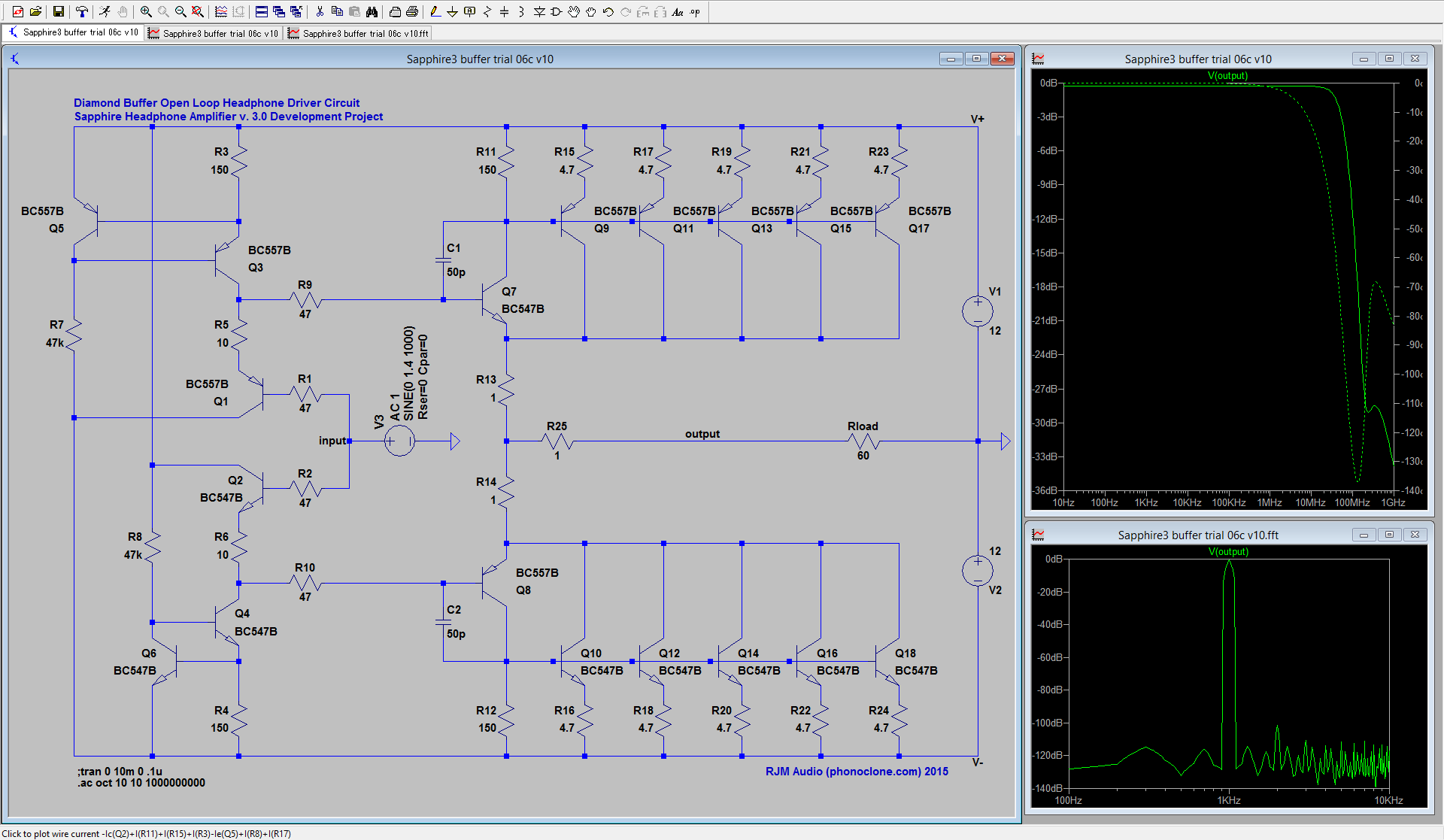

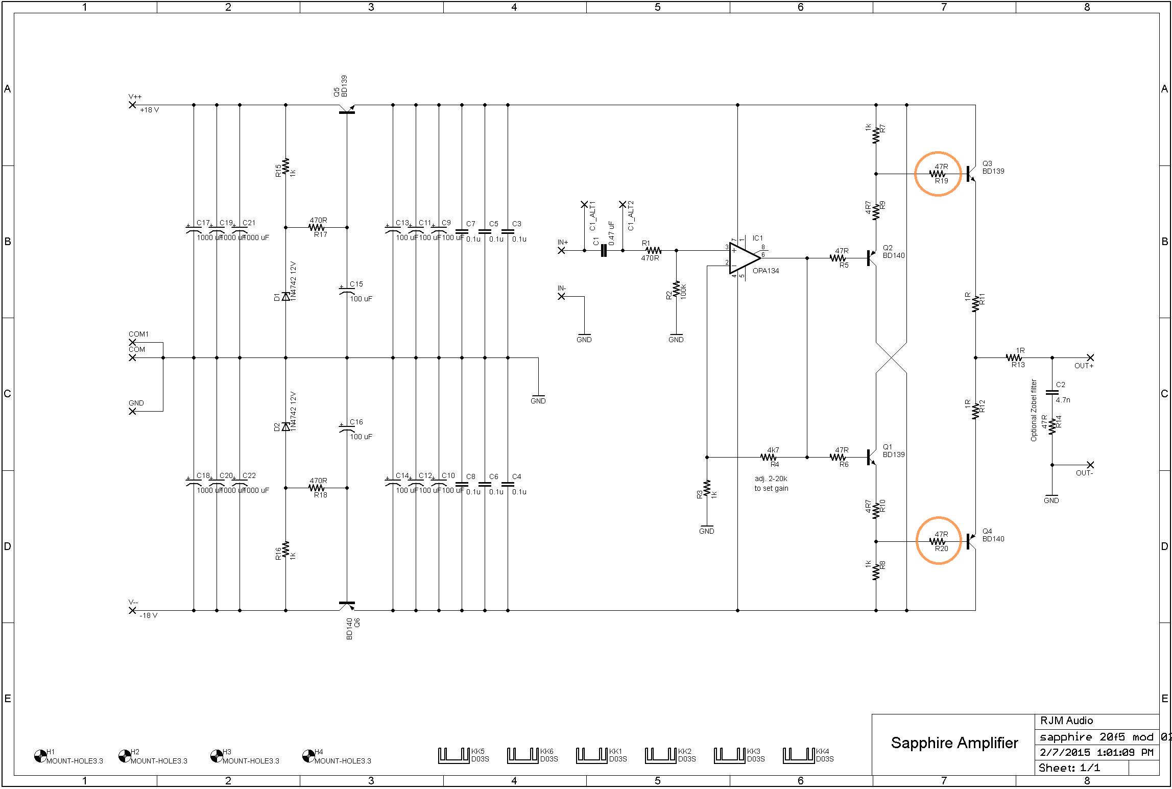

The transistors are not critical... the models are close enough for what I need them to do, or to put it another way, there isn't much difference between the different transistors here except at frequencies so high that the simulation is unlikely to be of much use. It's just a small annoyance that the bias set resistors will not match exactly the ones needed in the real circuit.
Note: the small bias set resistors (R1,R2 in the LTSpice schematic above, R9,10 on the current Sapphire circuit) really eat into the PSRR, so its not a good idea to make them any larger than absolutely necessary.
If you use a smaller transistor for the driver than the output, the Vbe for equal current is slightly larger so the output bias current is increased without having to resort to the bias set resistors.
From a package point of view, though, its a good idea to have both "mountable" to the heatsink to allow thermal feedback which suppresses thermal runaway in the output.

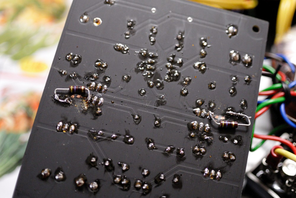

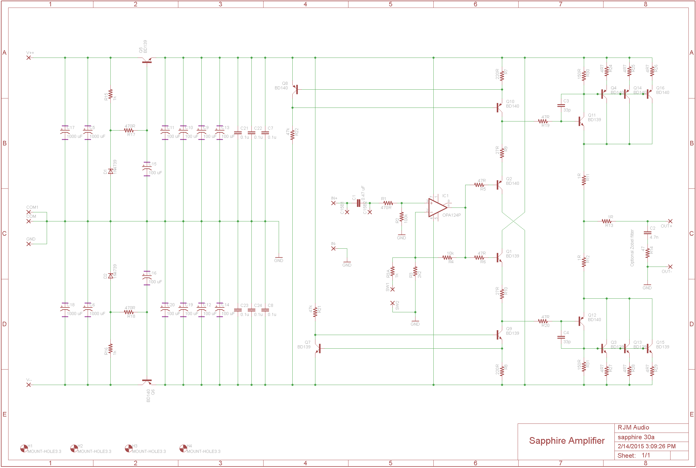

Notes from the mod lab:
Replaced the RC filters (475R + 1nF) before the output transistor bases with a simple damper resistor (47R, carbon comp.).
A bit of background:
I originally borrowed the diamond buffer circuit from the LH0002, around that time I came across a version in an old TI/BB app note (here) which had 50 ohms damping resistors on all four bases. This seemed to me a reasonable precaution, so I included them in the b-board circuit but, imagining they weren't all that important, omitted the second set in the sapphire circuit. (a layout concession...)
This latest mod of mine puts them back in, bringing the b-board and sapphire buffers back to a common point (minus the different bias currents).
I had a hunch that the b-board sounded slightly warmer/smoother than the sapphire, though nothing firm as the two systems were so completely different. Anyhow, adding these resistors to the sapphire seems to add that very slight roundness, a touch of smoothness to the treble. The RC filters did this as well, but it was too much and the sound balanced on the heavy/sluggish side.
This mod (47 ohms on all four bases, as per the Texas Instruments app note OA-07) is officially approved/cleared for the next layout spin.

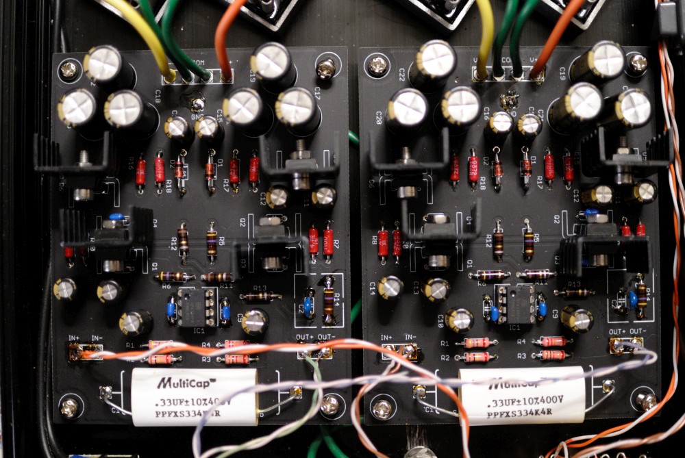

@Stan63605 (and arpagon, indirectly)
First my usual disclaimer: it's a %&$# resistor. I would not hold my reputation up to being able to tell the sonic difference between different types, let alone different brands... do whatever you want, pay whatever you feel is necessary.
For my build, I was ordering the Multicap coupling caps from Partsconnexion, so I got the PRP resistors from them at the same time. I've bought Welwyns from them for other projects in the past. I figured why not: they are red, they look cool, and they are not much more expensive than the Vishays at Mouser.
The rest is standard BOM. I use carbon comp. types where, to my way of thinking, resistor inductance is more of a worry than resistor noise, typically the small damping/isolation resistors used after feedback loops, or in front of transistor bases/gates/grids.
So as I said, I wouldn't put money on me being able to tell one from another but since you asked nicely here are my my nominal impressions:
Takman carbon film: I use these in stepped attenuators. I think these are really great: pleasant, warm sound.
Vishay: your standard metal film... invisible but soulless.
Welwyn (The black ones, H4): I haven't used these that often, but every time I have the result has been exceptional. There's this amazing quietness, very smooth and clear.
Xicon. Nasty things, but I consent to use them in the Phonoclone RIAA since Vishay doesn't have those values and I can't be bothered to make up the value as a pair of individual Vishay resistors.
Allen Bradley (and Kamaya and other carbon comp). They are very soft, and just plain noisy which can mask unpleasantness elsewhere (the noise is white in character, so neutral in sound), but noise is just a matter of management: don't use them for the resistors which contribute significantly to the circuit noise, and theres no problem. Very low inductance and negative tempco means they have their usefulness in modern audio.
PRP: Well, they are red. They look cool. They are cheap. What's not to like? Somewhere between Welwyn and Vishay in sound quality.

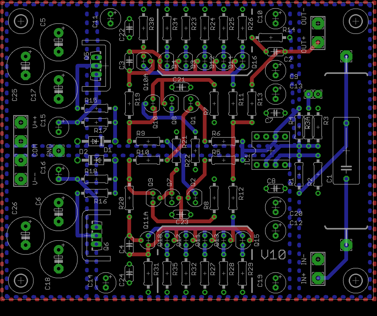

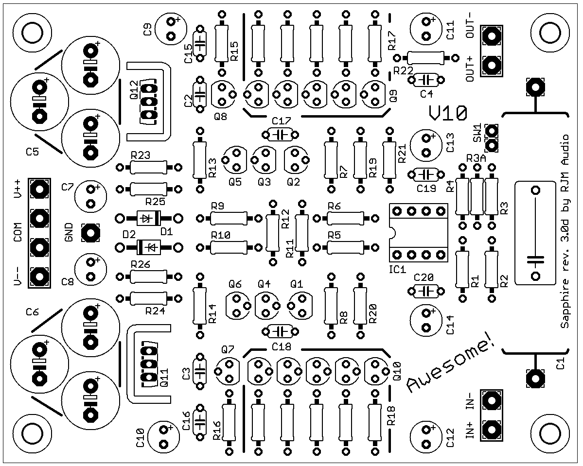

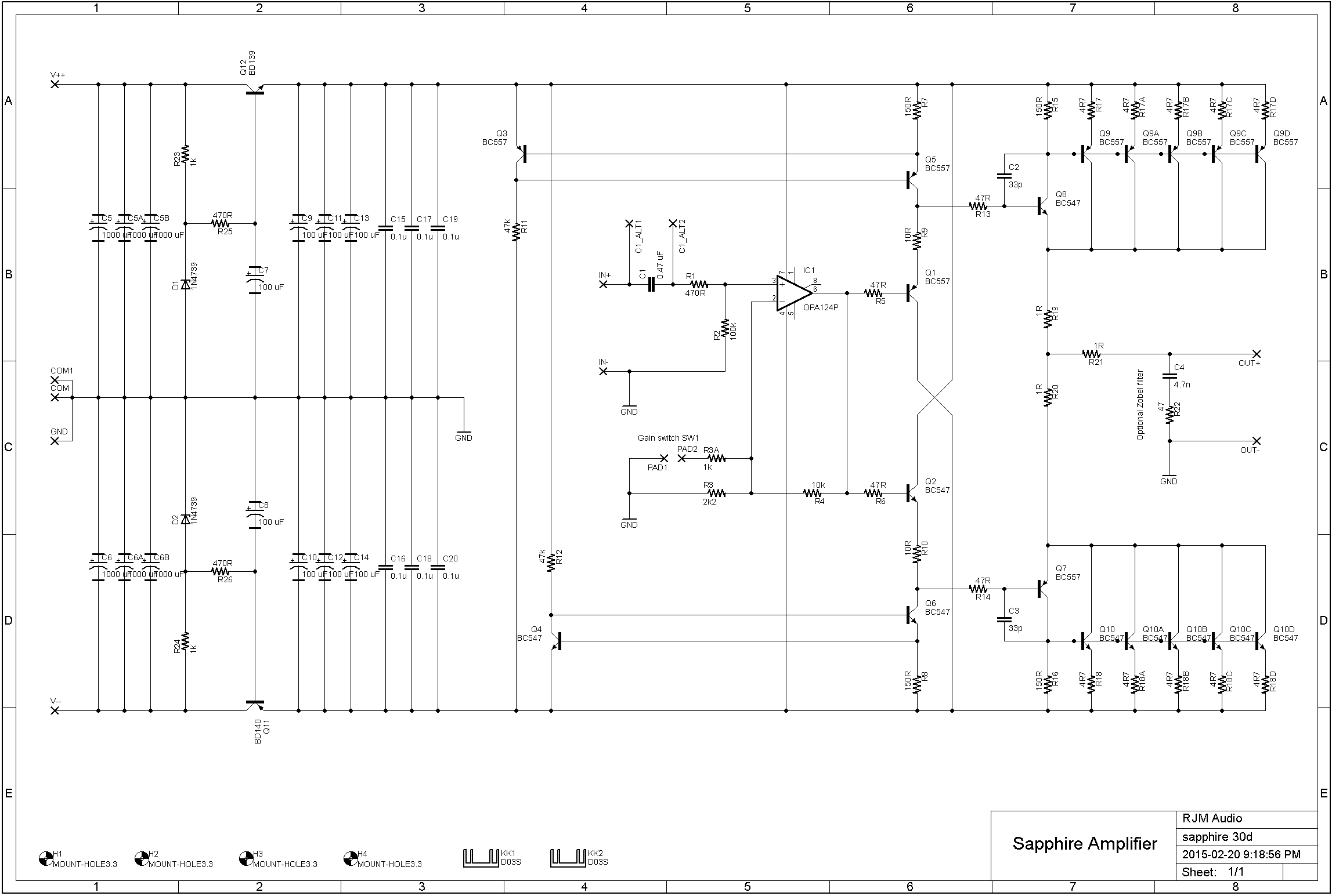

Sapphire Headphone Amplifier rev. 3.0d "V10"
Flat of pnp faces right, npn faces left. The layout is overall quite logical and neat ... it worked out a lot better than I had imagined it would.
As promised, a simple (and completely optional) gain switch (hi/lo) has been implemented, SW1. The 5+5 output transistor banks can be partially populated, as desired.
Generally speaking the output gain is fine-tuned by trimming R9,R10. The correct value to give about 5-7 mA in each output transistor will be ascertained during the testing phase.
