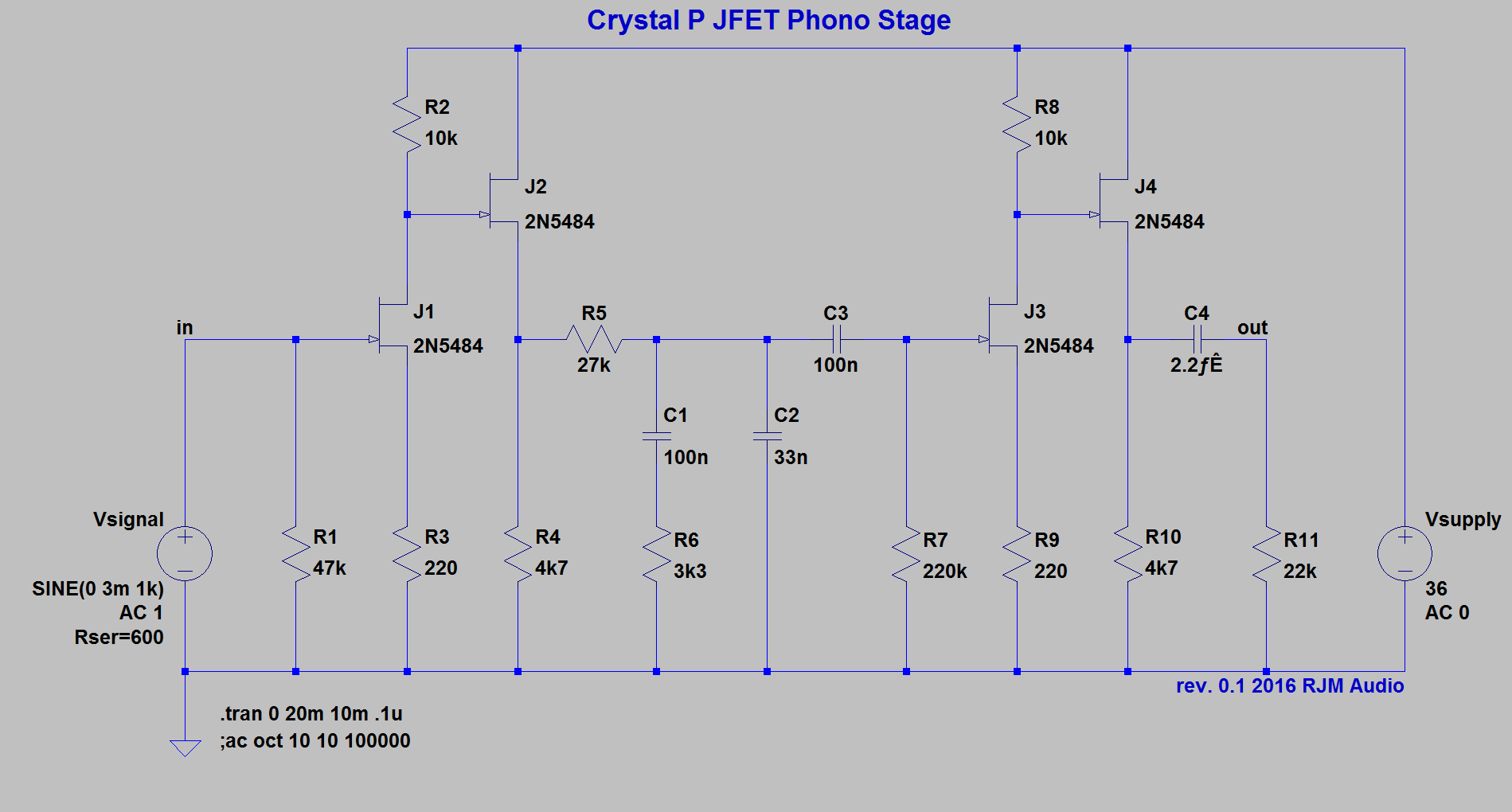

This seems to work out not too bad. Gain is touch and go, but noise and distortion figures are respectable. RIAA accuracy is excellent (+/- 0.2 dB 20-20k with the standard values shown.)
Power supply must be very (very!) low noise. Fortunately the current draw is only 10 mA per channel so it should be do-able. I'll be looking into that in a bit.

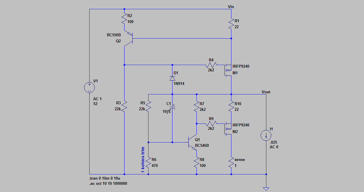

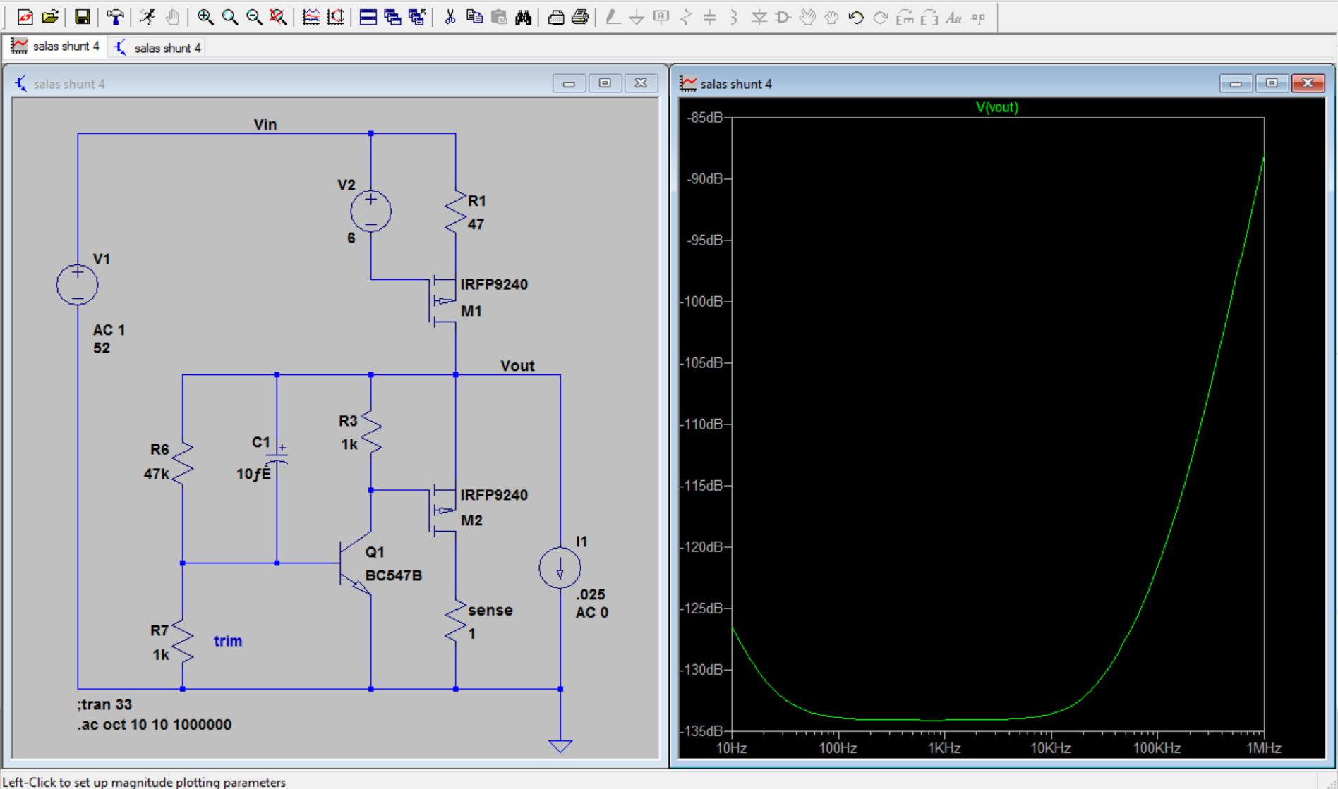

Currently my "object of interest": p-mosfet based shunt regulator, based on the PSU for the Salas phono stage. I simplified it a little replacing the current source FETs with resistors. At 135 dB rejection ratio it's good enough as it is.
C1 10uF. This gives a turn on time around 1-2 seconds. Turn off is clean with no spikes. The bias V2 will be replaced with a Zener or LED arrangement. Vin 52 Vin is the rectified, filtered DC from 2x18 VAC secondaries connected in series. Telama 60074 for example.
Gate resistors omitted for simulation simplicity. Rsense is just for bookkeeping so I can see how much current is flowing through the shunt arm.

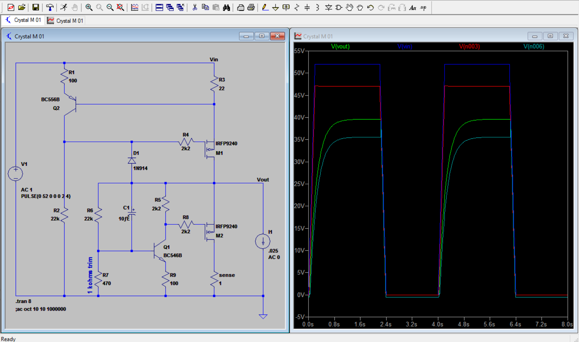

rjm
Joined 2004
"Crystal M" regulator stage completed as a functioning simulation.
The diode D1 is critical to protect the gate of M1 during shutdown. I also added emitter degeneration R1 R9 ... this degrades the performance but makes the output less critical on the individual device characteristics of Q1 and Q2. Gate resistors R4 and R8 also added for RF stability, though they don't do anything in simulation.
For the bias voltage of the current source MOSFET (M1) I opted to go with transistor-based feedback (Q2/R3) rather than using a Zener or LED to set the bias. I thought this was safer and smarter as it is self-regulating.
The ripple rejection hits -100 dB over the audio bandwidth.
rjm
Joined 2004
One small addition of 22 ohm resistor R10 on the source of M2. This damps out overshoot when the circuit responds to a quickly varying current load. It's very well-behaved now, but unfortunately ripple rejection drops to 72 dB.

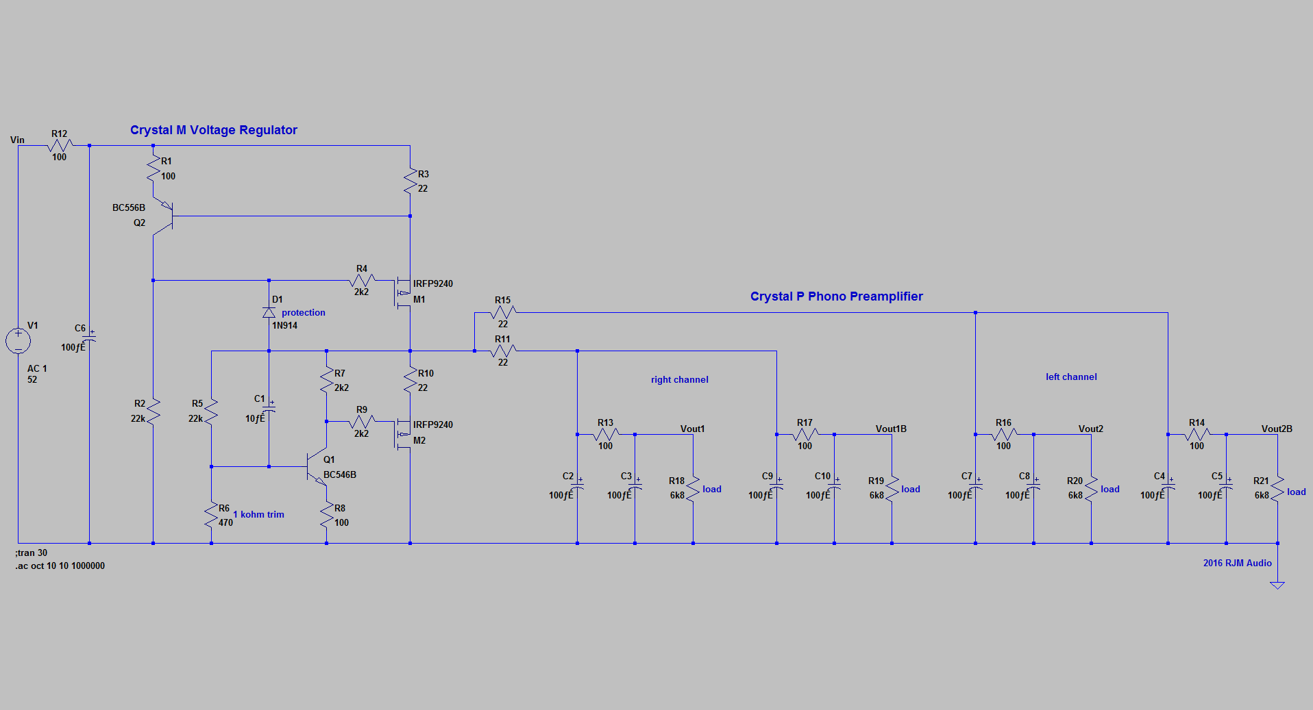

rjm
Joined 2004

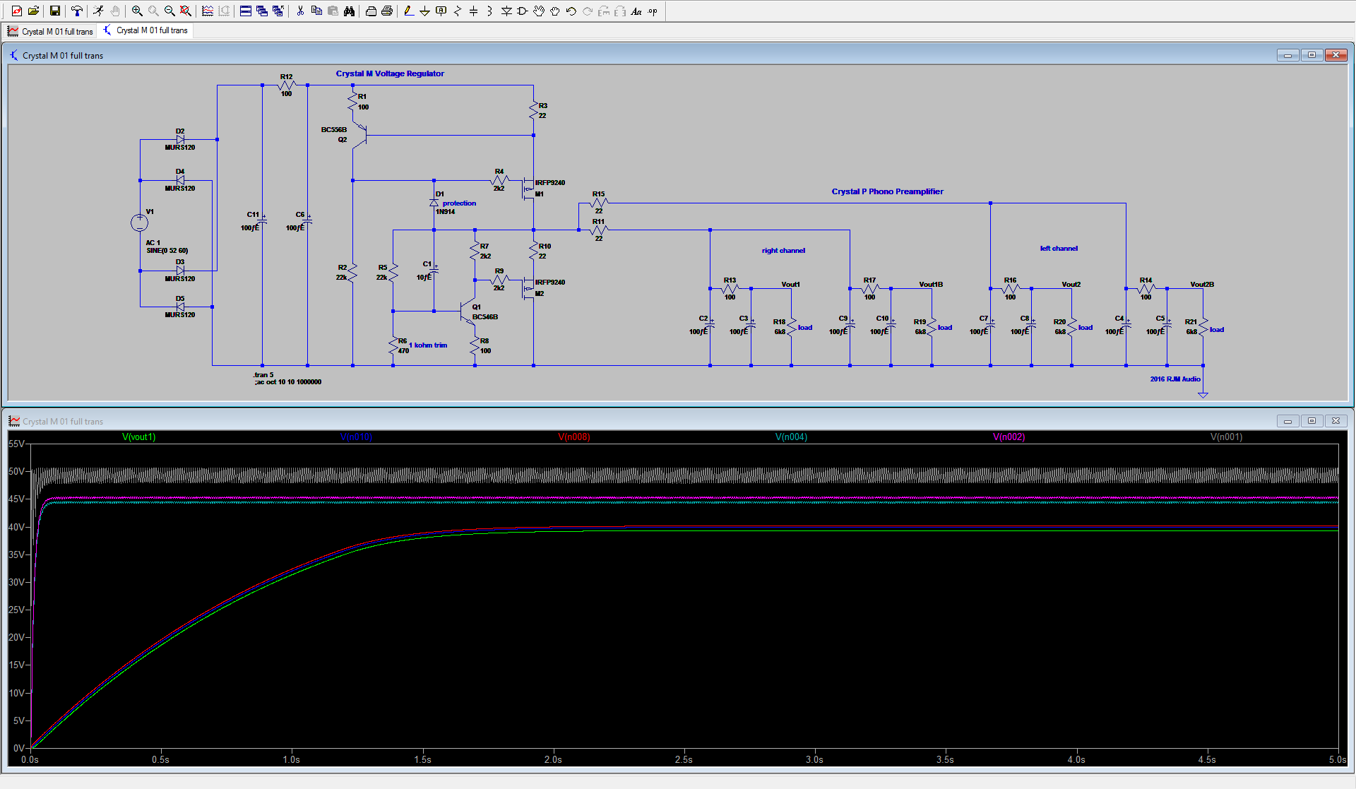

.. and something of how the regulator would integrate with the filter stages before and after it, with outputs to both stages of each channel.
rjm
Joined 2004

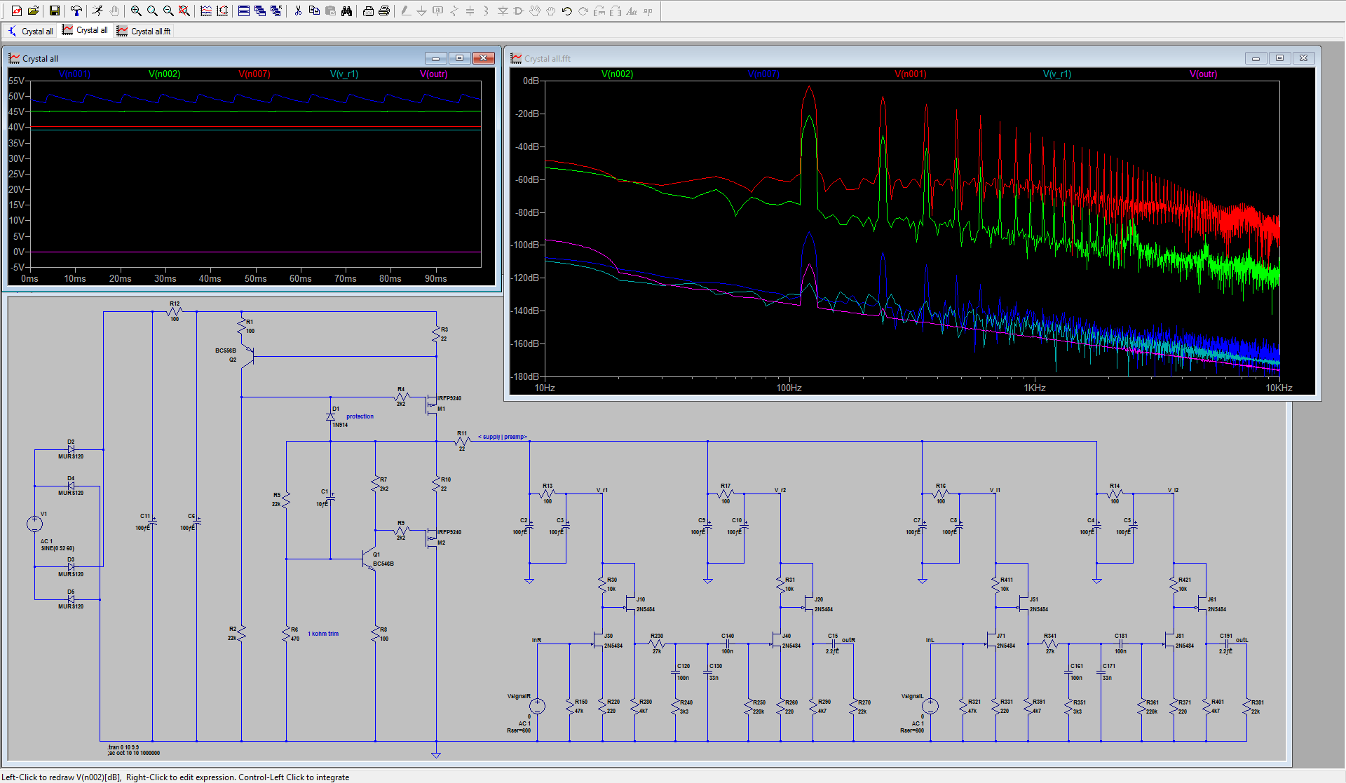

The whole enchilada, as it were.
The output power supply ripple is -110 dB at 120 Hz (around -140 dB input referred). Shorting over R10 would reduce that further to below the noise baseline, but I don't think that will be necessary in practice.

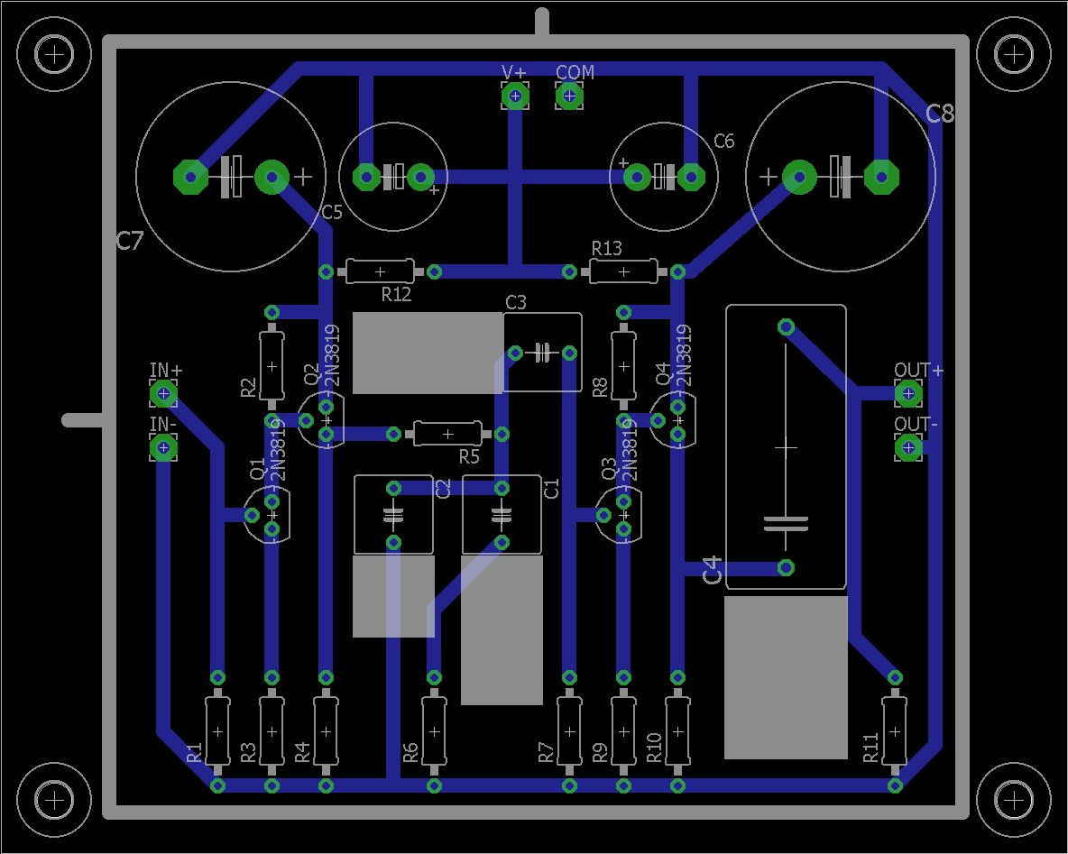

rjm
Joined 2004

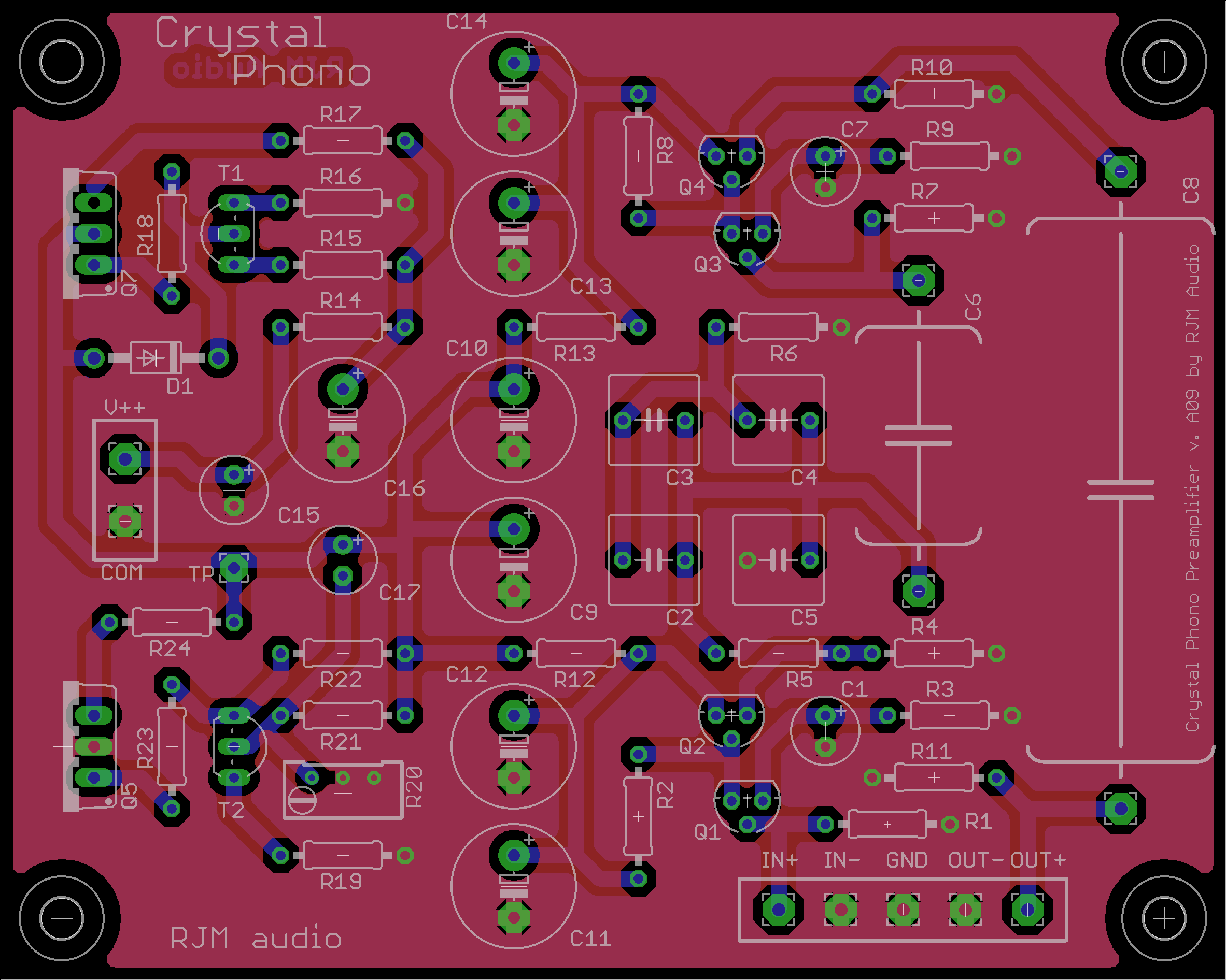

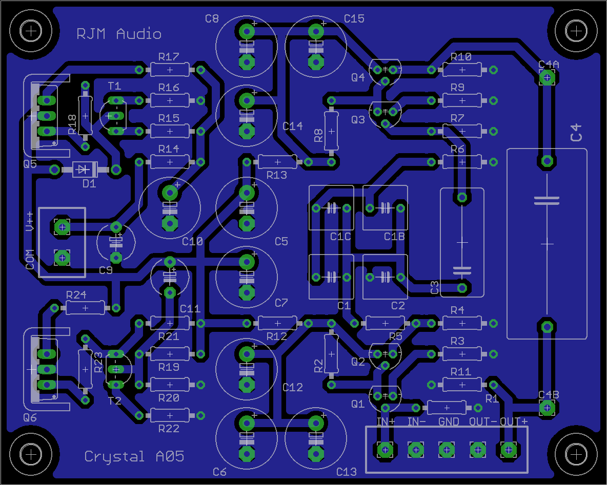

First ideas about the printed circuit board layout. This is what you might call "pre-alpha". Just to get some ideas about how the components might fit together and how much board area things are going to need.
The voltage regulator isn't included yet. I have to decide on whether it will be included or separate, or whether two channels or dual mono.
While clearly the layout could be shrunk considerably from its present state, board area isn't so expensive that it is strictly requires, and larger component spacing makes it easier to build build and modify.

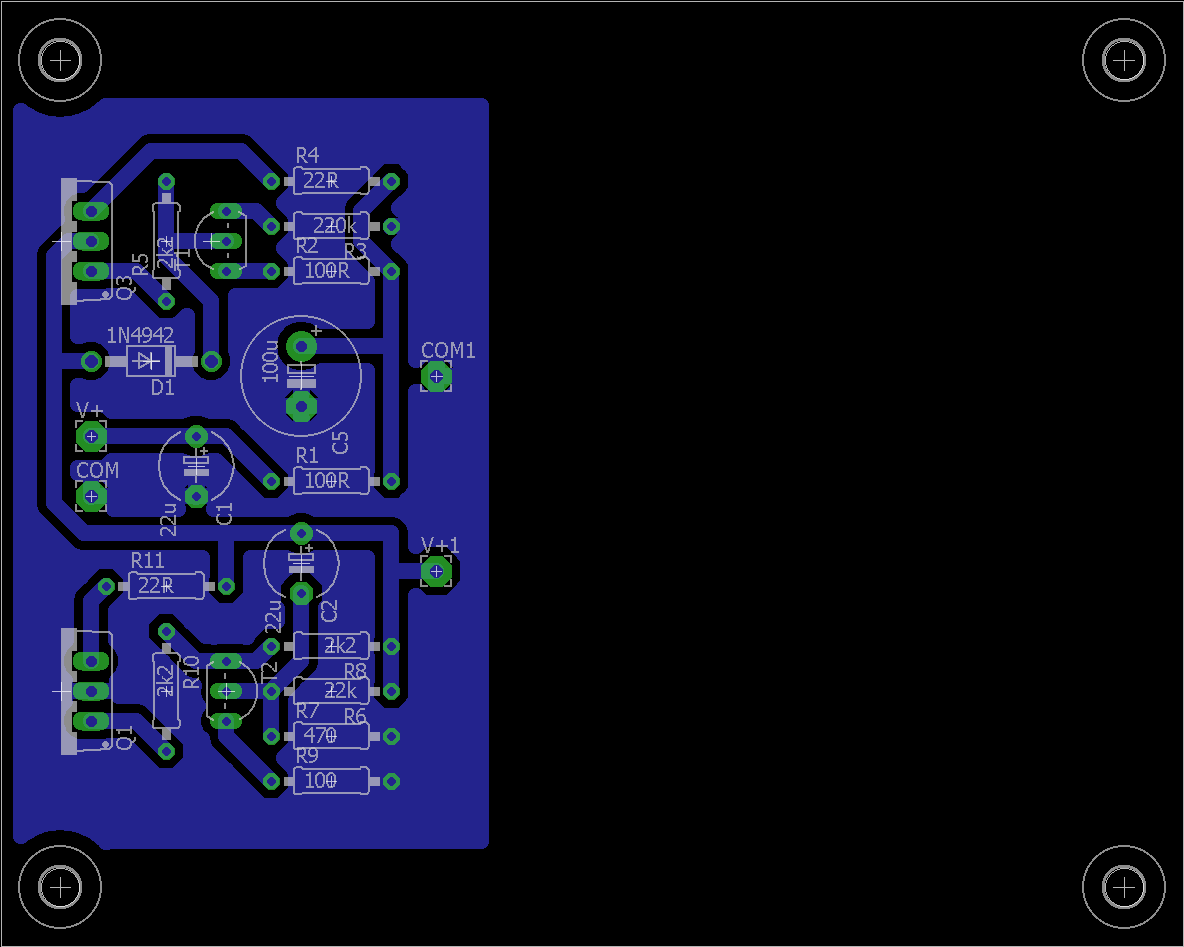

rjm
Joined 2004
The choice of capacitor for the RIAA network (0.1 and 0.033 uF) and interstage coupling (0.1 uF) is very important, both for response accuracy and board space considerations.
I'm very excited about the Vishay MKP1837 metallized polypro film, box type, which are compact, relatively economical, and available in 2.5% and 1% tolerances.
http://www.vishay.com/docs/26017/mkp1837.pdf
With these caps, it should be possible to put a single Crystal channel with the voltage regulator components on a single 8x10 circuit board.
Without them, there is little option but to split the circuit with amplifier and power supply on separate boards.
The power supply can be made quite compact. A "pre-alpha" board layout is shown below. The phono stage will cohabit the board in the unused space at right.

rjm
Joined 2004

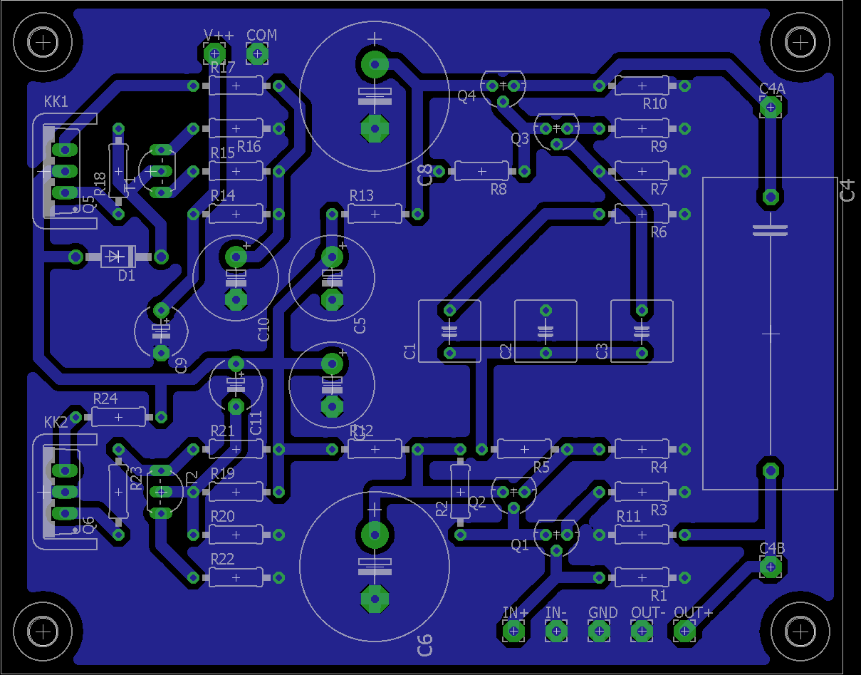

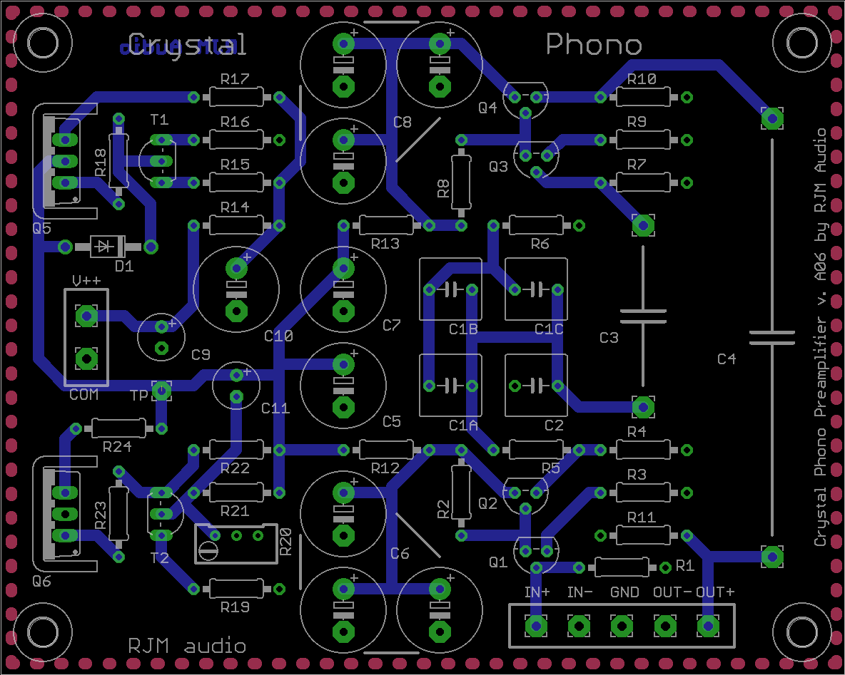

Milestone: Crystal board layout reaches "alpha" revision.
The board is complete and connected, but still far from being ready for fabrication.
One channel, complete with voltage regulation, on one 8x10 cm board. Two boards needed for stereo, plus a power supply (around 40-45 VAC secondaries, rectifier diodes).
Happily there ended up being plenty of room for larger RIAA capacitors, so some flexibility there will be included.

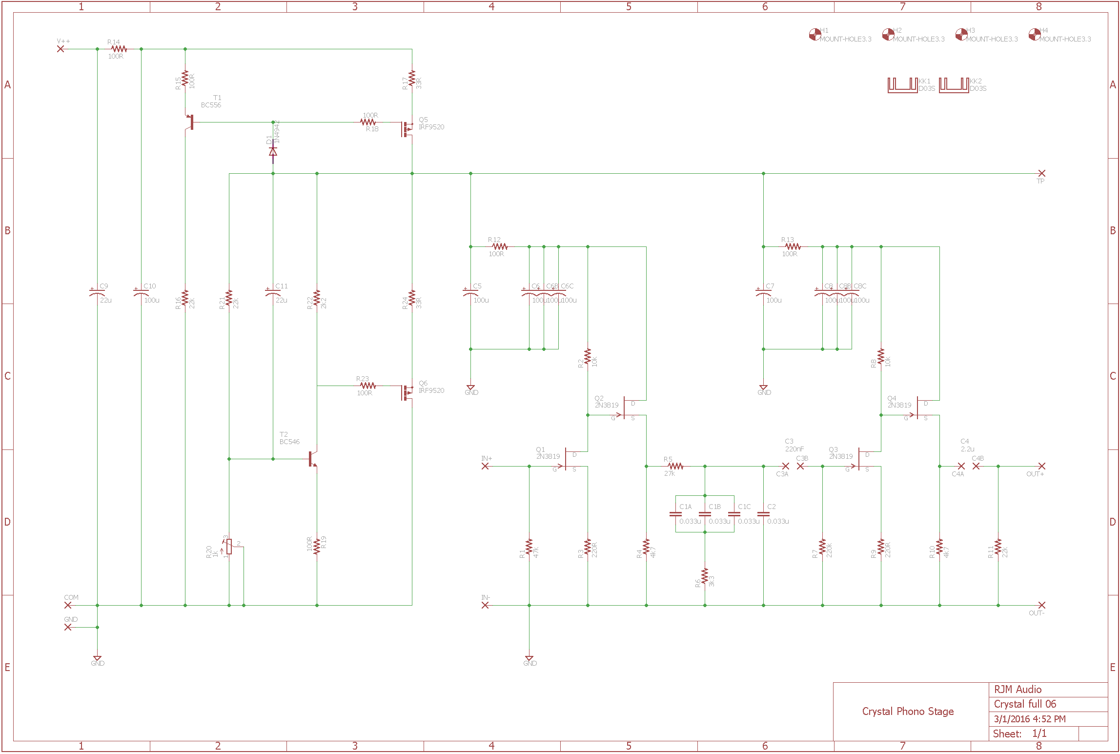

rjm
Joined 2004
Hold up. 2N5484 is only rated to Vgs/Vsd 25 V. On power off it would likely fry.
It's vitals are Vgs-off (-0.3 ~ -3) V and Idss (1 ~ 5) mA
Is it time to bite the bullet and go look up some LSK170's?
Obtainable substitutes that I can see are limited to
J202 Vgs-off (-0.8 ~ -4) V and Idss (0.9 ~ 4.5) mA [-40 V breakdown]
J112 Vgs-off (-1 ~ -5) V and Idss (x ~ 5) mA [-35 V breakdown]
whereas the LSK170 is Vgs-off (-0.2 ~ -2) V and Idss ["A"(2.6 ~ 6.5) mA [-40 V breakdown]
Back to the drawing board as they say.

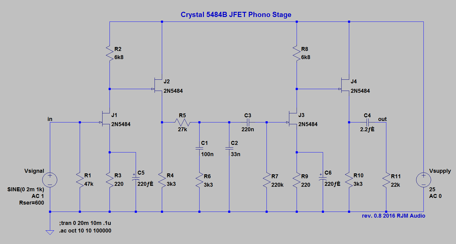

rjm
Joined 2004
Yes, well, it becomes clear why the 2SK170 is typically used in this circuit.
In terms of voltage gain, the 2SK170 is in a different class than everything else I've looked at. Single stage gains are around 35 dB, where other JFETs struggle to manage over 25 dB.
The problem? Well, for a MM phono stage the ideal total midband gain is 35-40 dB. Which means the single stage gain needs to be 27.5-30 dB. The 2SK170 is too high (just about enough for an MC stage, but...) while everything else is too low.
Once could mix and match the two stages, I suppose. Still, an ideal solution escapes me at present, and that's before thinking about if I can source LSK170s.

Joined 2004
Running at lower voltage means 2x12 VAC (24 VAC) to 2x15 VAC (30 VAC) transformer secondaries can be used, which is convenient.
Electrolytic capacitors in the power supply should be rated for 50 VDC, those in the amplifier section at least 35 VDC except for the source bias capacitors which can be 10 VDC.
So little power is dissipated by the mosfets that heatsinking is not required.
