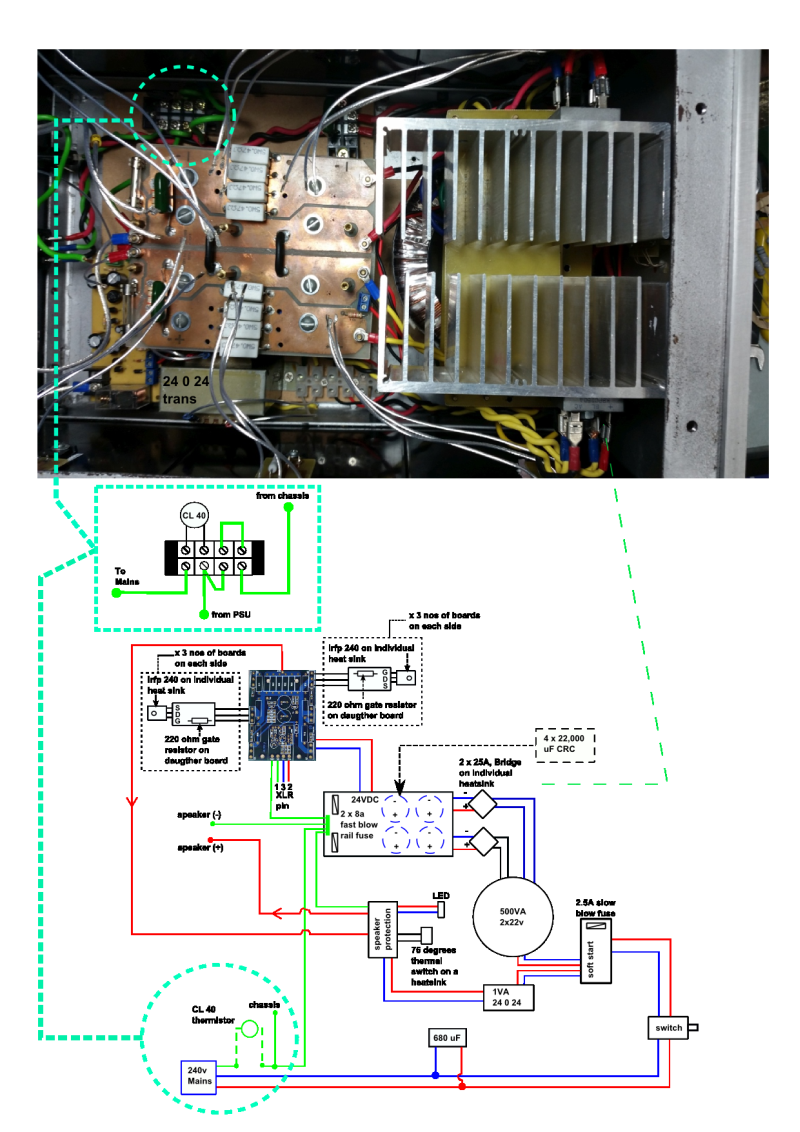

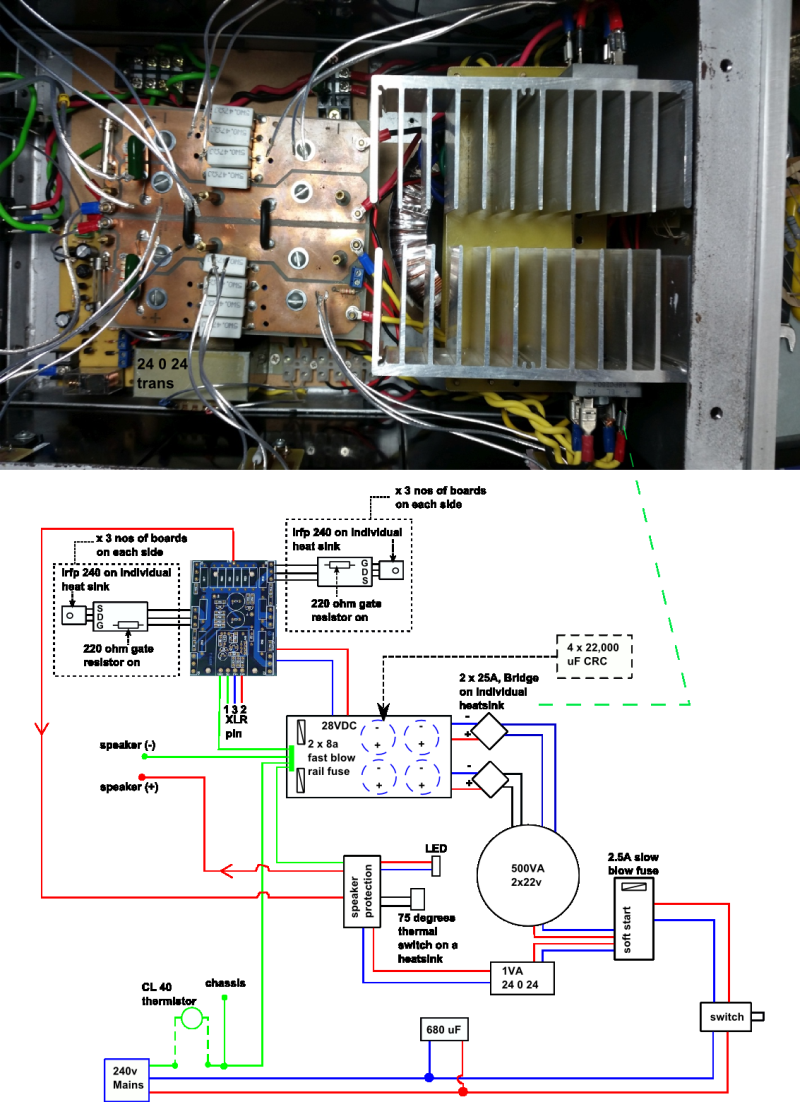

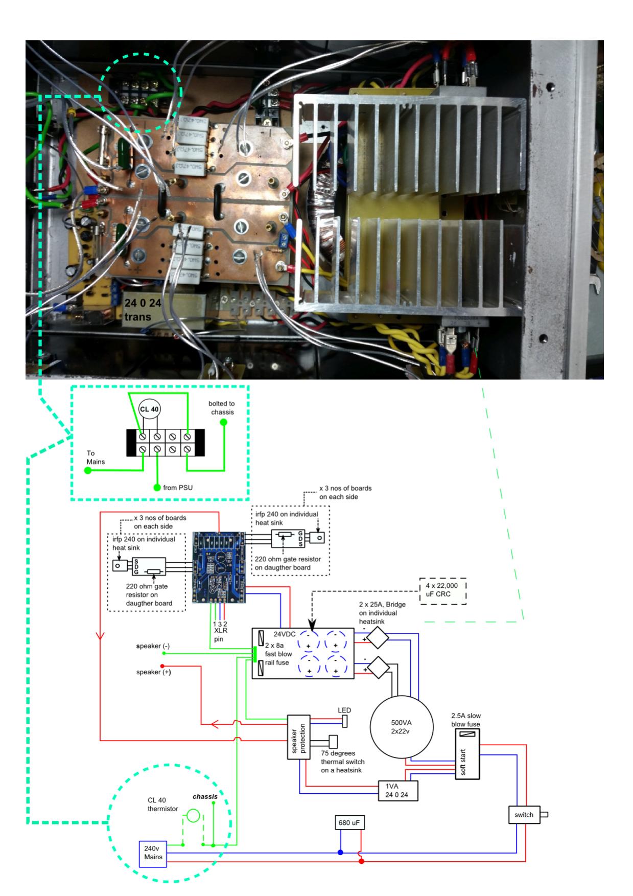

This is how it is setup. I think I have connected Peter Daniel's board SG signal erroneously to the XLR pin 1. I always heard a faint buzzing sound on my speaker. What component would be damaged by this?
I think it's correct, it's the ground signal.
Thanks.

The third wire of the Mains cable must be bolted to the Chassis !!
The earth wire is connected to the chassis.

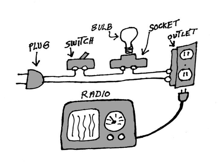

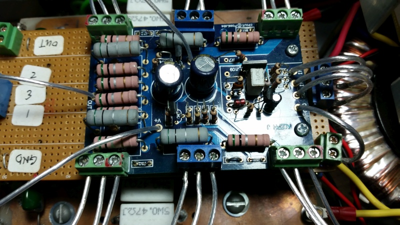

I've replaced the mosfets and install a light tester to the mains and when I powered up the amp, the 40w light bulb lights up. Something is wrong.

if amp is fully biased , and Aleph J is by construction (not starting biasing procedure from zero as , say, F5) - bulb tester can be used :eek:nly: for testing of unloaded PSU
so - fit appropriate fuse in mains , one dvm for observing Iq , another one for output offset ........ and bang it on
under condition that you triple checked everything in cold
post42 shows the Audio Ground connected to Chassis.
The Mains PE wire is not shown connected to Chassis.
Who are you trying to kill?
Hi Andrew,
I have connected it this way as shown in the diagram.

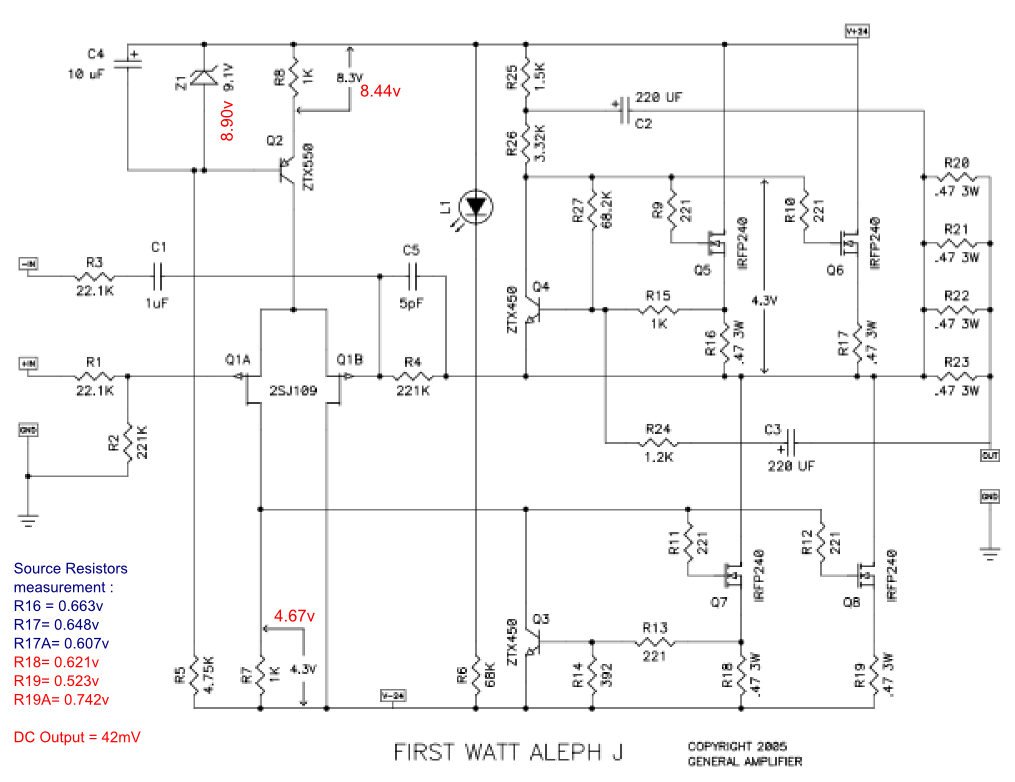

I ve powered up the amp without the light tester and it seems to work! DC offset is at 50mV when switched on and drop to 39mV after an hour. R7 is at 4.8v and Z1 is at 8.8v. But the mosfets are not well matched.

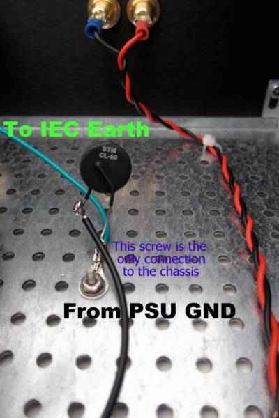

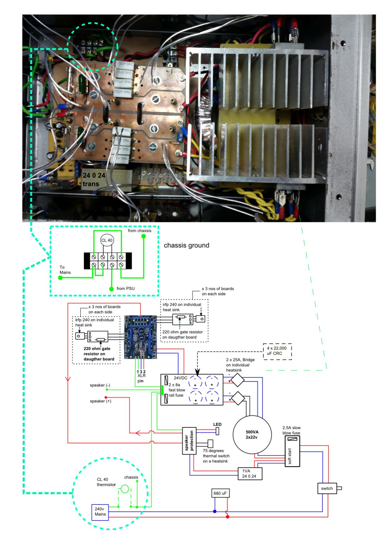

The third wire in the mains cable must be fixed/bolted to the Chassis. This is your Protective Earth (Safety earth).
There are no alternatives.
You MUST make the Chassis safe.
Hi Andrew,
It is bolted to the chassis and then connected to the CL40 thermistor along with the star ground from the PSU.
The measurement as in the attached picture.
