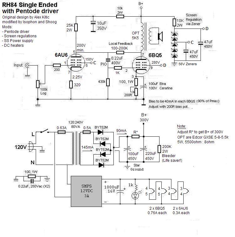

I built 2 years ago a RH84 according to Alex's plan using the 12AT7 and to this day it is my favorite amp. (I have also recently built a Chinook amp 13FD7 SET and RH807)
I have modified Alex's plan and ordered last night some 6AU6 JAN type. I have attached my schematics, please comment and recommend something better before I start making holes in my 10 x 6 chassis. Most comments for the pentode driver comes from a post by Shoog..this is why his name is on the plan (I do not like to take credit for someone else work.)

Looks good to me.
The only two comments I would make is;
-its a very good idea to regulate the driver stage as you have done, though I would be inclined to use 10V zeners in the critical range so that you can home in on the 6AU6 sweet spot for this circuit. The way I have done driver screen regulation before is to use a resistor string and a multi-turn pot feeding the base of a transistor. Pass 1mA through the string and use a high hfe transistor (MJE350 should do) and you have a totally adjustable screen supply which shouldn't vary much with screen current and will not introduce zener noise at a critical junction.
-regulating the output stage produces very little benefit in this circuit in my experience - though it is unlikely to hurt.

In his circuit, he's regulating the screen and not the driver or output stage.
The fuse on the secondary has no purpose. See Morgan Jones.
Also. I would be nervous of RF interference with the SMPS feeding the heaters. And maybe you need a 1M resistor in the input tube grid, in case the pot scraper lifts?
A choke in the power supply would be much nicer too.

Fuse on secondary are quite useful IMO, in case one of these 450Vdc cap becomes short-circuit or partial short-circuit the secondary fuse blows instead of having a dead power transformer. How can a fuse have no purpose ?
For the SMPS feeding the heaters my original RH84 is dead quite and I have not noticed EMI interference but I'll keep this in mind. Good idea about the grid resistor to gnd, it's there already but not on schematic.
My original RH84 is tube rectified with 5U4 + choke (8H, 125mA, Rdc = 150ohm from Radiodaze)
For the choke in the PS, besides having a smaller ripple is there any sonic advantage ?
your primaries are more likely to be damaged then your secondary windings from my understanding. Also it wouldnt protect against a internally shorted transformer, you'd be setting something on fire

The substitution of a pentode as the driver is based on the theoretical improvement it will bring. Having someone who can do a side by side comparison will help to clarify if the theory is supported by the facts and therefore you are doing the whole community a great service in trying the experiment.
I built a RH807 with a parafeed output stage as my first amp. I didn't like the result that much and moved onto PP amps. One of my current amps is a copy of Gary Pi,mms direct coupled Tabor amp using 807's. It sounds sweet and proves that the 807 can be made to sing in a Schade arrangement.
I very much look forward to hearing your impressions once the build is complete - Good Luck.
Shoog

I have built a number of schade amps with pentode drivers so I do speak with experience. I have used the 6AU6 with excellenet results.

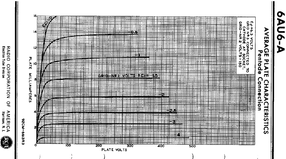

Since the driver will be relatively high impedance (~30K) you should probably increase the value of the feedback resistor to 250-300K to get a feedback voltage ratio of about 1/10 (as recommended by Shade).
Alternatively you may consider using a lower value anode resistor for the 6AU6, and corresponding adjustment to Rk and Rg2.
The AC load line for the 6AU6 will be much steeper than the DC load since the Rfb will represent a dynamic load corresponding to about 1/15 of its value.
From the 6AU6 curves it looks like it will be most linear with an anode current of 7-8 mA.
SB.

The portion of the driver's signal current swing that goes through Rfb is feedback. The portion that goes through the anode resistor is not.
Thus, the feedback ratio of the RH style feedback circuit must be calculated based on the ratio of the dynamic Rfb load vs the static anode resistor. A Svein points out, this is a small fraction of the Rfb component value ("about 1/15").
The dynamic Rfb is actually Rfb/(1+output_tube_gain) which is, not coincidentally, the same equation used to estimate the Miller effect.
So, if the Rfb is 330K and output tube gain is (guessing) 14x grid to plate, the dynamic Rfb is 330K/15 or about 22K. If the anode resistor is 33K, then the feedback ratio is going to be the ratio of driver current swing over Rfb vs. total driver current swing (1/22K)/((1/22K)+(1/33K)) = 0.6, or 6/10.
It follows that using a gyrator with high dynamic impedance in place of the anode resistor causes the feedback ratio to approach 1.0 or 100%. At 100% feedback, the output impedance approaches 1/gm, the same as a cathode follower.
6-8 mA is IME the sweet spot for the 6AU6 in this application.
