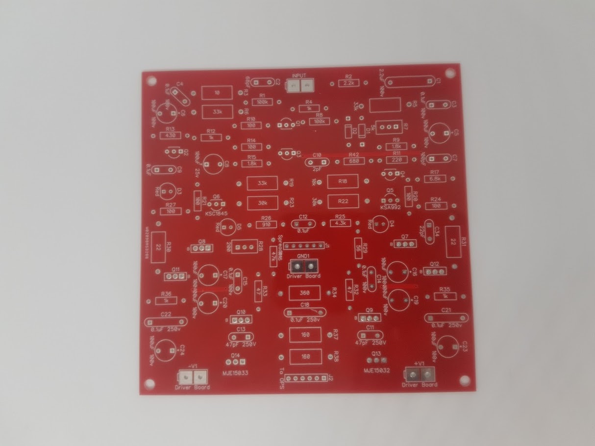

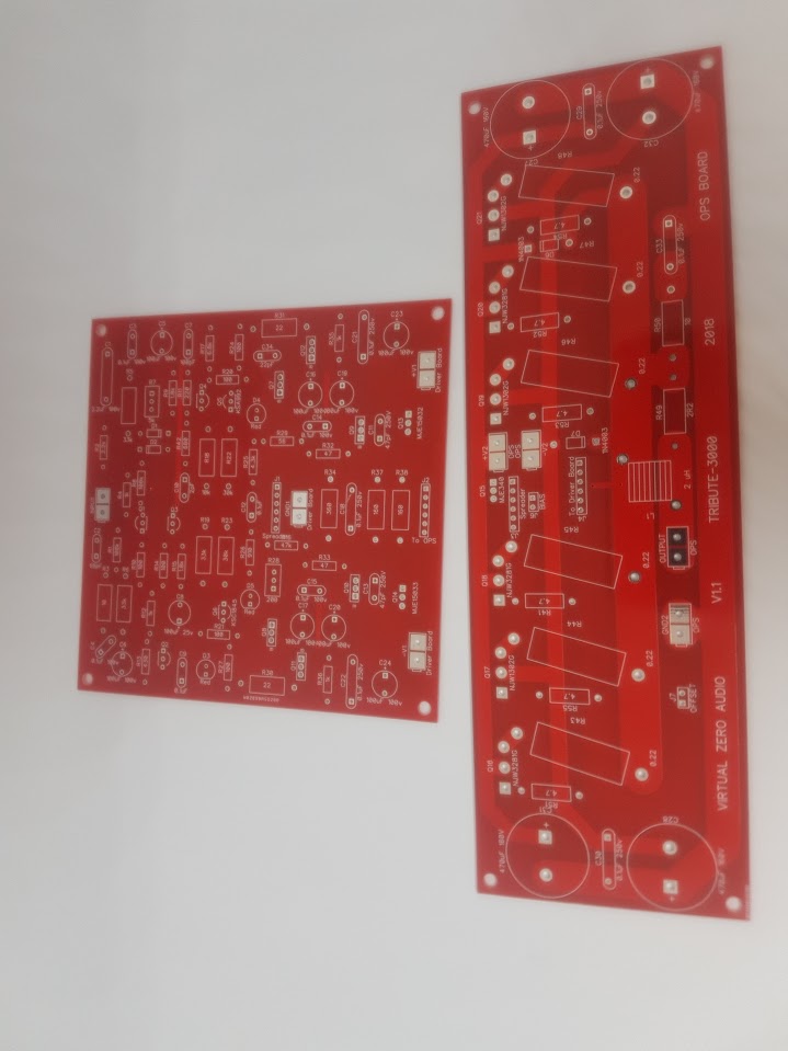

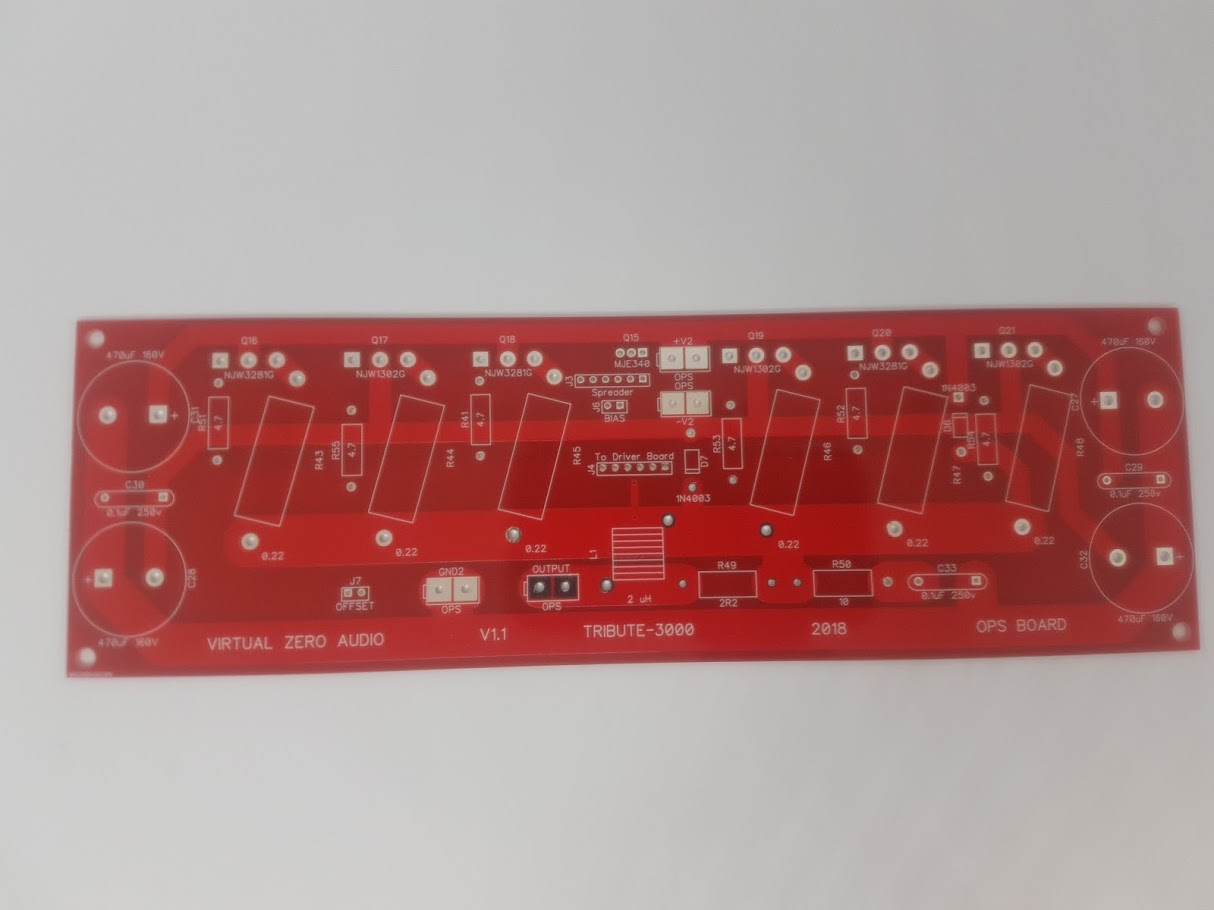

A step farther.
Thimios, it gives me association with a tank (in a good way) - a combination of power and uncompromised durability
You're getting closer! You're making more progress than I am.
Jeff don't forget,it is one channel!
I hope to do the same with the other.
Valery,yes like a tank ,the housing and the internall
