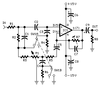

It's easy enough to build a loudness compensation circuit for a fixed speaker setup. Building one that smoothly hands over from OB to subs as the level increases is a whole new level of complexity. You first need to determine if it is even possible with your specific combination of OB speakers and subs in your room.
To do this you'll need a multi-amped (active crossover) setup with an adjustable high-pass for the OB woofer drive. The aim is to progressively cut the low bass passed to the OB woofers while replacing it with bass from the sub. You'll need to pick a crossover / high pass frequency that suits both the sub and the OB woofers.
Start without the sub, with no high-pass, and increase the level until you are approaching the limits of the OB woofers. This is your reference level. Now increase the volume further in small (2 or 3 dB) steps) and at each step increase the high-pass cut to keep the OB woofers under control. Then add some sub level to make up for the high-pass cut. After you have it tweaked to your satisfaction at each volume step, note the volume level (+dB from the reference level), high pass cut in dB, and sub drive level change in dB. You should end up with a list of values which can be plotted on a graph to provide the adjustment curves required.
If you're lucky, the curves can be approximated with a relatively simple analog filter circuit. It might have to have three volume controls - one to set the initial reference level, one for OB alone listening, and one for "sub assisted" listening. When the "OB alone" control reaches max, then you start turning up the "sub assisted" volume control.
If it can't be done simply, you'll need a flexible programmable filter unit where the curves can be programmed in. It'll need 3 or 4 independently programmable outputs - one for the sub, one for the OB woofers, one or two for the OB mids and tweeters. It might be possible to program a Behringer crossover to do this. I don't have one so I can't comfirm it.

Comments:
In order to obtain a good audio reproduction at different listening levels, a different tone-controls setting should be necessary to suit the well known behaviour of the human ear. In fact, the human ear sensitivity varies in a non-linear manner through the entire audible frequency band, as shown by Fletcher-Munson curves.
A simple approach to this problem can be done inserting a circuit in the preamplifier stage, capable of varying automatically the frequency response of the entire audio chain in respect to the position of the control knob, in order to keep ideal listening conditions under different listening levels.
Fortunately, the human ear is not too critical, so a rather simple circuit can provide a satisfactory performance through a 40dB range.
The circuit is shown with SW1 in the "Control-flat" position, i.e. without the Automatic Loudness Control. In this position the circuit acts as a linear preamplifier stage, with the voltage gain set by means of Trimmer R7.
Switching SW1 in the opposite position the circuit becomes an Automatic Loudness Control and its frequency response varies in respect to the position of the control knob by the amount shown in the table below.
C1 boosts the low frequencies and C4 boosts the higher ones. Maximum boost at low frequencies is limited by R2; R5 do the same at high frequencies.
Technical data:
Frequency response referred to 1KHz and different control knob positions:
Total harmonic distortion at all frequencies and 1V RMS output: <0.01%
Notes:
• SW1 is shown in "Control flat" position.
• Schematic shows left channel only, therefore for stereo operation all parts must be doubled except IC1, C6 and C8.
• Numbers in parentheses show IC1 right channel pin connections.
• R7 should be set to obtain maximum undistorted output power from the amplifier with a standard music programme source and P1 rotated fully clockwise.
Parts:
comments:
In order to obtain a good audio reproduction at different listening levels, a different tone-controls setting should be necessary to suit the well known behaviour of the human ear. In fact, the human ear sensitivity varies in a non-linear manner through the entire audible frequency band, as shown by fletcher-munson curves.snip
c1 boosts the low frequencies and c4 boosts the higher ones. Maximum boost at low frequencies is limited by r2; r5 do the same at high frequencies.snip
