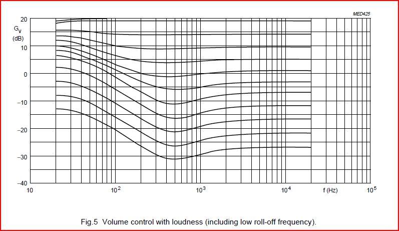

I've now looked at the loudness control from the December 1997 issue.
It's not suitable. The LF boost starts too far up the frequency range, and the amount of boost actually starts to reduce again as the volume setting nears minimum. It also boosts the treble as well as the bass, which I have always found unnatural. The response curves were apparently arrived at by experiment, which likely means the curves were chosen to suit a typical car stereo rather than a home environment.
I guess I am looking for a circuit to reduce boost with increasing volume but operated off the volume control so that two separate controls are not needed. This is to reduce xmax at high volumes. Thanks for any help, negative or positive.

What is needed is a progressive bass boost/cut control linked to the volume control, along with a gain setting control that lets you calibrate your system to the standard.

I tried this out last night and it seems to work. It works for increasing and decreasing and the first volume is for calibration.
Those curves don't look right. See http://www.diyaudio.com/forums/solid-state/154209-reverse-old-loudness-control-3.html#post1975429

Typo that first one is the wrong signal flow. This is what I was using. The bass roll off isn't much on the upswing so changing the xover to around 300-500Hz on the inverted filter would maybe work better for that application.
