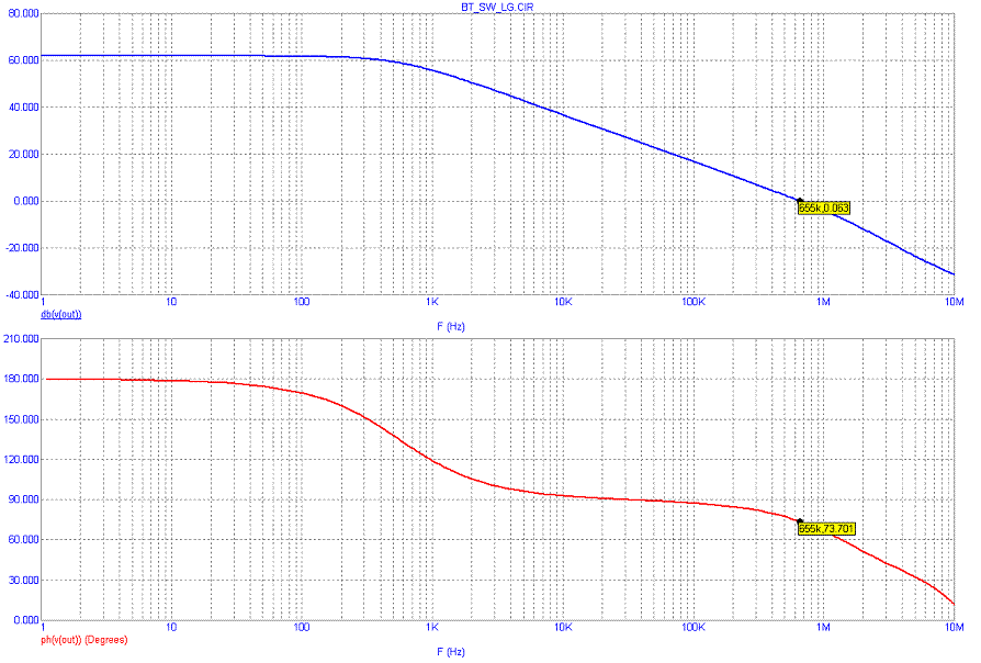

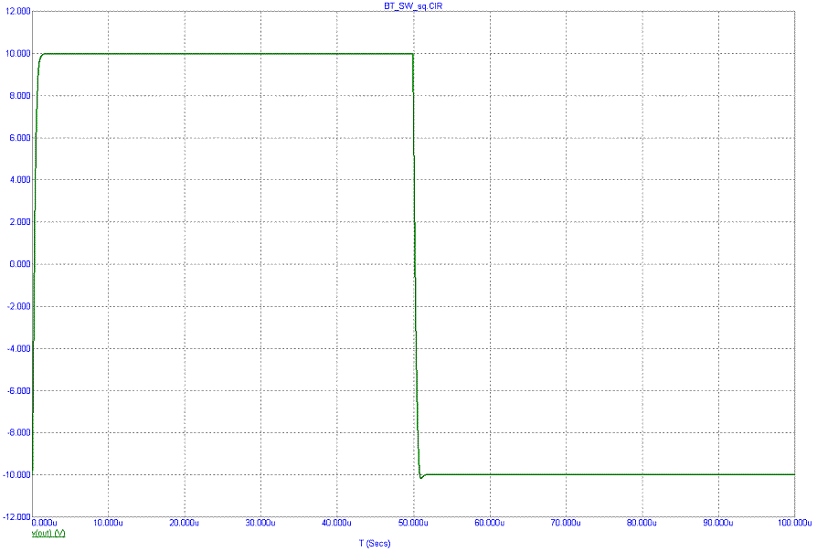

PMA said:Started to play as well ...
Try making C1/C2 equal to C3/C4, this should result in PSRR improvement

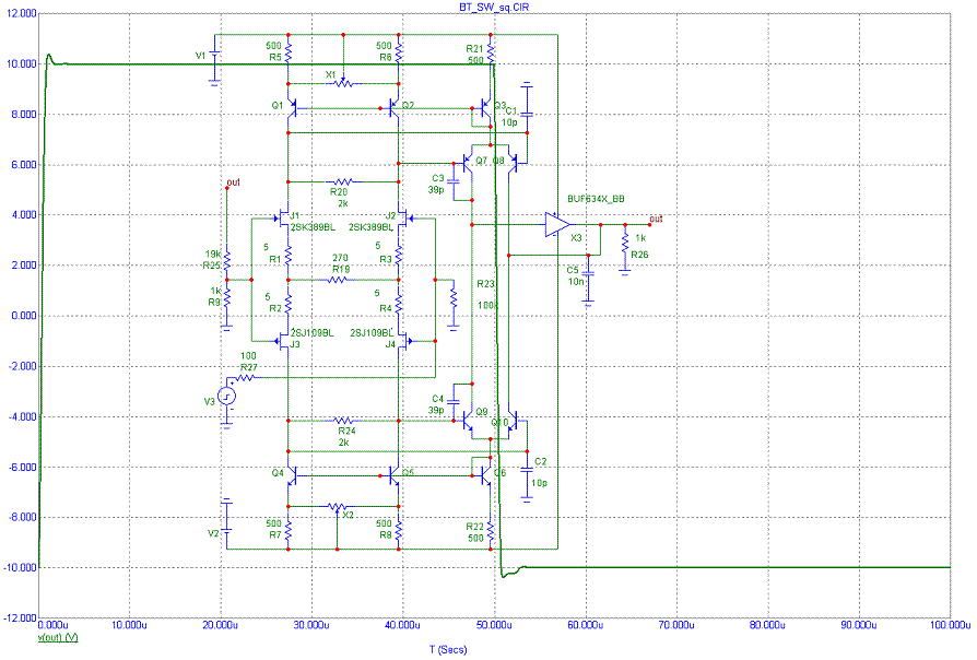

PMA said:10nF cap load
Good or bad, this has almost nothing to do with Scott's circuit, but mostly with the buffer model you are using.

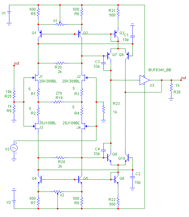

bear said:I think I have seen this circuit before... not quite sure where at the moment...
Btw, what was the purpose of the 2k resistors between the jfets?
Trying to follow along in my Libretto...
_-_-bear
It is possible you have seen this before. A very similar circuit was published in 1990 by William C. Snyder in "Class A Audio Design".
_-_-bear
More nodes with "infinte gain" than degrees of freedom. For a particular set of device offsets the DC solution is singular in simulation as well as in reality . The 2k resistors allow some differential current to flow when you use current mirrors.
As I stated the first time it's was an attempt at a complimentary version of the OPA627. Once you realize the self biased FET's can substitute for the LTP's you can go through and "Muntz" away. I think the first use of this CMFB was by George Erdi at PMI in the 70's. I happen to like this better than the one transistor mis-matched resistor take off, which BTW I don't consider truely full complimentary symmetry. The top and bottom transistors act like an LTP with one side pnp and the other npn.
My humble opinion is, to try Zobels in parallel with 2K resistors instead of all that 4 capacitors.
PMA said:Will depend on the CLG gain chosen.
I suppose, UG stability may be sacrificed in lieu of sound quality, right?
