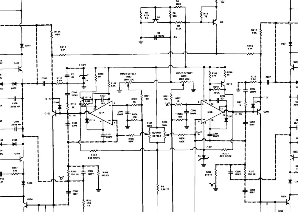

I plan to keep the case and heat sinks as I want to restore not rebuild. The output board will only fit the exact layout and position of the existing set-up. I have it in soft format and ready for tweaking. Nothing is in stone and I need more tech input from the brains who have downloaded the schematic from Crown Web Site and are reviewing it as I type this.
I am no PEng so I will need some serious input if I am to change the circuit. There is a lot going on in this design and it is much more complicated than the look of the amp itself. I consider the foot print, era and power to make this an exceptional design. It needs a little modern twist.
If it is all nine, then I will replace the components and put it back together, still it should be better than new.

Yes djk, and I wait to see what is to be done on the dysfunctional OpAmp. I think it makes sense to cook up a new driver board, I think. It is where the sound of this amp is born. It is where the Glass can be broken and the warmth of mother's chest can be introduced to the circuit.djk said:If making new boards, consider a newer Crown design.

Chris,
I would like to replace all of the components in this amp and hold on to the weird parts that can't be easily replaced like the funky inductors. I am ready and preparred to etch a new driver board and two output boards. I don't feel that many components can be removed with out wrecking the pcb trails anyway.
I guess I'm a little carried away with my forward thinking.
All I really want to do is improve it where possible knowing that I am etching all new pcb's for the amp. I don't want to end up with an entirely new amp.Looking at the schematic I will need:
-Substitutes for all of the transistors.
-If the power supply feeding the OpAmp is deemed ok then I can just change the layout for the pcb around it to accomodate new OpAmps?
-All passive components replaced with higher tolerance components. As you say and I love this quote, " All ceramics meet Mr. Hammer. Time for mica and the poly sisters."
That is the extent of my intentions but if there is obvious room to tweak a few things, I'm game.

Hi Shawn,
That sounds perfectly reasonable.
Be....all you can be....... Arrrgh!
In keeping with the spirit then, figure out where your mounting limitations are. Plan for new components throughout and lay out your improved design. Forget trying to use subs. Figure on using the most capable parts and understand that you will have to play with the stabilization of this amp. You may even incorporate a DC servo to null out the last few mV.
You can design a daughter board to mount standard pinout type op amps to the existing design. That way you can try both, even LM318's to test components available at the time the amp was built.

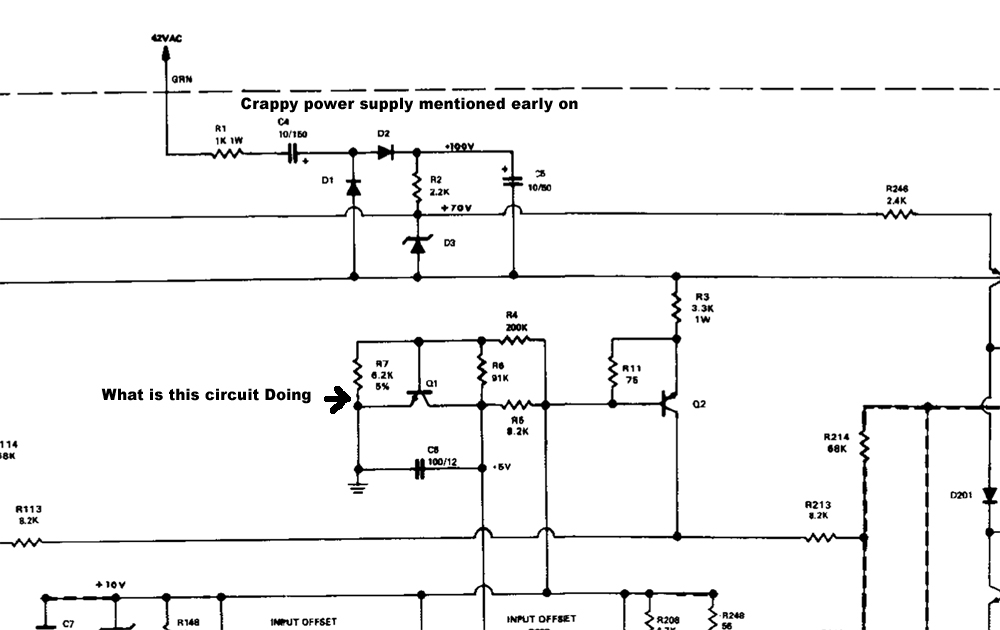

More of the schematic is needed, I'll check mine. That "crappy" power supply did it's job fine. It was enough for the job at hand and saved them another winding or tap. Yes, it often needs repair but not so much that the amp wasn't reliable. MTF was measured in years.
Hmmm. Might be a house number then. I must admit to being hyper sensitive to anything remotely ECG sounding in older amplifiers. I haven't cracked that manual open for at least a year, so it's time for me to have a look.The numbers are from the service manual
