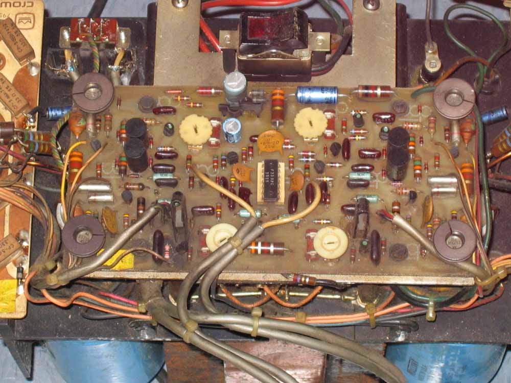

Ok I'm off to do the transistor substitution analysis. Sorry Shawn but by the looks of the photo of the input and driver board, I would replace everything....xept the inductors (why the .....have they got inductors?)

The OpAmp on the preDriver boards says:
F739PC
7511
(would that be 1975 date code?)
It is 14 pin dip, how nice, it has a socket! There is an OpAmp pin out and internal diagram inside the PDF from Crown. This amp is almost as old as me!!!!

Yep, it's 1975, 11th week. It is not a normal op amp either, but you could adapt one. They still have some of these original ICs hiding around, but they are dear. Be careful with the one you have.
A PCB rework using new components may be the pinacle of performance for this amplifier.

I remember this design. The 739/749 series from Fairchild were kinda weird first generation low noise opamps with a common emitter output stage (?!!). If I remember correctly, the 749 had an open collector output. With some jiggery-pokery, these could be used as the front end for a power amp. Why anyone would bother these days is beyond me. There is enough room to ditch the input board and build something decent like a fully complementary lineup a la Leach. If the output devices are original, I would ditch them as well, as better things have been available for years. When I look at the rust on the power transformer and see all the open carbon pots on the driver board, I cringe. The amp was lucky to survive.

This is what I would want to strive for by keeping the essence but upgrading where possible. Could be a pipe dream because...
wrenchone said:
...There is enough room to ditch the input board and build something decent like a fully complementary lineup a la Leach. If the output devices are original, I would ditch them as well, as better things have been available for years. When I look at the rust on the power transformer and see all the open carbon pots on the driver board, I cringe. The amp was lucky to survive.

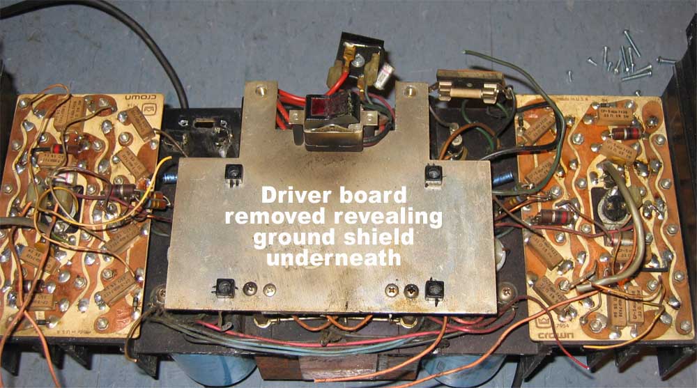

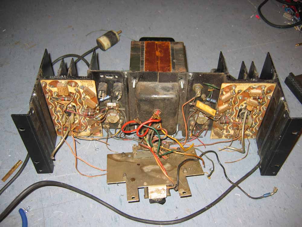

because I kinda agree here too Wrench. I'm very worried about the output devices. Come on, the PN junctions have got to wear down and start leaking? But that is a little too soon as I will test them to make certain. The XFMR was sitting directly on a wet cement floor for 1 or two 2 years; I think it stood up well. The amp has been serviced, you can see in post #37 on the low left a brand new resistor and transistor. The areas I marked with the white box in post #37 have serious heat damage on the surface of the components. This driver stage had little and almost no heat sink to dissipate and it shows. However, this can be rectified.
