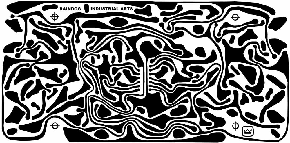

Here is the other PC board. So we have artwork for full-on retro rebuild, if that is the way to go. I'm kind of sitting on the fence. I thought more people would take the time to vote in the poll? And all those people wanting to take her out to the cottage and drop her off the wharf? Tisk tisk.
Chris, regarding oscillations the current bandwidth is listed for the MJ21194 on the On Semi sheet as 4 MHz but there is no spec indicated on the 2N3773 data sheet. ??

Hi Shawn,
Incorporate new devices in your layout since you have the chance to do so. You may end up with TO-220 or TO-126 types instead of the TO-5 originals.
The MJL2119X types maintain gain to higher current levels. The curves are a little flatter. The same goes for new drivers and other parts. It was common for parts like the Fairchild to be faster and have different compensation than other (motorola and other) brands. I thnk I remember that right. Point is, different outputs needed different compensation and they recognised that way back then.
So, compensate for the faster devices if they indicate that in one of the schematics and you may need to work on it some more.

Yes, the image you see is soft, now that I have it on my PC it is like clay in my hands. As the devices are selected (IF) I will then tweak to embrace the different components. First things First, the image needed to be brought on board. BTW, both pieces of artwork were done painstakingly by hand in photoshop! I must be crazy?

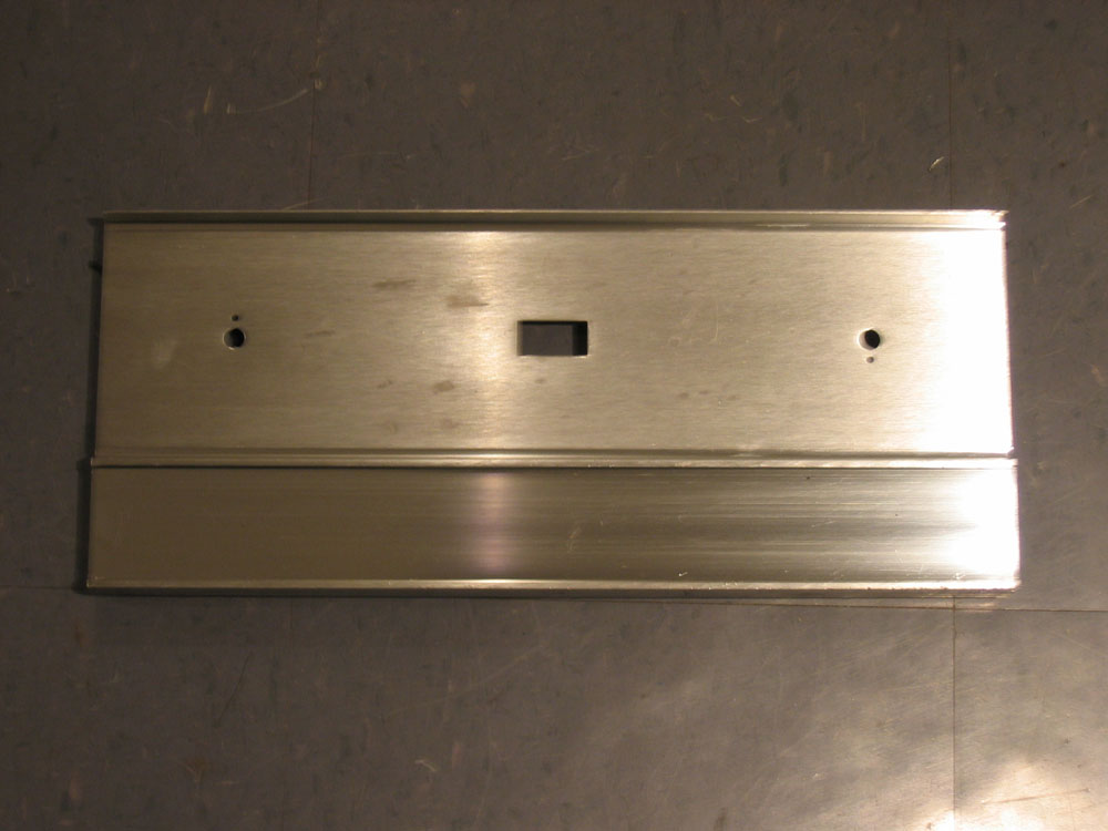

Front Panel
I stripped the front panel and it was in rough shape. I gave it a hair cut and little scrub & polish but it has these stains. The stains seem like some kind of acid was splashed on to it. I sanded it with scotchbrite very hard but still the stains won't come off?
It looks good but I think it should look better. Any ideas how to remove the blemishes?
Shawn.

Re: Front Panel
If it's aluminum and it's truly etched, they won't come off. Since you already scotched 'it, I'd give it a go over with a flapwheel sander or rotary scotchbrite type finisher, and try to even out the satin luster @ about 140 - 200 grit or so... give it a kinda "brushed chrome" finish.
I was trying to look at the b4 strip picture, but couldn't find a whole shot to see if it was etched b4 stripping.
The advantage of the brush finish is it hides damaged areas where the metal was dinged from being dropped and banged around, and, done right, looks pretty classy. You could then have it anodized and dyed to whatever color (puce?) maybe you want.

Yes, I will send it out for anodized treatment. I think it is logical (if) I get this restoration/rebuild right, then I'll get a gold anodized finish. You know, from silver to gold! Heck you can go blue or whatever you want these days. I even checked out a DIY set-up from some dude in the US that shows exactly how to set up the process at home.
I've got to sand that cover down with something and I may try the flap wheel next. I'm a little worried about consistency and not putting groves on the face? Tomorrow over first coffee...

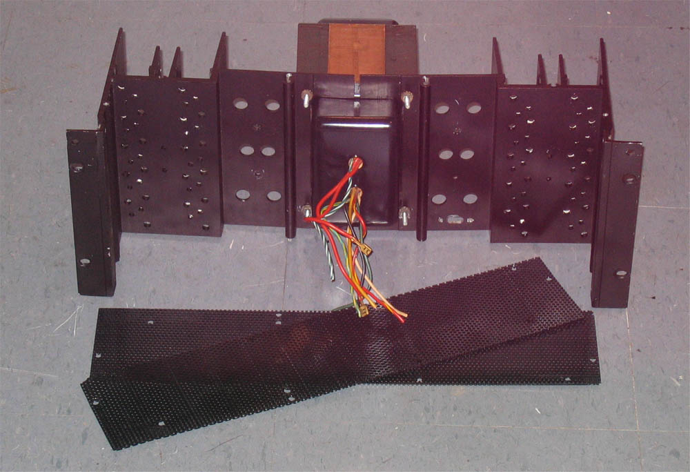

Getting better
Here is some cleaned up metal. Not so bad after all. Steel wool on the rusty XFMR and then I coated it with some new coil winding laquer. The top and bottom grills along with the bells from the XFMR were painted and baked today. The heat sink is mint as I did not touch it other than cleaning it with simple green and a little water.
Shawn.

what i meant was if there was any damage b4 you did anything where the stains showed up?
Anodizing isn't too hard to do, need about 36 volts AC @ 20 amps/ft^2, a 180 F sealing tank, and some etch and acid dip tanks for pre-treating...

I wish I had a macro photo option on my camera, then I could give close ups. These blemishes are on the surface of the metal and there is one good scratch in there too...
I just rubbed it and took a good hard look at it, they are not chemical stains at all, they are divits in the metal by a drill or a grinder or some gouge marks that go perhaps .1mm under the top surface. It looks like someone sanded out the old scars before and after I stripped the paint, voila. I guess I understand what you were saying earlier.
I can fix it, I need to sand out those areas gently with something powerful. I have a hand held grinder but what attachment would be best?
