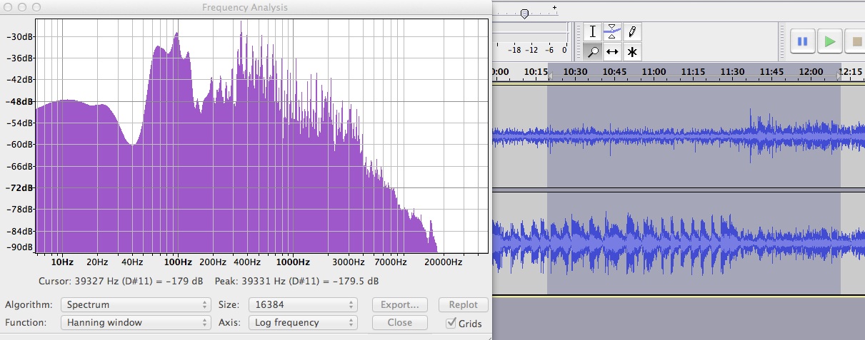

I did some measurements on a 124 Mk1 with worn steppulley bearings they produced some annoying noise .
FFT with accellero meter from B@K on the chassis from the turntable .
Results speak for themselfs.

I"m note sure what I see on your spectrum plot the bearing frequence at my measurement is at about 400 Hz -500 Hz after replacement the noise is -20dB down on the 400 Hz level it runs quiet now .

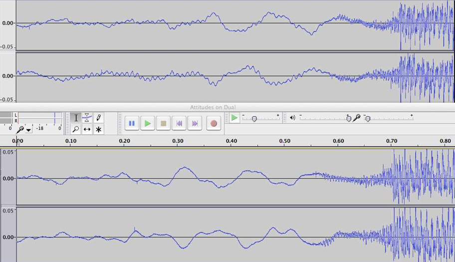

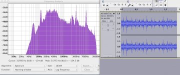

Volken - I took the spectrogram several months ago, but failed to take another one of just the silence, which would have let me identify the frequency, instead of just representing it as a "squiggle" in the silence prior to music start. I suspect though, that mine is in the 400 Hz - 500 Hz range too. Next time I hook up the Thorens I'll see if I can narrow it down.
When I first posted about this many months ago, I noted that it seemed as though I could see a mild oscillation in the top axle for the stepped pulley, but that I'd not been able to determine if it was the bearing or a bent axle. I bought a kit a month back that has several bearings in it (we think it originally came from Schopper) and I think one of them is for the stepped pulley. I need to confirm that and do the replacement so I see if that resolves the problem as it did for you
EDIT: Apologies. The pic I posted today is obviously the waveform, not a spectrogram. Foolish me for not pulling one at the time
TD 124/II spectrograms

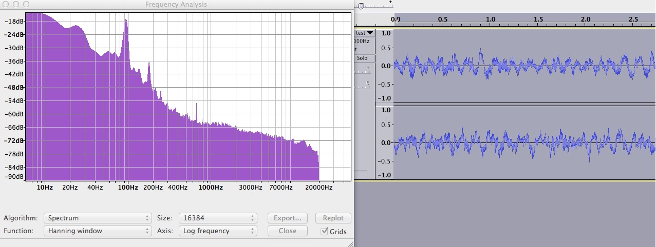

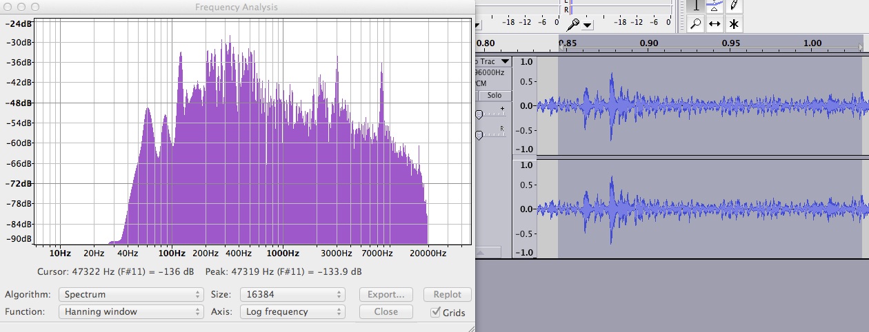

My curiosity got the better of me, so I hooked up the Thorens to a preamp, recorded an album, and took screenshots from Audacity that show both the waveform and spectrogram for select portions of the recording. The screenshots I'm posting here are from John Coltrane Quartet - Ballads (ABC/Paramount Impulse!).
The recordings were done using the preamp's direct mode and no clamp or center weight was used, so this is pretty much what you hear is what you get.
I won't upload all the pics, but here's the run-down.
(1) the lead-in to track one.
(2) the silence between tracks one and two.
(3) a one minute segment of a track approximately 11 minutes in to side one.

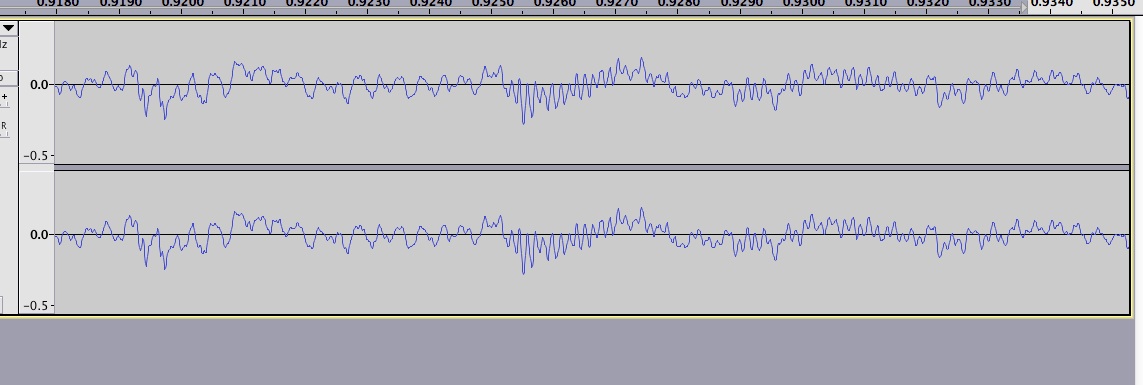

(4) A sample of silence, de-clicked (ClickRepair) and amplified to -5 dB. This one I think shows the main issues most clearly.
As I reviewed the pics, I could see that the "squiggle" apparent in the waveform corresponds to the 100 Hz spike on the spectrogram. This was actually the second record I studied this way today. I decided to post the Coltrane shots because while the noise floor below 40 Hz moves up markedly to -48dB on this record, it was a lot worse on the other one.
While it's not apparent on the charts, there's also a lot of noise coming from the stepped pulley which may be related to the bearing, just not sure of that yet. Putting a mid of downward pressure on the belt eliminates this noise. Because this noise is pretty audible, I uploaded some videos to YouTube and will post links to those separately.
For background, at this point very little has been done to this turntable, besides a quick lube of the motor and spindle. My intent with these pics and vids is to establish a baseline. I will do the restoration/maintenance one step at a time and after each, pull similar charts so it'll be easy to tell when something I've done has made a difference (hopefully for the better). Any thoughts that come up while looking at the pics & vids, please post!

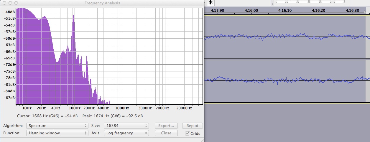

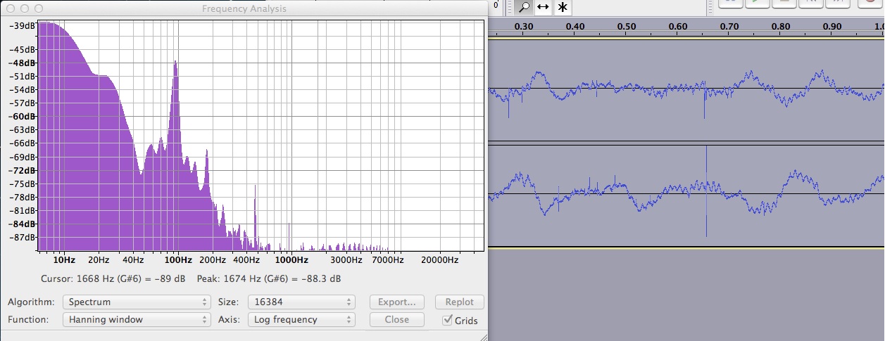

Thorens TD 124/II waveform using external mic
Last night I posted some screen grabs taken from a recording, focusing primarily on the silence between tracks. The idea was to create a baseline of noise, primarily from the stepped pulley, so I'd have something to compare as I renovated the turntable. Obviously by using as my sound source the silence between tracks, a lot of noise sources were included in addition to the noise I was trying to focus on - anything from the platter spindle, the tonearm gimbal, and the vinyl itself, but it was a start. I also posted some Youtube vids that let you hear what I was able to pick up with the iphone mic placed close to the pulley.
This morning, in an attempt to remove some of the other noise sources, I did a similar experiment, but this time recorded audio into Audacity via the mic built into my earbuds. The mic was taped to the inside of the chassis, a few inches from the stepped pulley. Once I'd captured the sound, it was amplified 40 dB to a -1dB. Without that amplification much of what the mic captured simply wouldn't render in the spectrogram. It did, however, amplify the noise to such a degree you'd think a freight train was going by on really bad tracks!
I've no idea what the frequency response is of the mic I used, but I'd guess it's been optimized for voice. Still, it picked up quite a bit on the low end, and as the primarily noise from the stepped pulley is quite audible, the mic did a reasonably good job.

Detach your tonearm from the deck, and use the pick-up to record noise. Make sure the tonearm board is fixed and stable, and that the tonearm can be swung over the deck.
Lower the needle on to the deck, close to where the wheel drives the platter to register its noise, and close to the engine, to register that.
Very effective way of localizing your readings.
