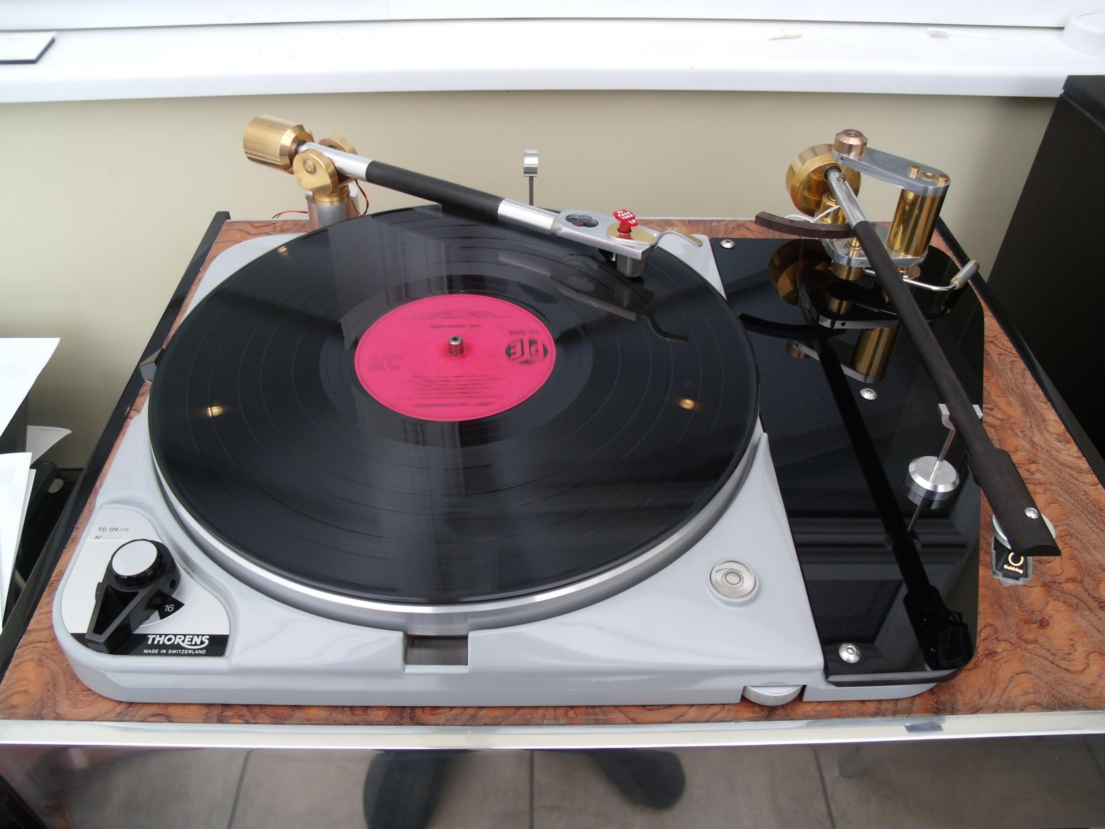

Hello to everyone,
I would like to share with you the work I did last Saturday on my Thorens TD 124. My table has received a new upgrade: new idler wheel, new step pulley bushing and three brand new gel motor grommets. Let's start with the first point. Last week here in Munich there was the Munich High End, the biggest fair of High End in Europe. I had the possibility to talk with Simone Lucchetti, a man from Rome who is very known in Italy to be a great expertise of TD 124. Lucchetti developed its own idler wheel, therefore I decided to give it a try. The idler wheel is in aluminium and its weight is 54,34 gr: the original idler wheel has a weight of 66,88 gr. The new idler wheel mounts rubber o-rings, that can be easily changed. This idler wheel should reduce a lot the rumble and improve the turntable performance: well, I can confirm that rumble is reduced, on the other hand I don't notice big difference in the turntable performances in the cold phase or in the sound.
Than I replaced the bearing of the step pulley: I remember that we have talked about it here on the forum. Changing it is very straightforward, I just used an M4 allen bolt, a nut and a pair of washers plus a piece of rod, in order to receive the old bearings. Here a photo of the old bearings (on the right) and the new one (on the left), bought from the spanish seller that we know.
Hear the new bearing in place
As you can see, there is now only one bearing, instead of two, whose total length is equal to the sum of the previous two. The noise coming from the step pulley is now reduced a lot, therefore I am happy of the installation, considering also the tension I had doing the operation. As said it was not difficult but in any case a stressing action
At the end I mounted the three gel motor grommets: honestly said, I see an improvement in vibrations' absorption but not as much as I expected. Here a shot of the TD 124 after the work.
Finally, I would like to share with you also my experience in replacing the bearing of the original idler wheel. Something strange happened: I bought two replacement bearings always from the same seller in Spain. The bearings, before fitting them, could easily be mounted on the idler wheel shaft. I replace the first bearing in the idler wheel: I tried to fit it on the shaft and the bearing didn't want to fit on it! I thought "something wrong has happened, let's try with the other one". Same result: I measured the inner diameter of the mounted bearing, it was only 4 mm instead of 5 mm (diameter of the shaft). It seems that those bearings change their internal diameter, maybe due to the compression of the idler wheel's walls. Has anyone of you already mounted those "spanish" bearings on an idler wheel? What are your experiences?
I've terminated my post, I hope it was helpful for the TD 124's community. I want to say that I don't have any affiliation with the idler wheel's seller, I want only share with you this new possibility of replacing idler wheel.
Cheers
Maurizio

Maurizio,
Thanks for sharing the updates. Interesting your experience with the idler wheel bushings - I'd have expected them to be sized correctly for post installation..
Most interesting IMO is the new idler. Would be interesting to know whether or not the new version transmits, more or less noise from the intermediate (stepped) pulley as compared to the original part.
There is no benefit I can see to installing a new line cord other than potentially enhanced safety and/or convenience. It might not be a bad idea to install a 3 wire cord with safety ground which would allow you to ground the chassis. In this case do not tie the arm and chassis grounds together in order to avoid ground loops.

Hello all, i'm also interested in that idler wheel it looks great. i use a 3 core flex on mine with an earth with no hum problems at all. i've only recently noticed this forum and it is very informative i could have done with it when i started rebuilding mine. lots of experience and knowledge. this is mine so far. i say so far because their is always an improvement to do

Hello,
I've replaced my original idler wheel with this O ring idler from Simone lucchetti. It's beautifully made and works perfectly. Using my stethoscope on the armboard to listen to the rumble and motor noise coming through, I can tell it is much quieter than with my original. My TT is the MK I model and I'm using the single gel type grommets per motor post. Simone sells the longer motor posts to convert to a MkII motor mount. He also sells the MKII motor coils which will enable the motor to provide more torque.
The change in idler has change the the sound of my system. How exactly, I am not certain. I need to listen some more and swap my old idler back in to compare. My initial reaction: my system sounds better. Sorry that's all I got for now.

Hello ,
I bought two idler wheels from Simone too.Simone is very nice and easey person. My experience the wheels runs quieteras original wheel but the bronze bushings diameter of the new wheels is not the same, one idler wheel fits perfect and the othe one has slihgtly large busching diameter. Maybe I´ve got the bad one. The black O ring is also not perfect it has a seam in the midle and it couses some rumbles and the rubber is to hard.But it better as original wheel
But I ´ve got the other problem , my motor runs now slihgtly to fast, the brake is so close as possible, the speed ajustment turned max to left. Any one can help?
The motor worked well before, The Idler Wheel diameter with the O-Ring is 81mm

Hello ,
Hi, I've also noticed this little imperfection of the O-Ring and noticed some rumble. By the way, I solved it just turning the O-Ring in the idler wheel profile, in order to put in contact the "clean" O-Ring surface with the step-pulley.

Is the platter turning too fast also when the original idler wheel is mounted? I haven't noticed appreciable difference of the diameters between the original and the new idler wheel. Therefore I don't think that there's an effect due to a change of the total transmission ratio. The only thing I can think of about a possible cause is the magnet of the eddy current break. Are you sure it has still got its magnetism, I mean 100% of its property? I've read somewhere in the forum that some people did notice a decreasing of the magnetic effect, it turned in a too fast turntable. They solved the situation changing the magnet. Right now, there is a magnet on Ebay.

All O-rings have a seam. When it is exessive it is called flash. You might try to buy a higher quality O-ring. While you are doing that, you could also try O-rings of different hardnesses. In the US, the hardness of O-rings is measured as "SHORE" hardness with a number such as SHORE-50. The material also makes a difference. If you go to the WWW.applerubber.com website you can learn much about O-rings.
I can see why your motor runs too fast. The O-ring has a curved face. It takes less force to push it against the inside diameter of the platter and therefore the motor sees less resistance. A softer O-ring might solve that problem.
The diameter of the idler has no effect on the rotational speed of the platter. The diameter of the idler in my TD-124 is 79mm.
I hope that I have addressed all of your concerns.

Thank You for reply.
Motor: I don´t think so... The turns of motor depend from how much Hz, Voltage and A comes in.If the motor is in bad or not cleaned condition it might turns slower. I cleaned it and got the good results, the speed was correct at first.
My guess the curved profile of O Ring makes no differens, it might comes to better or worse results to how quick the platter rich the right speed.But Im not sure.

The TD-124 motor is an induction motor. It is NOT locked to the line frequency. If it were, the Eddy Current brake would make no sense. Variations in load will make it run at different speeds. You stated that the motor ran at the correct speed before you changed the idler. So why wouldn't you suspect the new idler? The original idler has a flat face where it engages the platter which puts a larger load on the motor than the round faced O-ring does.

I have bought the same wheel and when I swap between that and the original
there is only a very slight speed difference which I can correct within a 1\4 turn of the speed adjusting wheel so I'd think Oregon's problem lies somewhere else...
