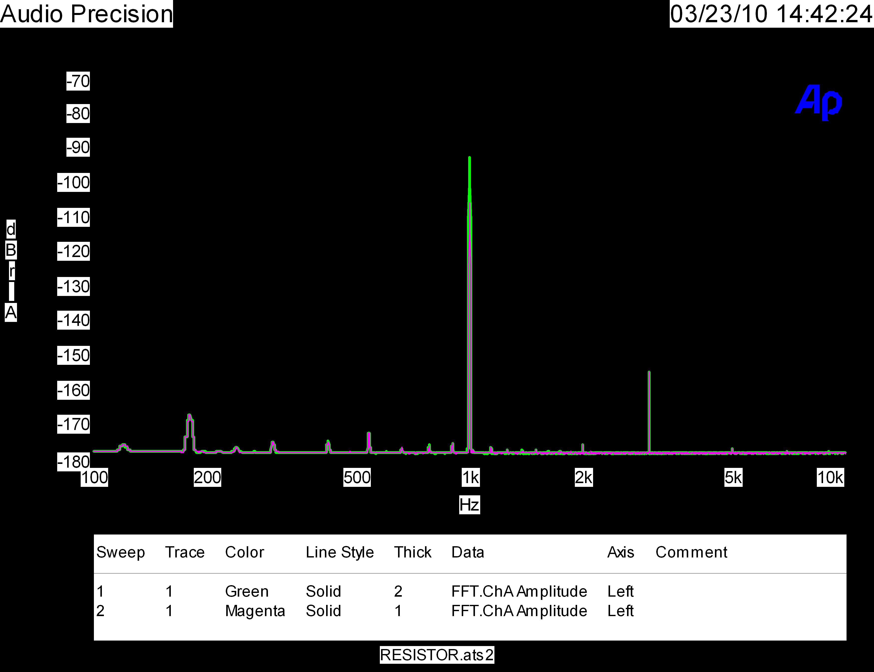

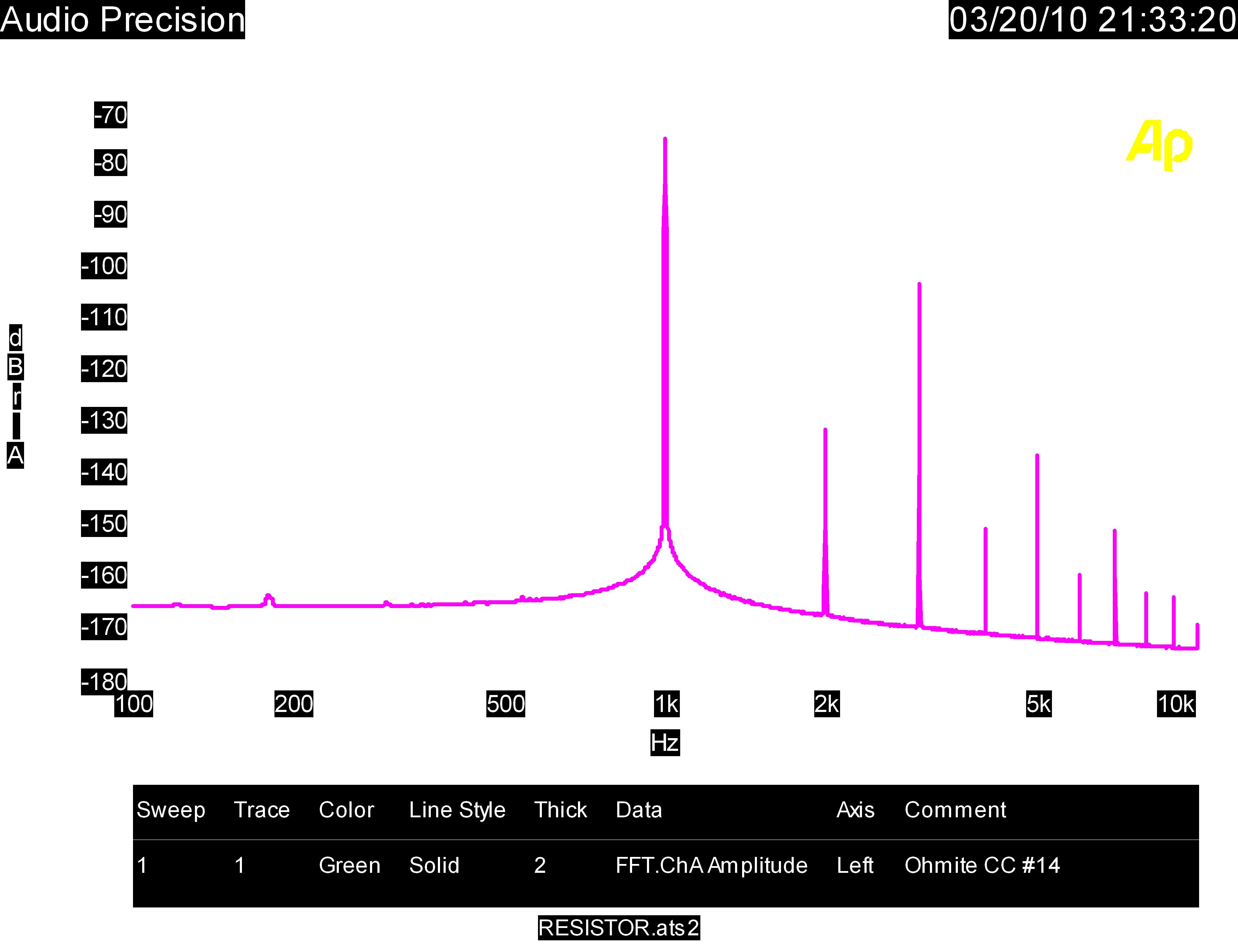

Here are the distortion measurements for an Ohmite carbon composition resistor and a Resista brand one.
Both are measured at 1 Khz and the test tone nulled as much as possible. 0 dB reference is 15.8 volts the resistors under test have 1/2 of that across them or in other words the power is 1/16 watt.
For full details see Linear Audio Vol. 1.
