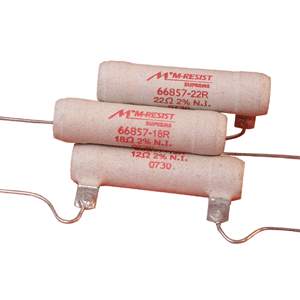

recently i have removed the vishap resistors and used mcap's mresist resistors on in my speakers...these resistors are real nice...the sound quality is much better than before:D

Hmm, its quite odd to have a "much better" effect like that at large signal. Perhaps the previous resistor (that was replaced) has much fiction in its advertisment/datasheet?
The usual approach tends to work as well--This is take two or three of cheap 5w resistor and parallel them (speaker resistors). This makes for half the inductance or less. And its not reliant on truth in advertising. :)
Some people get really brainy and parallel several of the really inexpensive 3w resistors because those have generally higher quality anyway. I haven't explored that technique.
