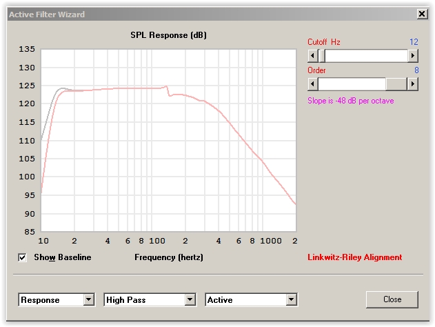

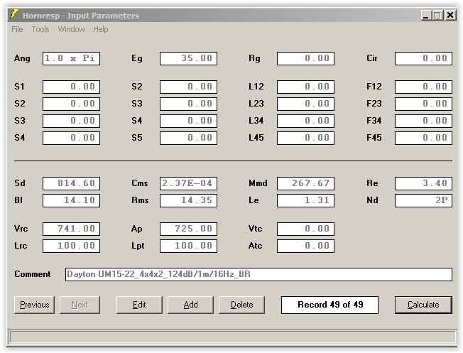

Since the UM18-22 may just be "vaporware", I've been playing with the UM15-22 to get as close to my goals as possible. It winds up at around 124db at 16hz with only 35v which is a much cheaper amp. The box is still 48x48x24 and contains 2 drivers.
Here's how it looks so far.
Steve

P.S.: Hi Xrk971, the Hornresp Input in Post #79 is after calculating backwards from the drawing. I tried to take all volume losses into account. The duct length is 35.5", the cross-section is (5.5"x22.5")-(5.5"x0.75"x2) (raw opening minus dividers), or 115.5in^2.

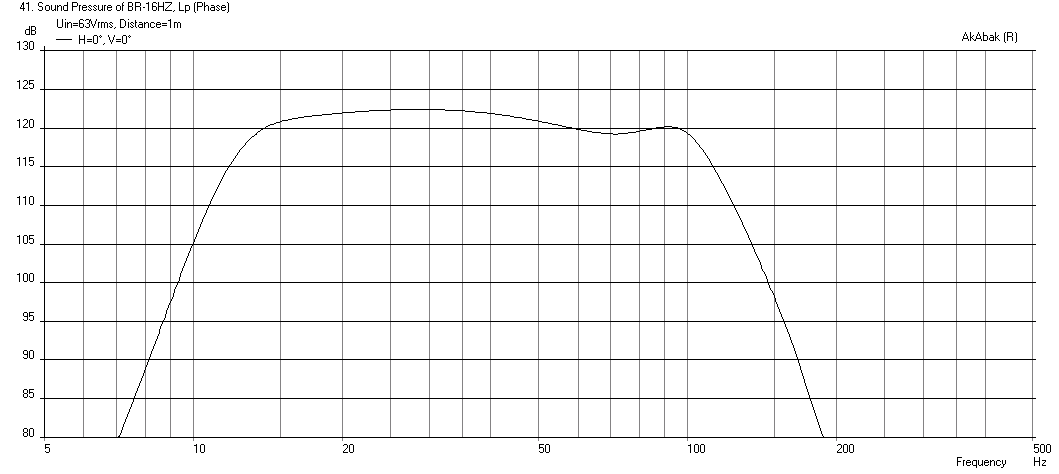

Tb46,

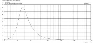

Thanks - I put 684 liters as the volume and adjusted port size to account for brace and realized I did not have 1-pi output setup correctly. Here it is with same dimension as yours and 1-pi with 64 volts rms to get xmax with 12.5 Hz 48dB/oct HPF and 100 Hz 48dB/oct LPF. I get about 127 dB at 16 Hz. There may be an issue with port velocity being 28 m/s that is pretty fast (about 63 mph) which may cause some turbulence noise/chuffing. Also, the group delay at 16 Hz is about 67 ms which is the problem with many BR designs at the deepest extensions. I think 67 ms is substantial and may be unacceptable from a musical timing standpoint?
SPL vs Freq:

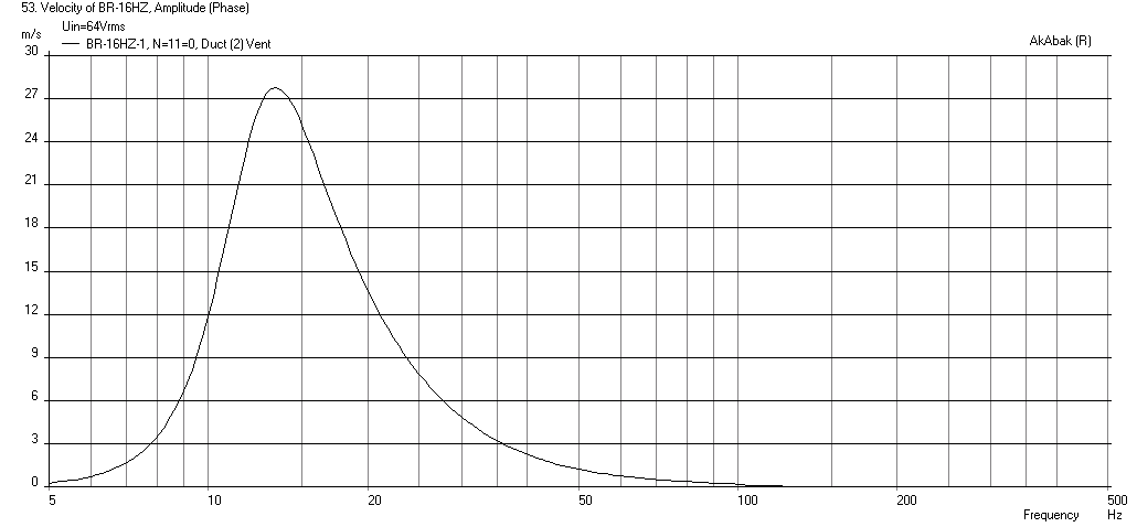

Port Velocity:

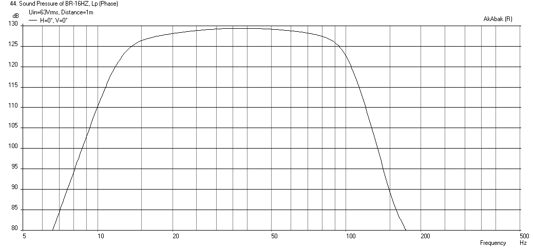

Group Delay:

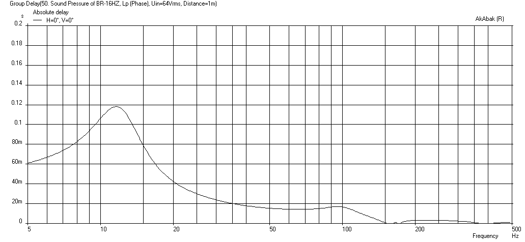

Hi xrk971,
Remember that those frequencies are there to replicate a pipe organs lowest notes. Pipe organs inherently have severe delay in some of the pipes due to the mechanical lag in servo valves and air flow.
Now if these were intended to be used for dubstep and electronic music the delay could be a problem.
Steve
The additional delay would exacerbate the servo-mechanism delay in a recording. But you are saying that since this is meant to play live music, the delay would actually replicate the inherent delay present in a real servo actuated organ pipe?
Hi xrk971,
I don't think that group delay in the lower subwoofer octave (e.g.: 15-30Hz) has been fully researched yet. I tend to feel that it is not too important (no solid data to support that assumption). I have seen an "audibility threshold" suggested as 1 to 2 cycles of the respective low frequency; at 15Hz that gives you something between 66 and 132 msec.
The problem of driving the box resonance lower to lower the point at which the group delay reaches maximum is that you then raise the displacement of the driver at the upper resonance peak. So it's probably a matter of compromises again.
One thing is for sure, that specifying a range of 15-80Hz, and an SPL of 125db/15Hz/1m/1xPi in a single enclosure within a limited enclosure volume makes for a difficult design challenge. THs don't have the range, FLHs are too big, CB need a lot of amplifier power, the list goes on .....
Just guessing, the room, electronic organ, drive electronics and the rest of the speakers for the extended spectrum will all have a greater influence at what all this is going to sound like.

I subtracted all volume losses caused by drivers, port and braces to get the attached Hornresp simulation.
IF this driver actually becomes available, and IF the T/S parameters are as presently stated (or close) this Dual Driver BR should get to the target of 125dB/1m/15Hz/1xPi. In 2xPi it clocks in @ 122.94dB/16Hz - taking 4dB off for power compression and losses we get 118.94dB/16Hz.
That would put it into an exclusive club, even the best systems on data-bass.com do not get higher, the Gjallarhorn comes close @ 118.3dB/16Hz, the DTS-10 LMS-R falls of another 2.3dB. Naturally, these are actual measurements in a 2xPi environment.

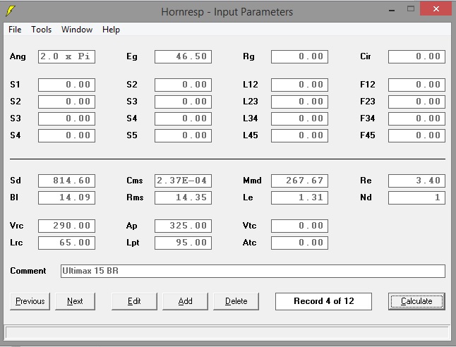

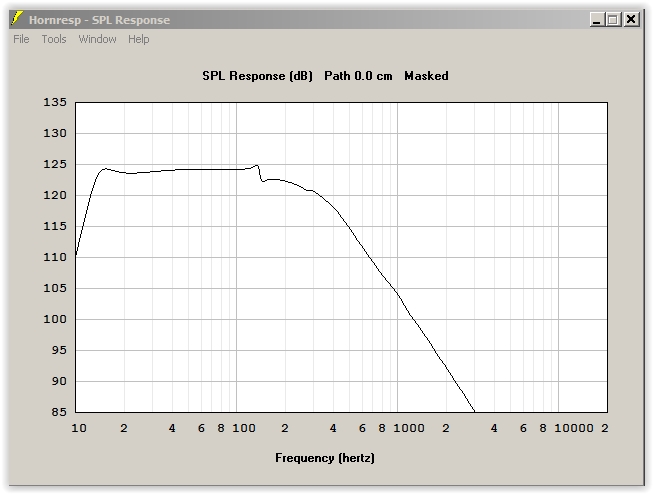

I've got a pair of Ultimax 15s in a similar situation, but two cabinets with single drivers tuned somewhere around 16 hz. They offer pretty good output, but honestly at some point in the future, they're going to be in something different...the BR cabs were "Let's just do this for now."
