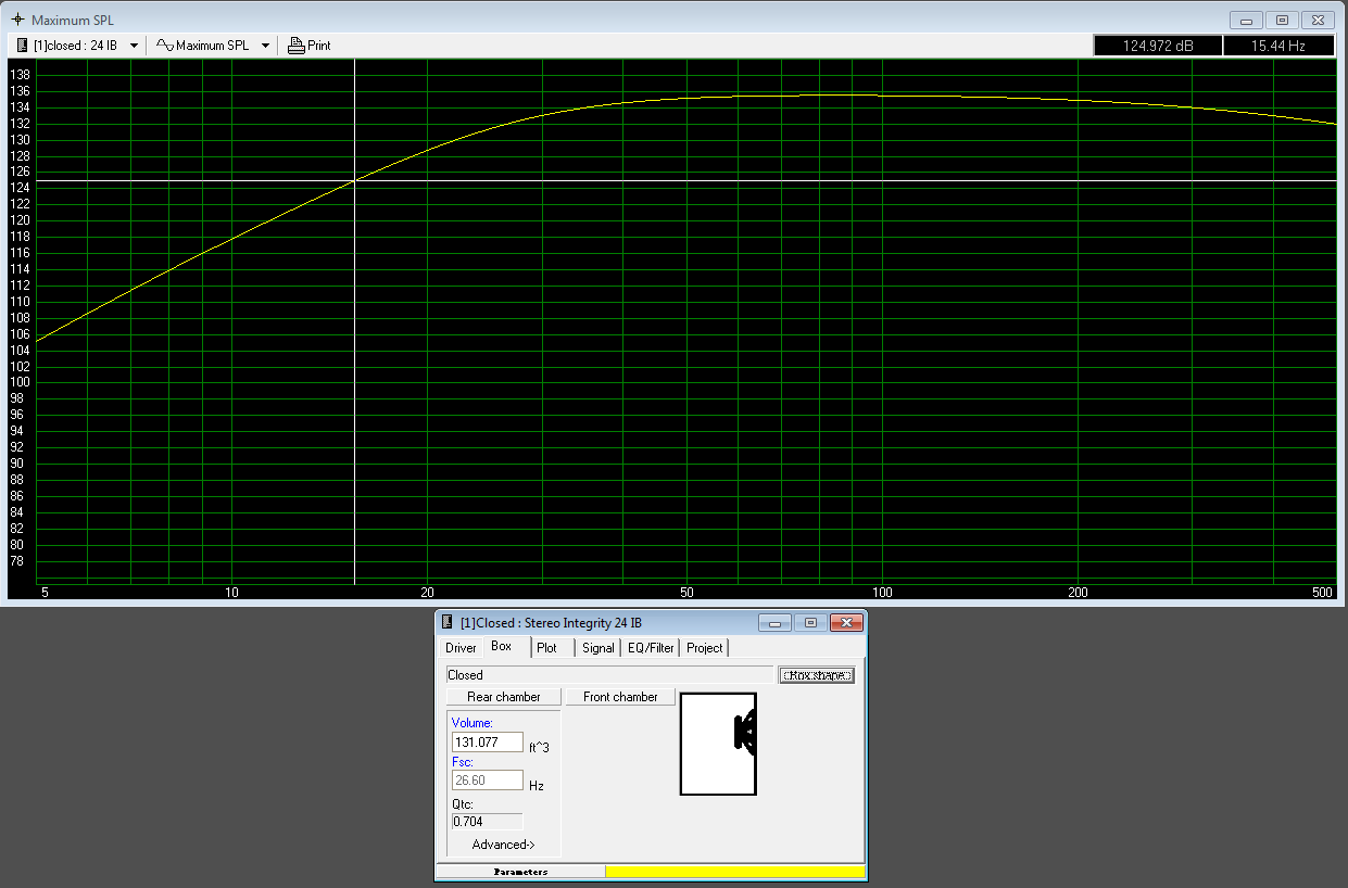

Steve,
If this is keeping within your budget, the simplest solution would be to wall off the old speaker chamber and manifold mount four Stereo Integrity HS24s. Put 1500 watts to each driver (fairly simple to do with the recent spate of high power, low cost four channel pro amps) and you should hit your target SPL. Four should be enough, but you'd have enough volume to add more if you felt they were needed.
I've been running one of these monster drivers in about 12.5ft³ sealed for a few months and have been pleasantly surprised at how well it performs, better than I expected and modeled. The HS24 compares favorably against the TC Sounds LMS Ultra 5400 going by what I've been hearing when switching between the two in my setup except the LMS-U doesn't make my room breathe in the single digits like the 24" does.

Steve,
Wow! That is one scary driver. And you are correct, I did a sim. $4,000 in drivers would accomplish the goal.

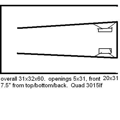

The UM18-22 is really interesting.
After running hundreds of sims over several weeks and fighting the laws of physics or Hoffman's law as it's known here, it basically comes down to finding an appropriate driver at a reasonable price. And Jim, after following you secretly from BFM to here and studying a multitude of your designs (it's all your fault! :mad:), there are several designs which can accomplish this goal. I just need to pick one and stick with it.
Interestingly, a tapered horn that you sketched out for Wisounds in 2010 is working really well. It is 5 feet deep and since the organ speaker chamber is actually a triangle, I could stack several (depending on driver arrangement) in there.
Thanks for the inspiration!
Do you remember this one?
