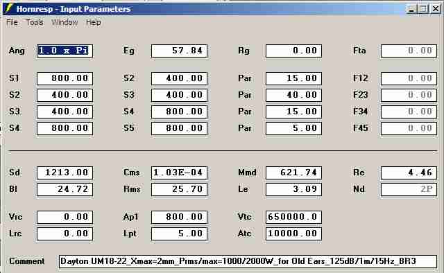

Looks like we got the size for the BR and the port just about right. Now it's just a matter of making it fit the cubby hole. Have you ever done any work on jet port as described by JBL? I have simulated them in Hornresp, but don't know what to think.
Just thought I'll post the Jet Port BR simulation, sure would be nice to know how far you can take that method without choking the port.
Don't know, my only experience with severe port compression was when I applied the bass reflex rule-of-thumb to a couple of McCauley 6174-8 MLTLs back when this was the Xmax ‘king’ by a wide margin and wound up with the mean area = to Small's 4.5% vent mach minimum.
Dual UMs @ 22 mm = 99.26"^2/640.386 cm^2, but your mean is only [400*800]^0.5 = ~565.685 cm^2, so too small for me.

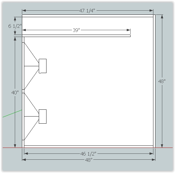

Well, it's the international day of labor, so I took some of my sitting around time to take a stab at a 2D drawing of the Dayton UM 18-22, and at a BR enclosure using Old Ears' outside dimensions.
Looking at it for a little while, I arrived at a more symmetrical layout w/ the port inbetween the drivers, this should also split up, and support the large side panels.
At the port inlet (inside) I added 2x4s (1.5"x3.5") to help support the edges of the port, there are two port divider braces running the length of the port, and all the way against the rear panel.
Additional 2x2 (1.5"x1.5") braces help to support the large panels. The drivers are mounted on a three board thick baffle that is set back to provide room for the diaphragm to move to its forward excursion limit.
From my experience I lean towards panel bracing and cross-bracing over additional wall thickness. If additional wall thickness is desired it may be a good idea to go w/ void-free plywood instead of MDF. MDF adds a lot of weight to a given panel, but its stiffness increase is not as high as that of plywood (which is also lighter); so doubled MDF panels will not raise the panel resonance as much as doubled plywood would; others have suggested using plywood inside, and MDF outside (North Creek?).
The nominal cutout diameter is 17", this needs to be checked on the real thing, as it looks like a smaller cutout circle might work for mounting from the front.

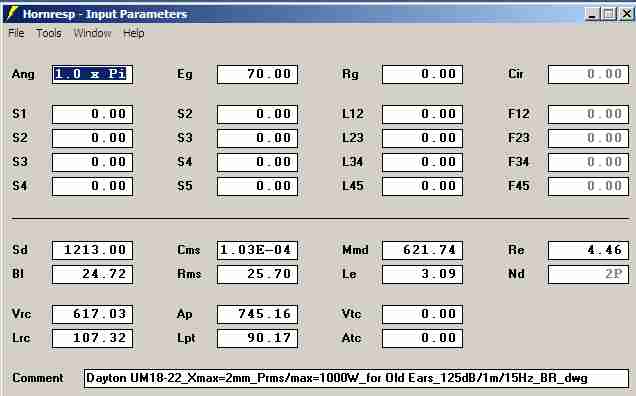

I subtracted all volume losses caused by drivers, port and braces to get the attached Hornresp simulation.
IF this driver actually becomes available, and IF the T/S parameters are as presently stated (or close) this Dual Driver BR should get to the target of 125dB/1m/15Hz/1xPi. In 2xPi it clocks in @ 122.94dB/16Hz - taking 4dB off for power compression and losses we get 118.94dB/16Hz.
That would put it into an exclusive club, even the best systems on data-bass.com do not get higher, the Gjallarhorn comes close @ 118.3dB/16Hz, the DTS-10 LMS-R falls of another 2.3dB. Naturally, these are actual measurements in a 2xPi environment.
Hope somebody gets to build this.
