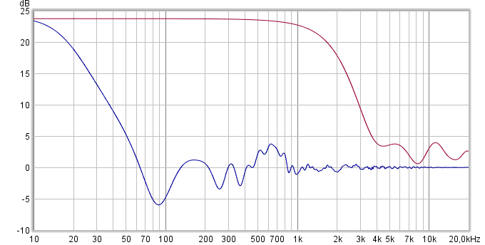

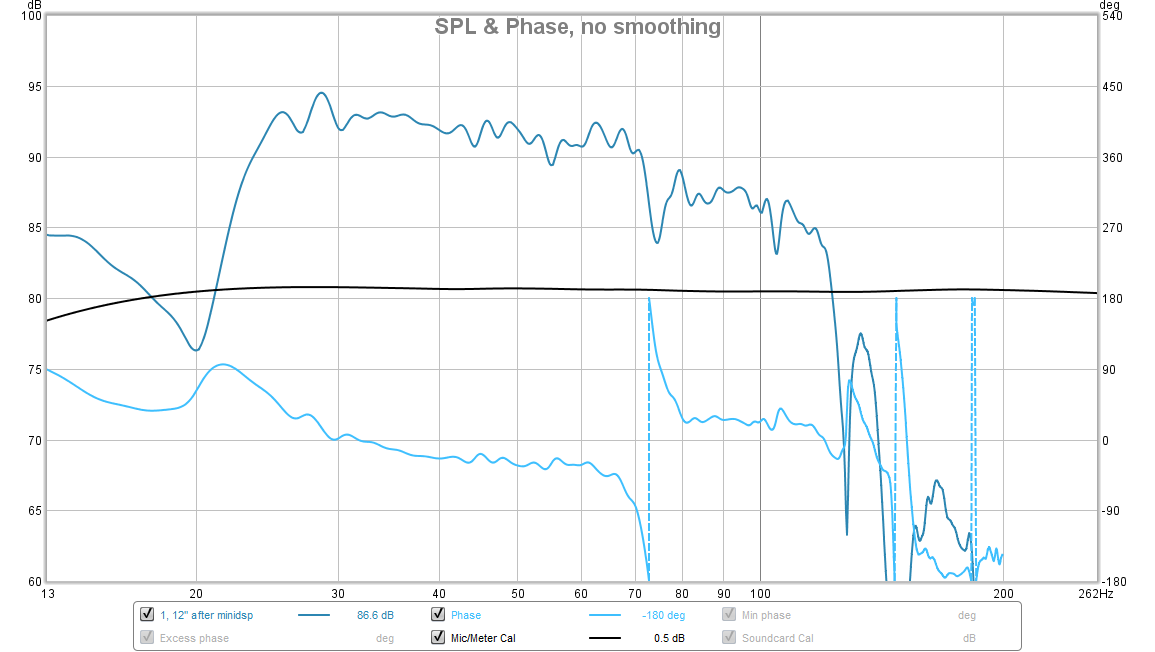

hi,
i have subwoofer measurement using REW, and the phase are not good.
attached please find my measurement, i measure the subwoofer in 7 position, and generated EQ using REW and applied to my 2x4HD.
the chart 10 is the measurement after EQ, and the phase has sharp drop.
so i use rephase to adjust it but i am not sure how to deal with a sharp drop in phase at around 72hz.
could any one please give me some hints?
thanks.

That phase shift at 72Hz corresponds to the magnitude sharp notch at the same frequency. If you could address that notch using minimum-phase EQ then you would take care of the associated phase shift in the same time.
Not sure you can and should address that notch though, and in that case the associated phase shift should also be left alone.

I am not very familiar with the minimum phase EQ, all I use is just the Auto EQ feature by REW. Would you mind tell me how to do a proper minimum phase EQ ?
I measured with mic on my MLP at ear level after EQ, and measured 7positions before EQ, also pos1 is the MLP.
Thanks.

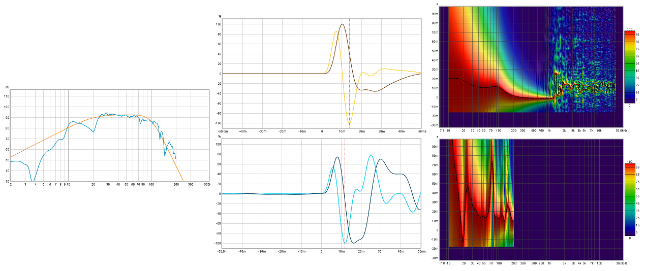

Agree what pos hints and looking your mdat file shows some user stuff had to been understood in the long run, observed is IR (impulse response) which is ground for calculate phase is not alligned on timeline and actual about 11mS too early so for that use "Estimate IR delay" after each measurement or redo it for that mdat session you shared, also IR is inverted as far i can see so either invert it each time a new measurement has been done or go to "Preferences/Soundcard/Input Options" and tick on "Invert" so that any future measurements is inverted automatic. Info tells sweep is 2-200Hz lenght 256k and samplerate is 3000Hz, play around with these settings and mayby go a bit higher and think even a full bandwidth sweep will work, and that 3000Hz sample rate number sounds strange is that because source and output is listed as ASIO4ALL.
When pos talks minimum phase EQ also called IIR filter in digital domain he talks normal EQ as we know from analog gear and all EQ manupulation into REW is of minimum phase type, try understand normal our enviroment and musical instrument sound plus analog recording and reproducing gear is all of minimum phase type where phase pattern is predictable and follow amplitude domain, therefor if we EQ for example any non smooth amplitude error we also automatically repair phase, the confusing thing is probably in digital world we can also use FIR filters that can be either setup to behave as a minimum phase filter correction but it can also manipute phase on its own. In general use always IIR filters for any correction of a band pass and use only pure phase correction to repair if any real summing IIR XO point filters is used in system. In REW you can tell it to "Generate minimum Phase" and that trace show the phase that belongs to the measure amplitude and deviation relative to your measured phase is called excess phase and can for example be because measurments chain units is not calibrated or also in a acoustic domain measurment there can be tons of reflection that all sums or cancel into amplitude domain provided if they in perfect timed phase or some delayed cycles phase at arival time or out of phase. Try open your chart 10 again and "Estimate IR delay" as many times until dialog tells its at zero then "Generate minimum phase" and now see how phase for that measurment should have looked if it was perfect without any excess phase from non calibrated chain units and acoustic reflections. A help for acoustic reflections is adjust the time window especially at these low frq, try set "IR Windows" to FDW (frq dependant window) 6 widths in cycles before doing any EQ should help for filter out some reflections and not overdo EQ.
Other help can be generate textbook target files in Rephase as IR and import to REW so as to have some textbook graphs to look at and learn from, example is below where a band pass BW2 at 20Hz - LR8 at 100Hz was set to replicate something close to your curves.
From over here software the below attached pdf white paper should be good reading for frq as low as these also because frq is so low it should be possible using white papers nearfield method to set a perfect band pass at enclosure location and then via the shared spreadsheet over there called "Baffle Diffraction and Boundary Simulator v1.2" calculate and export a frd file to Rephase to be reverse EQed so that room nasty gain and location problems is corrected for.

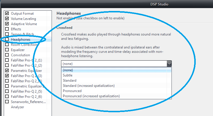

...Anyone implemented crossfeed for headphones with FIR and/or rePhase?
Not on a permanent basis but in its build into JRiver player its easy to try out and get feet wet from a subjective standpoint, if you wonna try it and haven't any JRiver license can say a trial version will work unlimited and full featured for 30 days so plenty of time to evaluate effect, in below we look into DSP settings where if out at left you tick on "Headphones" you get those comments and settings over in right side.

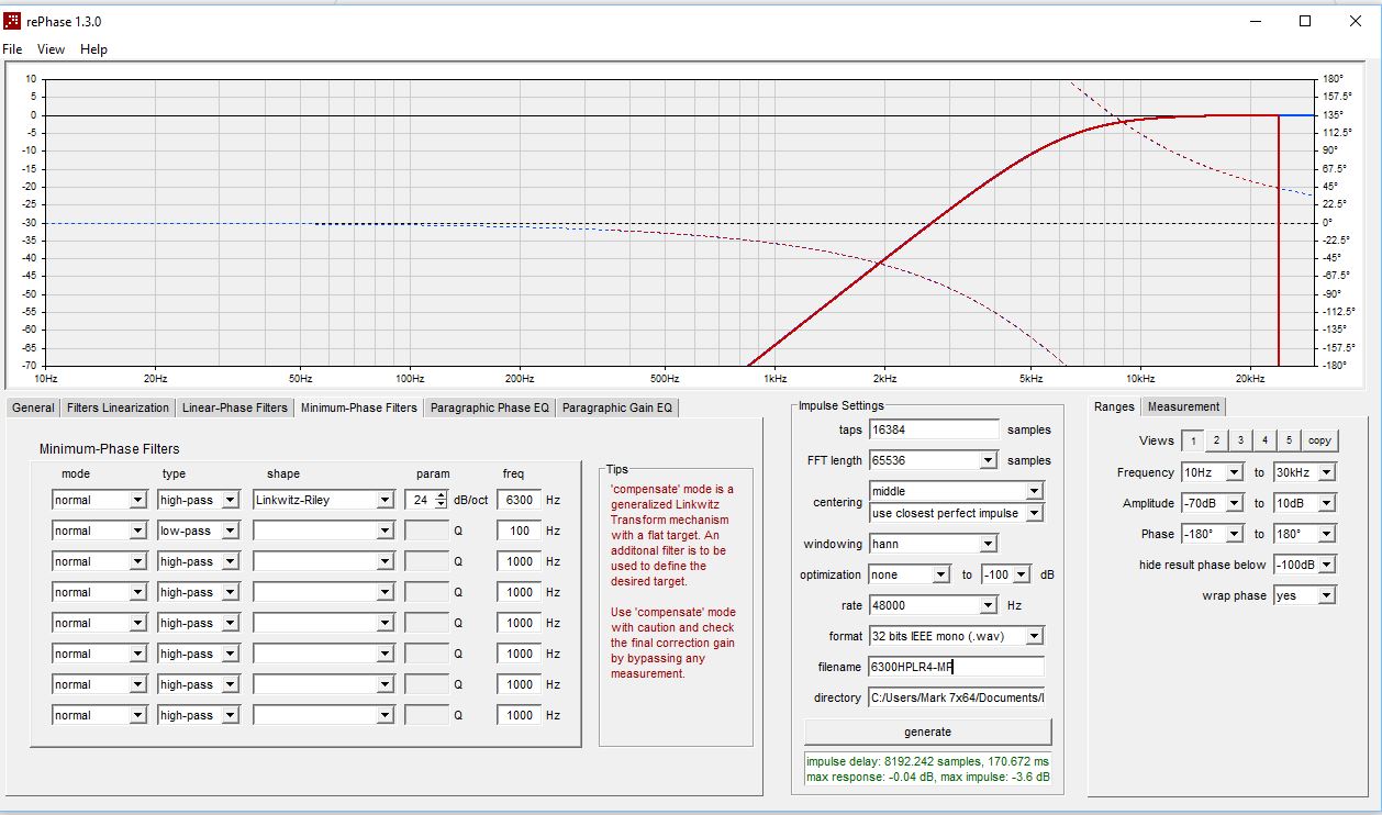

Hey Pos, or anyone else in the know :)
I've been trying to really learn how minimum phase crossovers time align and sum.
So I've been generating impulses in rePhase, and studying them and their summations in REW.
Many aspects are making sense!
But here's something simple I don't get...

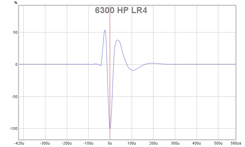

I made a LR4 high-pass at 6300Hz in rePhase.
The REW impulse response looks inverted to me, but I know it's correct by the way it sums textbook-like with a 6300Hz low-pass when properly time aligned.
Why does this 6300Hz HPF impulse appear inverted?
Many thx, Mark

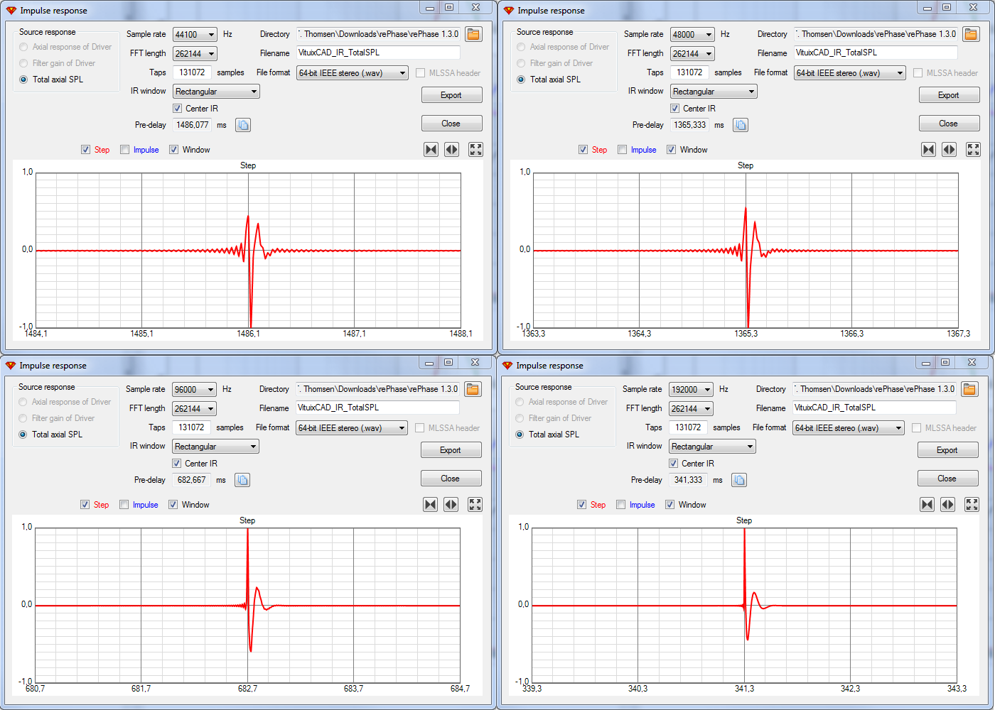

Is it roof of nyquist or what mark100, i was in the middle of test myself and got same result at lower rates where 96kHz and up got better, then fired up new software to me in free VituixCAD and it confirmed with below rates 44/48/96/192kHz.
BYRTT, thanks for looking.
Maybe I didn't get it...you've given me new doubt ..lol
But that said, i didn't get a change in polarity by going from 48 to 96kHz ...???
After seeing my rePhase/REW sim results, I'm now looking at real transfer functions under Smaart...and see the same inverted impulse on the HP side.
I rationalized it was due to a 4th order LR making 360 degrees rotation...which has to be split on both sides of xover...so +180 low, -180 high. With -180 being an inversion. Maybe that is full of sh&&t haha
But to test the theory, I tried using LR8's where it I'm thinking 720 degrees gets split +360, -360. Both these should be positive polarity..(i hope :)
They do measure that way....so maybe....
Please do check the results at low sample vs high...dunno what to think there...rate shouldn't matter should it ???
