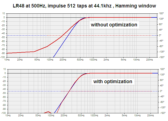

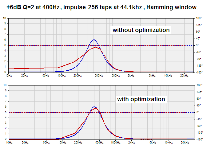

The optimization feature is an iterative process that tries to make the result magnitude curve closer to the target one, step by step.
The parameter controls the number of iterations (ie the generation time).
The optimization process can really help to reach a given target when the number of taps is limited, but it has two drawbacks:
- iterations will often raise the "noise" floor (not really noise, but...), and that is what the "to" parameter is for: it does stop the process when the "noise" exceed the given dB floor
- optimization will tend to break the magnitude/phase relation, and will for example generate pre ringing on a minimum-phase correction
Here are two examples of the effect of the optimization process on linear-phase corrections with a low taps number.
