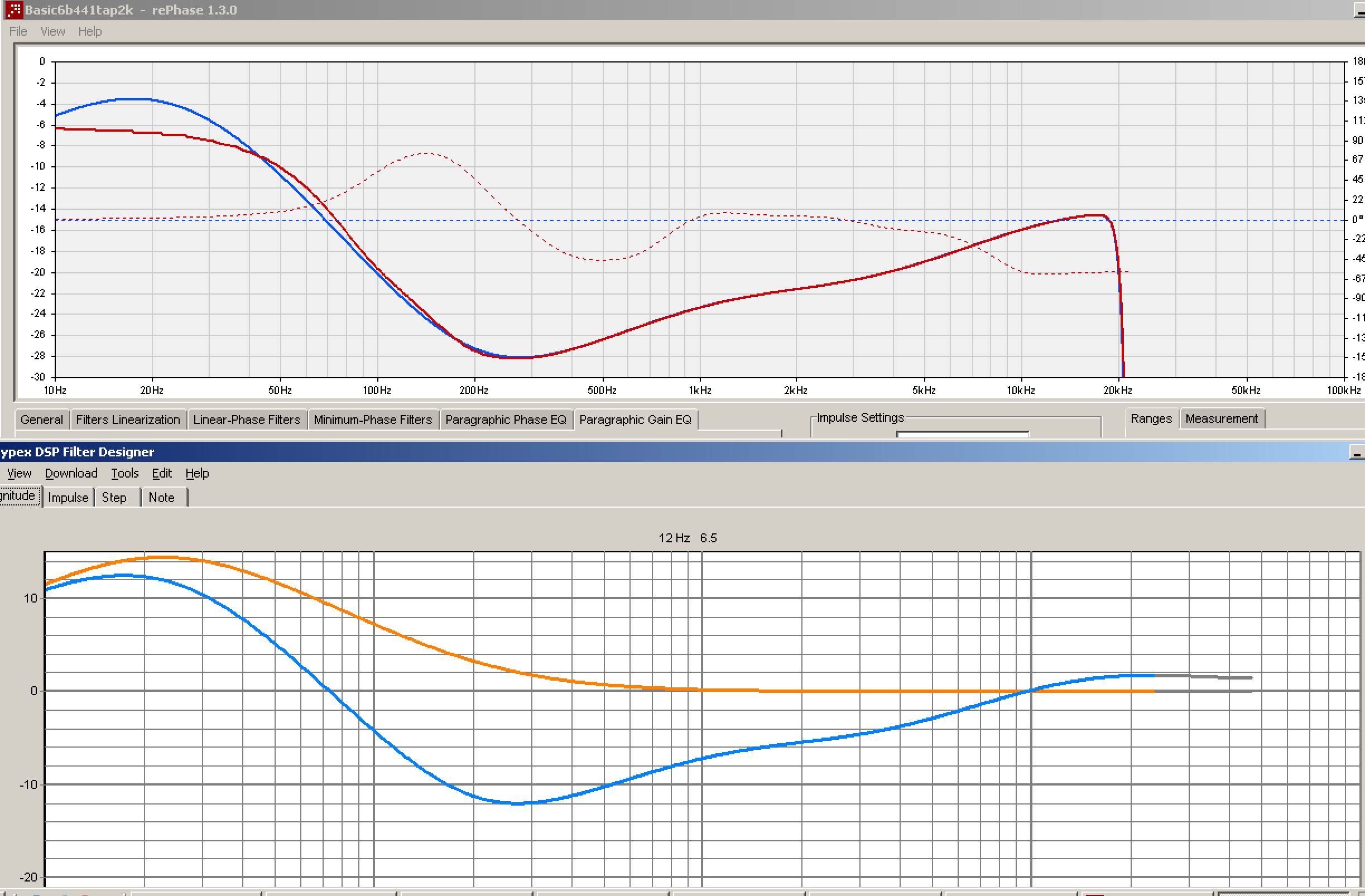

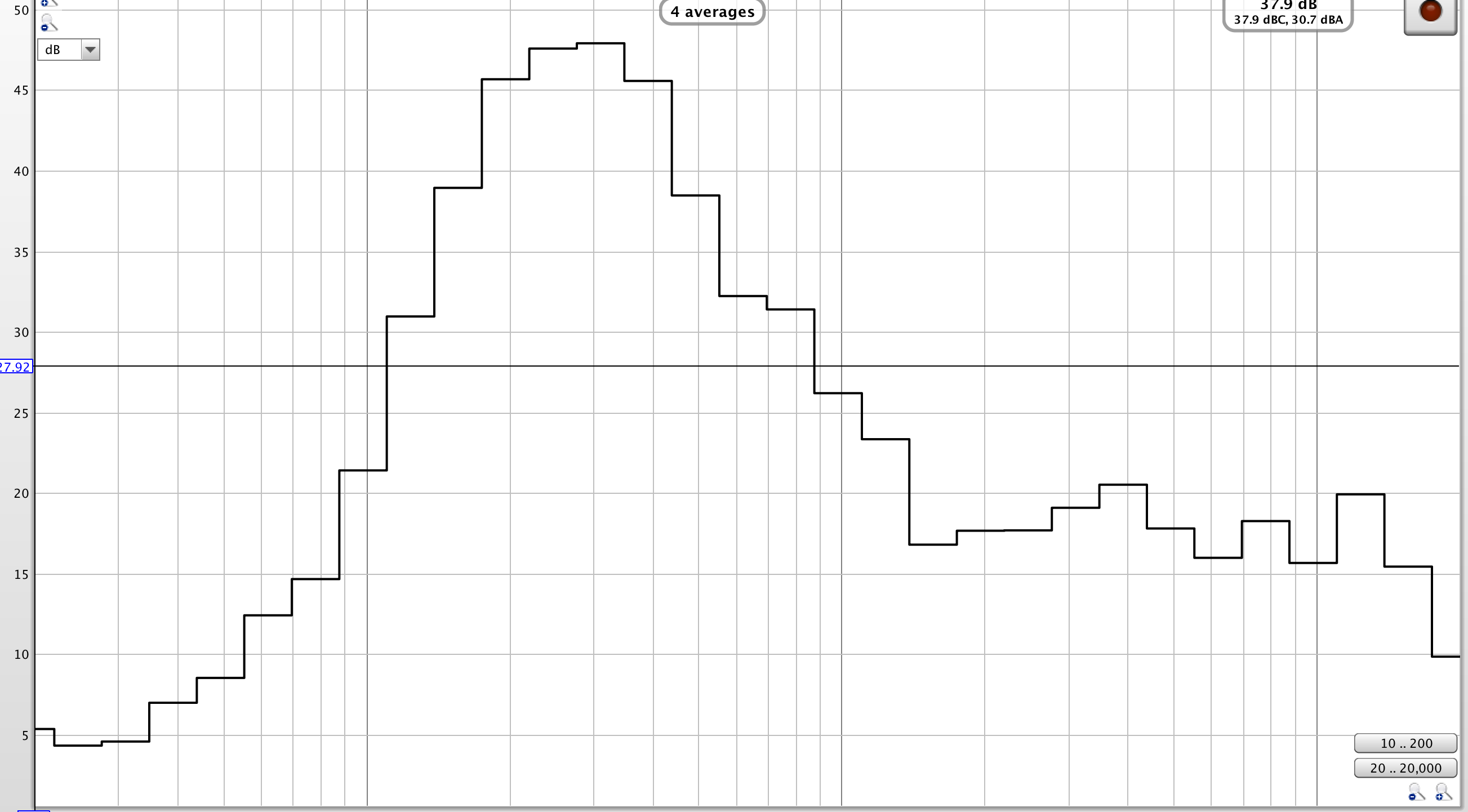

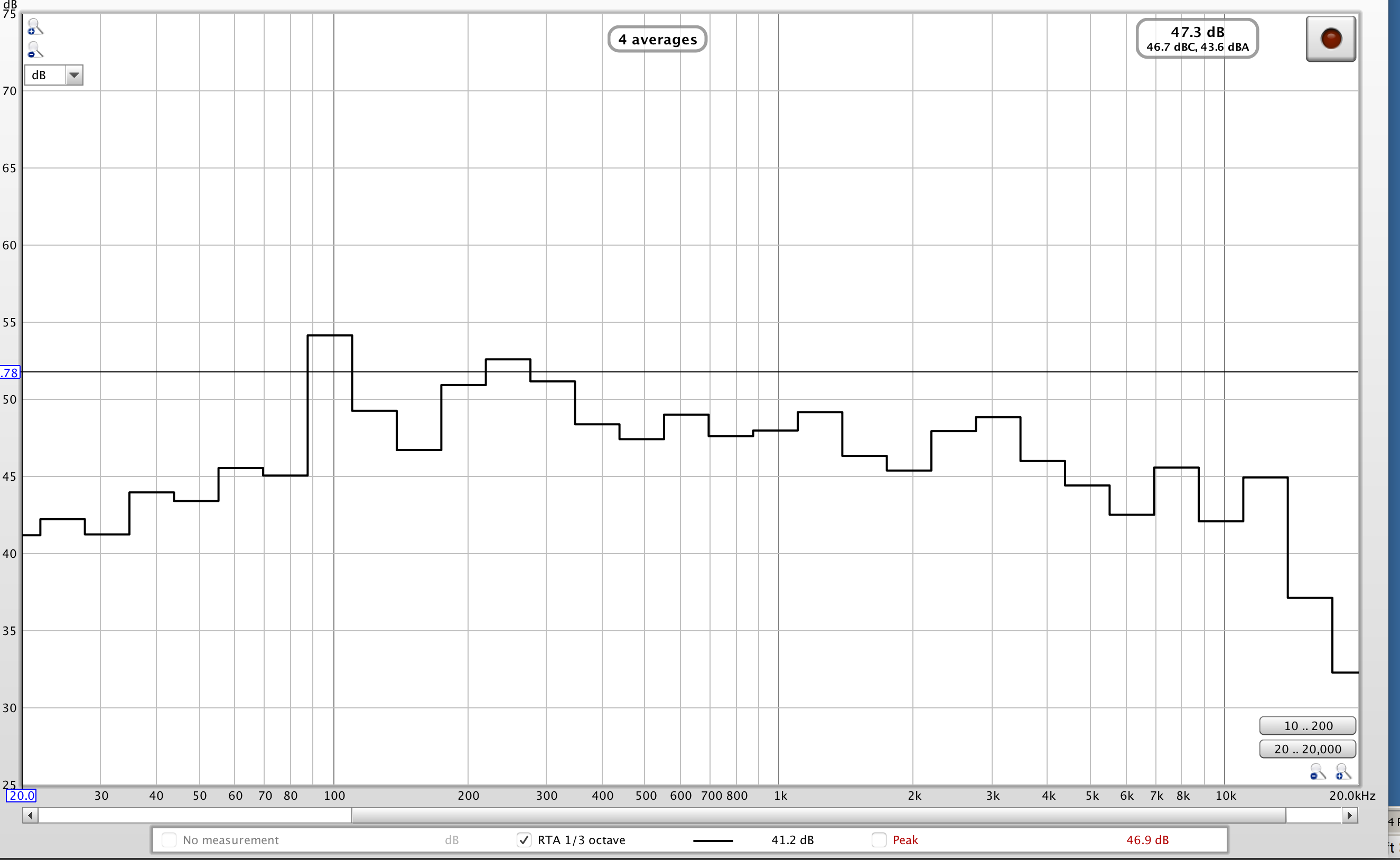

I'm puzzled right now. Implementing the same EQ using rePhase as the one I have tried out with my Hypex DLCP gives different sound.
The rePhase/DAM incarnation sounds hollow and very midrange heavy. I did try to inverse the settings and loaded these - now the upper half sounded good but no bass. And no highs above 600-700?
Picture shows the DLCP vs. rePhase screens...
Colors: Hypex Blue is complete target, red is the current biquad. RP/DAM: Blue is theoretical, blue is what can be expected with available taps (?)
X-axis are aligned!
See also pink noise meas from hypex and RP/DAM.

TNT, once gain the target frequency for the FIR should be either 353.8kHz or 384kHz, not 44.1kHz.
What you see in your measurement is exactly your correction shift 8 octaves up (and no antialiasing filter...)
Regarding biquads, this is something else, you cannot design these with rephase (albeit you can simulate them)

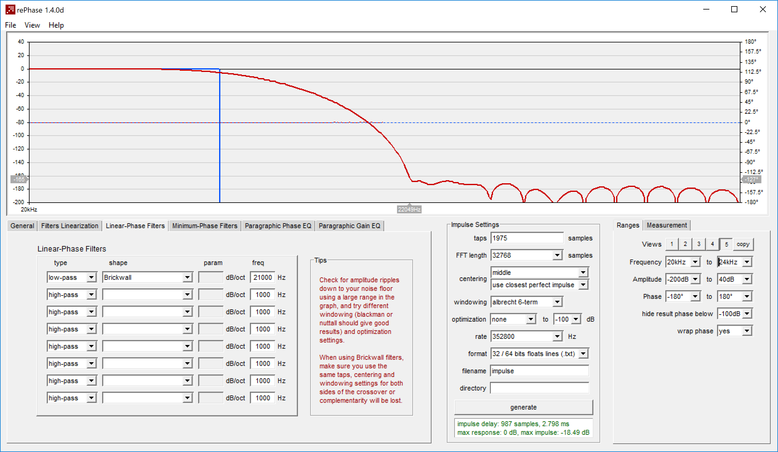

I am sorry I have no experience with the DAM.
I believe these parameters specifies something like 44.1khz base sampling rate and 8x oversampling, ie 352.8kHz
Here is an example of such a filter, running at 352.8kHzwith 1975 taps (don't know if this is the limit, but this is what is used in your example), -0.000002dB at 20kHz and <-165dB from 22.05kHz and up (and less than +/- 0.00000001dB ripples in the passband)
attachment.php
With this kind of filter capabilities (taps and sampling freq) is not at all suited for system EQ, as this will impact the quality of the antialiasing filter
blue is the target, red is the result.
Here the approach is a bit different than normal rephase uses where you want the result to be as close as possible to the target: in the case of a brickwall filter the result curve is dictated by the windowing algorithm. It is exactly like windowing a sinc function. It is only really useful in the precise case of an antialisaing filter though.
With 4000 taps and an Albrecht 11-term window you can get an in band response of +/-0.000000000000005dB up to 20kHz, <-300dB at and above 22.05kHz, and -1dB at 20.88kHz
Alternatively back to an an Albrecht 6-term window you can shoot for <-165dB at and above 22.05kHz, -1dB at 21.38kHz, and +/-0.00000001dB in the passband up to almost 20.9kHz
Yes, same basic setup as the screenshot but with 4000 taps.
Sorry I cannot post the rephase settings as the version I am using is a development version with a format that would not load in current rephase versions.
Start with the settings in the screenshot, adjust to 4000 taps, and then rise the brickwall cutoff frequency so that the rejection "floor" is obtained precisely at Nyquist (around -165dB for Albrecht 6-term, and -300dB for the 11-term variant).
For example that is 21530Hz for the Albrecht 6-term version. I don't have the other one anymore, but it was a bit lower.

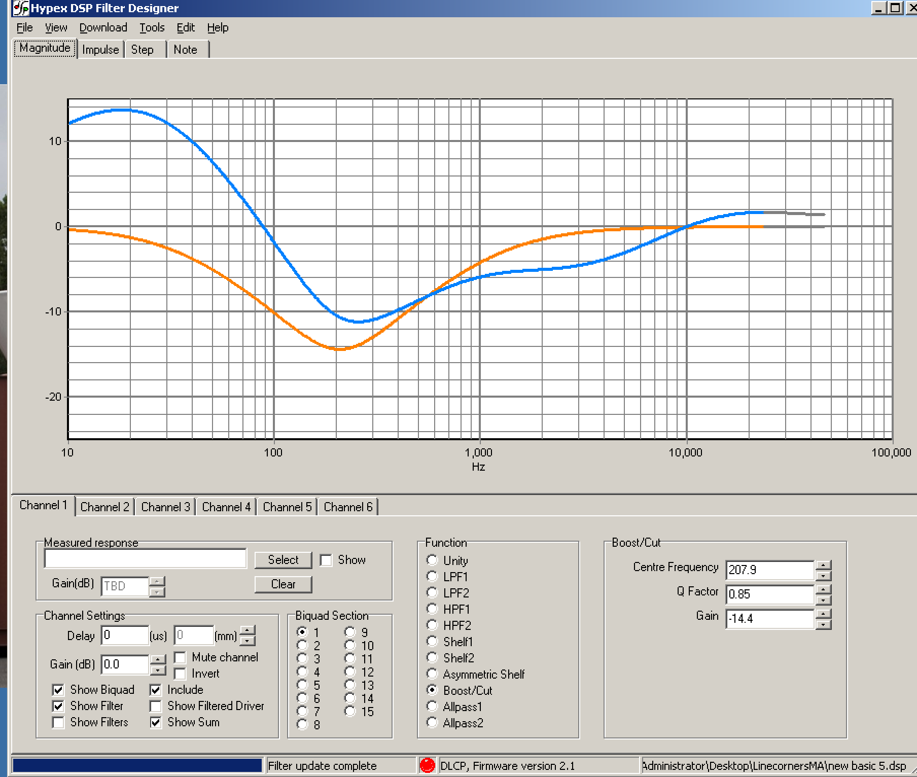

I''ll take a chance as you are so kind to answer me and present this task:
This is what my Hypex DLCP do - they are "boost" or "cut":
1: -14,4dB at 210 hz Q 0,65
2: 14,4dB at 23 hz Q 0,55
3: -3,8 dB at 3000 hz Q 0,5
4: 2,2dB at 17000 hz Q 0,5
Resulting in attached picture...
(This is what I did in rePhase but could not keep the bass levels it seems, with 4k)
There is definitely not enough taps for such a correction at this sampling rate, especially considering the antialiasing filter that requires a very gentle windowing to reach a low stop band.
If you remove the 23Hz and 210Hz EQs and use biquads to apply them then it might work, but quite frankly I think it would be better to use an external DSP.
