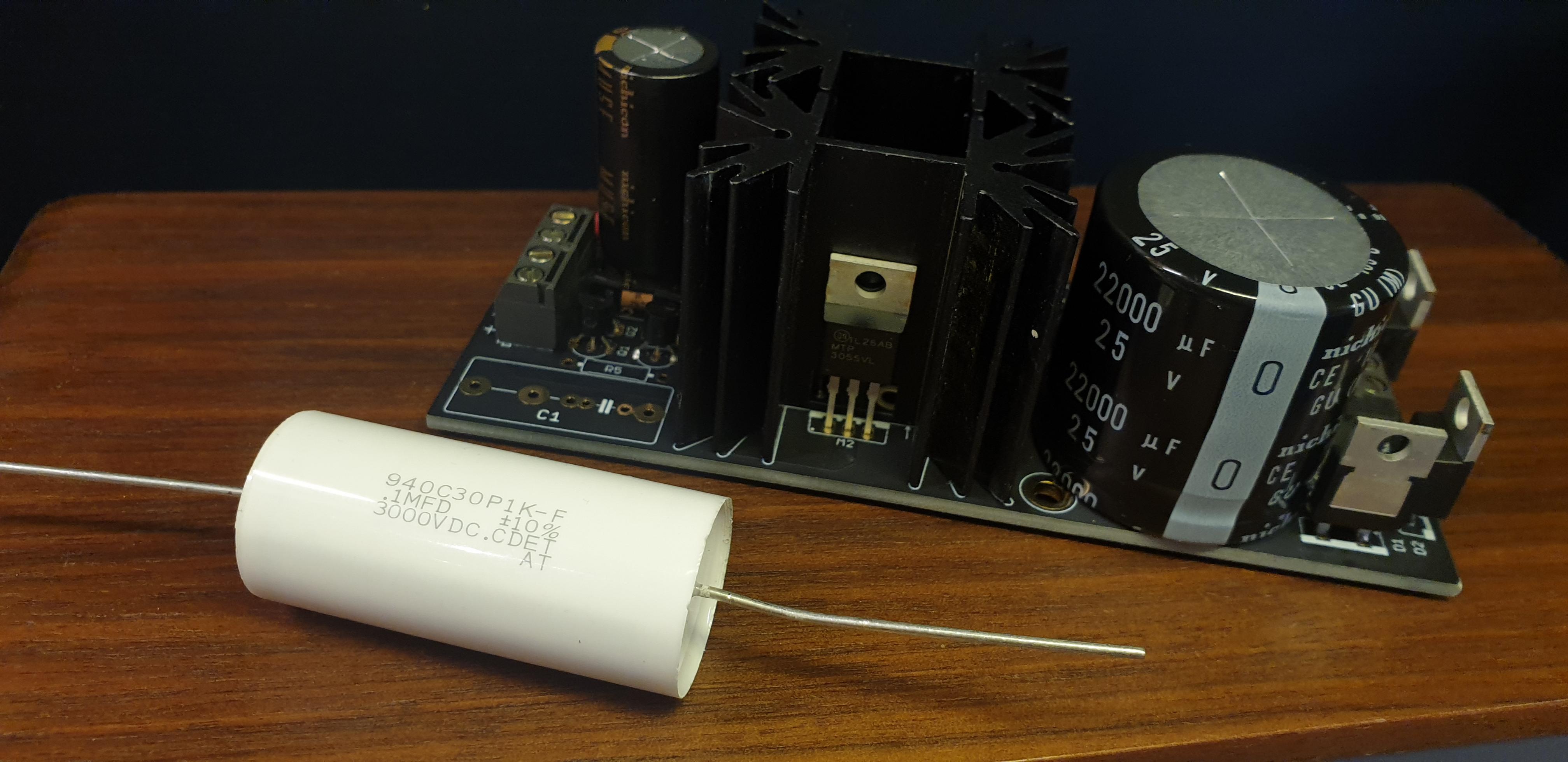

Nice caps
The big 22k gives the 2Sk117 a little push!
Something tells me this for C1 isn't going to fit!
Russian FT-3 teflon film & aluminium foil best bang for your buck.

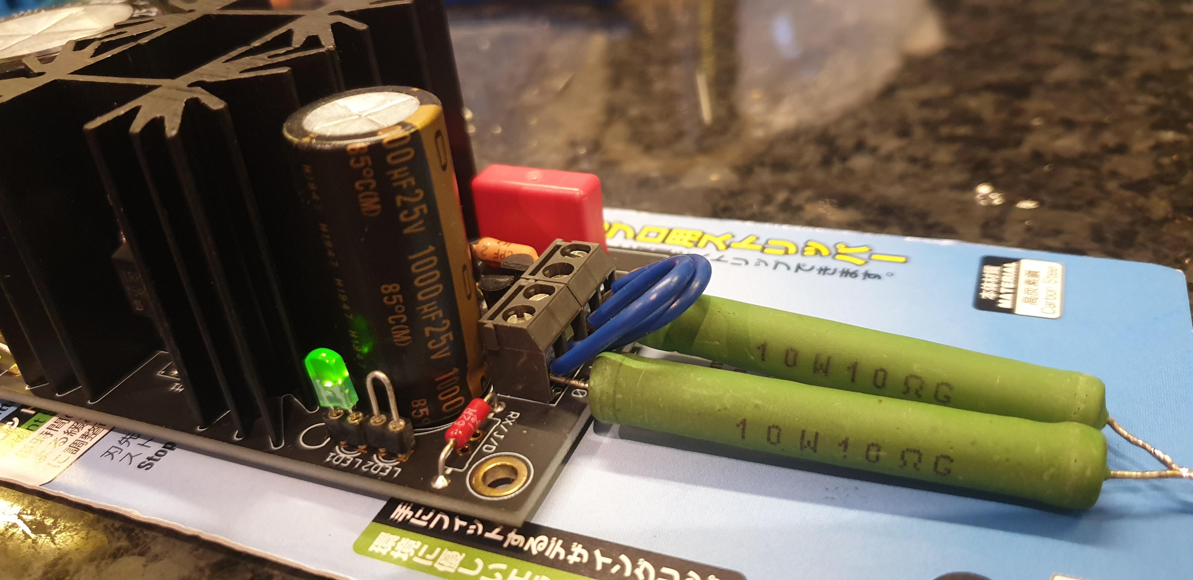

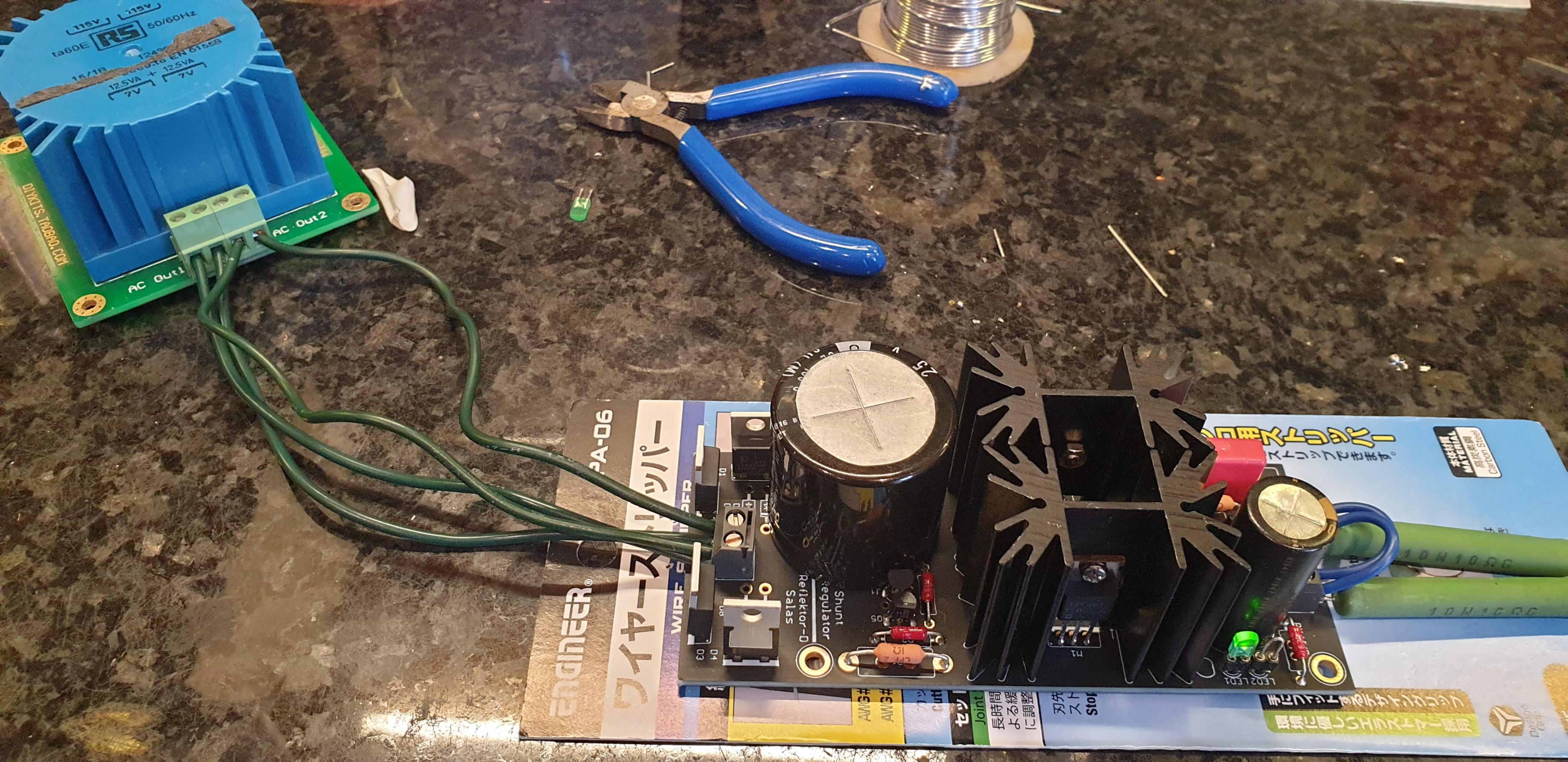

So I have success on first test. Only had 1ohm for R1 so it is running quite a bit of CCS. Testing with 2x 10W 10R in series.
Set for 3v3 with 1 green, 1 jumper and 62R and I have 3.32v so perfect there.
I'm monitoring the heat and then shall test on a dac.

9.3V DC level is alright for your purposes after bridge losses etc. 9.3V-3.3V=6V DC across the reg. Good for stiff CCS performance. More would be bad for dissipation on sinks. Also, 62mV RMS ripple seems quite probable for such CCS load.
Indicates, if you had put a scope on CM, about 200mV pk-pk sawtooth 100Hz on the screen. But expect a straight line on the reg's output.

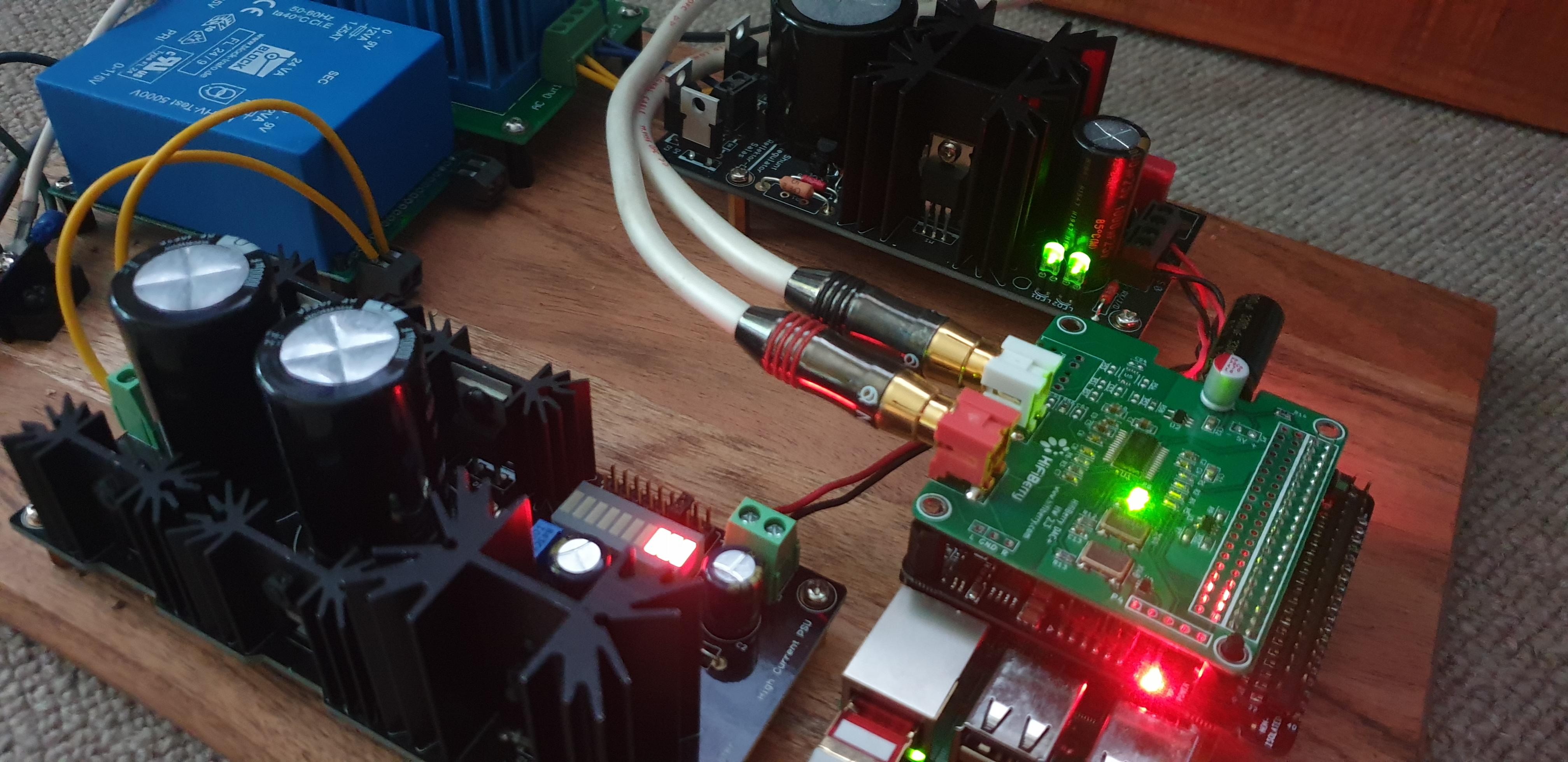

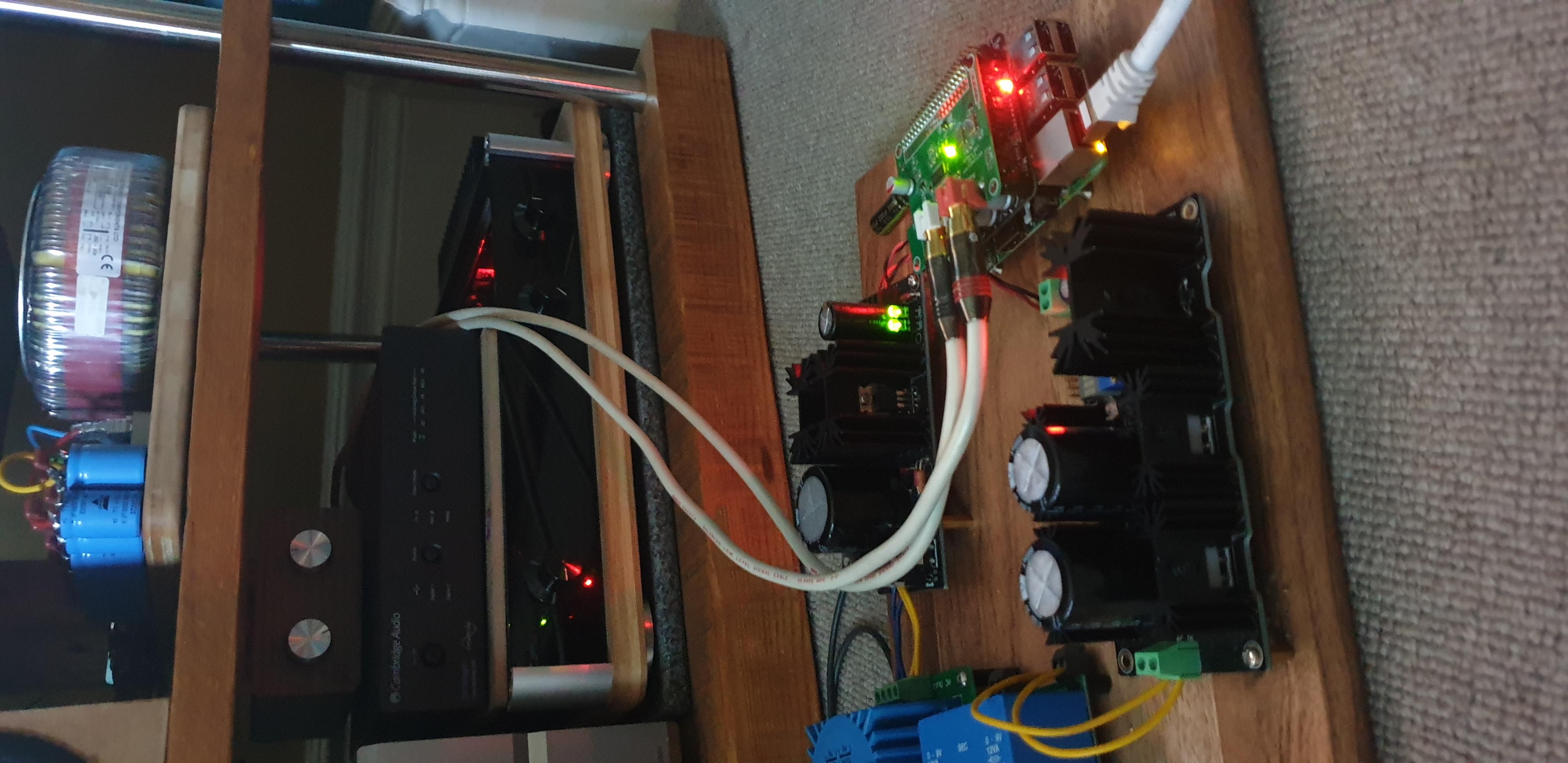

So a quick test with playing actual music and all is very well.
My normal 'rig' is a full Ian Canada stack but obviously quite involved for quick tests. So this evening I quicky rigged L adapter 5v >Ian Isolator dirty side> Rpi and Reflektor 5v2> Ian isolator clean side> Hifiberry Dac Pro. Quite a cheap dac hat but surprisingly good. Especially when Salas powered.! Signal from dac into DCG3!
Limitations of todays test being that the R-d 5v goes through an ldo for 3v3 on the dac. Without cutting traces and stuff this is all I could manage this evening but I am very pleased.
