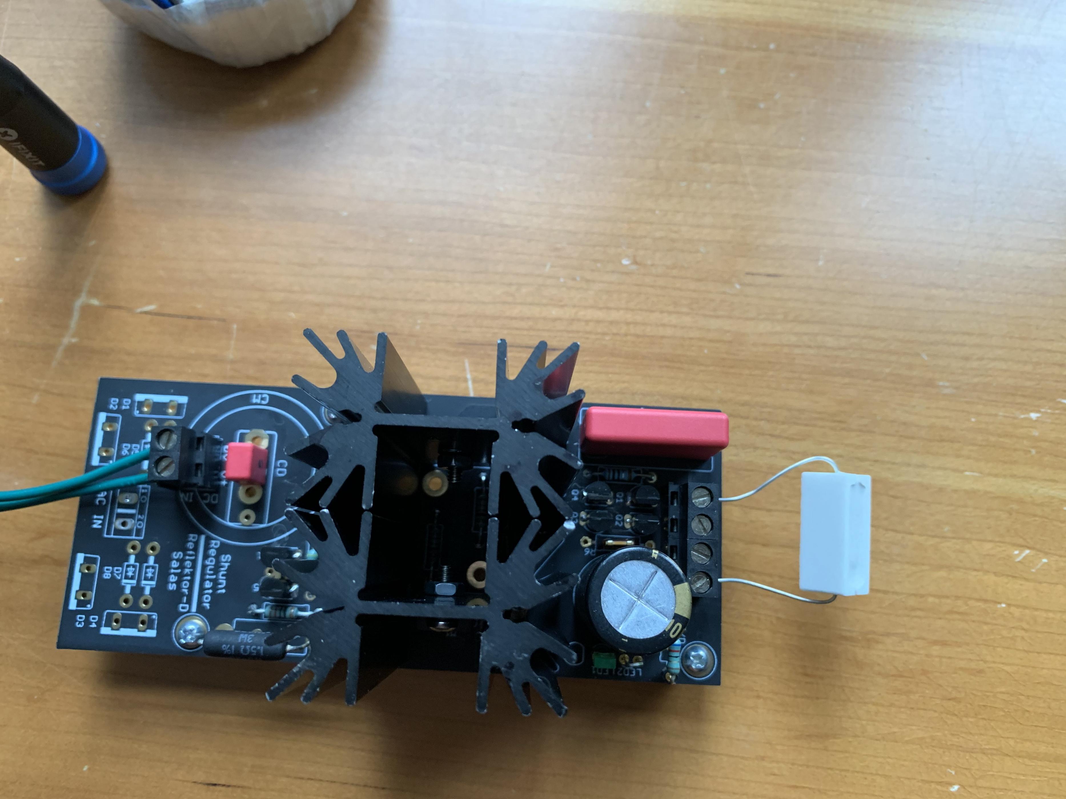

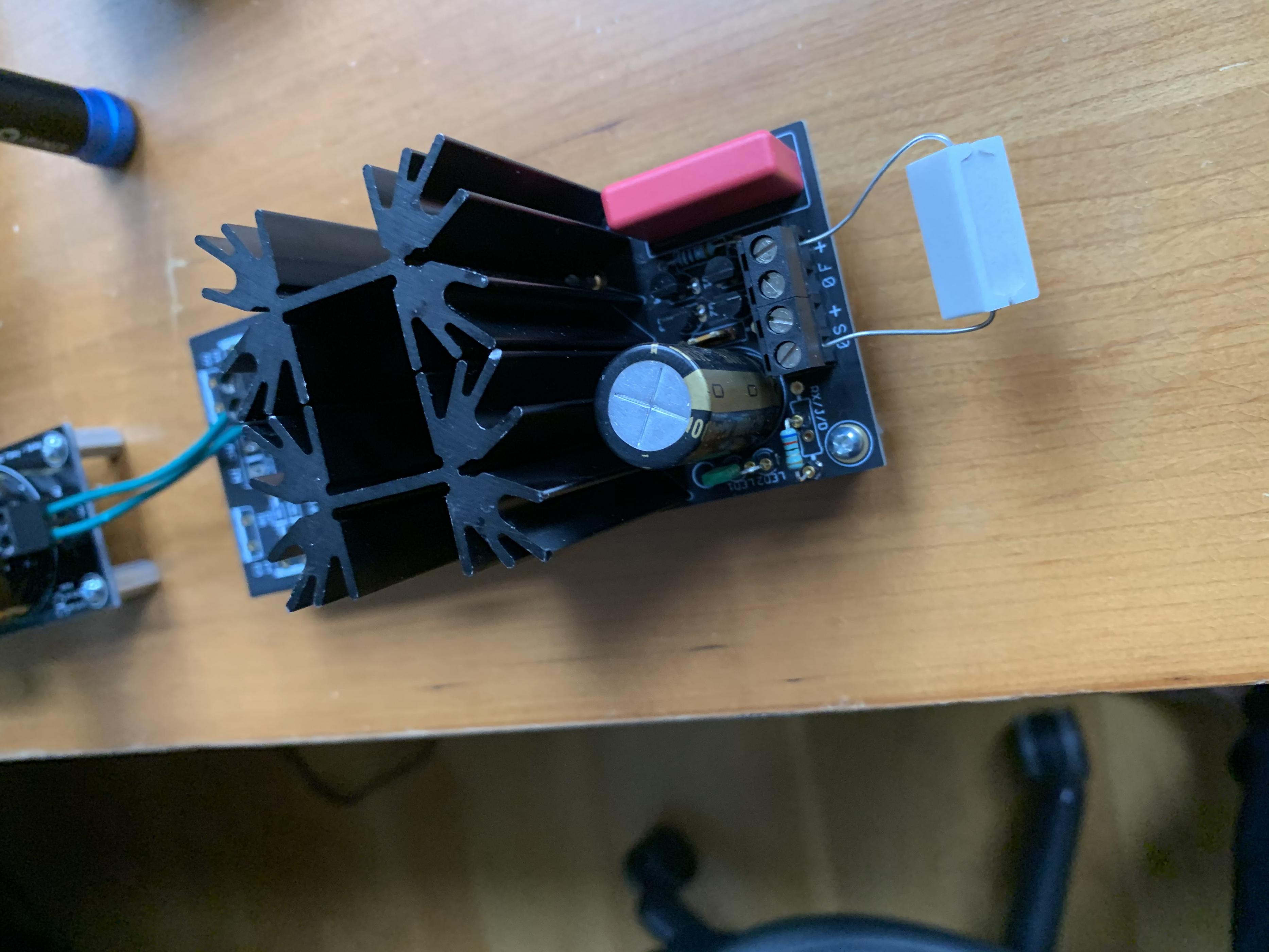

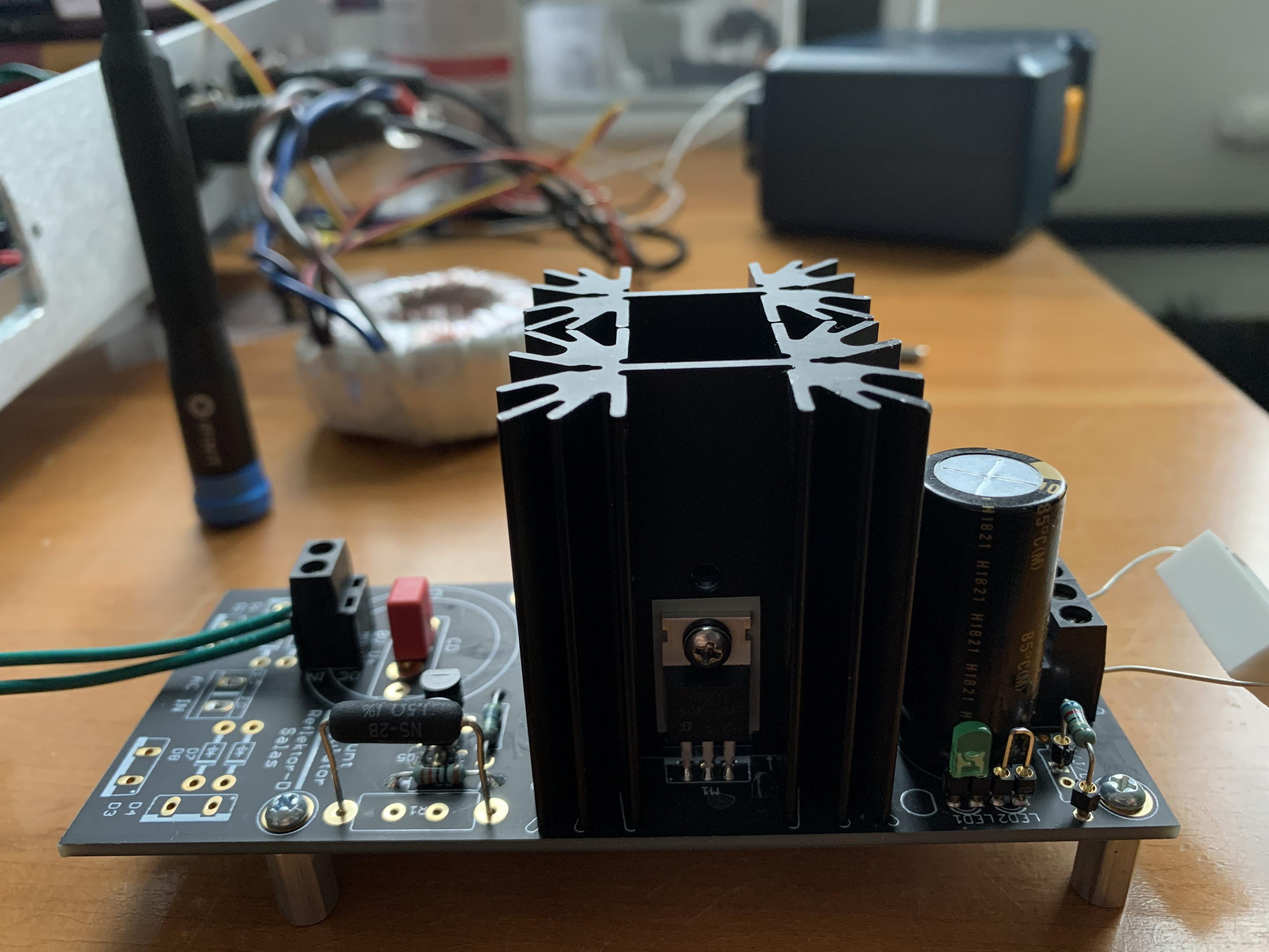

Salas, I've tried powering up the reflektor for the first time but the LED is not lighting up. I'm using a dc flexy and am measuring dc out from that board. I believe the parts are all correct. Do you see any issues in the photos?
