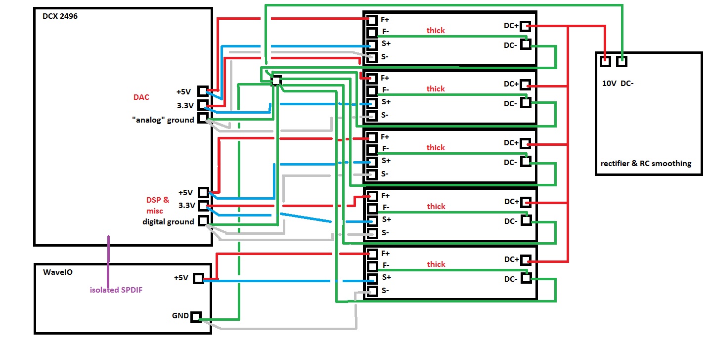

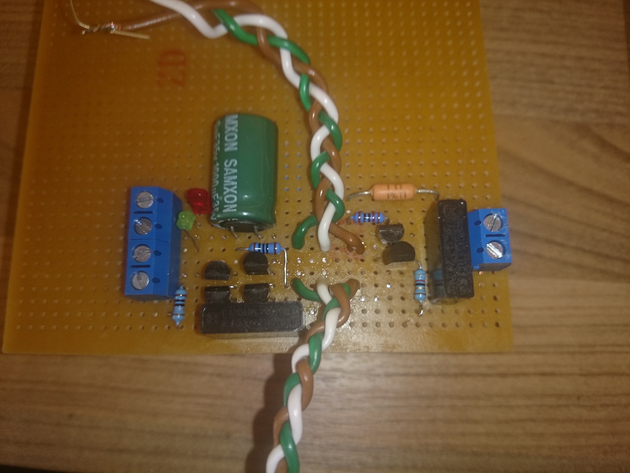

I soldered my first prototype ( out of five ) on veroboard. It was a nightmare to do but i managed without mistakes and with only three top side vias. I got 6.something volts with off the shelf leds but didn't have more time to try swapping them. The chance of error is incredibly high and I wouldn't recommend anyone to follow my steps. We'll see how the next four shunts turn out but I managed to make a compact and low package.
Since I don't have anything but two digital multi-meters I doubt I can measure the hum let alone jitter. It is an all-digital circuit I'm powering so a possible degradation of performance caused by hum and jitter is almost impossible to asess when the whole PSU will be replaced.
I want to do it right the first time. How about making a star ground point where I'll connect DCin-, 5 times DC- to suppply the shunts and grounds for each of five parts of circuits being powered. So F0 would stay disconnected on the shunt but a thick wire + tin trace will go from DC- to the F0 on the board. S+ and F+ will connect at power input of a circuit and S0 woul be taken from where the wire from the star point connects to the circuit ground.
Does this make any sense?
Since there will be pcb track resistance first connect normally nearest to the consumption target nodes in tight loop areas and if you will get any hum or jitter then you will debug towards alternatives. Like a star for all returns to go, or closing locally on each reg and using shortest possible thick two wire classical connections.

@marko

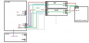

I don't like the wide loop areas. I would prefer each reg "module" DCIN- to form STAR at RAWOUTDC-. Same for each DCIN+ i.e. individual wires to RAWDC+.
Every FORCE- to its respective PWRGND at the receiving digital boards. FORCE polarity pairs from each reg module to every receiver PCB PWRin points should be twisted. The SENSE pairs also.

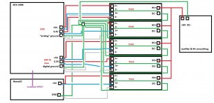

Salas, can you point me where are the loops formed? Don't take my drawing literally. It only shows what is connected where. The star could be at the RAWDCIN-, the S+ and S- in a shielded cable. Individual F+ also.

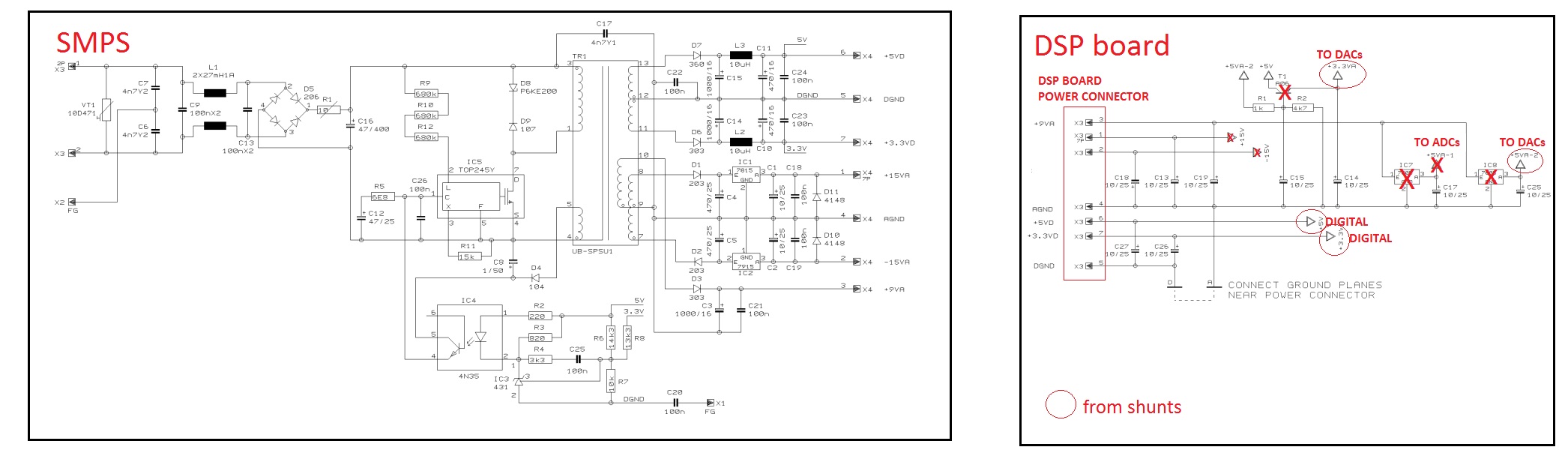

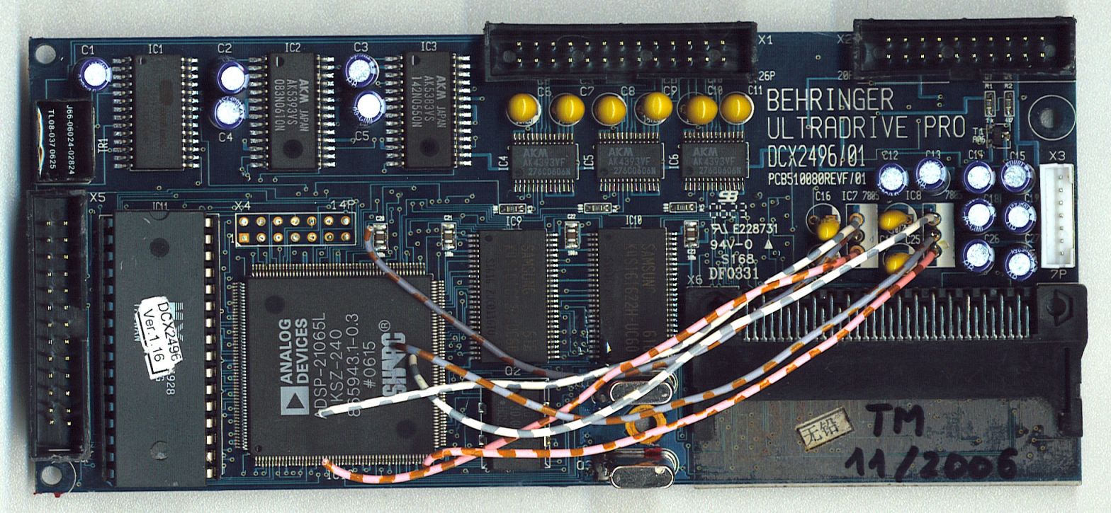

The problem is all the grounds get eventually connected on the DSP board of the DCX2496.
Here is the schematic of the original PS and the layout of power supply on the DSP board. Also all components of the DCX are on the DSP board.
I made a partial drawing from what you suggest. I cannot separate the ground connections on the DCX, and if I got your suggestion correctly it would form multiple loops.
Thank you very much for your help. I really appreciate it.
Then I can twist each F-, coming form the shunt to the star at the DSP board , with respective F+ coming form shunt to the power input at the DSP. That way only the incoming DC wires would remain untwisted, with the + away at the power input side, and the - wire could be guided through a small iron pipe if you think it will do harm if left bare.
