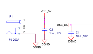

Hi! I built a Reflektor for my breaglebone black that is serving music to my dac in the same chassis ("chassis" being used liberally to describe an mdf board... ).
Before using the Reflektor I powered the bbb with a 2A/5vdc smps so I could get and idea of the current draw using the music I usually play. At turn on it draws a bit over 400mA. After it stabilizes and plays the average seems to be about 350mA, with the max recorded for a two hour listening session being 410mA.
I built the Reflektor with a 1R Caddock MP930, thinking that it could draw close to 500mA, but it fell a bit short. Should I leave it as is or try to get a 1.2R instead of the 1R? I ask because the heatsinks during this two hour period stabilized at 50-51 degrees F (max was 50.7dF). It's using a 9v trafo. I live in Florida so summer is long and hot and the thing is not yet inside a case...
My second question is regarding the startup. When I hit the on button, sometimes the bbb does not start! The leds are on in the Reflektor board, but the bbb does not boot (no lights come on, as if it had no power). When I was testing the setup with smps it always started. Pulling the bbb's 5vdc plug in/out makes it start. From the measurements above it doesn't seem to drawing, even for a brief moment at startup, anywheres near the max current, so I'm not sure why this is so.
Thanks in advance.

1 Ohm is about 600mA. Can go down to 450mA in your case. Check voltage across R1 and divide by R1 Ohmic value to define exactly. Check DC raw across the big filter capacitor. If its more than 10.5VDC with your mains and Tx maybe you can use a lower secondary VAC one to avoid some more heat. Or try power resistors to the primary until 10.5VDC rectified.
Does it do the missing a start thing with or without remote sensing? Check both occasions. I.e. as in the guide or by lifting the sense lines at the Ref-D connector and closing them locally with short jumper wires to the relative F+ and F0 screws.

I tried it both ways, full sense cables (as photo) and jumpered at reg and single cables out to bbb. I'll test some more the start up current surge just to make sure and report.

The MTP3055VL is a logic level MOSFET with low VGS threshold. You should not use a normal MOSFET in its place. Its not the pin-out, its the VGS. Normal MOSFET may be used for higher voltage Vref. If the Vref is lower than the VGS itself in this circuit then the current goes crazy through it and the open loop gain suffers, so output Z suffers too.

I did several measurements of current draw at boot time and the highest was 420mA, so you think I can drop the shunt to 450mA?
I changed the R1 from 1R to a 1.1R and measure 0.61vdc (550mA). After playing for about an hour the temp is now 46-47C. Still too high, since it's not in a case yet?
The raw dc across the big filter is 11.5vdc. I don't have any 8vac secondary TX, so try the resistor? I've never done this before to the primaries of a TX, any recommendations for the type of resistor to use?
...if its not a matter of sudden peak limiting see if a small size decoupling polymer or electrolytic helps that mini Linux computer start always when installed at its DC input jack. Maybe the small delay of C2 to charge up catches it out sometimes, hmm. Smaller C2 to test? 470uF?
Based on the current draw measurement with a voltmeter it doesn't seem to be a peak limiting problem, even at the 550mA it's set for now. I did change the C2 for a 470uF but it made no difference, still starts randomly. I was going to add the cap as you suggested to the BBB plug, but I looked at the schematic and there is a 10uF cap already there at the other end of the plug on the board (image attached, from BBB schematics). Should I still add the cap there?
Thanks again for all your help.
You can drop to 450mA since the 420mA peak is rare, so there will still be enough margin averagely. That and 1V less DCin should back down few more C.
Restore C2. Add 100uF to the plug so to see what happens.

Put back original C2, added 100uF bbb 5vdc input, no difference. It seems to randomly choose to boot... Pulling the 5vdc plug out of the bbb and put it in again always works to make it start.Restore C2. Add 100uF to the plug so to see what happens.
So the original 50-52 deg C (with the 1R) is ok too? If so I'll go back to the Caddock 1R. If the answer is yes then I will not use the resistor in the TX secondaries.That temperature poses no threat to the reg MOSFETS
I may have to go back to another PS since it will be very difficult to pull the plug out of the bbb when it's all in a sealed case!
Any other ideas as to what may be causing this? Adding a delay circuit between reflektor and bbb might help? But I would rather not do that if I can avoid it...

This is something related to what bugs the mini Linux Ti computer which I can not know without having it in hand to investigate. Using the scope etc. Maybe it does not like so low output impedance of such wide bandwidth, or it has some local buck converter chip(s) that interacts kickstart, can only theorize. I would try this practical thing though: Using a switch to turn on the PSU and a relay or hand-switch to connect the plug a few seconds later. Can be pre-tested with any handy secondary switch near the plug end. The PSU would take the short off-load time on a 470R dummy resistor I would put across the plug switch so to have a complete circuit for sense always. As a matter of fact I would try such a resistor at the plug as it is already wired, just in case it helps.

Yes Salas I do like this with the Cubietruck.I start the Reflektor and after plug the connector of the Cubietruck,it is no a problem.. I would try this practical thing though: Using a switch to turn on the PSU and a relay or hand-switch to connect the plug a few seconds later.
But a switch is another solution.
Cubitruck, another ARM device has this problem. I know Enrico had the same issues with an Edel renderer, which is also an ARM device. There must be something in common between all these one board computers that cause this?...do like this with the Cubietruck.I start the Reflektor and after plug the connector of the Cubietruck,it is no a problem
I have one (just got it, learning how to use it as we speak...), what should I look for?...Using the scope etc.
A 5w 470R?...470R dummy resistor I would put across the plug switch so to have a complete circuit for sense always. As a matter of fact I would try such a resistor at the plug as it is already wired, just in case it helps.
