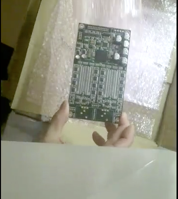

Unboxing Experience...
... the movie :)
edit: ok - movie not possible here but I got it and it looks very good.
