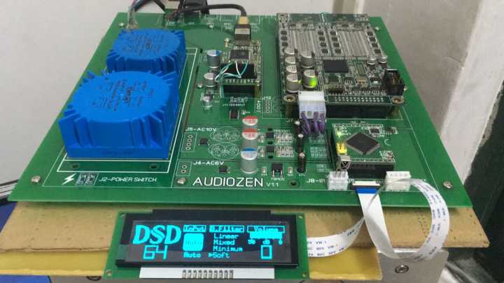

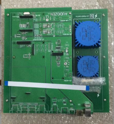

When we design these considerations, a better sound is considered in this version. And can be easily split into 2 pieces, can become smaller.
Beautiful design. Looking forward to rev 4.
