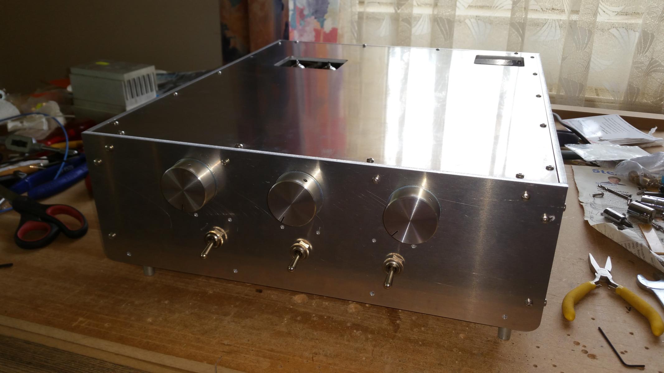

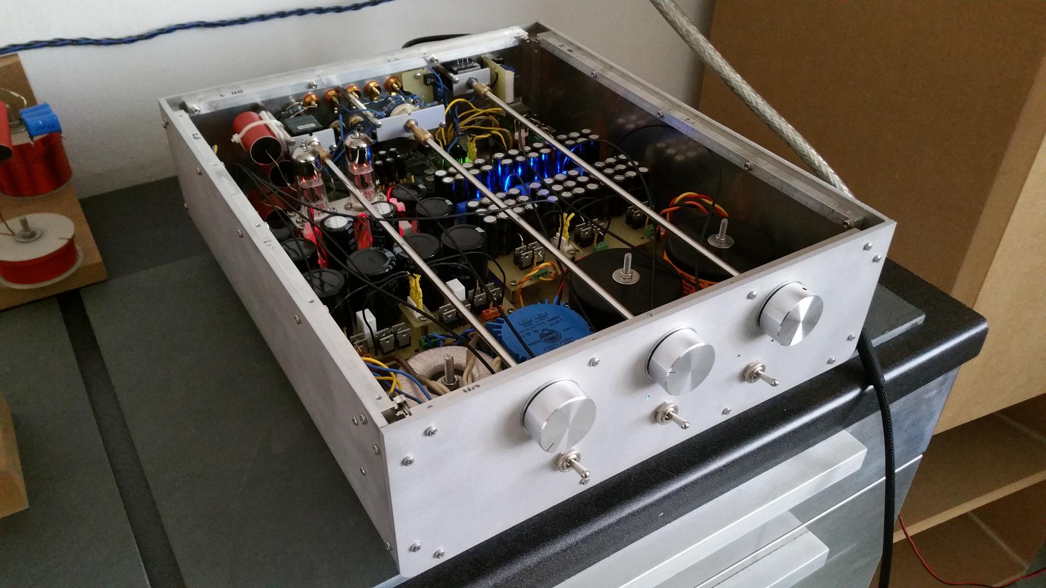

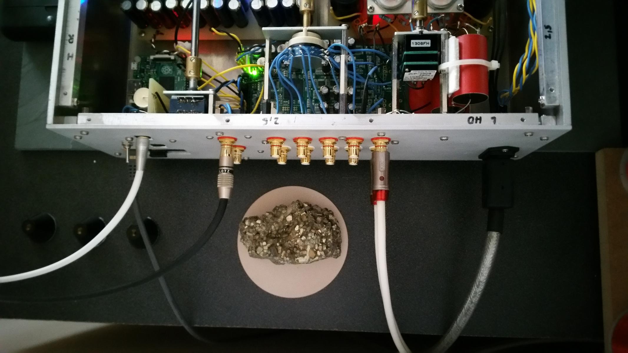

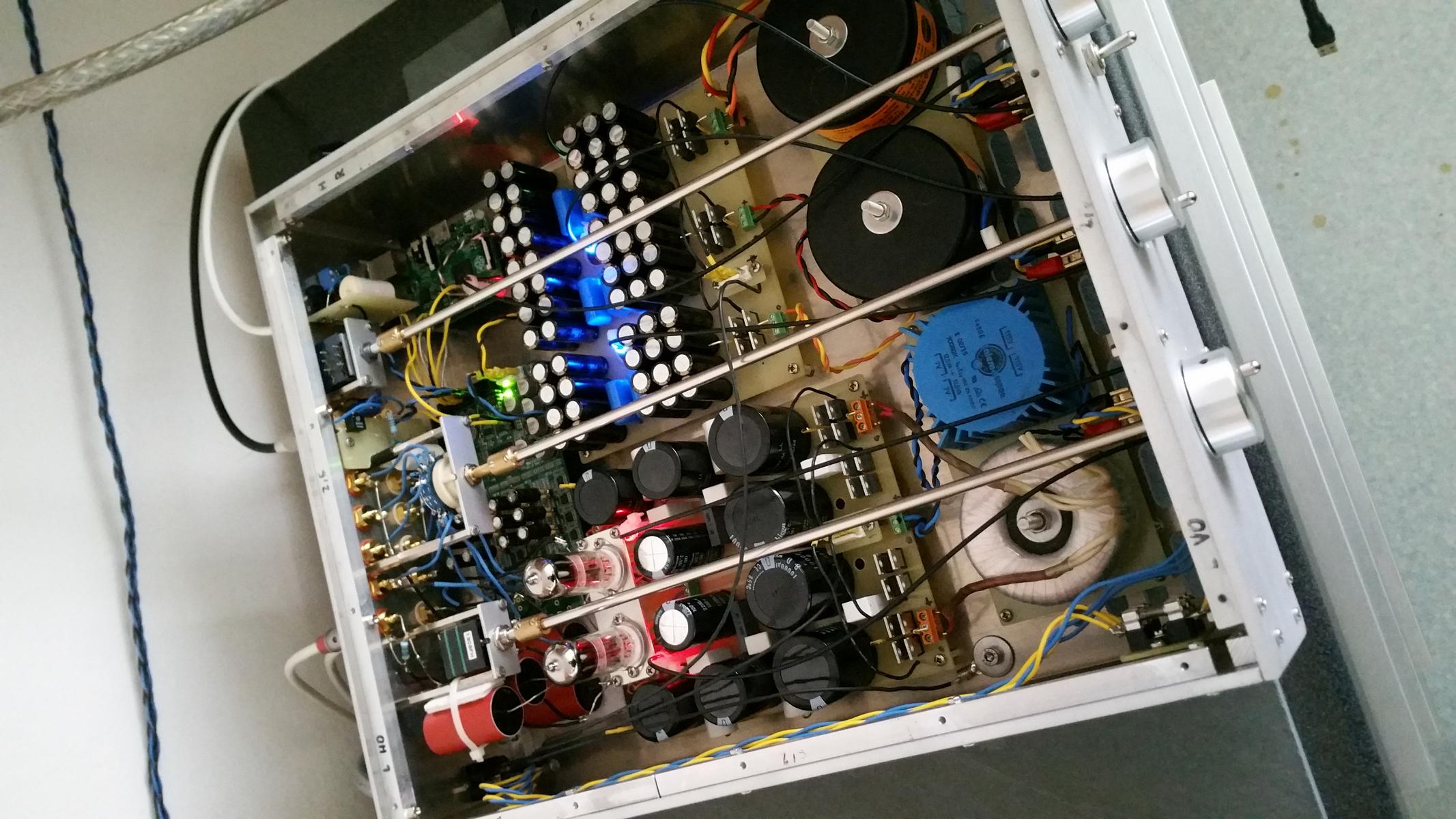

Here some pics of my soekris-build-up; not yet ready, but stunningly playing;-)
That looks great! Thanks for posting!

Thanx to All for your kind words!
It's not ready yet- still in test-mode;-) External and also internal look will change as some circuits are getting further optimized.
But one's for sure- this thing killed my summer last year;-)
