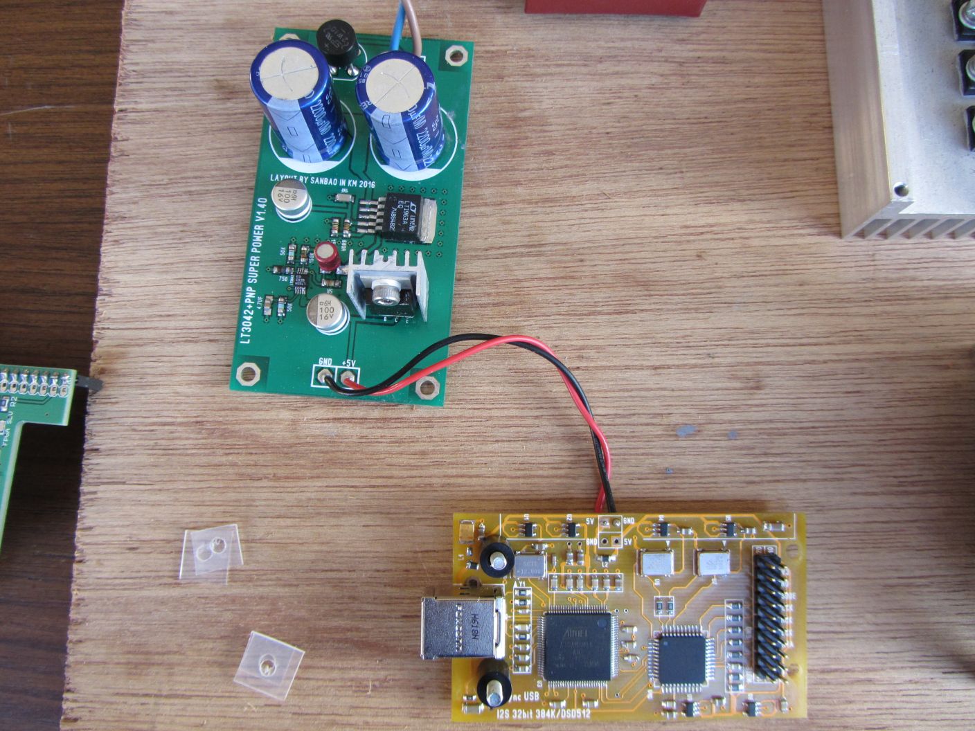

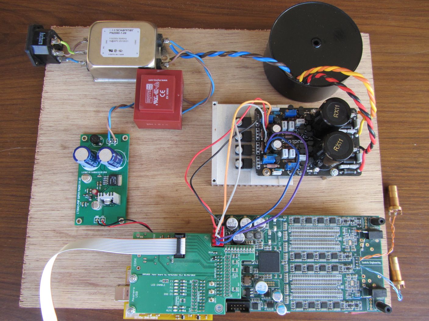

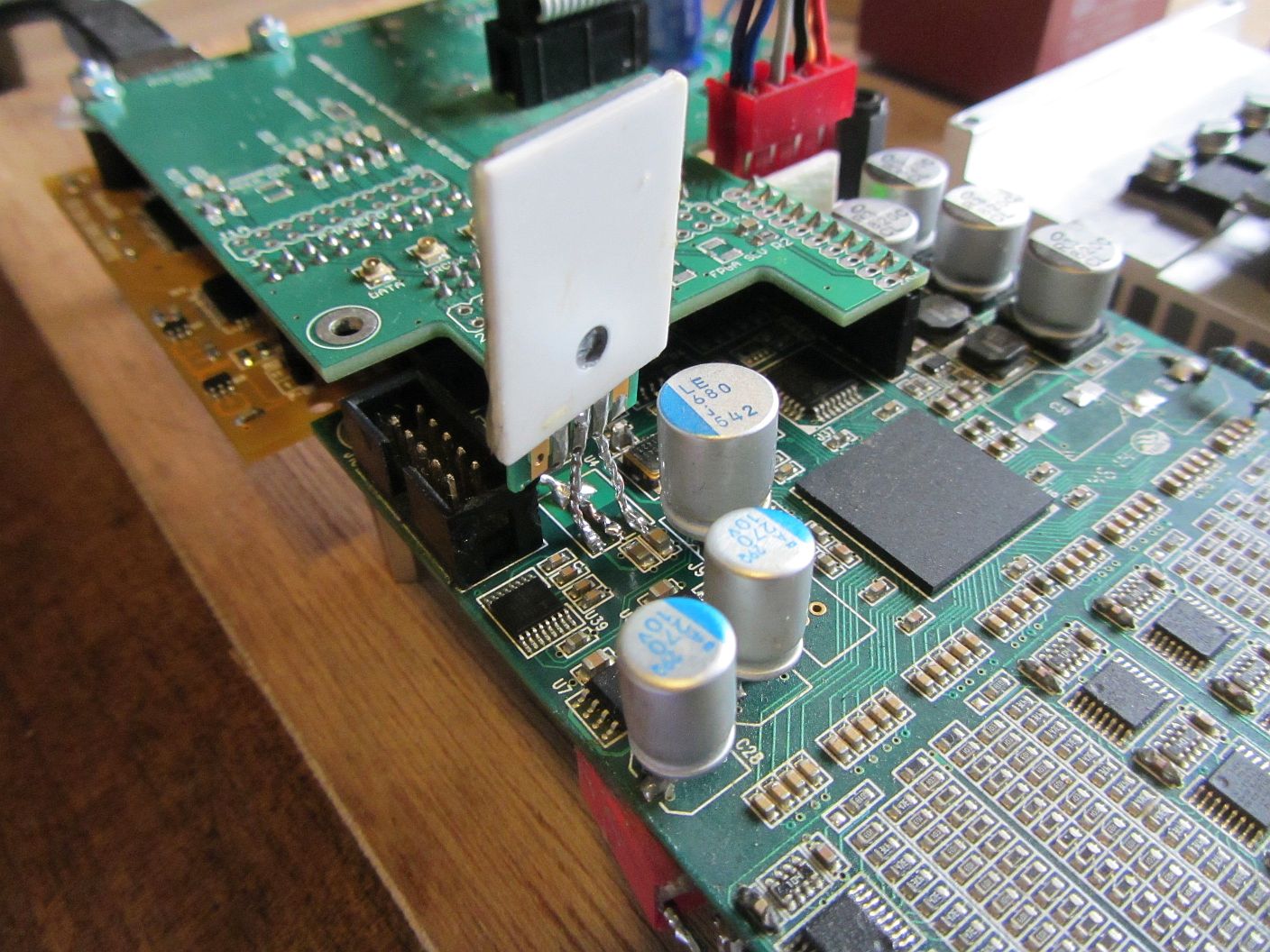

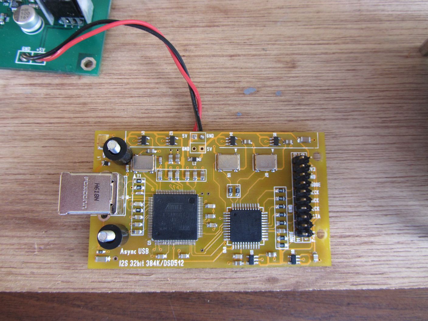

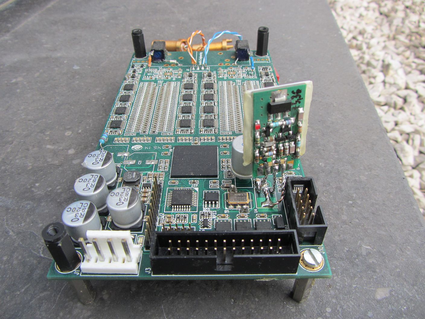

Hello,
Here are the latest mods I did to the Soekris DAC that it lifted a few notches up in sound quality
I have a Soekris v1 DAC with the lowresmod and plenty of vref capacitors on the backside added
The easiest one was to replace the Amanero interface with another Amanero that I found on Taobao,
that new Amanero has better clocks (C3391) and a better PS: 6 LDOs instead of 2 on the PCB.
I also removed the +5V USB PS and added a dedicated LT1963+LT3042 PS for the new Amanero.
I just noticed that for 2017 that Taobao Amanero is being replaced with one that has I2S isolation.
I had some muzgdiy 3.1 voltage regulators that I finally got the courage to install, especially with the help of a new hdmi microscope
I replaced the 3.3v LDO regulator that is used for the clock.
The result of this is better detail, better separations of instruments, ...
I noticed that I got to hear the echos of the instruments.
Of course this is all subjective
Danny

Danny, what is the power supply you're using for the dam1021 board itself? (The one just below the black toroid in your first pic)
Thanks,
Matt
