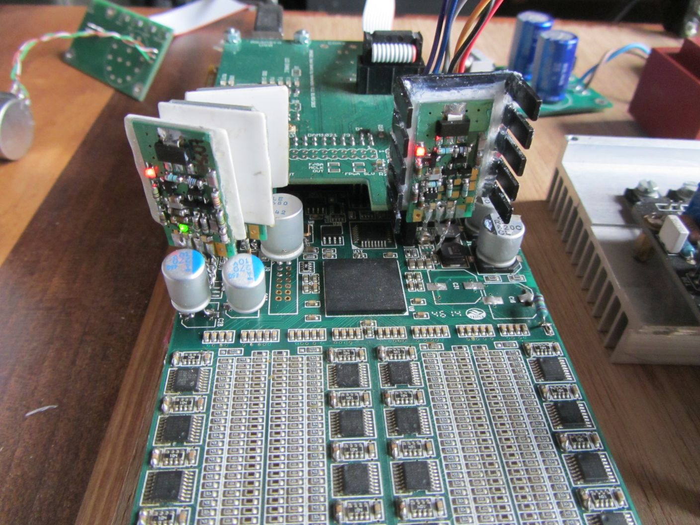

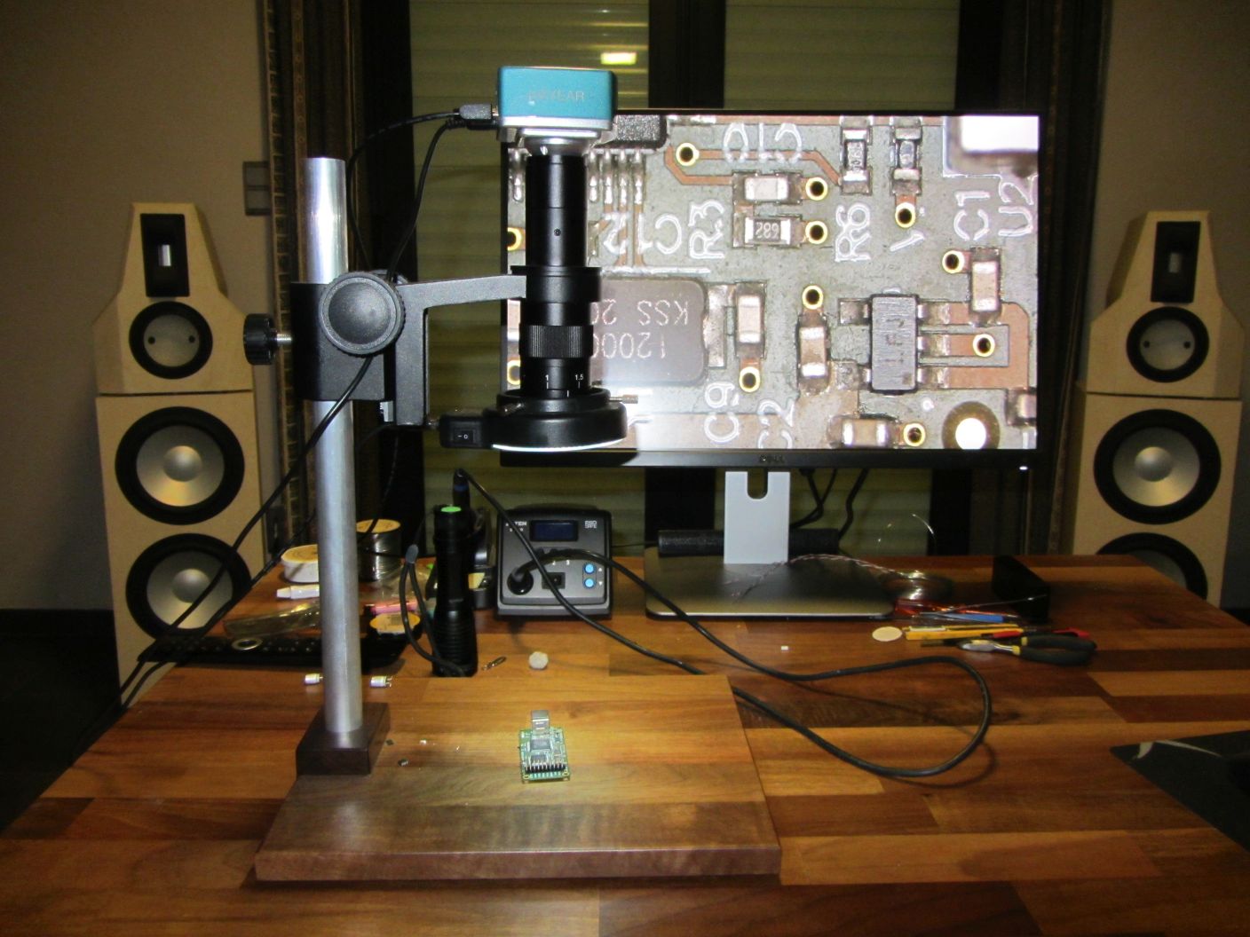

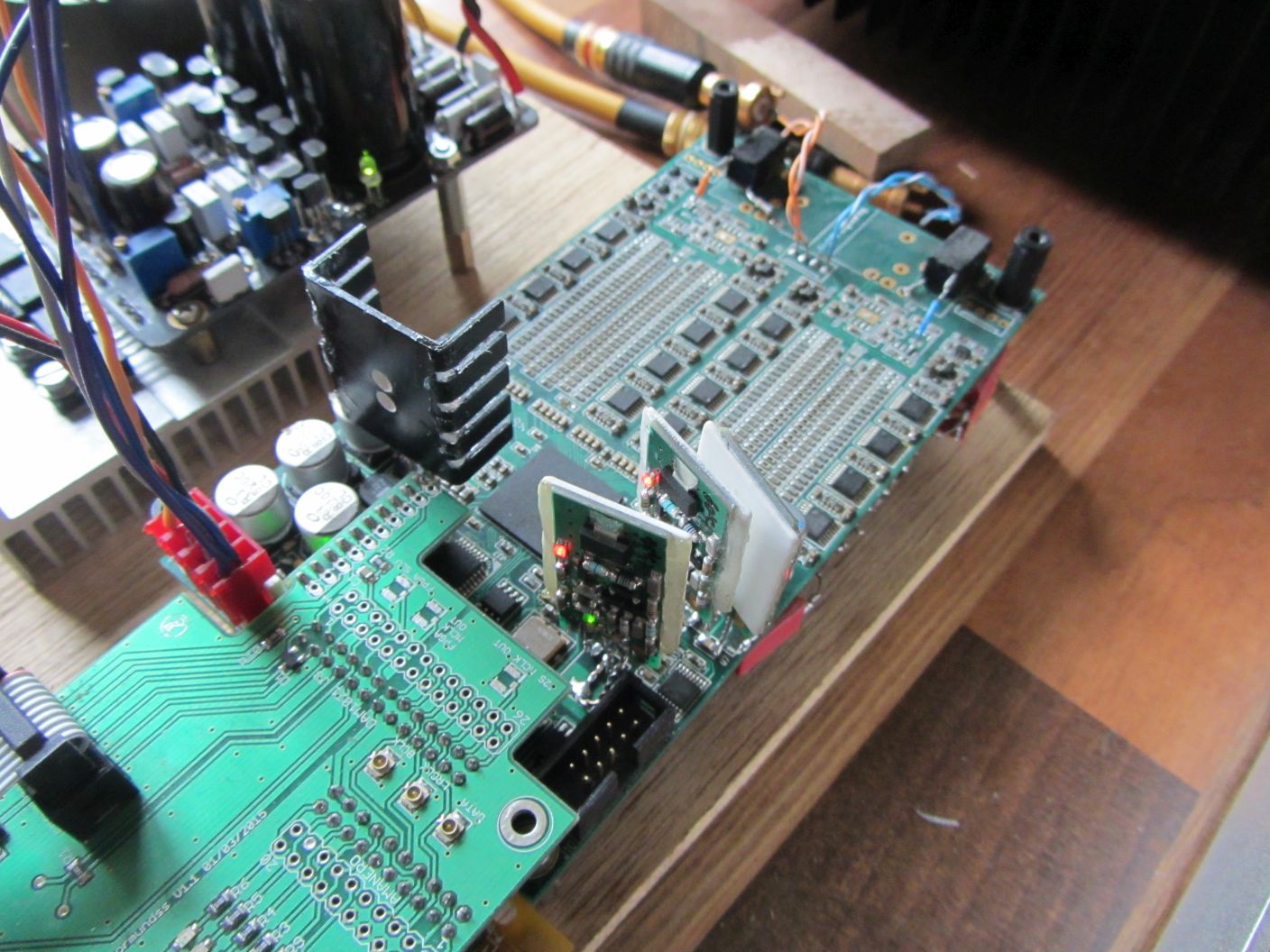

Last week I finished replacing the 4 onboard regulators 3.3v, 5v, -5v and 1.2v with muzgdiy regulators.
I glued some alumina ceramic pads on the back for better heat transfer, on the 1.2v I added an additional heatsink.
Result of this: better 3D soundstage, deeper, better separation between instruments/voices, more relaxed, ... all good
On the last picture you see the surgery table and my hdmi microscope that makes this minuscule soldering possible

what u do with the vref?
My board is a v1, for the vref I did the lowresmod and plenty of polymer capacitors (32) on the back
ah ok
just seen the v1 board and wondered
Sören: On V3 / V4 boards - when adding caps, is there any OPTIMAL capacitance for the vref-design on these? Also, are the v-ref schematics like old but just different resistor/capacitor values or is there any other difference?
From rev2 and forward, the vref buffers use 0R1 and 499R/499R, giving a Zout of 0.05 ohm.
You can use as large capacitors as you want, but you will see diminishing returns above 500 uF per vref rail....
