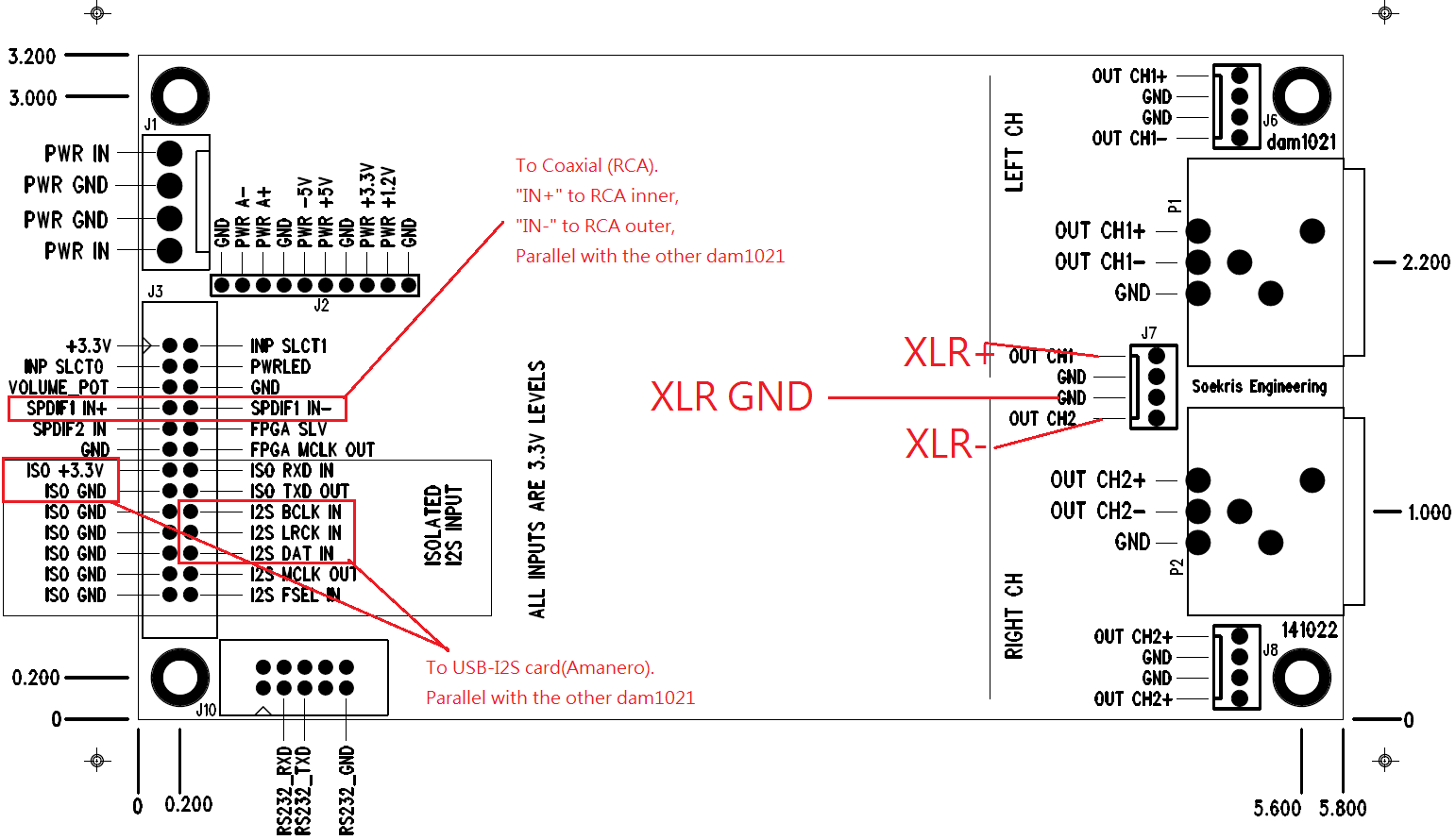

Hi Soren,
I have a problem, I am trying to setup two dam1021 rev2 in balance output. I used RAW output for each of the channel (see the attachment for detail). I used both USB and S/PDIF1 (in RCA) and for both connection, the DAC can lock and make sound.
I tried to test the two cards before by mounting them on a wooden broad and it was okay. Now they are mounted inside a chassis. Their grounds are not interconnected (I use plastic screws for mounting) only at the point of XLR gnd. And they doesn't share the same power source (no beep from DMM for GND, +/-5v, 3.3v, iso 3.3v, 1.2v in J2 in two cards). I have also loaded the v099 party pack (The v099 Party Pak | moreDAMfilters) and selected F7 (newnos) in both cards.

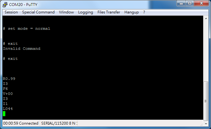

After the firmware reload, everything seems reset, I use RCA jack for testing but the low volume issue still exists, then I went to uManager and set mode=bal-right again but still the output volume is extreme low.

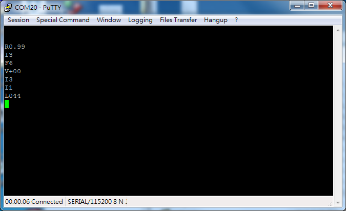

What does the dam1021 print out when powering up, especially the Vxx status ?

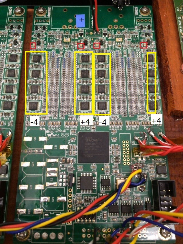

Please post some pictures of your setup so we can take a glance, you might have overlooked something.

It seems to be V+00What does the dam1021 print out when powering up, especially the Vxx status ?

It's powered by separate power of +/-5v DC and +3.3V DC, the +1.2DC powers from a LDO source from +3.3V, I leave ISO 3.3V unpowered.How are the boards powered ?
I use coaxial cable to play music from squeezebox duet, it also plays to another dam1021 (rev1) which also have exactly the same power mod like this one. (rev1 has vRef mod but rev2 that having problem now doesn't have any vref mod yet).And of course check your software....
Also I double check the voltages (the red and yellow parts), all are either +4V or -4V.
It seems to be V+00
Ahh, a heavily modded board....
The new mute circuit in rev2 is sensing the power input. Without power there it's probably muted....
Let me think about a recommended work around. A quick fix is to connect PWR_A+ to something, maybe 5V is enough.
Actually, the muting circuit itself need negative power, which it gets from PWR_A-, -5V is probably enough there....
First thing to try is to ensure that PWR_A+ and PWR_A- get +-5V, not just being left unconnected....

Confirmed that's due to what you said, and I have fixed. It can't be fixed with just +/-5V, I used +/-12V which gets from the +/-5V board before regulation.
