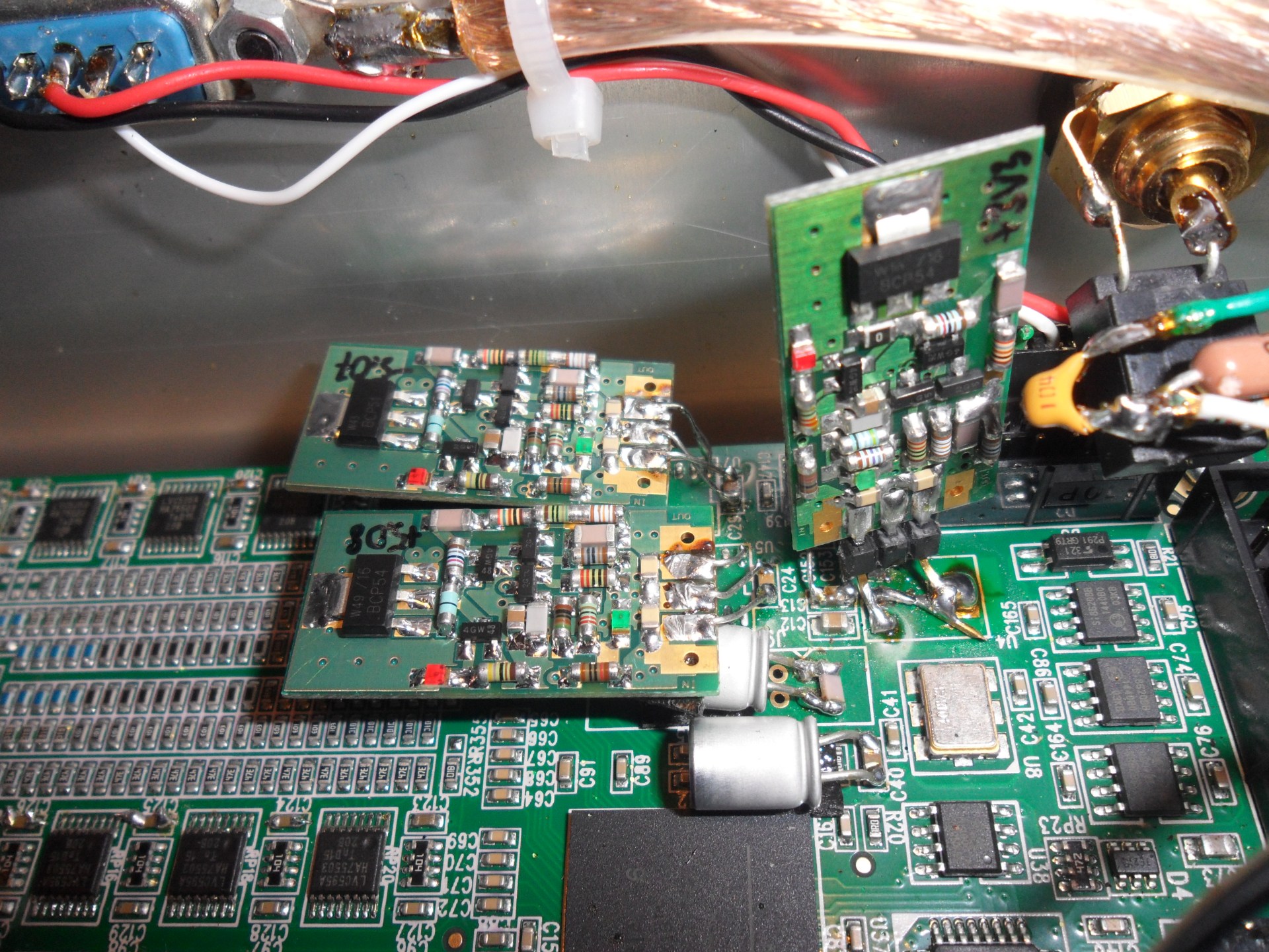

Hi all.
Still have problem that my dam1021 can't lock signal if it has been powered off for a day or two, need to upload FW(0.99) again to get a lock...MAD!!! Anyone?
Anyway, i did a small PCB to get nice 3.3V for usb, 1.2V and space for a SPDIF transformer (Murata). It use low noise ADM7150 LDO regulator. I use to have a cheap 3.3V standard reg to power usb and input isolators. Nice upgrade i think.
For 1.2V to coax transformer it uses a standard MCP1703-1202.
PCB is 70*30mm.
If anyone need one i have 3 that i don't need.
Regards //Daniel

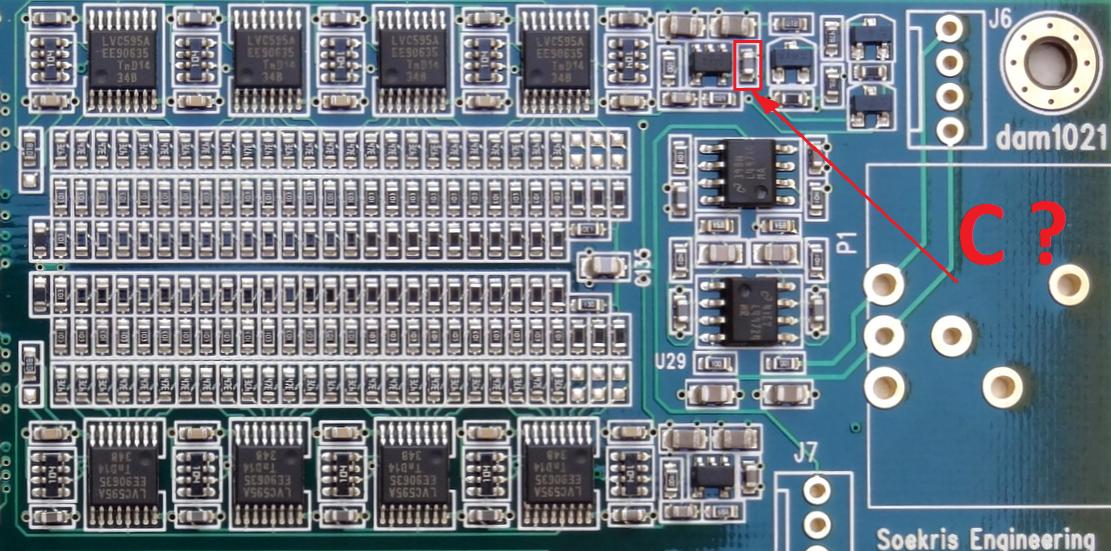

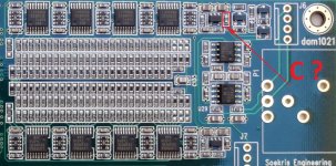

It has dropped an object on my DAC and this capacitor is broken.
Does anyone know what capacitor is to order a new one? Thanks a lot.
1u X5R 25V 0603, not that critical decoupling capacitor....
Hi all.
PCB is 70*30mm.
Regards //Daniel

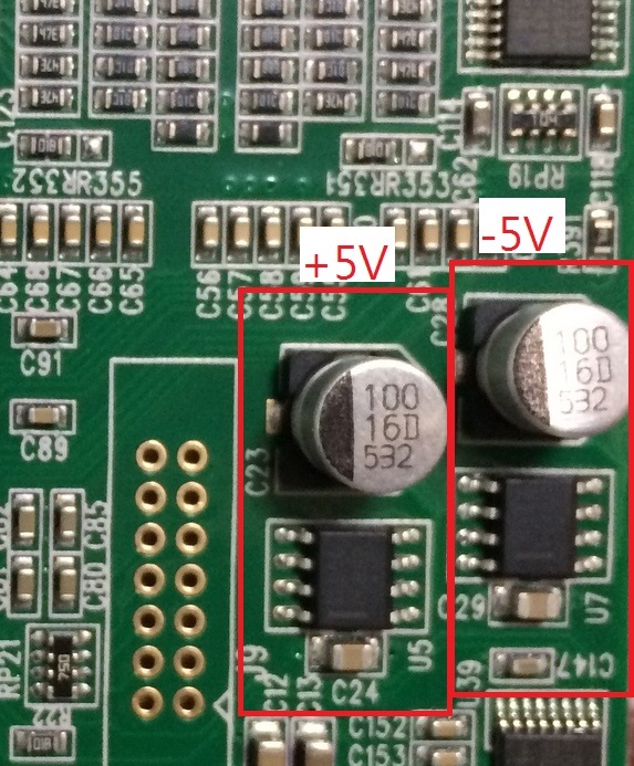

I am going to replace this part
Just remove the two LDO and capacitors and connect the +/- 5V to the capacitor pads.

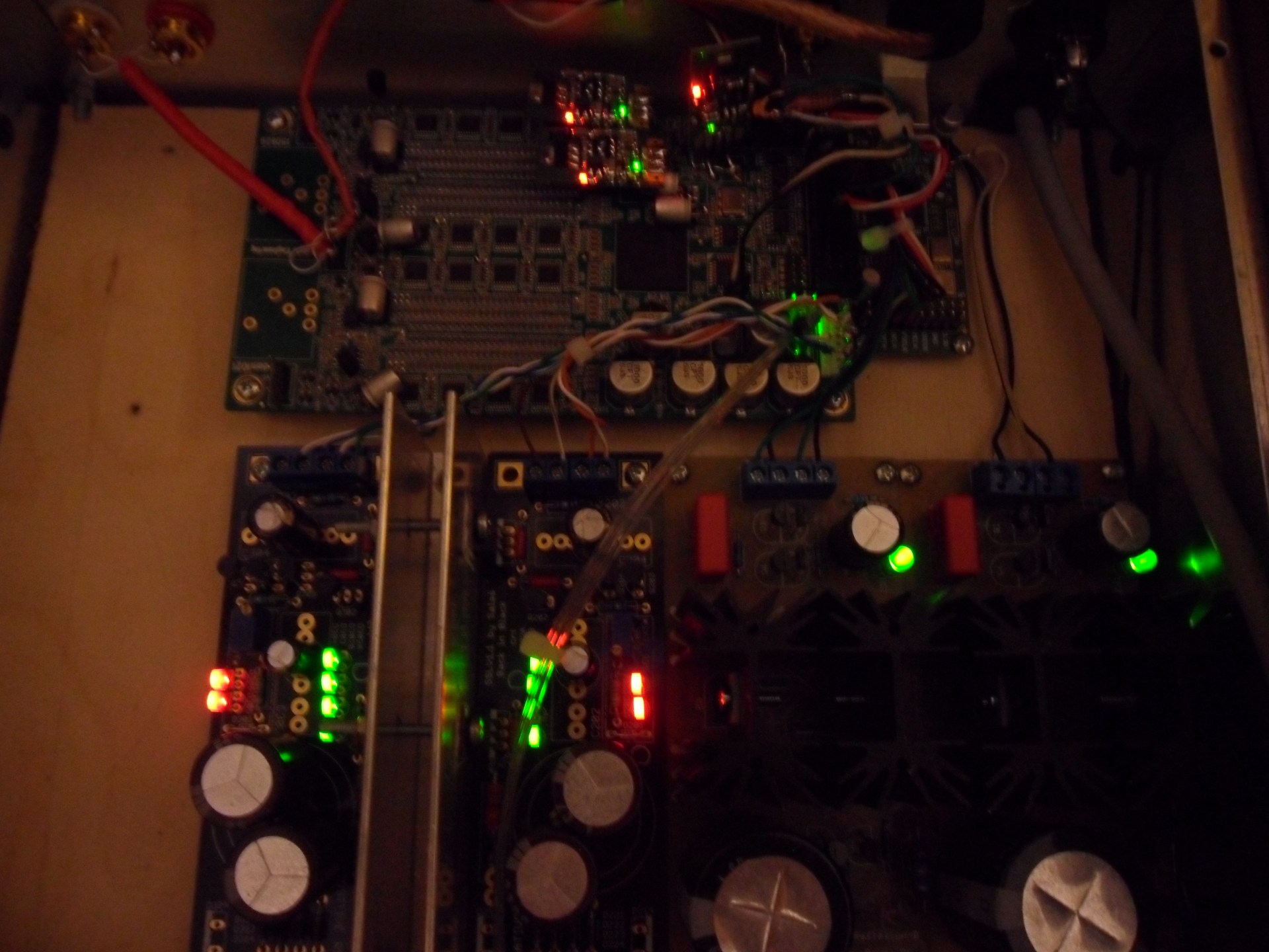

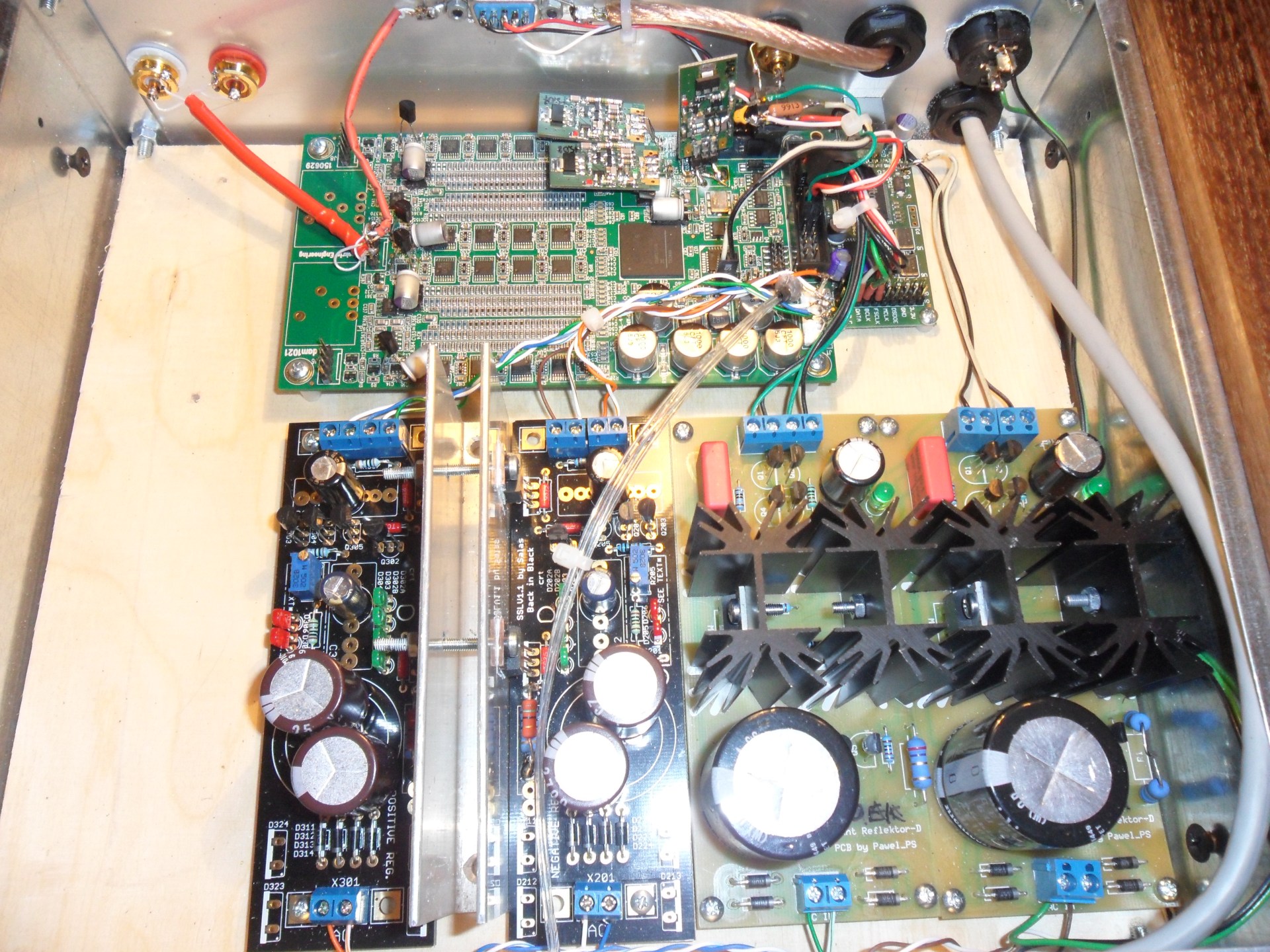

If anyone wants to follow I think nige2000 has come up wit the best way to handle the Vref.
My implementation uses the regulator sold by mravica elsewhere within the VENDORS area. It is two positive regulators using a common ground.
Using the A123 26650 batteries, I am using four, I have removed all of the OEM regulators for the resistor stack. Two of these batteries per channel for the plus and minus supply of each channel. The regulator is connected to its proper side for both channels.
You are limited to 3.3 volts since that is all the batteries should be asked to produce. In this case, the battery is used as a super capacitor; the regulators are always on. One needs a constant voltage, obviously and there is no way to do this with batteries alone.
My setup is producing 3.317 volts for each rail. It doesn't waver at all.
All capacitors are removed. In fact, I have removed just about everything from the board other than the resistor stacks and the shift registers. Suing the HIFIARDUINO method for adding capacitance I use the vias near the shift registers for wiring to the batteries.
This is involved but all in all I think it is simpler to implement than any of the other schemes.
For the input side, the DC-DC converter for the FPGA has been replaced with a BELLESON 1.2 volts regulator. The 3.3 volts reg has been replaced with another A123 battery which is regulated by one of DOEDE's shunt regs set to 3.3 volts. One could use whatever they like, or have on hand, here.
The thing sounds very good but still nowhere close to my LP setup but that is to be expected.
Needless to say comparisons with other approached is impossible but it sounds like a very different, and better, device to my ears.
The lower voltage seems to make no difference at all. It gets louder than I would ever need and it is driving two amplifiers and an active crossover.
I am using a SLAGLE autoformer for volume control.
I uploaded the new firmware in this condition so I know all of that works as intended. There are no drawbacks that I have come across. I have had this operating for a month. I do leave it on since I have not made provision for blocking the batteries from powering the regulators in reverse. There is a switch to turn on the "front end" battery and another pair for turning on the resistor stack batteries, left and right channel. Switch the front end on first and then the resistor stack - easy as that.
I cannot imagine any Vref regulator, alone, bettering this approach. The A123 batteries are quieter and faster than any regulator I am aware of and due to the configuation of the mravica regulator voltages for plus and minus are the same all of the time.
I consider my SOEKRIS finished and I am very pleased with it.
