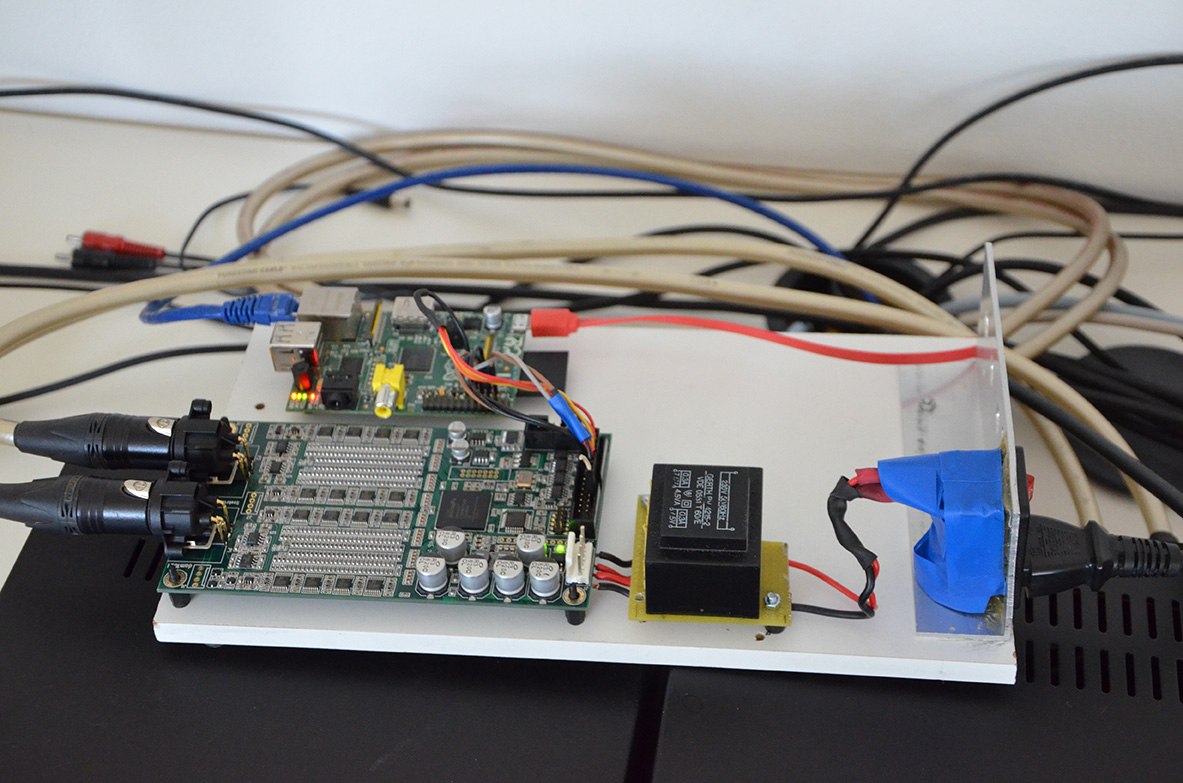

I have made a temporal set-up with a Raspberry Pi and a I2S connection.
When I use Vortexbox 2.3 as a music server and all settings are correctly installed, I can play DSD via DoP, and it sounds very well.
I can use a ESS 9016 as a reference who can play native DSD.
Correct, Vortexbox 2.3 has a little program DSD2PCM.Besides the obvious problem (that the DAM does not support DoP or DSD playback), neither does the I2S connection of the RPi, so Vortexbox must be doing DSD to PCM conversion.
It sounds wonderful.
