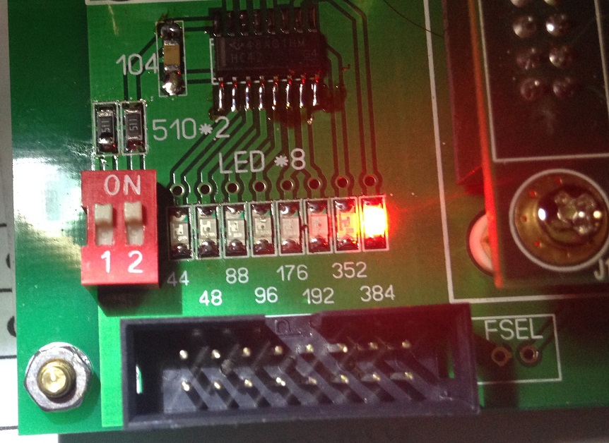

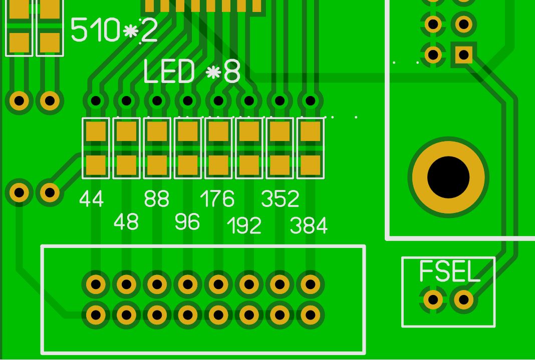

The above picture was upload by Kiven and also share the broad for us . First and second picture from left was the completed installed the Amanero Combo with R2R DAM Dac there are serveral on broad led to indicate the real time sampling rate. The rest of picture just a comparison of the different version of the main broad
Thank ericlhs
LED display close-up pictures
Use the dip switches to select an external LED or PCB LED display.
