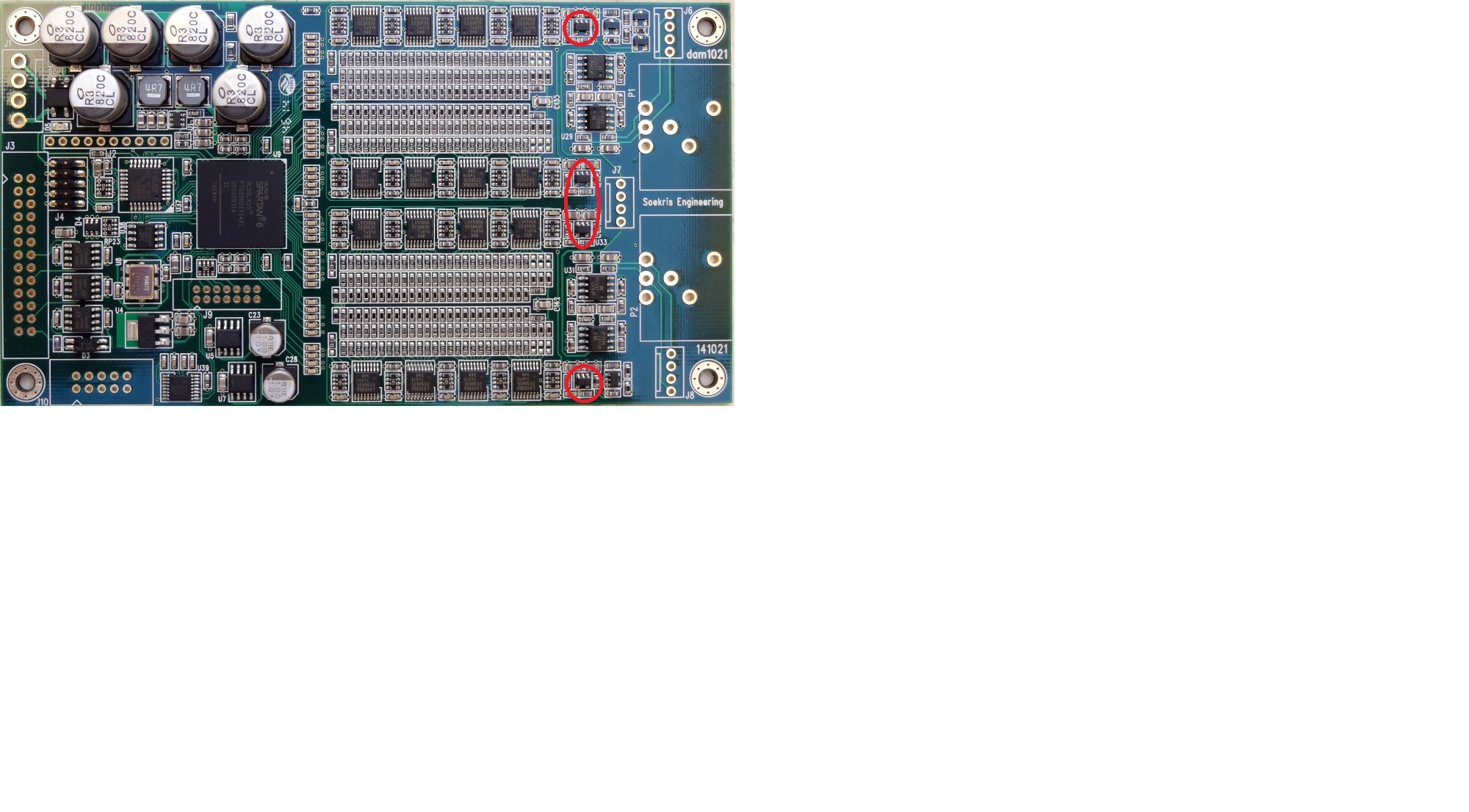

here is a picture from link.
What I can see from the board is very small switching 1.2v regulator at capacitor rails, 3.3v LDO at clock, +-5v LDOs. Please let me know if I miss..
remove those four LDOs and supply each voltages via J2 pins, will it be okay?

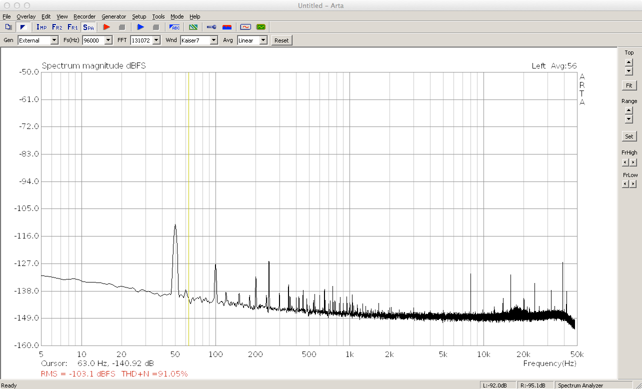

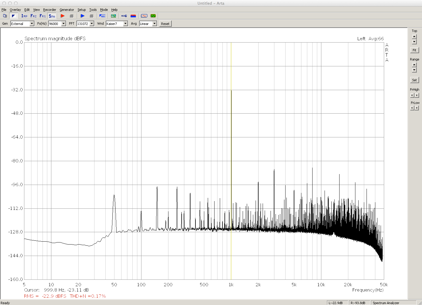

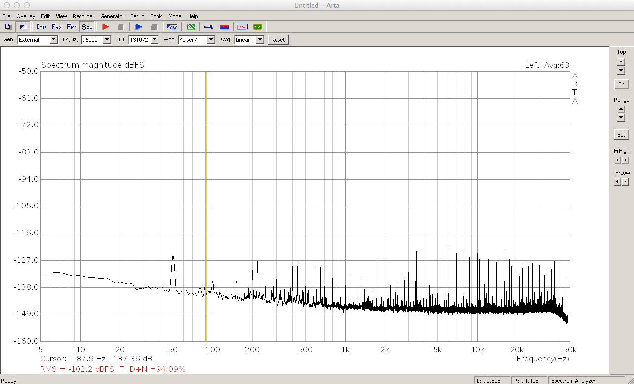

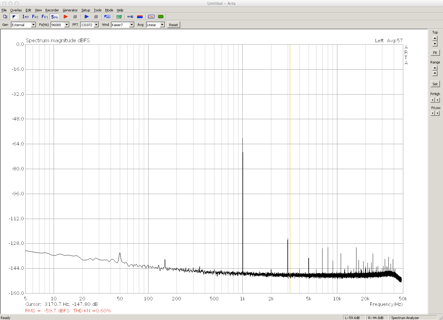

Coming back to the noise via the serial connection.
997hz sine test tone, at -6.2dBFS which is just shy of clipping my audio interface's line inputs via Amanero, then balanced out - > TRS 1/4" inputs.
USB disconnected:
USB connected (but serial not active):
Peak level of the tone is -0.2dB on the plots, and reflects the level is just below clipping point of the input.
The main difference is the noise floor is about 2dB higher with USB connected, as you'd expect.
There is no obvious degradation to the signal.
What will make a big difference is if the serial interface is active, which I didn't test this time around. The RS232 interface chip goes to sleep fairly aggressively - which makes serial volume control a bit problematic at present. When the interface is awake it has an onboard switching power supply to boost voltage to RS232 levels. I suspect the high levels of distortion are related to the switching power supply being active rather than the USB - RS232 interface being connected per se.
What I was refering as serial conection, which passes somehow some 50Hz noise throught, was the RS232 interface. It would be strange that a SPS of the RS232 interface would show 50Hz harmonics, or not?
So more precisely my graphs are both with USB audio once with and once without the serial RS232 interface connected.
The noise floor is with DAM disconnected and input ADC shorted. The measurement was done with a RME Fireface 800.

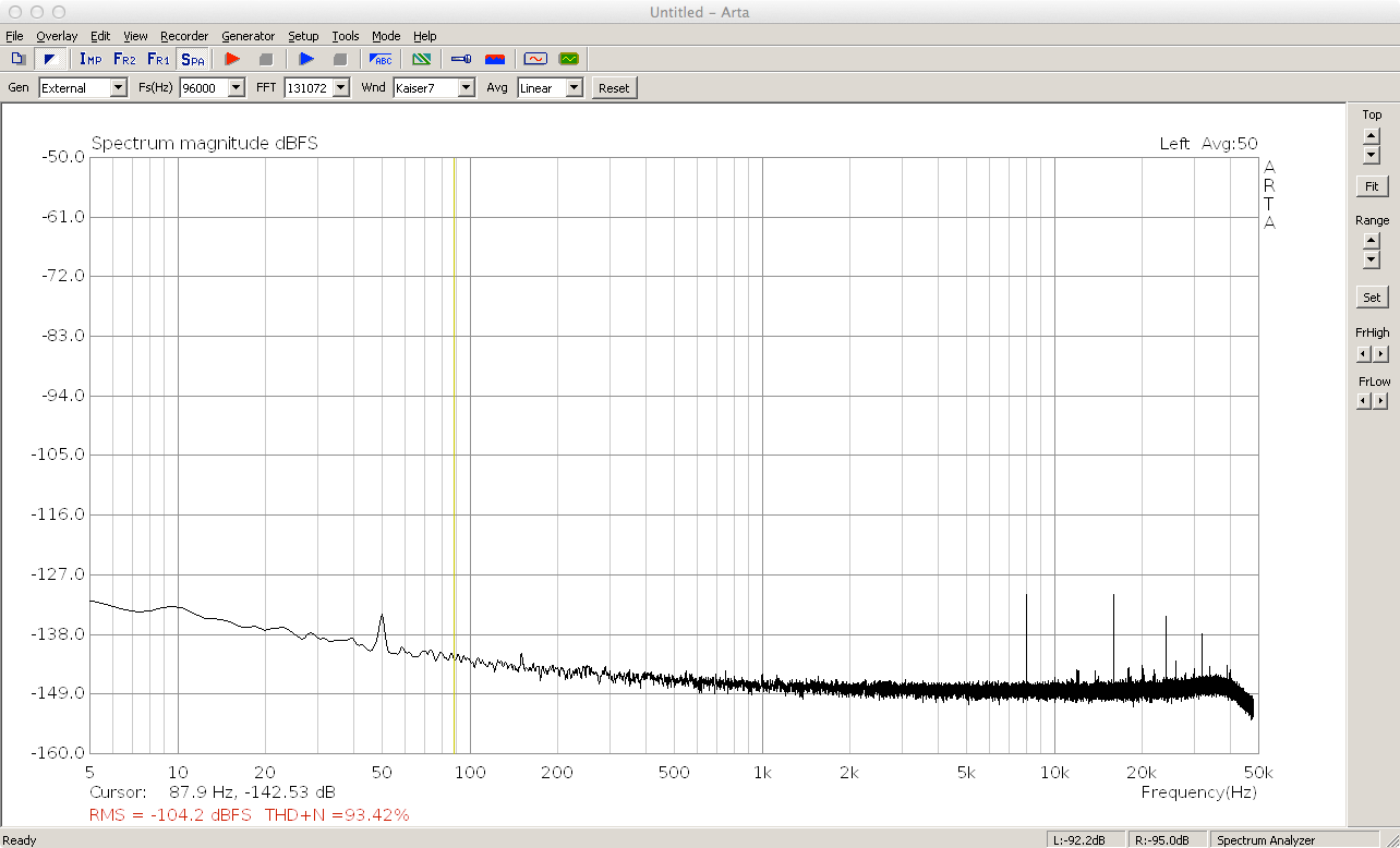

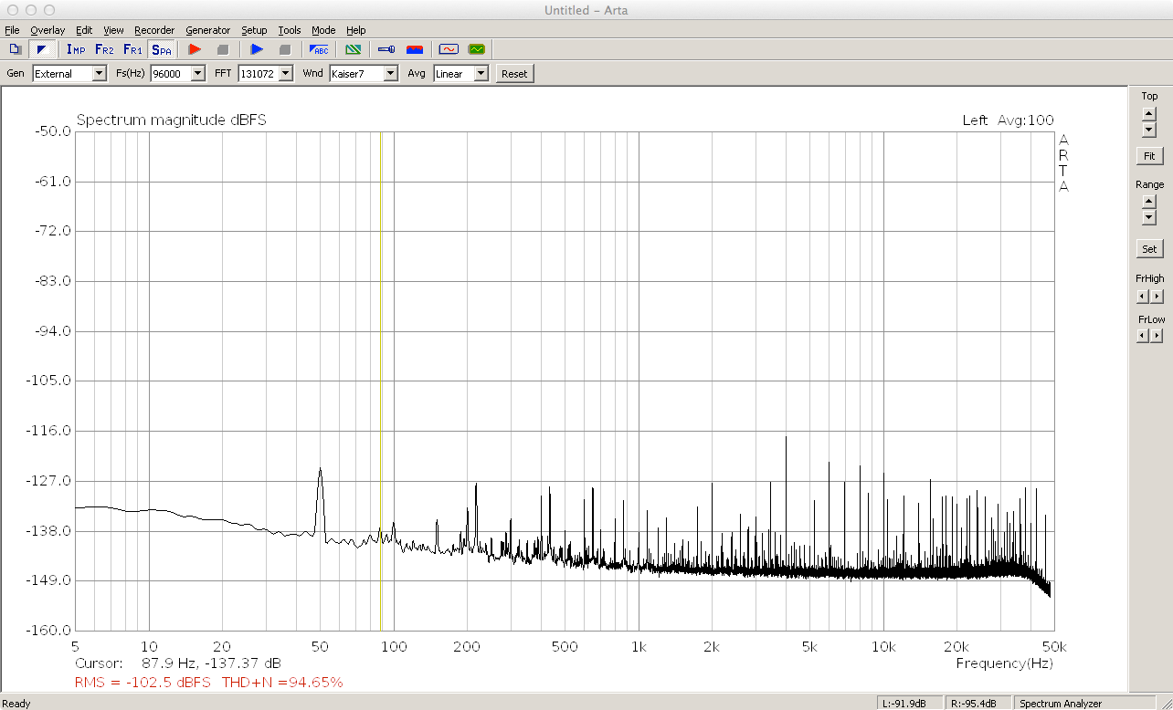

So I measured a balanced connection, moreover I tested several things I forgot the last time.
Firstly with SE it only matters is RS232 is connected or not, no influence what is connected to the computer, if the RS232 connection is established or not, to which computer it is connected,... As the Firewire 800 can not be run bus powered, I can not avoid the ground loop which probably causes the effect.
Secondly with the balanced connection the 50Hz stuff is less and the difference between RS232 or not, is only minimal more overall noise. So I admit I was wrong here
Here some measurements with nothing except power and serial (or not) connected to the DAM (so no signal)
Balanced no RS232, with RS232
SE no RS232, with RS232
The measurements were made with the same settings, if you now take in account that the balanced signal level is 9dB higher, the balanced plot look no that frightening anymore.

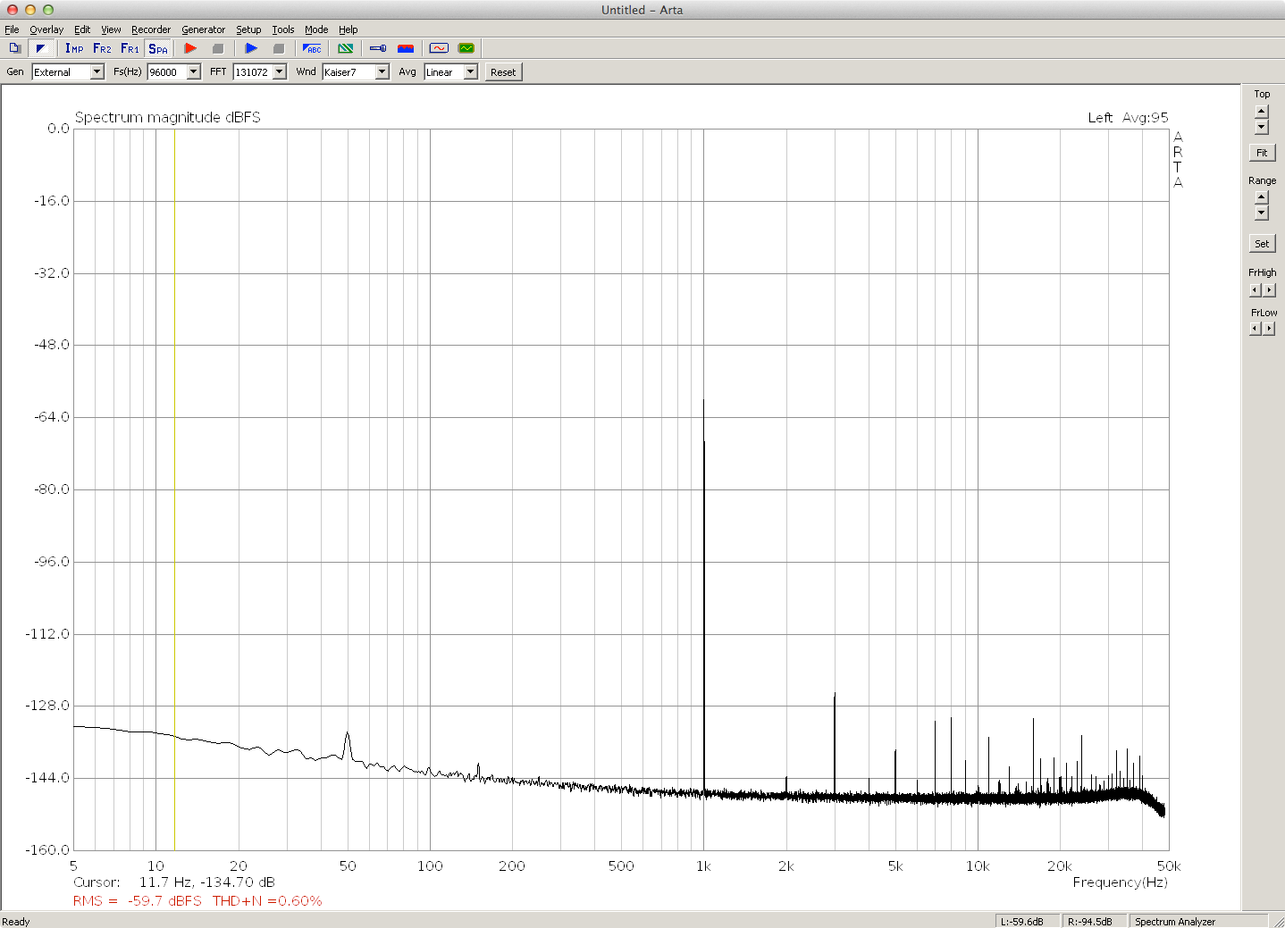

Now plots with a 1kHz -60dB signal (without RS232 and still unchanged settings)
SE/balanced
if you subtract the 9dB from the balanced you also end here more or less with the picture of the SE except the 2kHz and 4kHz harmonics, which seem to be relatively higher in the balanced case.

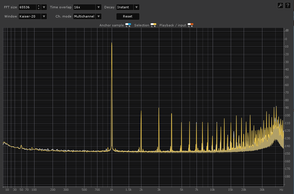

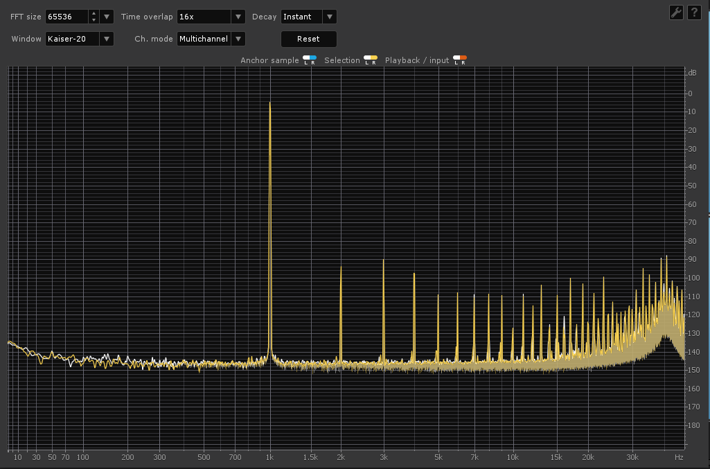

The spectrum looks like square wave at -90 dB with some oscillation at 32 kHz

What I can see from the board is very small switching 1.2v regulator at capacitor rails, 3.3v LDO at clock, +-5v LDOs. Please let me know if I miss.. :rolleyes:
remove those four LDOs and supply each voltages via J2 pins, will it be okay?[/QUOTE]
You forgot about LDOs powering shift registers which directly drives R2R ladder. IMO performance of this LDOs have huge impact on analog output performance.

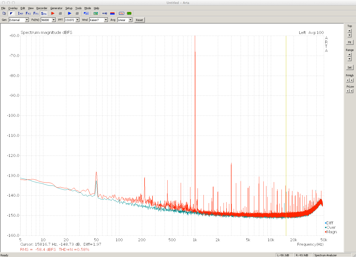

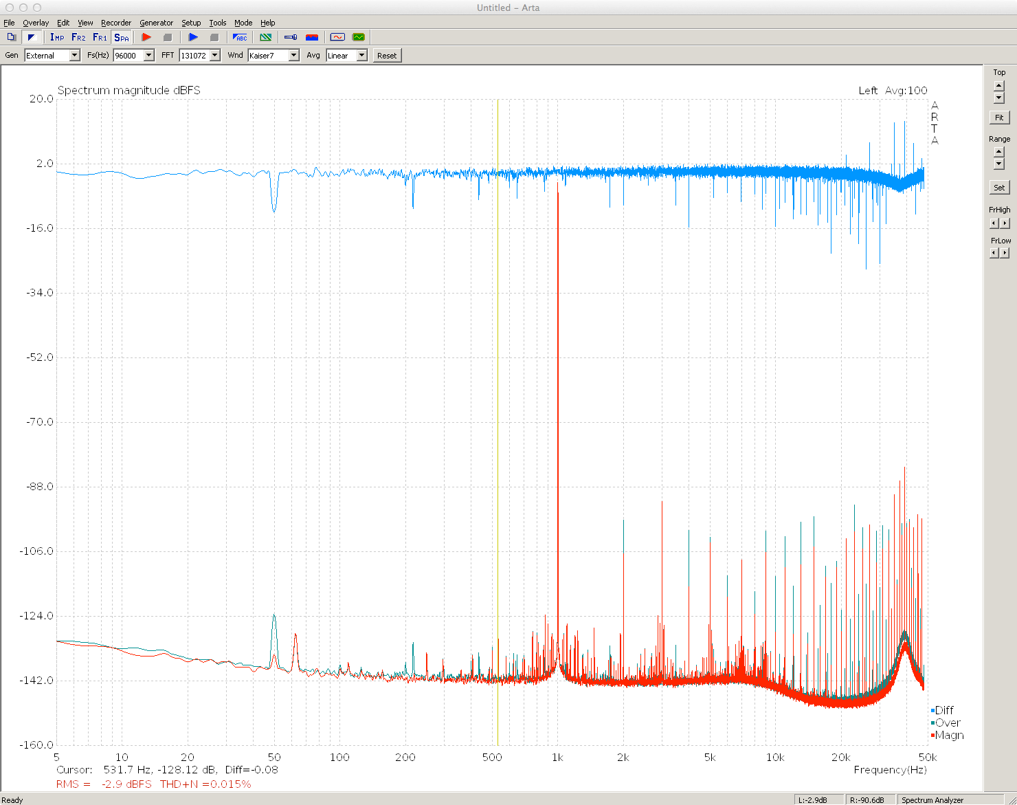

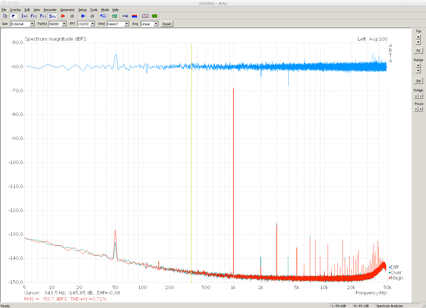

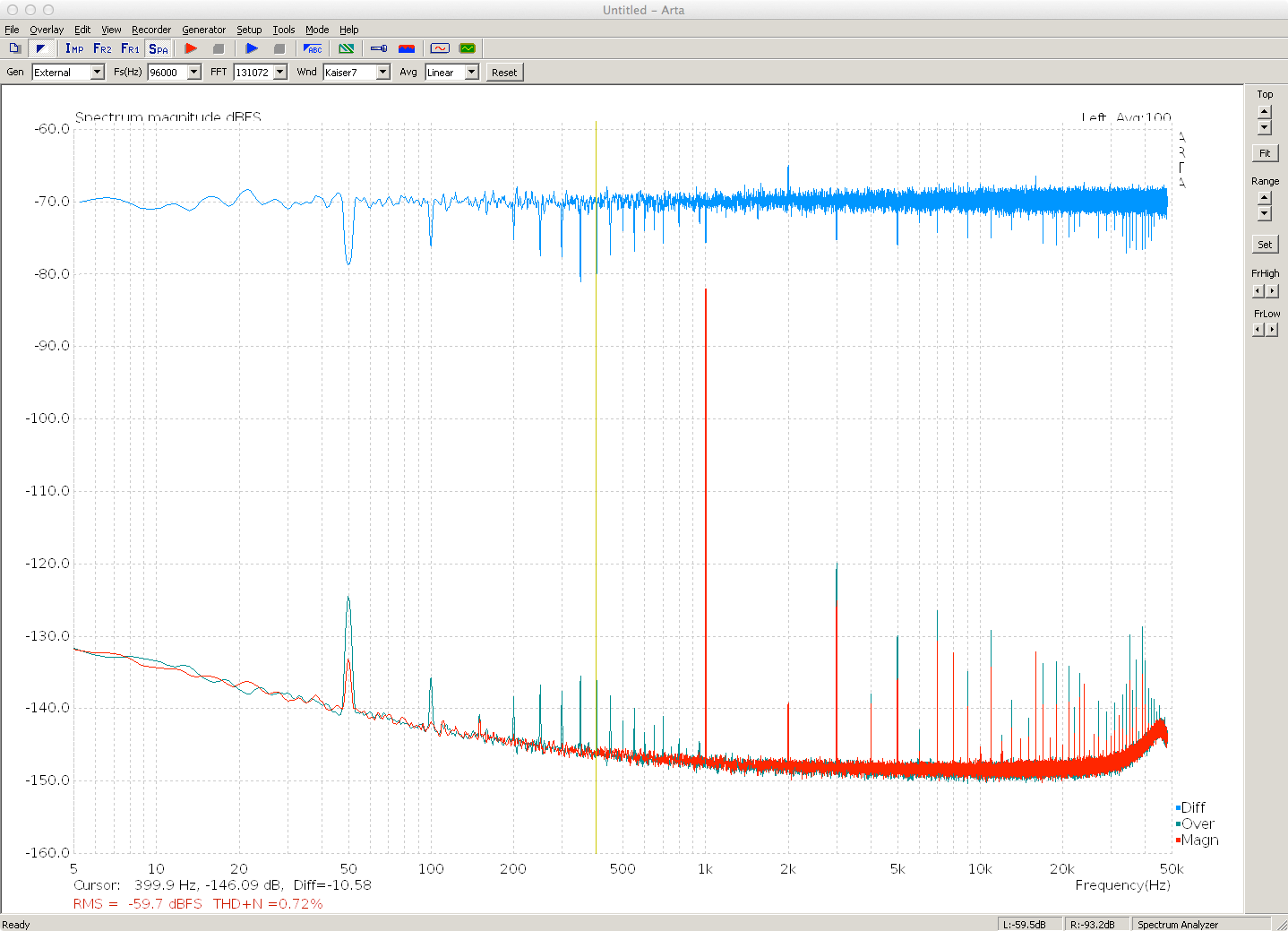

The balanced (not yet) dual mono preview!
I inverted the signal on one channel and fed both (from the SE terminals) as balanced signal in the ADC.
Here an overlay of balanced mono (red) over the ordinary balanced (gray-green).
To obtain the same signal level I had to use a 0dB signal on the balanced mono and -4.5dB of the ordinary balanced.
The balanced mono performs in general better on the even harmonics.

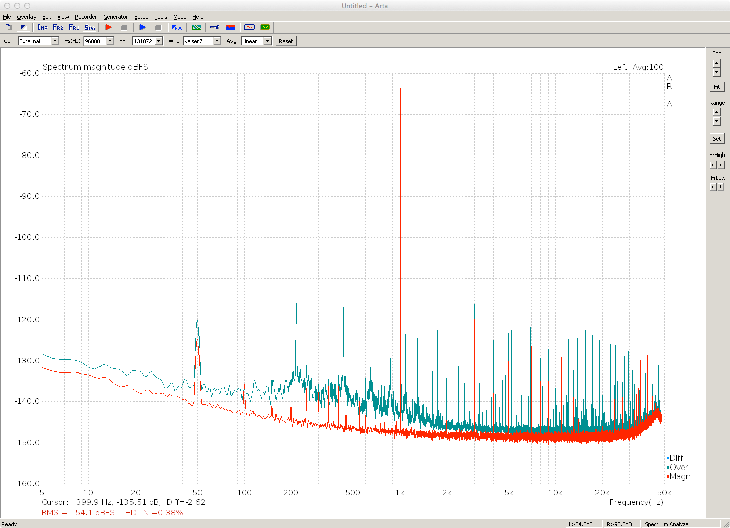

The same for -60dB (resp. -64.5 for the ordinary) with 9dB gain at the ADC input for more details.
Just to verify that the different gain does no real harm, here the overlay with the same -60dB signal (so the level of the ordinary balanced is 4.5dB higher at the ADC input). The colors are swapped.
And the balanced mono compared with the SE output (red) which is one half of the balanced mono (same digital signal thus -6dB weaker peak at output).
You see that the SE has larger second harmonic. If you shift the other peaks by 6dB most will disappear except in the area around 400Hz where the SE looks better.
Finally the overlay of right and left channel of the above signal. You see e.g. significant differences on with the 2. and 4. harmonic, probably due to the resistor tolerances.

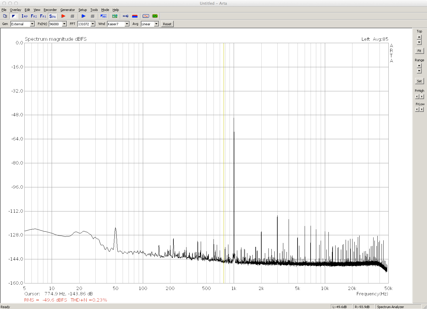

P.S. if you are interested, I experimented with the variable gain inputs. You get maximal about extra 45dB analog gain over the SE-input setting. Which gives you this plot
instead of this
With the DAM SE out ... no terribly more information and I am not sure how reliable the results are.

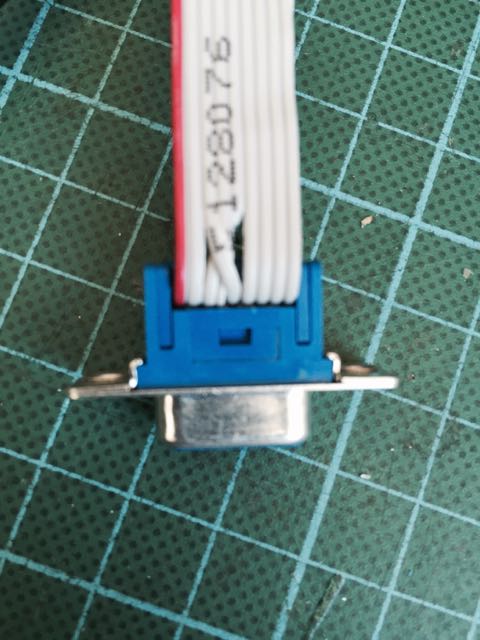

On a slightly more practical note...
I was having to repair the cable from RS232 header to DB9 socket on a reasonably regular basis due to the wires breaking at the solder joints. The socket isn't mounted so was subject to stress every time I plugged the RS232 adapter.
I've ended up getting an IDC DB9 connector from the local parts barn ( DB9 Female IDC Connector | Computer | Plugs, Sockets & Adaptors | Interconnect | PRODUCTS | PS0805 | Jaycar Electronics ), and swapped the TX and RX lines in the ribbon cable. I split out the individual strands before I had thought too much about what I was doing
A better way to do it is to split the three wires for TX GND RX and twist theese wires 180° to reverse position of the TX and RX, then use a bit of sticky tape to hold the wires in position.
The board connector is 10 pin, so what I've done is use a 10 pin IDC plug, 10 strand ribbon cable, and a 9 pin IDC DB9. If you split between 2-3 and 5-6 at one end and twist 180° this gives a cross-over cable which allows direct plugging of the RS232 adapter. The wire from pin 10 on the board is not required and is trimmed.
1 -> 1 (red)
2 -> 2
3 -> 5 (RXD -> TX)
4 -> 4
5 -> 3 (TXD -> RX)
6 -> 6
7 -> 7
8 -> 8
9 -> 9 (GND -> GND)
10 -> x
Anyway the main advantage is this is a lot more robust (and neater) than soldering to the DB9 socket.
