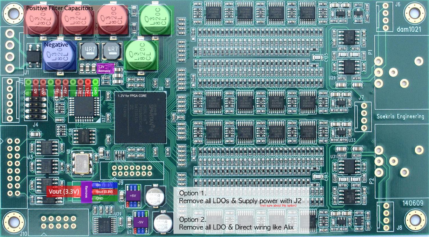

Hey guys,
I am not a big fan of LDOs, so I am thinking of remove all LDOs(+-5v, 1.2v, 3.3v) from dom1021 board and supply power with each voltages with discrete power supplies. Soekris mentioned that it is not recommended, but I think it might improve the sound.
Some will be very difficult to solder wire on board due to very tinny soldering surface; however, it will be clearly done if I use J2 Pins. The problem is I don't know J2 patterns can hold powers.
any opinions?

There are also LDOs (very samll) after J2 so you have to replace all LDOs with new sources if you want to achieve any progress..

here is a picture from link.
What I can see from the board is very small switching 1.2v regulator at capacitor rails, 3.3v LDO at clock, +-5v LDOs. Please let me know if I miss.. 🙄
remove those four LDOs and supply each voltages via J2 pins, will it be okay?

If you read more of the posts you would see this has been discussed many times.
J2 are power outputs. If you power from there it will not do what you want. In addition, the power will be too far away from its intended target. So you gain nothing since nothing is more useless than a reg not in intimate contact with its circuit.
SOEKRIS has assured the chances of destroying the board are far greater than any chance of success. It is not that he wants to discourage experimentation.
You can replace the 3.3 reg that powers the clock but to go further one should be ready to purchase another board. nige2000 has done this but he also eventually destroyed his board attempting to go further and I am not aware of anyone with more experience at doing such work. nige2000 is using a float charged battery setup there

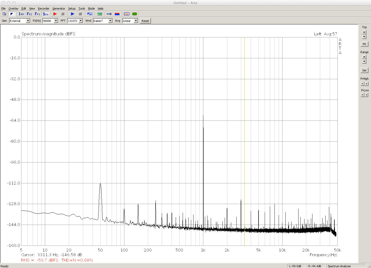

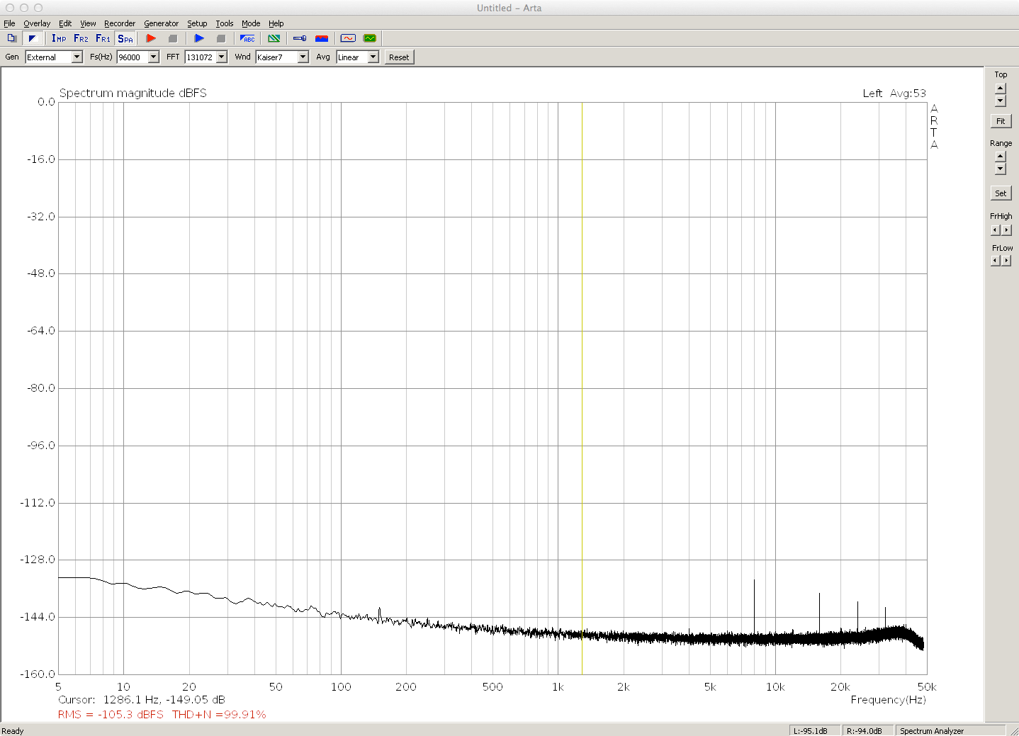

Coming back to the noise via the serial connection. I notice some 50Hz and harmonics enter the signal when the serial connection (via USB adapter) is attached. The music signal is supplied by USB from a laptop. If the laptop power supply is attached or not has no influence, but there are several other items connected to the laptop which are powered by AC power.
-60dB 1kHz with serial connection
DAM 1k -60dB dither 384:92 vol-24 serial.png
-60dB 1kHz without serial connection
DAM 1k -60dB dither 384:92.png
