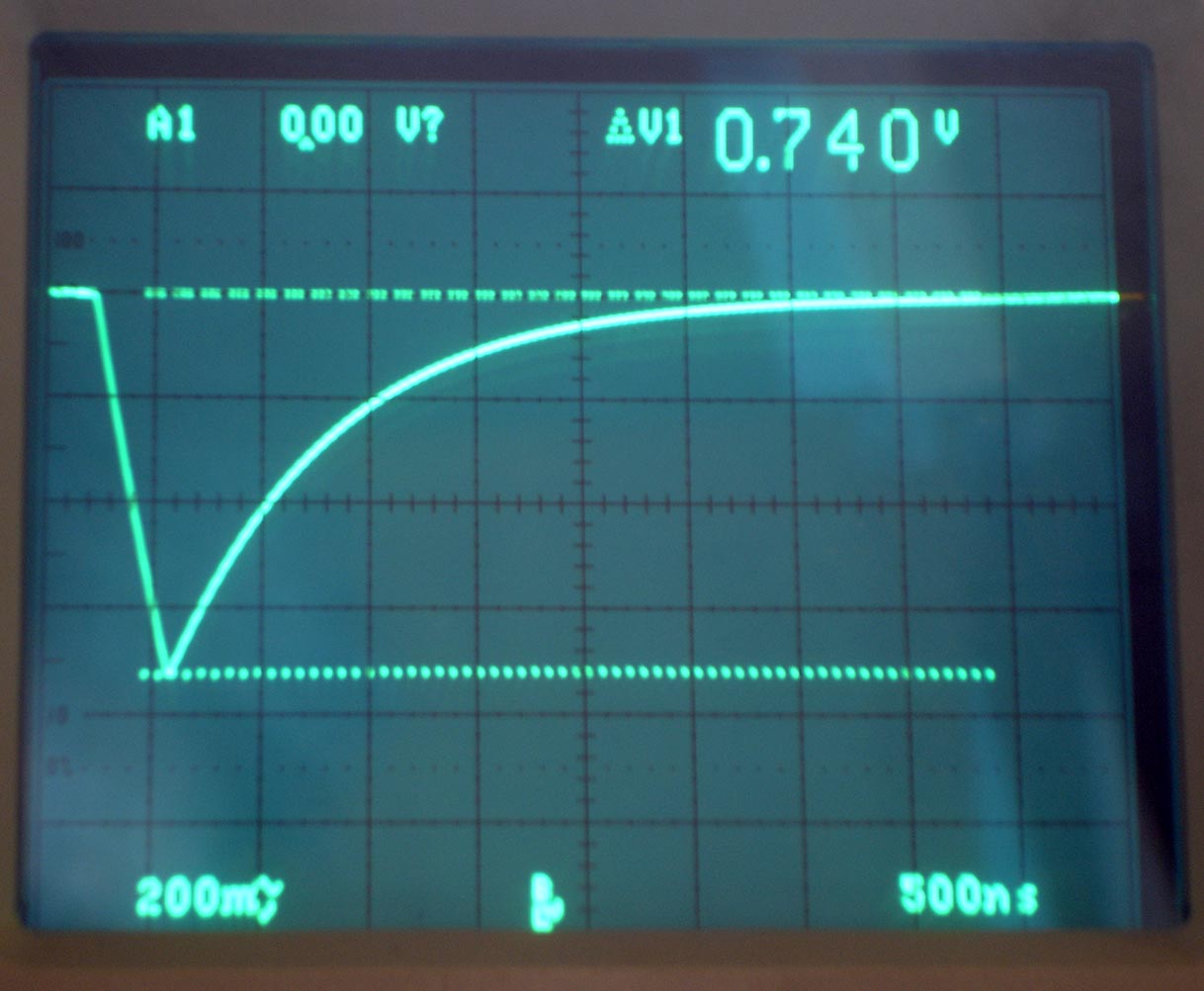

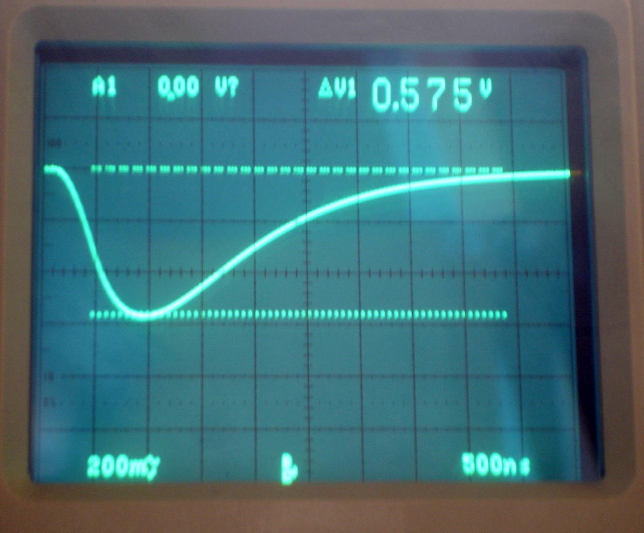

Moreover if you look at the output of the DAM of an single 1/(64*44100) second pulse you see that it looks different.
SE:
Balanced:
There will probably be no impact at the audio frequency range, but, as I interpret the images, there is some smoothing of (unwanted) very high frequencies at the balanced output. You might see that as an asset or an fault of the balanced output, your choice.

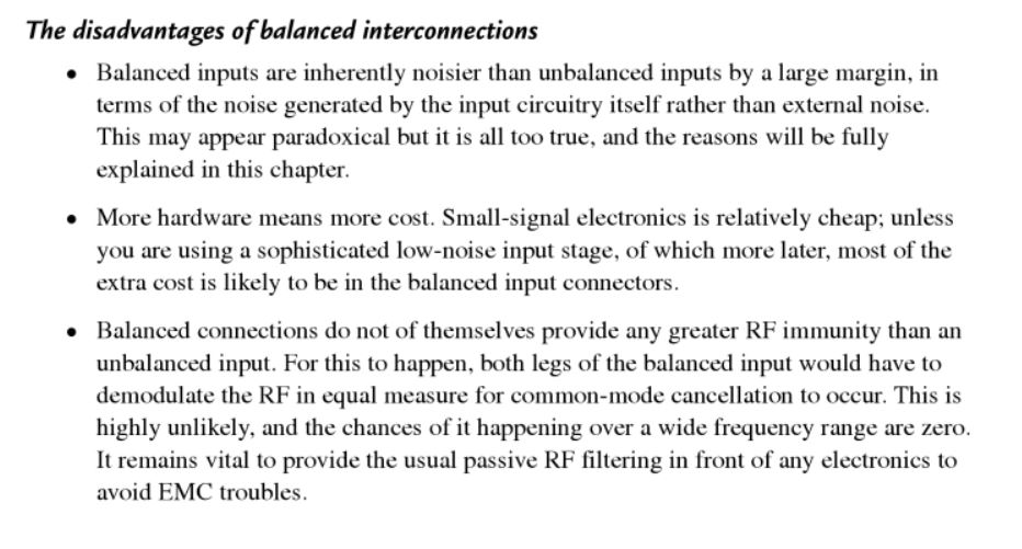

Helps if you read more than the bullet points. The comparison was between a very basic NE5332 balanced stage and a ne5332 unbalanced stage. At the end of the chapter the self compares a number of variants which are closer to what the hypex and dam uses and these are between 0.5 and 1.6db quieter than the SE line stage referred to in the summary.
It's always an idea to read the whole chapter rather than just cherry picking the bits you think support your argument.

Yes, but if you have a closer look you see that he needs to use 4 stages of the superior Op amps in parallel to achieve this numbers to beat a simple SE input build with the "very basic NE5332". If you do the same efforts for SE it gains its advance again.
Plus with balanced you've got all that extra circuitry. And the circuitry is a bunch of opamps.
Unless you need the external noise rejection that balanced can provide its not going to be a better solution.
Oh, unless the equipment you are connecting has crappy ground design. Then you might find balanced is better. But then it's just covering up bad design.

Most of the noise comes from the Johnson noise of 4x 10k resistors used in the basic balanced circuit. Show me the 10k resistors in the hypex input stage or the dam output stages. The DAM uses 10R resistors. The Johnson noise of a 10r is 30dBu lower than that of a 10k resistor. The quad and dual opamp buffers - which are input buffers Btw not output buffers, use 820R resistors which have Johnson noise 19dBu higher than the 10r.
Do you still want to argue about 14dB benefit to SE?
Any I'll take Bruno Putzeys recommendation that his products perform best with balanced inputs. If you want to argue about the benefits you can take it up with Bruno or Jan Peter. I suspect Bruno has a clue or two about the products he designs.
I was speaking of inputs, so the DAM side ins not the problem.
Douglas Self knows about the Johnson noise of the 10k input resistors ;)
He spend several pages to explain that you need high input resistance for good CMRR and how to modify the design to get around the noise. Simple buffering was not enought. As result you see that you need quite an effort to achieve noise-wise the same performance as with the straight forward implementation of the SE input, if you do not want to destroy the benefits of the balanced input.
If your hypex, Jan and Bruno has implemented it similarly well, fine.
I bet most of the manufactures did not do such an effort on the balanced inputs.

The ucd180 has an instrumentation amp configuration with a lm4562 used as a differential buffer. maybe not Selfs fully tweaked config but not nearly as bad as the basic buffer.
Of course you can tweak either design, but it is a bit silly saying look see what doug self says - balanced is always worse than single ended. It depends on implementation. My amps work best with fully balanced inputs - maybe the dam is a little worse using balanced but it's swings and round abouts. Fortunately I got over audiophillia nervosa years ago, so I can live with that.
