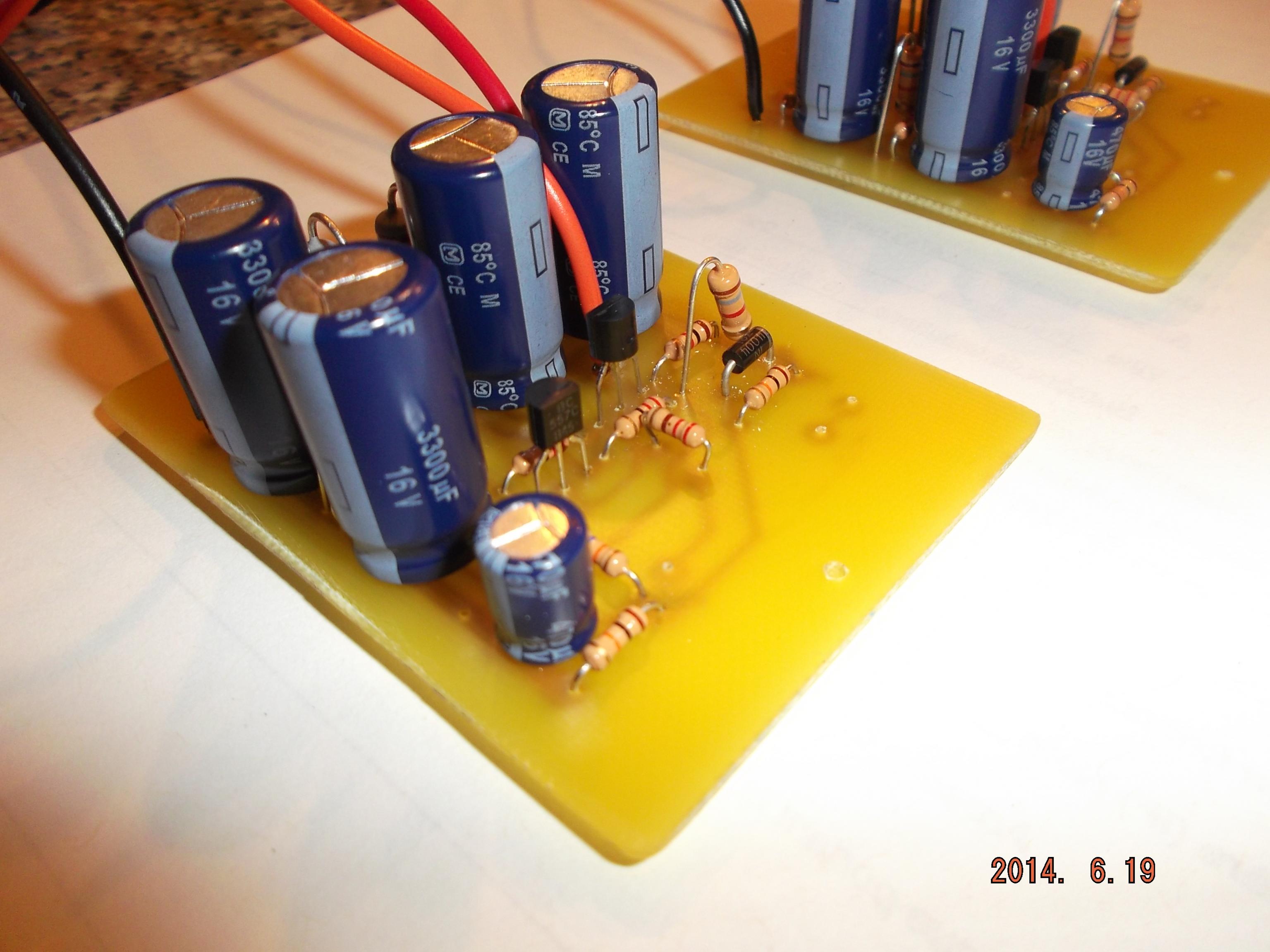

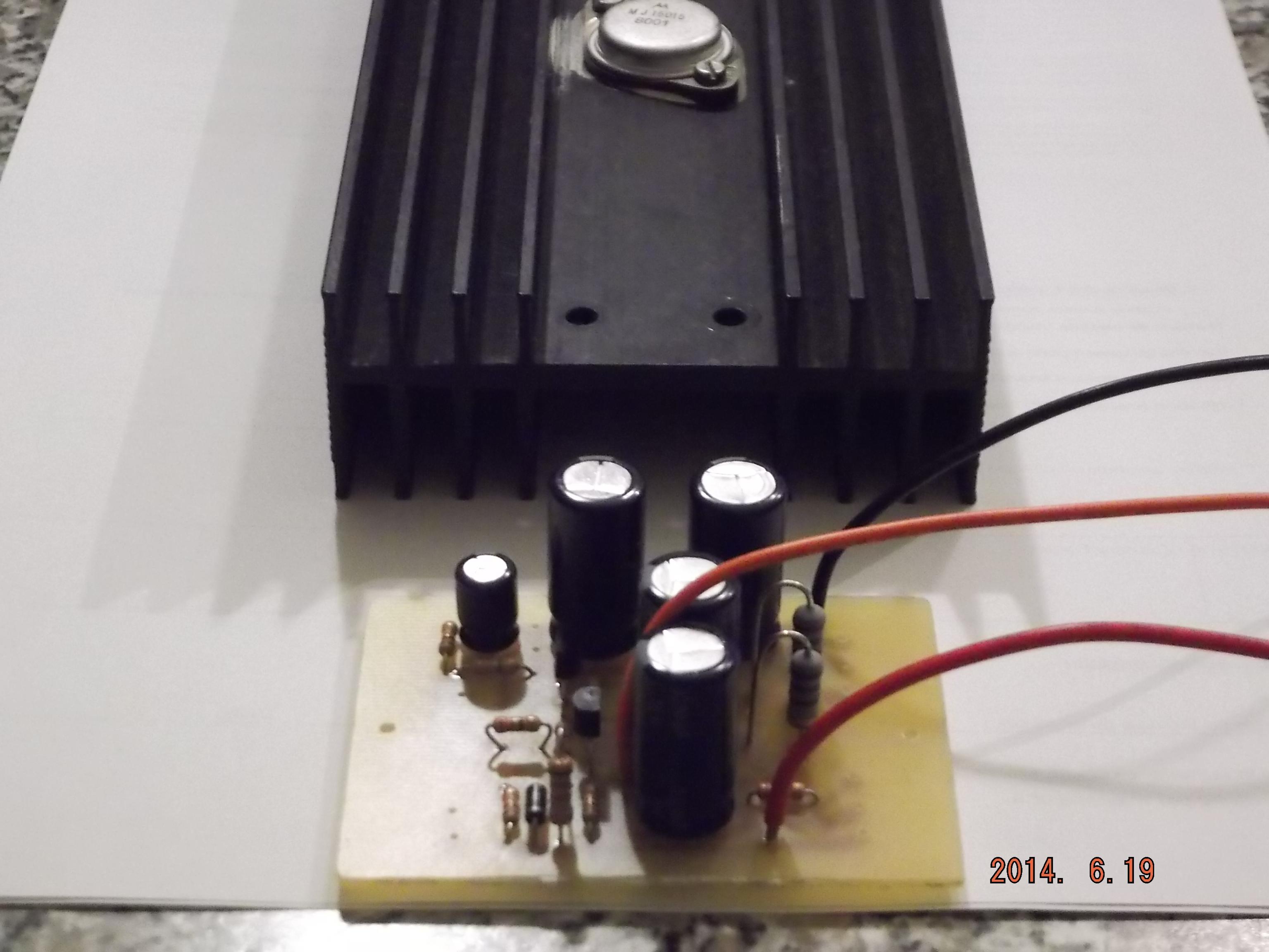

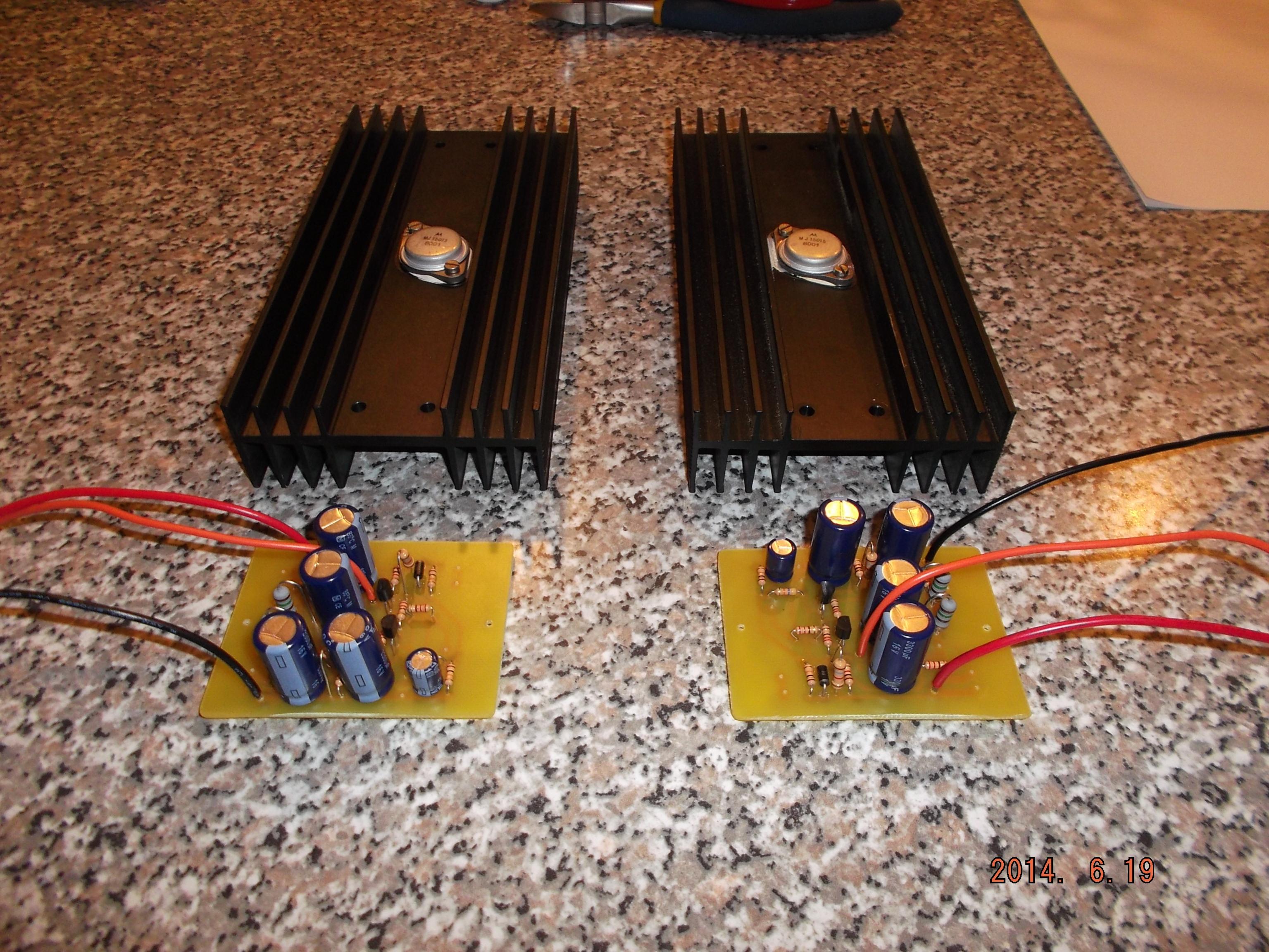

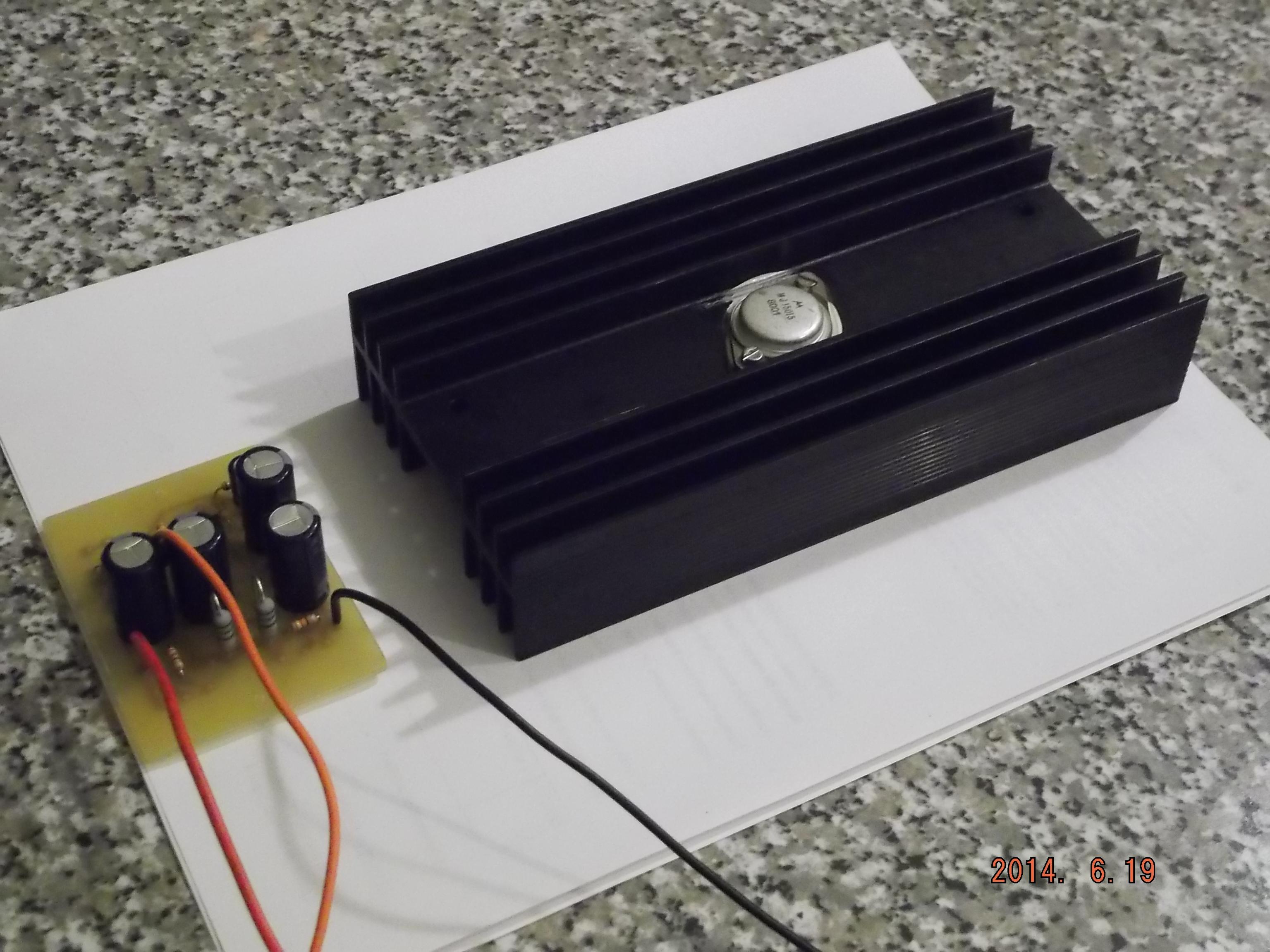

Here are my amplifier module based on Juma's schematic and PCB Layout, I,m only missing an input cap and the output device which will be installed on 1 heatsink per channel.
Each channel has to dissipate 17W for an 8 ohm load for a bias of 0.7A.
My heatsink are recycled and I will if they are big enough install 2 x TO-3 on each of them, but are they big enough ?? By looking at the pics is there a way to find out if they can dissipate 17W with a max temp. rise of lets say 25C ?
They will be installed like on the picture, horizontal. They are 7 inch long, 4 inches wide and the height is 1.5 inch, each heatsink has 8 fins.
To help out I have attached some pictures.
Thanks for your help.
BR,
Eric

...s is there a way to find out if they can dissipate 17W with a max temp. rise of lets say 25C ?...
25C temp. rise might be a bit too optimistic for a given wattage on that heatsink, but there is an easy way to check that out.
Mount your MOSFET on the heatsink and make a simple setup (see attachment). Use P1 to set the current (start with lowest resistance of P1) and after you do it wait for about an hour (heatsink needs time to heat up) and measure the temperature of the heatsink, MOSFET and the ambient. Then you'll know for sure.

I'll run some test during the week-end and for fun I'll keep you posted of the dT.
I recently finished a JLH amp where I have to dissipate 36W/ch at idle and my heatsinks were mounted horizontal (identical style) and are OK since I can rest my hand for as long as I want but of course the heatsink where about double the size.

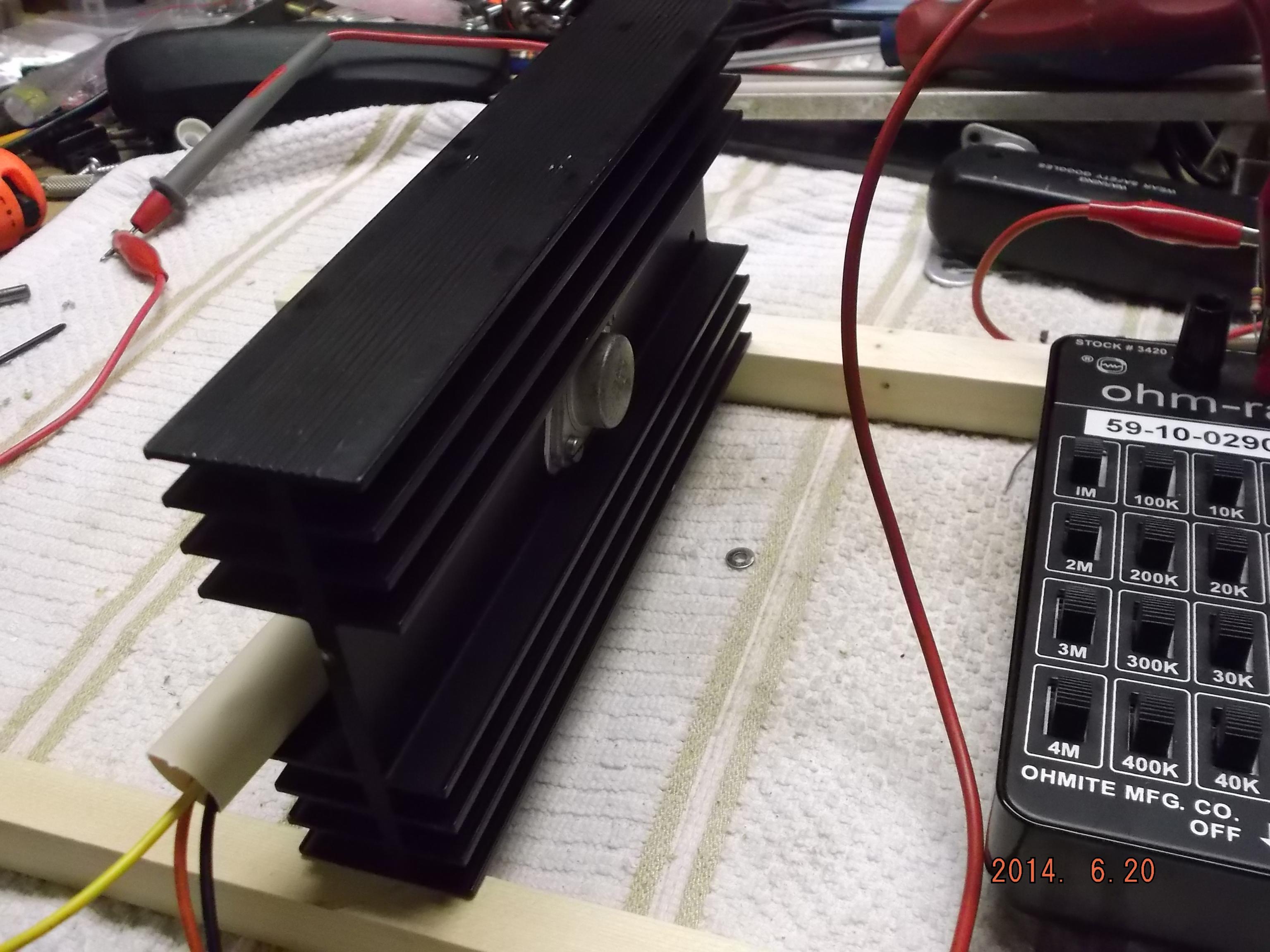

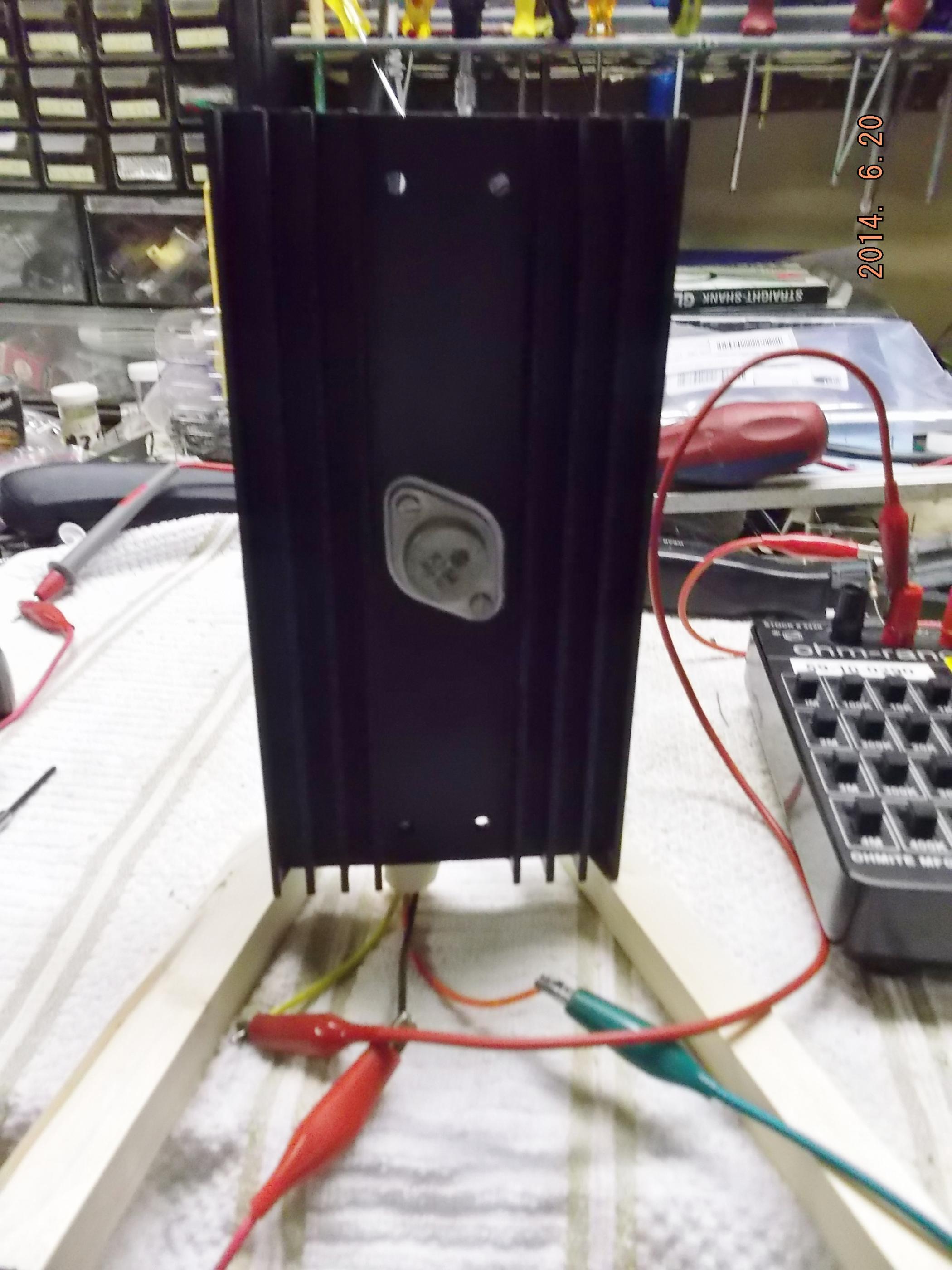

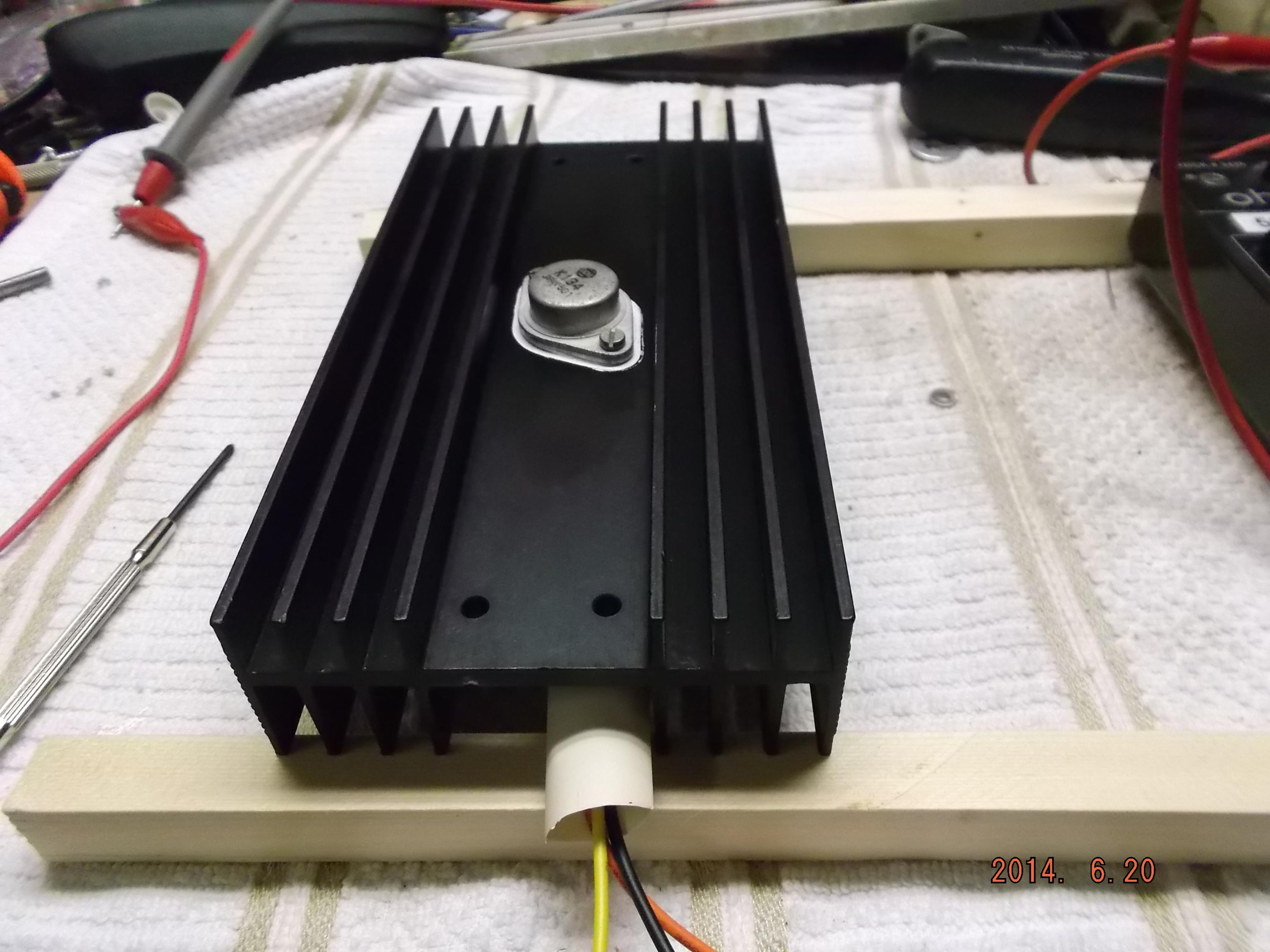

Results are in, Juma you were very close. (5 deg. off only)
For the test, heat dissipated in heatsink was 17W, I needed 2.20V at the gate of the single 2SK134 to get a drain bias current of 0.7A
Ambient was 23C, temp reading taken with an Infra-red gun, reading taken after 1h in each of the 3 differents heatsink positions. The coolest is obviously when the heatsink has the fins vertical (standing) but not by so much...I was surprised.
Pic no.1 (left) Vertical position (temp rise of 27C, Heatsink temp 50C)
Pic no.2 (center) Flat (temp rise of 30C, Heatsink temp 53C)
Pic no.3 (right) Horizontal (temp rise of 31C, Heatsink temp 54C)
So to minimize the volume occupied by the amp I'll go with pic no.3
Do you consider 54C as being too hot..?
BR,
Eric

54C is tolerable but you have to be aware that you measured with both sides of heatsink exposed to free air. When you build the amp one side of the heatsink will be inside the box so you'll have to provide good internal air flow to maintain those figures.
The other thing seems a bit unusual - with all the 2sk135s and 2sk1058s I used that much Vgs (2.2V) gave me Id > 1A. Looks like you have a "lazier" batch of Laterals - nothing wrong with that, just take care to choose appropriate values of collector resistors in the input stage (I'd use 820R for Ic of 2.7mA). Measure the Vgs of your P-channel parts (2sj49) to get the whole picture.
