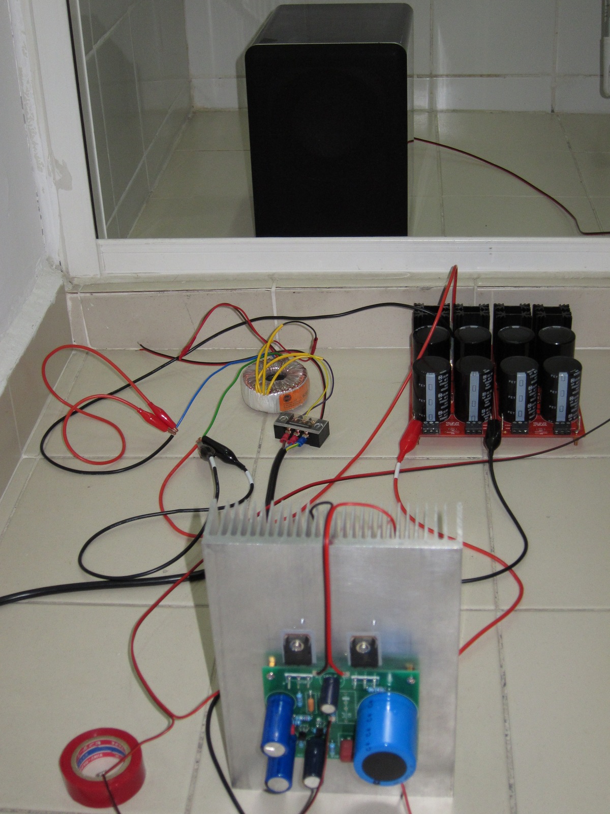

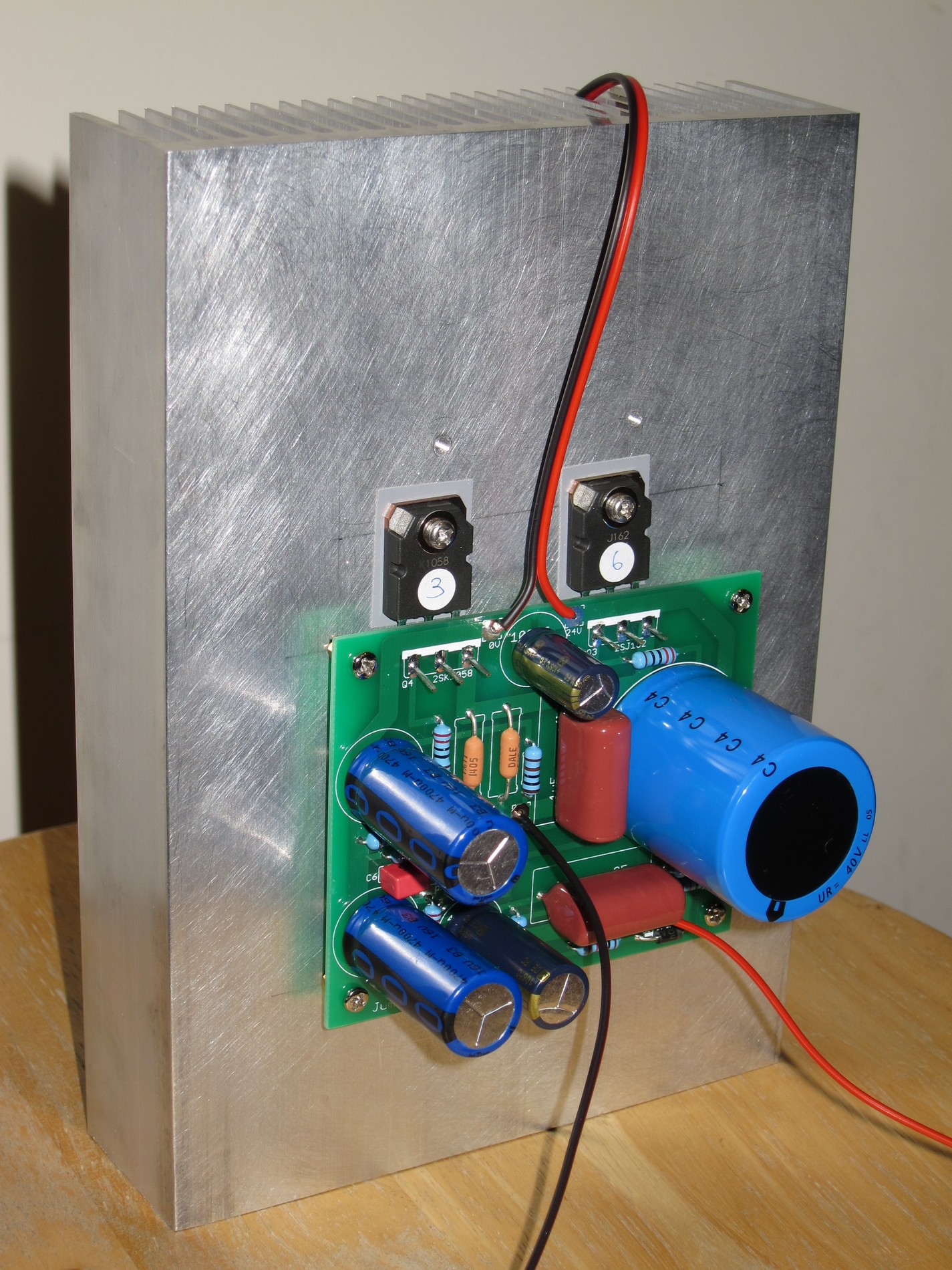

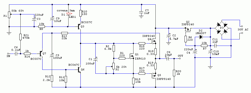

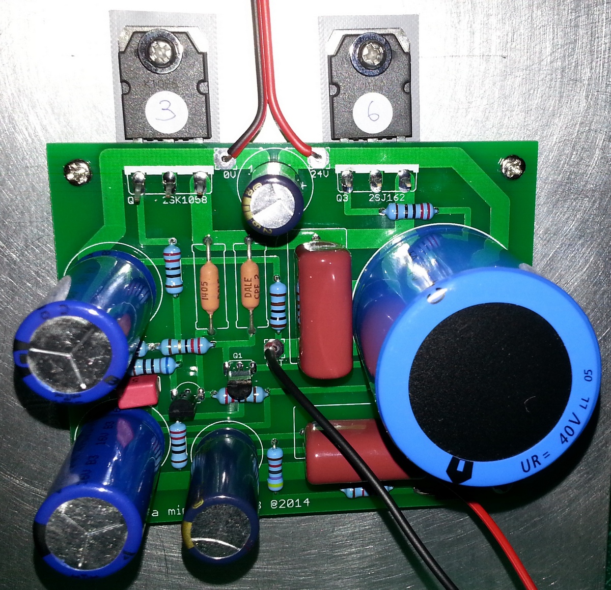

I made one channel of the mini-F5 for testing, with component values according to the attached schematic. Except that I used a 19.5V notebook smps to power the circuit while testing, since I'm still waiting for the toroid to be delivered.

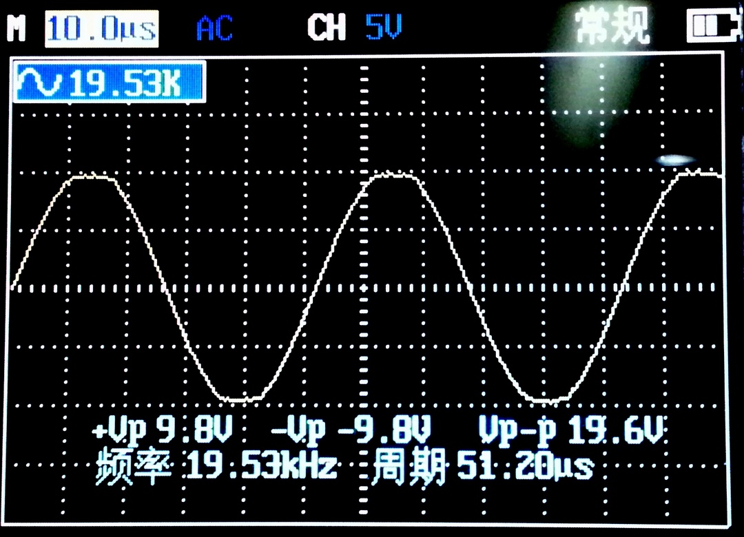

The amp seems to work, I fed it with a 2.8Vpp sine wave from my scope meter and it's amplified (in fact, it clipped but the generator output from my cheap scope meter is fixed at 2.8Vpp so cannot lower it.)

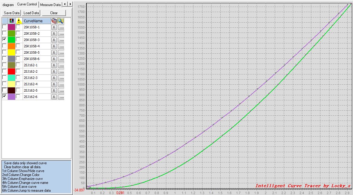

However, I have an issue. I noticed that Vgs of Q4 is only 0.89V and Vgs of Q3 is only -0.53V. That correspond to around 140mA of bias, too low actually. So I want to know whether I should increase R3 and R5 to get higher Vgs, or this is simply due to the use of the 19.5V supply, and will be fixed when a 24V supply is used (I would like to have around 750mA of bias current).

Nice looking PCB.

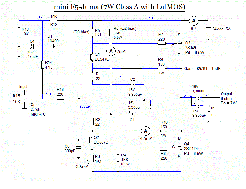

In my amp R3, R5 are 1K1 (with a 24V supply) but that is because my NOS LatMOS seems to be lazy.
Before changing R3 and R5 and would wait to use your 24Vdc supply.
I think your low bias is mostly due to a low supply. Do you own a small bench test 24V supply ?
Rgds,
Eric
It sings
It'll take another 2 weeks for the 200VA dual 18V toroid I ordered to be delivered, but I took an undersized 35VA dual 9V from a linear regulator to give the 24V dc I needed for testing.
At 23.8V Vcc, I got a bias of 500mA for each MOSFET, so I increased R3/5 from 680R to 820R. However, it was too much to ask for the tiny 35A toroid and Vcc dropped to 22V, anyway I got a bias of around 600mA with that.
Next I connected a 5R 20W resistor to the output as dummy load, and I saw oscillation from the scope meter when test signal was present. I removed the 4.7uF output bypass capacitor and the oscillation got even worse. It turned out oscillation was due to the nest of crocodile lead wiring mingled altogether, but was resolved by separating the input and output wires with proper distance.
Finally connected the test channel to a cheap Denon speaker, and it sings !! Source is just a Samsung smartphone's audio out, but even with a single channel the sound is quite nice, it has a taste of sweetness resembling that of tube amps :cool:

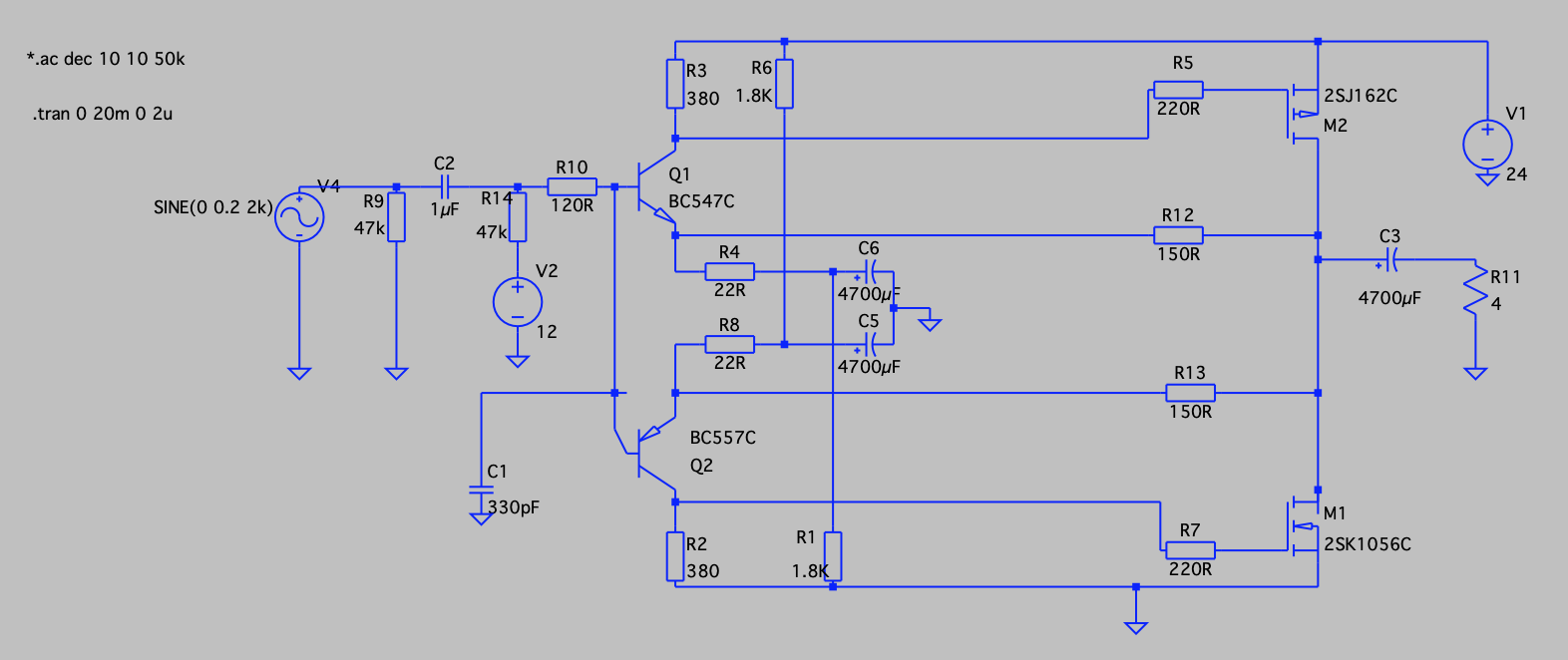

Sorry to resurrect that thread

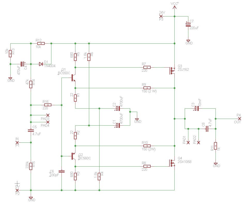

But I am on the search for a small amp to power my tweeters from 3Khz upwards. They are planars with 3,6 Ohms flat impedance and around 90dB sensivity.
I have the lateral mosfets and an enclosure with heatsinks capable of around 10W dissipation per channel.
So I simulated a version of jumas amp from post #217 https://www.diyaudio.com/forums/pass-labs/255523-recommendation-5-10w-amp-22.html#post4000309 which biases the laterals around 0,2A, so it will be Class AB, dissipating 5W per mosfet. It simulates fine...
But since I am not an experienced amp designer at all, I would like to ask you guys if that approach is valid?
Is there a similary low parts count amp schematic out there with the 2sk1058 and the 2sj162 (which are the parts I use), that could work better with the low bias approach?
Thanks for your help.
